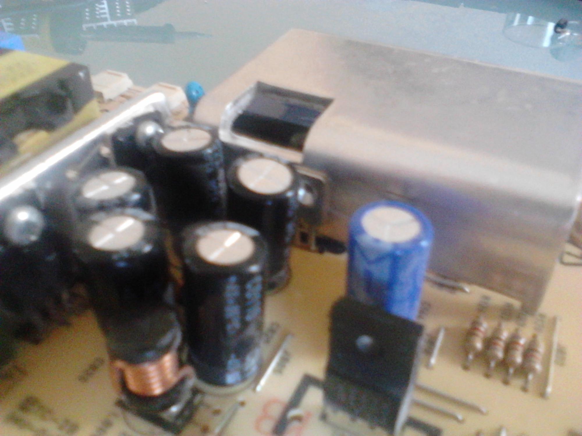

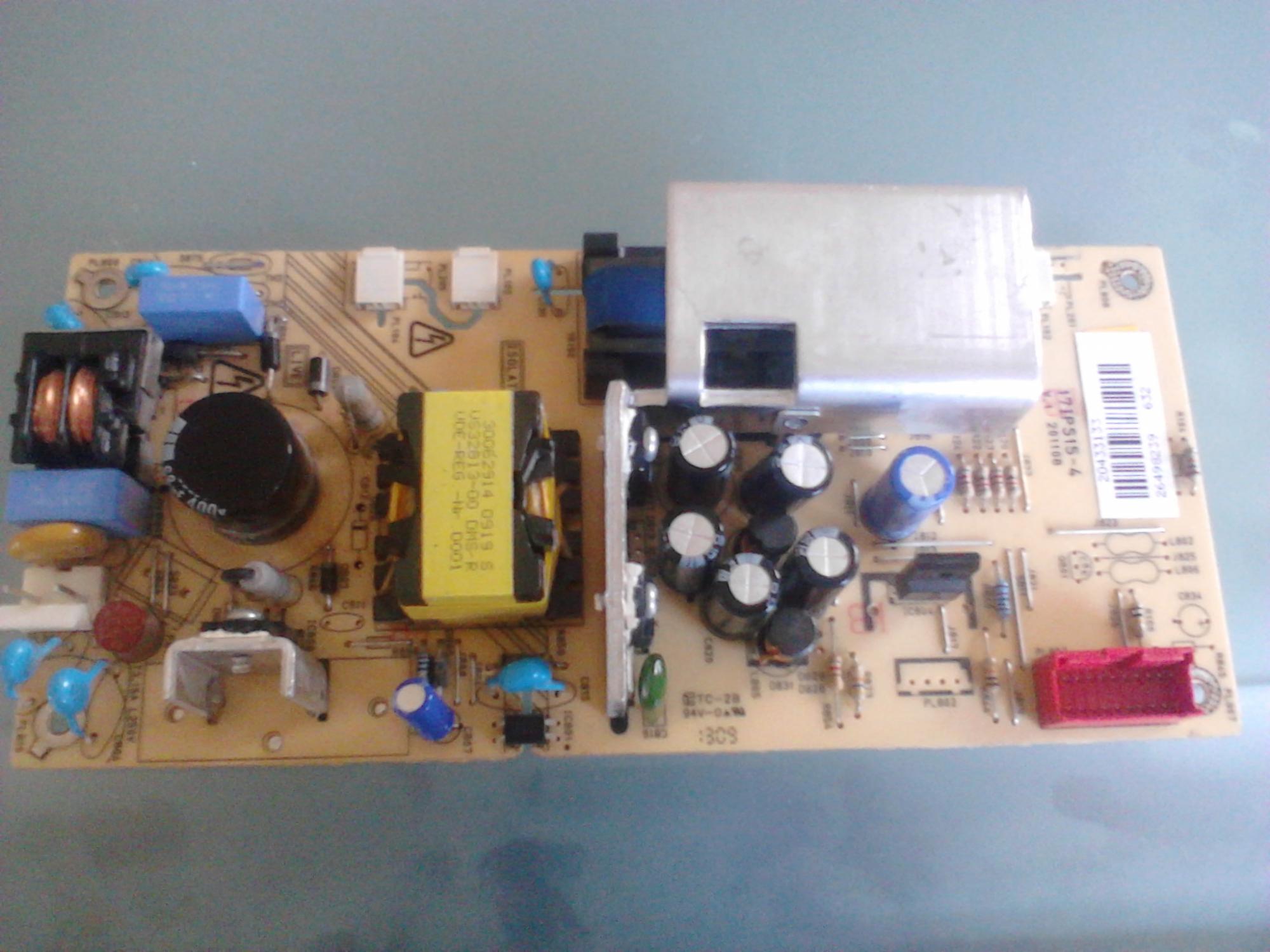

    Hi guys, just joined as i have been looking around for a fix to a tv i have just bought.
    Have always liked electrics and now want to learn about them so i thought i would buy a broken tv and see what i can do.
    I bought an alba 19inch (Vestel from what i have read on this site).
    It goes into standby (Blue light on) but then when i press the power button the blue light goes off, then 3 seconds later the backlight comes on for less than one second and goes off. And thats it? I have read about and its likely to be the caps but i can't find any bad ones?
    The power board is a 17ips15-4.
    I have tried this board in another alba (16inch one) and it does the same thing. Although the 16inch one works fine.
    I have swapped all the caps from the 16 inch to the 19 inch and it still does the same yet the 16 inch tv works fine as before?
    Is there any chance you guys can help me out, I plan to be hanging around here for a long time .
    Really sorry about the pics, poor quality phone.

    Bad cap can look normal, since you have already found out that it is the board, you may want to try taking the resistance reading of the inverter transformer and may be compare it to the 16" version. We cannot really see the transformer too well in the picture since it is under the heat sink.

      First lesson. I think I see Capxon caps. If I'm correct, they make the worst or second worst caps in the industry.
      Second lesson. Since we are doing remote troubleshooting, the clarity and composition of pictures matter. This is how we prefer composition.

        I cannot test the inverters against one another because the 16 inch one has a smaller transformer (4 legs) and only 2 backlight wires (2 pink) And the 19 inch one has 4 backlight wires (2 pink & 2 blue)?
        I also have another alba/vestel, a 22 inch one that works fine, has the built in dvd player, would that power supply be the same as it might have the same transformer to test against?
        Thank you both for the replies so far.
        Retiredcaps, i will dig my camera out late on today and see if i can get a few decent pictures for you to mull over.
        Just to let you know, both psu are the same model number (17ips15-4) on the 16 and 19inch but have different inverter transformers and different amount of backlight sockets?

          Right guys, strange thing.
          The psu i thought was faulty works fine in the 22 inch? And the 22 inch psu fails to start the 19 inch tv up.
          So i put the main board out of the 19 inch into the 16 inch and the main board started smoking lol.
          And the 16 board in the 19 and it failed to start, even though i know the board is fine, all i get as usual is a quick blink of the backlight then off.
          So it must of been the mainboard the whole time, or possible faulty cathode lights that broke the original board?
          I put all the parts back in the 16 and 22 and they both still work fine.
          So its game over, i have another 2 tvs coming this evening and hope i can rely on your help if need be.
          Thank you.
          Ps. Sorry for all the 16 19 22 16 22 19s, just easier for me.

            Have you given up on this then?
            The symptoms you describe sound like 2 seconds to black there is a guide here, written by retiredcaps: https://www.badcaps.net/forum/showthread.php?t=10419 start at post19
            There were more fairly easy tests you could do to rule out the inverter transformer or the light/wiring.
