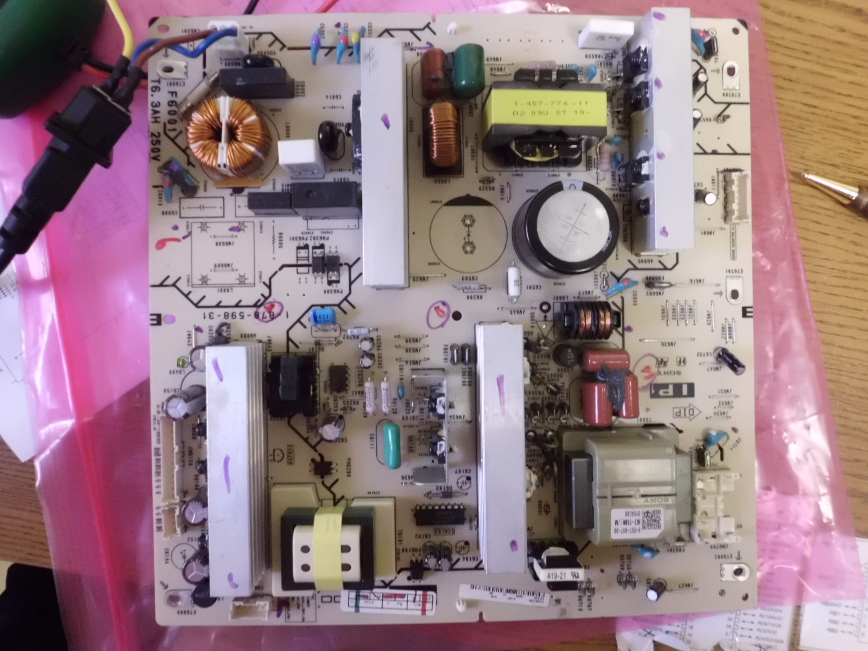

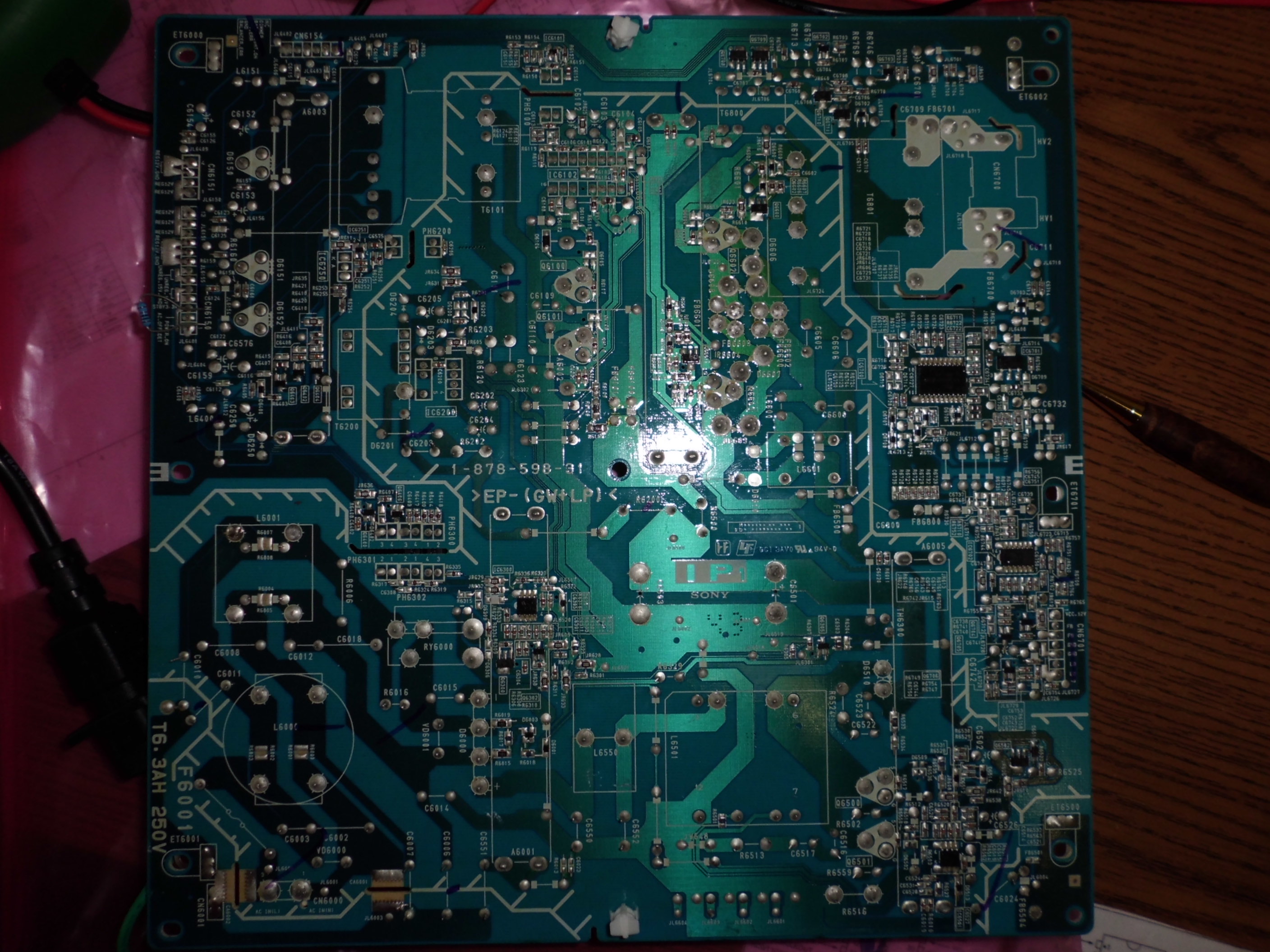

                      Well, this set failed again with the exact same symptoms. 2 x's red LED blink. Buying another board would be senseless, so I am compelled to find the problem. Any input would be greatly appreciated as always. I really don't have the best grasp on how the PS's function in terms of PFC and OVP IC's. Here is what I see when I have a 1 K ohm across PWR_ON and STBY (3.3 VDC):
                      1. Q6100's drain reads 165 in standby mode (resistor off) and 394 when PWR_ON is high.
                      2. Pin 1 of IC6102 reads 2.18 VDC when PWR_ON is high.
                      3. Pin 8 of IC6501 reads 15.81 VDC when PWR_ON is high.
                        Re: KDL-40S5100 - No picture - Red LED blink x 2
                        Pictures of the front/back of PS.

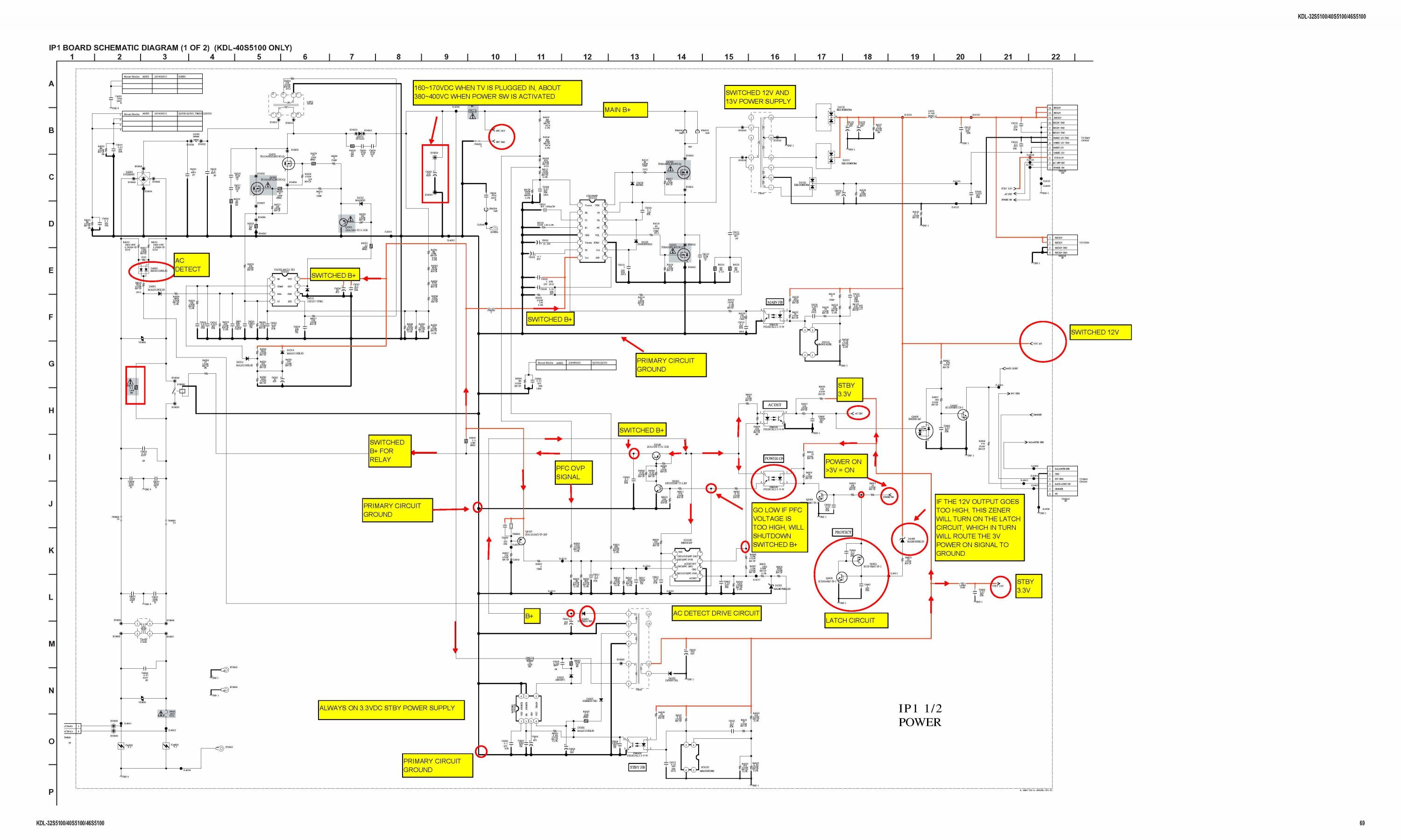

                          OK, you only post one of two page of the power supply, I do not see the 24v power supply section.
                          There are MANY detection circuits in this TV.
                          This how the circuit in this page works: I hope you can follow it, print out the diagram on big piece of paper will help. It is not that bad.
                          1) TV is plugged in but the power switch is not activated yet. The relay is open, the power to bridge rectifier D600 through the resistor R6016 which is connected across the relay contact. The output of the rectifier is filtered by the main filter cap C6501, it will have about 160~170VDC (MAIN B+) on it.
                          2) The MAIN B+ is used for running the always-on STBY_3.3V power supply (IC 6200, it drive the power transformer T6200), which is used for running the main board micro controller.
                          3) The transformer winding of T6200 pin 9 & 10 is for generating the 3.3VDC.
                          4) The transformer winding of T6200 pin 3 & 4 is for generating the VCC pin4 of the IC 6200.
                          5) The transformer winding of T6200 pin 1 & 2 is for generating B+ for feeding the switch Q6300 and for the IC 6300 (AC detect, PFC detect, PFC_OVP, .
                          6) When >3V is applied to POWER_ON pin, this voltage is fed to R6421 in series with R6410, the output of R6410 will turn on Q6404, which will then turn on the LED inside the Opto PH6300, the Photo transistor will also turn on. This will turn Q6302 which cause the switch Q6300 to turn on and supply the voltage (SWITCHED B+) to turn on the Main relay (contact is now closed), this SWITCHED B+ is now will feed the PFC IC 6501 which will cause the DC voltage on the main DC filter cap C6501 to rise up to 380~400VDC. The SWITCHED B+ is also feed SMPS IC 6102 which drive the MOSFET Q6100, Q6101 which drive the power transformer that produce 12v and the 13v.
                          7) If the 12v output goes too high, this will bias on Zener Diode D6400 this will turn on the latching circuits consist of Q6402, Q6403. This will route the POWER_ON signal at the junction of R6421, R6410 to ground that will turn off Q6404 that will turn off the SWITCH B+ that is used for the PFC and the SMPS (12V/13V) ICs.
                          8) IC 6300 does the AC present detection, PFC DETECT (not used), PFC OVP (OVER VOLTAGE). If the PFC boosted voltage goes to high (detection at pin 2) the PFC_OVP OUT pin 4 will go low which will turn off Q6302 which in turn will turn off switch Q6300 for the SWITCHED B+ , again turn off the PFC and the SMPS (12V/13V). Notes: I am not sure the ACDETECT OUT at pin 7 should be high or low when AC is detected since I do not have the 2nd page of the power supply circuit.
                          As you can see, we can defeat the detection circuit to find out what causes the shutdown. The first place to look will be the POWER ON signal pin, we need to see if it is still there when the TV goes in to shutdown mode.
                          I need to see the second page of the power supply circuits.

                              So look at the Power ON pin to see if it is still there when the relay click off. Look at the 12v LINE to see if it went way over 12v, you may have to use peak hold function to catch that.

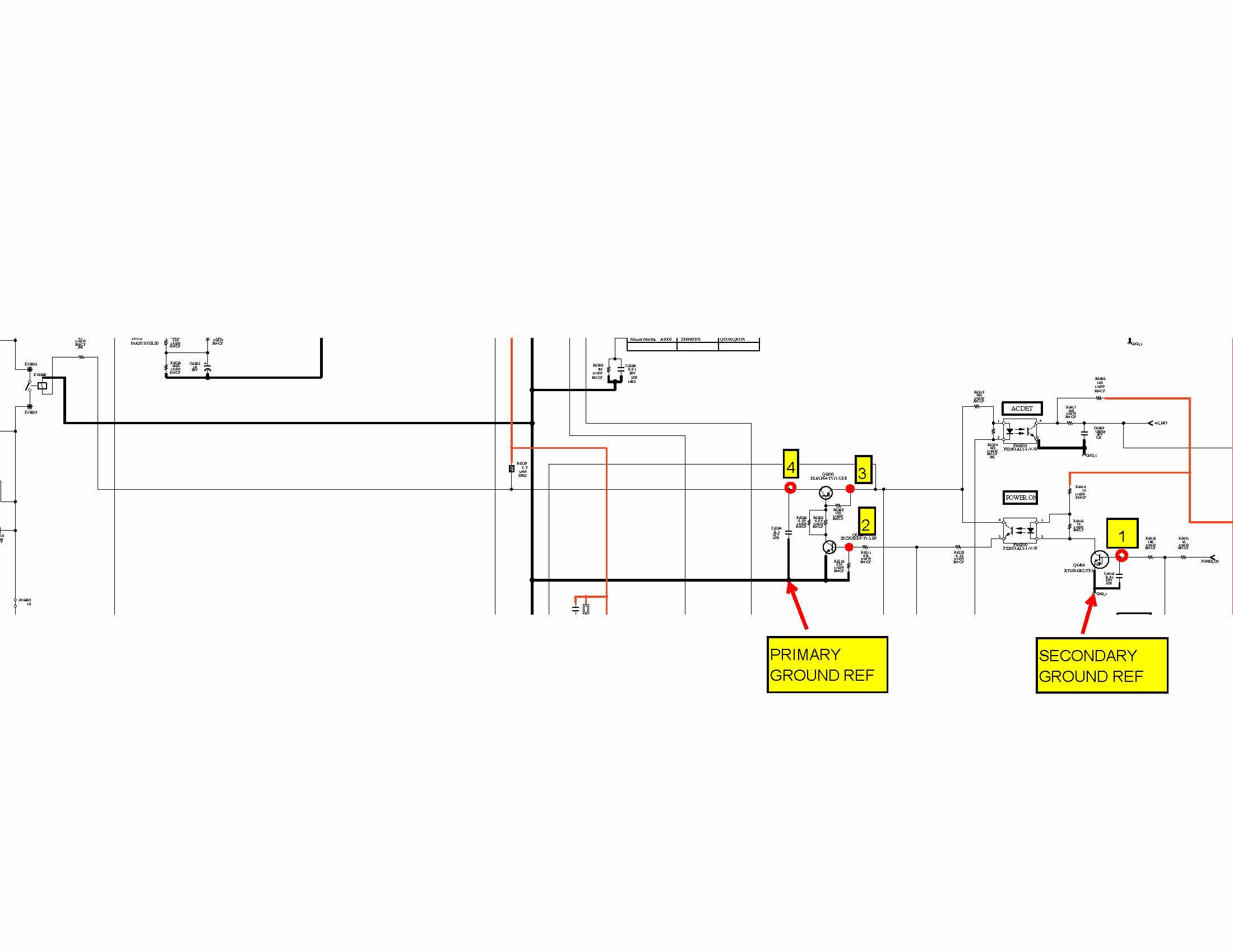

                                Hi I am Mani from India. Got to know this forum via search engine. Very nice to see the details. Thank you all. I have one issue in my Sony Bravia 40S504 Power Supply board 1-878-598- 11. The link for the schematic is below.
                                The problem here is even though when we give power on command, the main relay is not getting closed. If i forcefully close, the tv is turning on and working fine. I suspect its having start up problem. probably with Relay driver. Is there any helping hand to fix this issue. i do not want to replace the board and want to fix this by changing the component. Any suggestion is welcome. Looking forward for the support.

                                  @MAN9COB, so your TV is model 40504??, the service manual in the link is for 40SL150, if that is power supply section matches your TV then you need to check the DC Voltage at test point 1 (use Secondary ground ref), then the DC Voltages on 2, 3, and 4 using Primary ground ref. report the readings.
                                  You should start a new thread for the correct model you are working on.

                                    Hi Budm, how are you? thanks for your quick reply. Yes my PS board is holding same schematic. Unfortunately i am outstation for this week. i will do check and let you know the voltages by this weekend to get further help from you. mean time if you suspect or want some more points please post, i can do everything together. i am very much grateful to you for supporting me. sorry for the delay in response. mean time i have connected external switch to short relay contact manually and release the start up problem. once the TV is ON i will open the external switch again. the sequence is Power On - External Switch ON - External Switch OFF, once manually short the contact, immediately the relay getting 15.46Vdc at the coil, so relay getting closed always. if you feel any logic behind please share with me.

                                      OK, I will wait for the voltage reading at those test points, it will tell me if those transistors are getting the correct signal or not.
