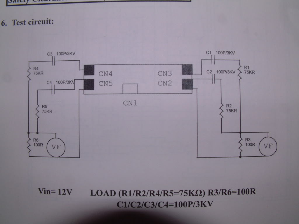

    Does anyone know how I can test the output voltages from a LCD Power supply to determine whether there is any voltage coming out or not
    I am not sure whether I should be testing for AC or DC. and, what would the approx voltage be basically?
    I am trying to test a bunch of power supplies by using jumpers on the 5VSTB and PSon and BL-On or Inv-on.

    if i'm reading you correctly your trying to measure the output voltages from secondary side of the inverter transformer going to the CCFL? If so that voltage extremly high AC and could very well damage most dvm.I would suggest an oscilloscope to measure,in most cases you can just hold your scope probe right near your inverter and you'll see the oscillation of the inverter working.

          Check the scope maximum input voltage it can handle, otherwise you will blow up the input circuits of the scope or the meter. The firing voltage for the CCFL can be from 1500~2000Vac, the sustain can be from 800~1000Vac.

                I dont think anyone ever tries to test inverter output with a meter.
                Remember most meters have quite thin leads and you are talking 1500-4000vAC.
                Why dont you just use a testbulb- out of all the members on here you must be one of the best placed to set up a 2, 4, 6, or 8 bulb test frame.

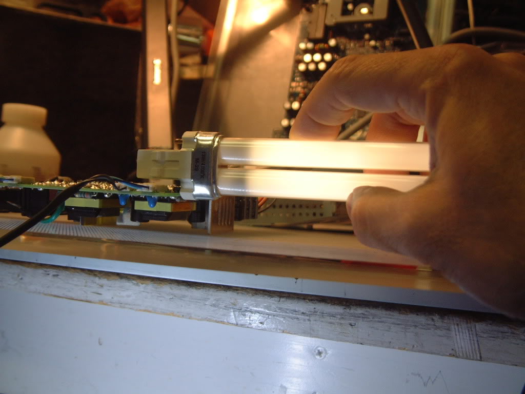

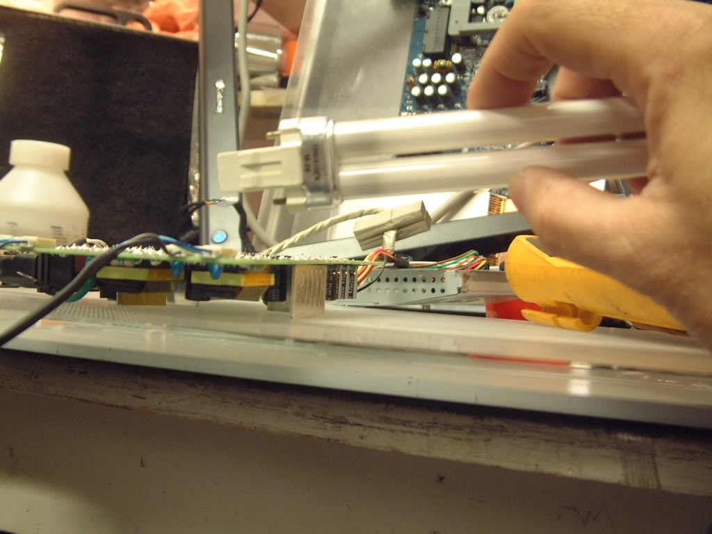

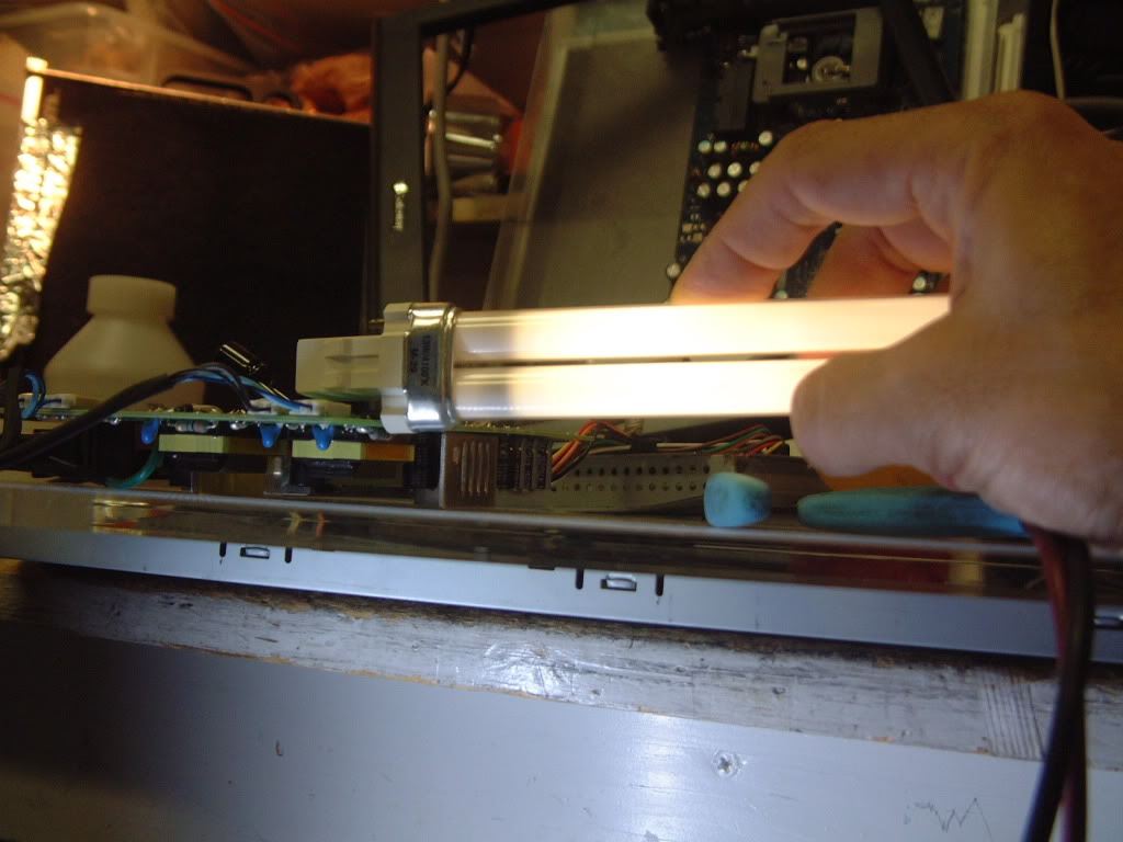

                        I am not sure if he wants to actually read the Voltage value or just want to find out if the transfromer is putting out high voltage, bad transformer may put out some voltage but not at the right voltage, so it depends on what you are looking for. One of the test SONY uses, is to put the meter (set to AC) probe on the connector plastic body, but not touching the output pin, then turn on the TV to see if the meter reading will jump up, this is just for finding out if it s putting out anything at all or completely dead, I myself do not use this test method.
                        You can do this: if you worked with RF transmitter you know why the lamp lights up.
                        http://s807.photobucket.com/albums/y...er%20testing/?
                        The lamp will not stay lit, this test is to find out if the transformer will put out enough AC to light the lamp or not, the inverter will go into shutdown since the lamp will no draw enough current to stop the protection circuit from kicking in.
                        Best test will be using spare lamps.
                        By the way, the HV meter for checking CRT HV, is for DC reading (the high voltage on the picture tube is positive to attract the electron beam from the Cathode Guns, it works the saem principle as vacuum tube), but you can buy AC/DC high voltage probe to use with your DMM.
