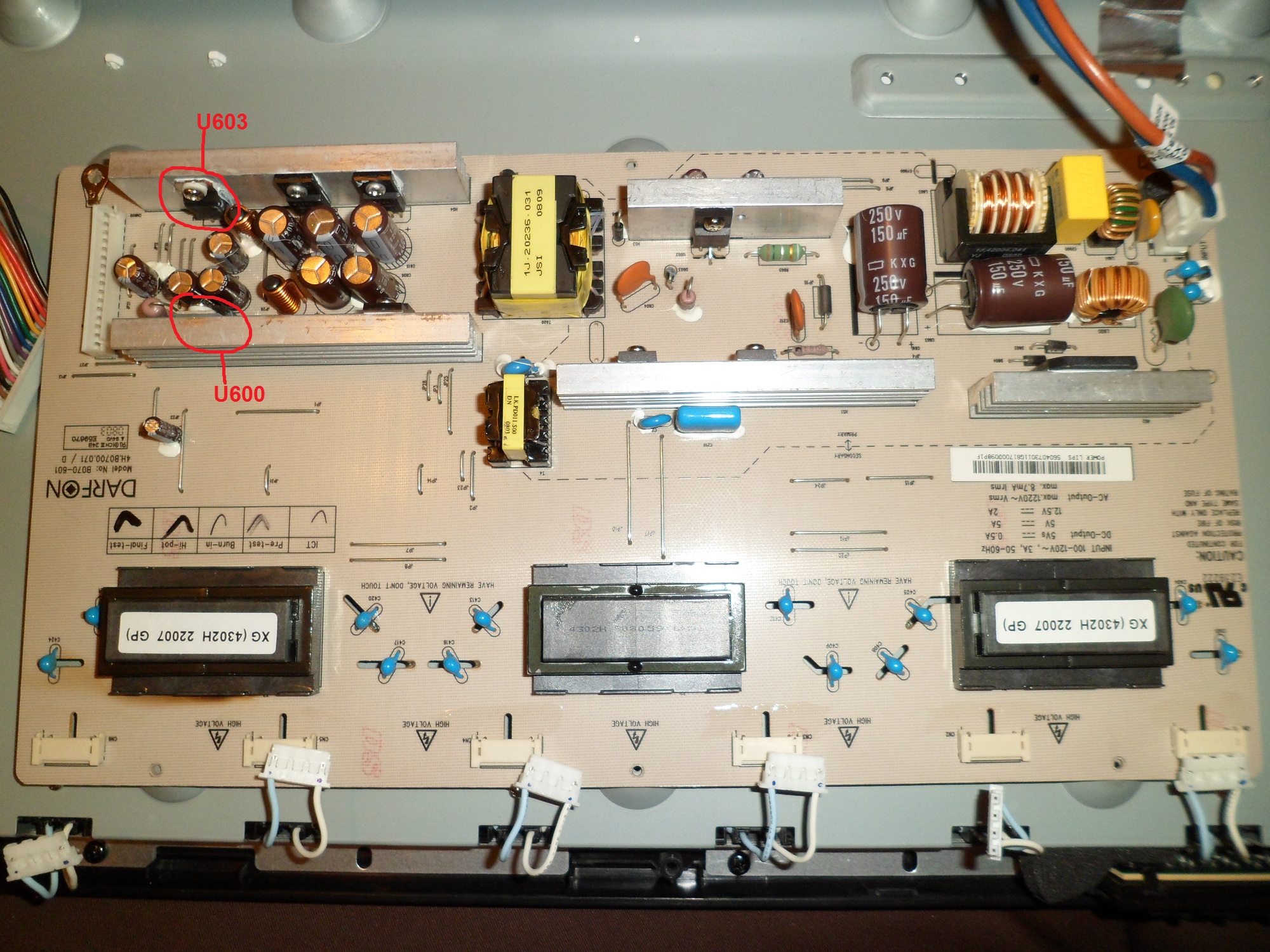

          I measured the Vcc input to the transformers and reading 56v at all time whether the TV is on nor not, does that suggest anything?
            #65

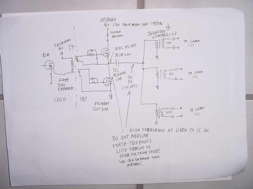

            Re: need help to test inverter transformer

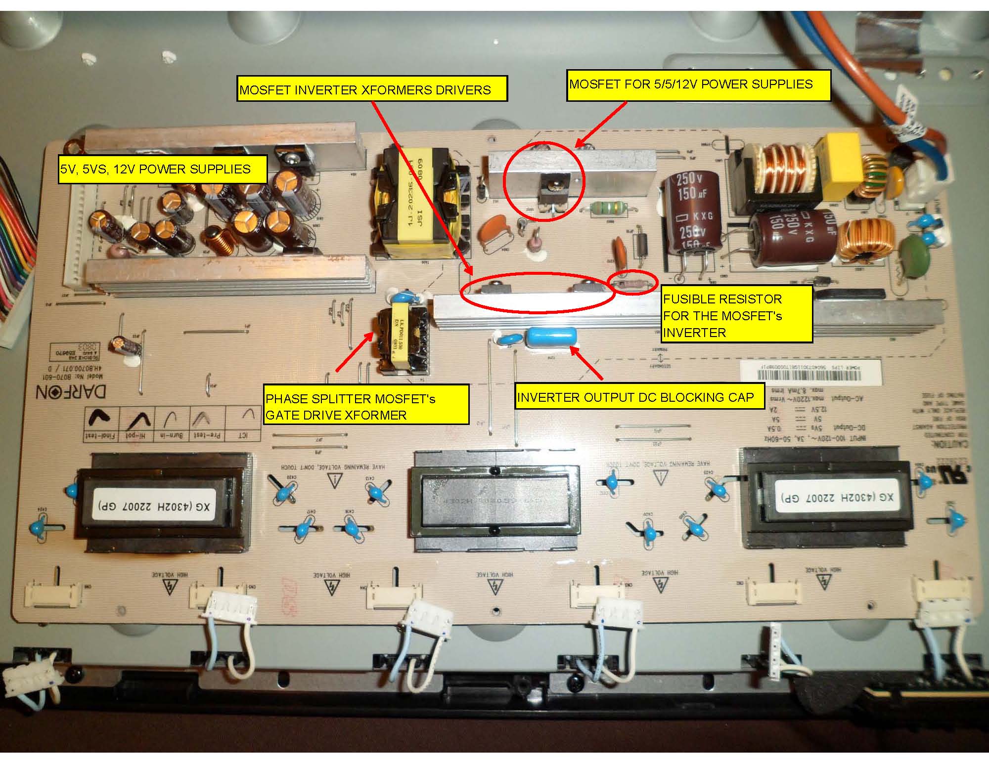

            OK, I looked at the inverter/power supply board, all three transformers are driven by the same output MOSFET's. I still think you should have replace all 3 transformers.
            You have indicated that you have 56V at all time on the inverter transformers primary side. It should have 0 Volt due to DC blocking cap, and the junction between the two inverter MOSFET's should have 0V (not 100% sure since I did not draw out the circuits in details). I would take that blue DC blocking cap out and measure for any leakage resistance using the highest Ohm scale, cap should show open circuits, you should also check its capacitance.
            Another thing you can check to see if all the lamps do at least try to light up or not by just having one set of lamp connector connected one at a time, then turn on the TV in the dark room and see if each set of the lamp will light/flash.
            I will tell you later how to use home made tester lamp.

              #66
              Wow, thanks for that drawing, I've learned much more since I take on this project. Thanks for all those replies.
              I checked the light bulbs one at a time and they're all flashed up in the same pattern; it flashes like twice in about 5 seconds, I think they are fine.
              The DC blocking cap were removed to test, it read opened when test with the ohm meter and the capacitance measured 0.452 nF and the caps's label said 474K (I'm guessing that 's a 0.47 nF cap)

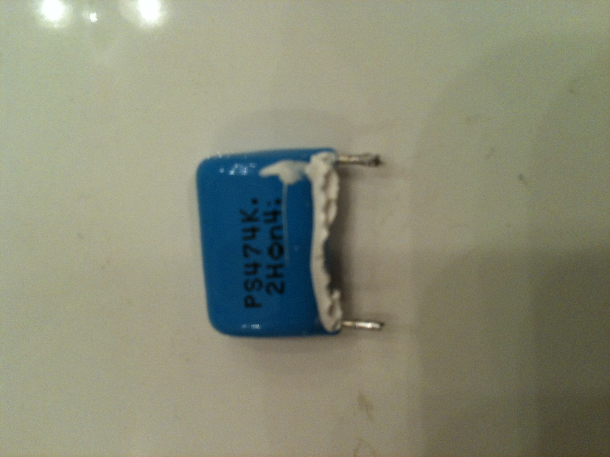

                        Could you please help to id this cap? all I can tell is .47uF, don't know what the voltage rating. I probably be able to find it in my junk pile. Thanks
                        sorry for the blurry image, that's the best i can come up with with my iphone.

                          Is the K relative to 1000 or is it a tolerance value - I have seen some with a J.
                          The 4 could be 400v is there a voltage on the small blue cap next to it?

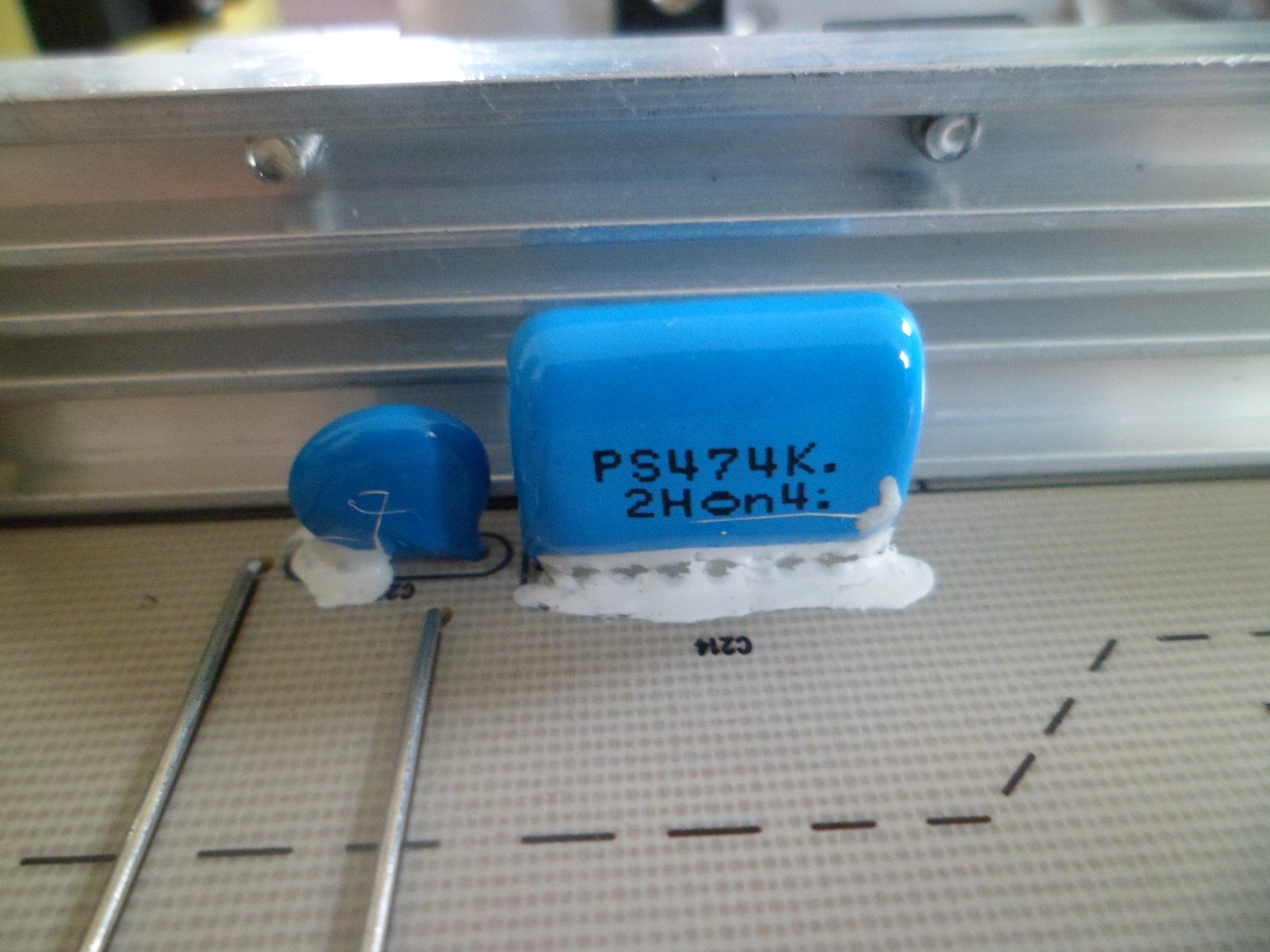

                            there's nothing written on the small cap either. From what I found the 3rd character is the multiplier and K is tolerance value of +-10%

                              Yes that was what I thought - in the absence of more educated input I would try a 400v - I have looked at a few and some are just coded so 4 could be anything. Can you get a better close up of the logo in the middle of the bottom line - if anyone recognises that we might find the codes.

                                  That cap should be 630V or higher due to high voltage pulse.
                                  http://www.digikey.com/product-detai...F6474-ND/56678
                                  Bythe way:
                                  474k = 470000 pico farad(pF is x 10 to the minus 12) = .47uF (uF is x10 to the minus 6), K = 10% tolerance)

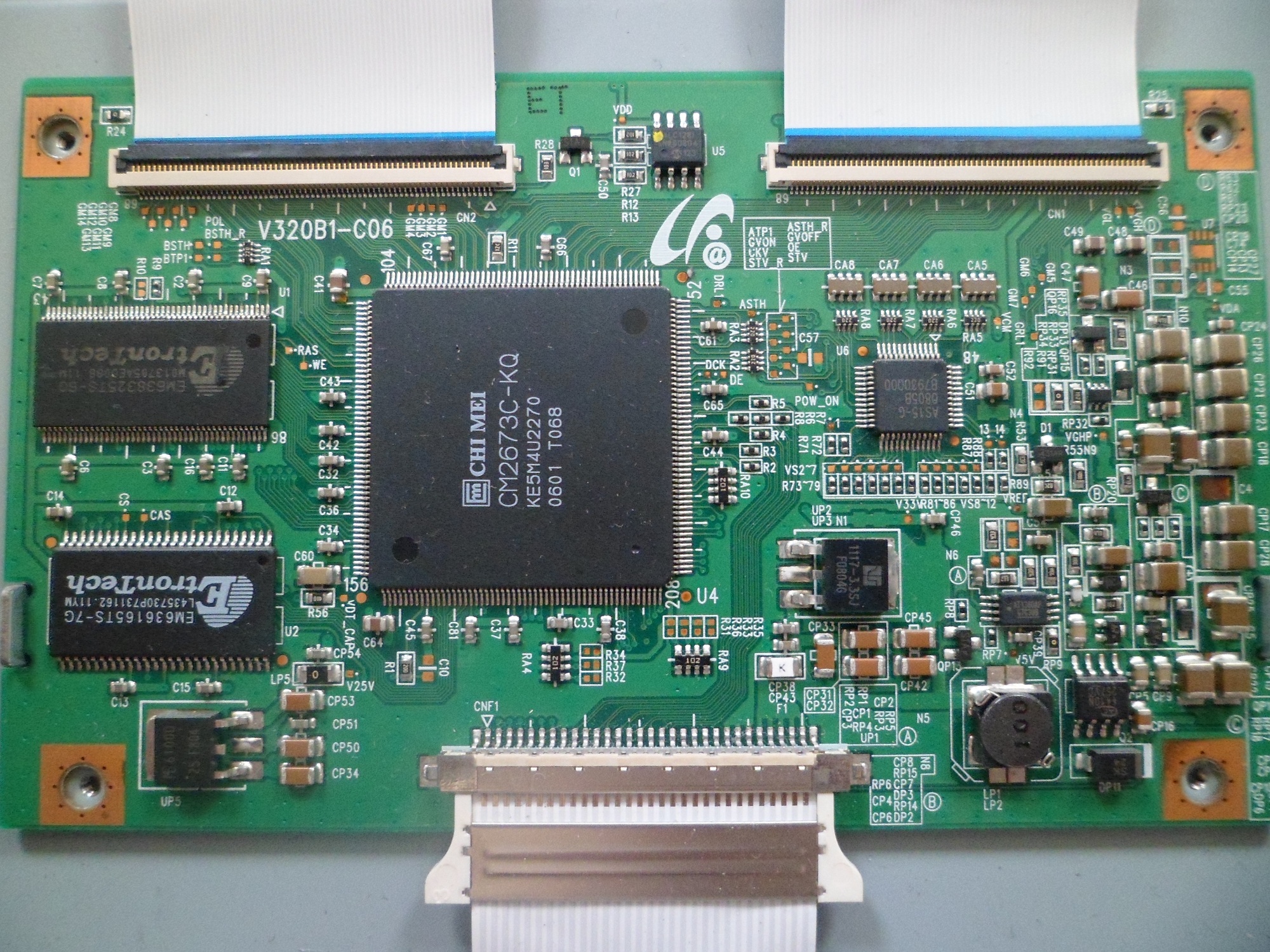

                                    Right - that is the blue cap sorted then. I think we need to have a look at the Tcon board it is under a metal panel in one of your pics. Can you get to it and take some pictures - I think there will be fuses on it to test.
                                    Have you tried unplugging the lead to the Tcon from the main board to see if that allows the backlights to stay on?

                                      I couldn't find 1 similar from my pile of electronic junk so I guess I will have to order the replacement.

                                      I scanned through the t-con board and couldn't find any fuse, may be someone can help me spot it. I hope the photo is clear enough
                                      I have not tried this because I currently have couple mosfet off the pcb for testing.

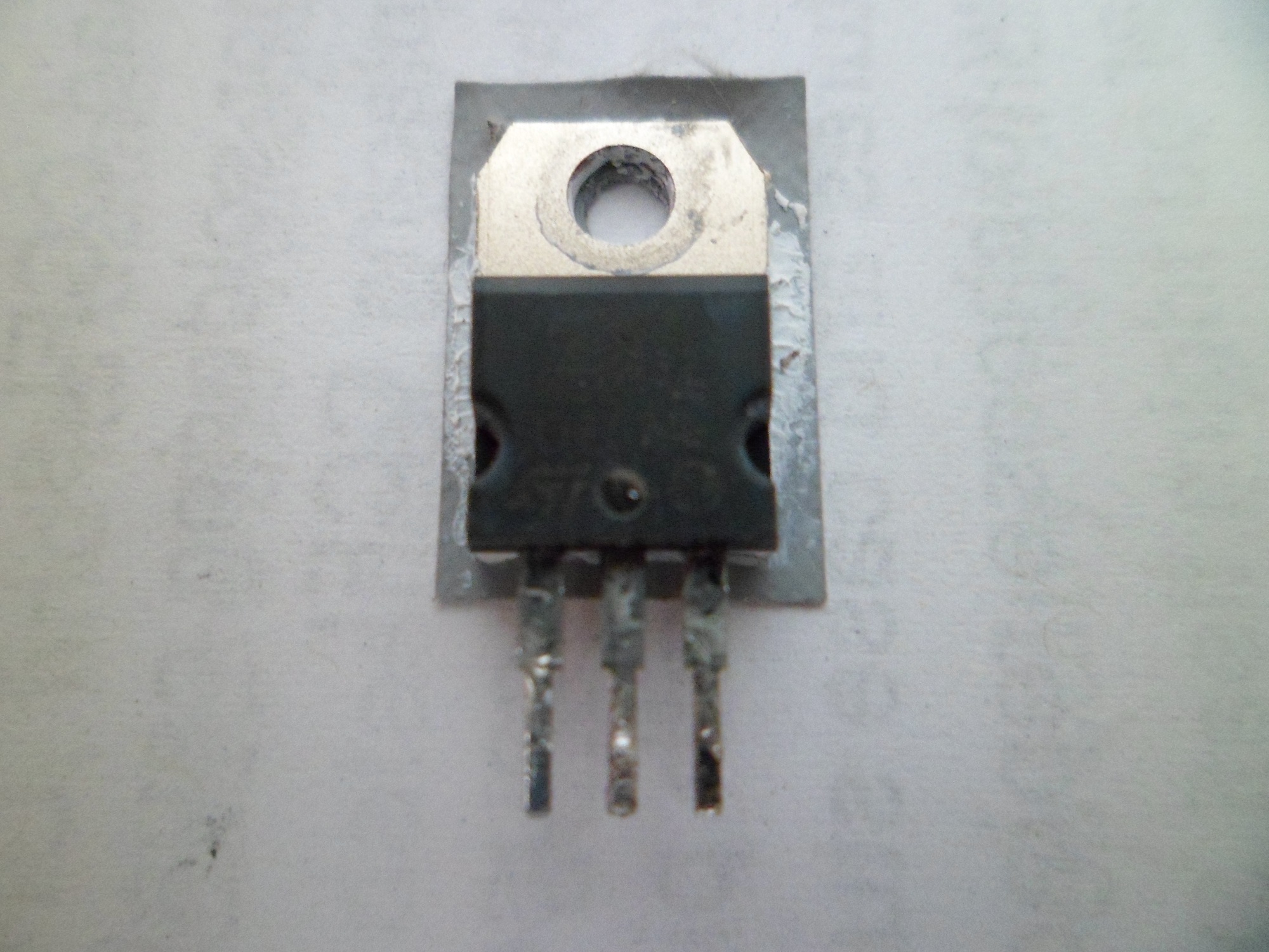

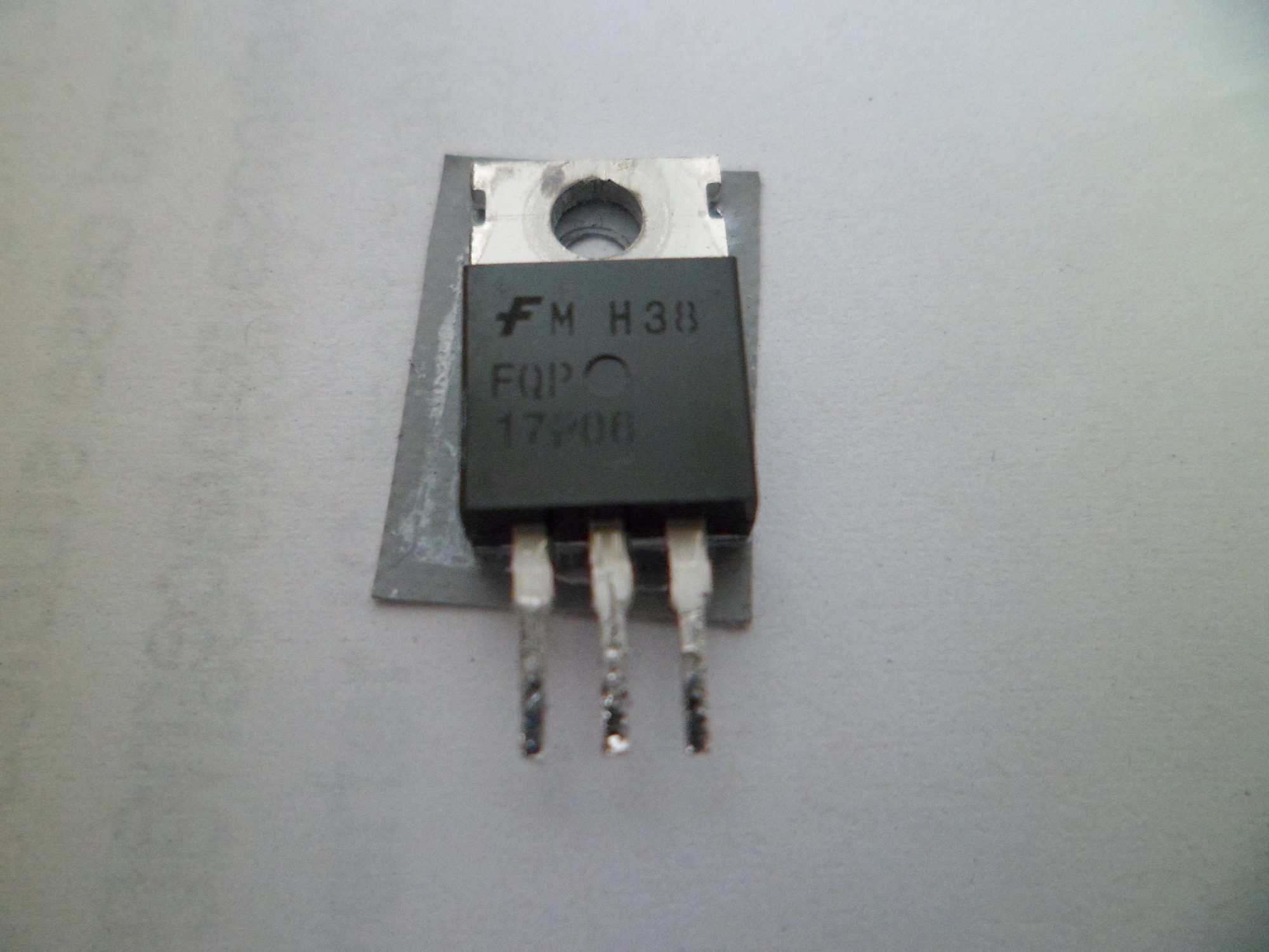

                                      As I mentioned, I de-soldered these 2 mostfet U603 & U600 of the board to test (using retiredcaps instruction). The part numbers are P65NF06 & FQP17P06. The test (setting @ 200 ohm)result are "1" on every pair of leads. Isn't that suggested the mosfet are bad?
                                        Yes - just check that the "1" is one ohms and not "1" meaning "out of range"
                                        would would mean they are likely ok.
                                          that was the "1" on the left, so it's out of range
                                          I'm waiting for the blue cap in order, I'll update with result later. Thanks
