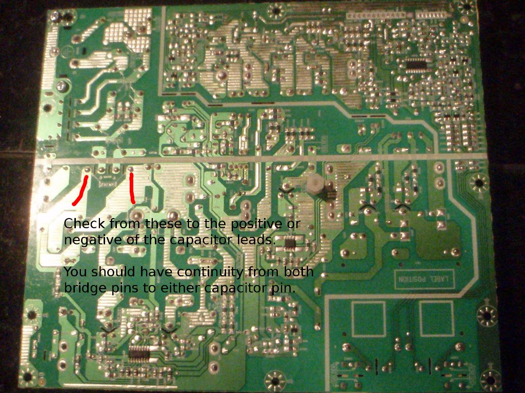

    I have an Insignia NS-L42Q-10A lcd that has no indication of power after being plugged in and the power button is pressed. No power LED or anything. Upon taking the back off the unit, I took a few measurements from the power board. I was getting no voltages on the rail, with the main board being plugged into the unit or not. No 5 volt stanby voltages either.
    Fuse is good, check all the diodes and they are good as well. No burned/scorched components either. Caps are all Elite brand with the exception of the filter caps that are Rubycon. Checked the voltages on the big filter caps and both of them showed 5.90 volts on each of them while being plugged in. My thoughts are that I might have an issue with the SMPS controller IC, but I want to make sure that I am troubleshooting it the right way.
    Board number is 715G3511-P02-000-003M and the pictures of the top and the bottom of the board are as follows:
    Any thoughts, ideas on how to proceed would be more that welcome.

            Okay, but you say you are only getting 6V across the caps?
            Do you see the big green component next to the fuse? That is an NTC thermistor. Check it is not cracked or damaged in any way, and then ohm it out with your meter - should measure a few 10s of ohms cold.

                      No problem at all. Yes, bridge works great. AC side is 122.4 VAC and the DC side is 168.2VDC. We are looking good there.
                        Re: Insignia NS-L42Q-10A with no power/dead
                        Okay, this is getting odd. I'm thinking a cold joint is more likely now. Let's see if there's a way for the bridge power to get to the capacitors. One way may be open causing the low voltage on the caps. Follow the instructions in the image. Do these checks with the board power unplugged.

                          Sorry, I misunderstood you. So I do have continuity between both those point and the filter caps. No problem there.
                            Your last check was good, and it shows the bridge is working. Now I'm trying to see if there is a broken connection between the bridge and capacitors.
