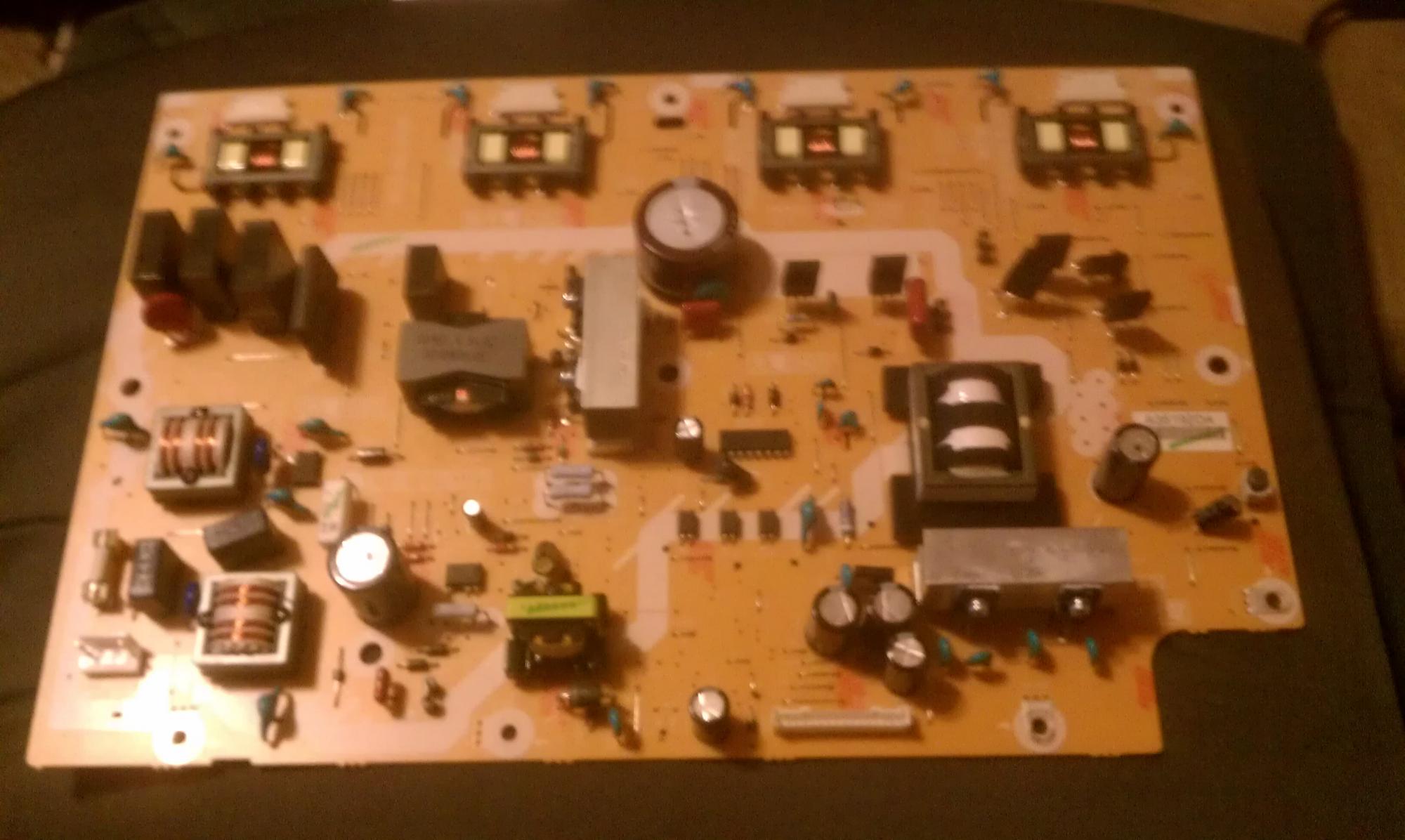

    no blink codes, no red light nothing at all
    Originally posted by randtek View Post
    By the way, are you getting any blink codes on the Power LED? Or is the unit completely dead.

      Re: Panasonic tc-l32c22 lcd
      Tom,
      The 20 pin IC says H3475 OR H5475, not too sure
      Jon
      Originally posted by selldoor View Post
      Tom means the number that hopefully is on the IC with 20 legs that is ringed in red on the picture. You may need a magnifying glass and try rubbing it gently with isopropyl alcohol.
      If it is the same as the tv number I apologise.

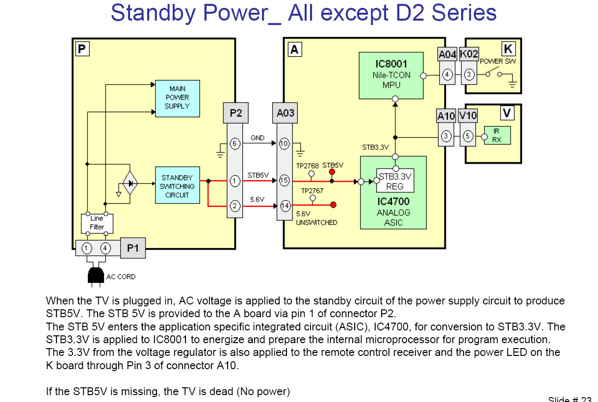

        Selldoor,
        Thank you for the illustrations. This is starting to make some sense to me a bit now. I will continue to study until I have the Power Supply conquered, then of, course, I will have to move onto the Main board and Inverters. Hopefully
        Originally posted by electronicsurplus View Post
        So, correct me if i am wrong. It looks as though the 115V goes to the fuse and then to the Rectifier, then to the 5V standby transistor so, if no 5V I should look to this transistor
        I think i will find a properly working power supply to determine
        I apologize IF i seem dumb but, I obviously am. I must be skipping some chapter or something because, I am surely missing something here
        Thank you for your help in trying
        I guess I will just need to study more to hopefully someday understand

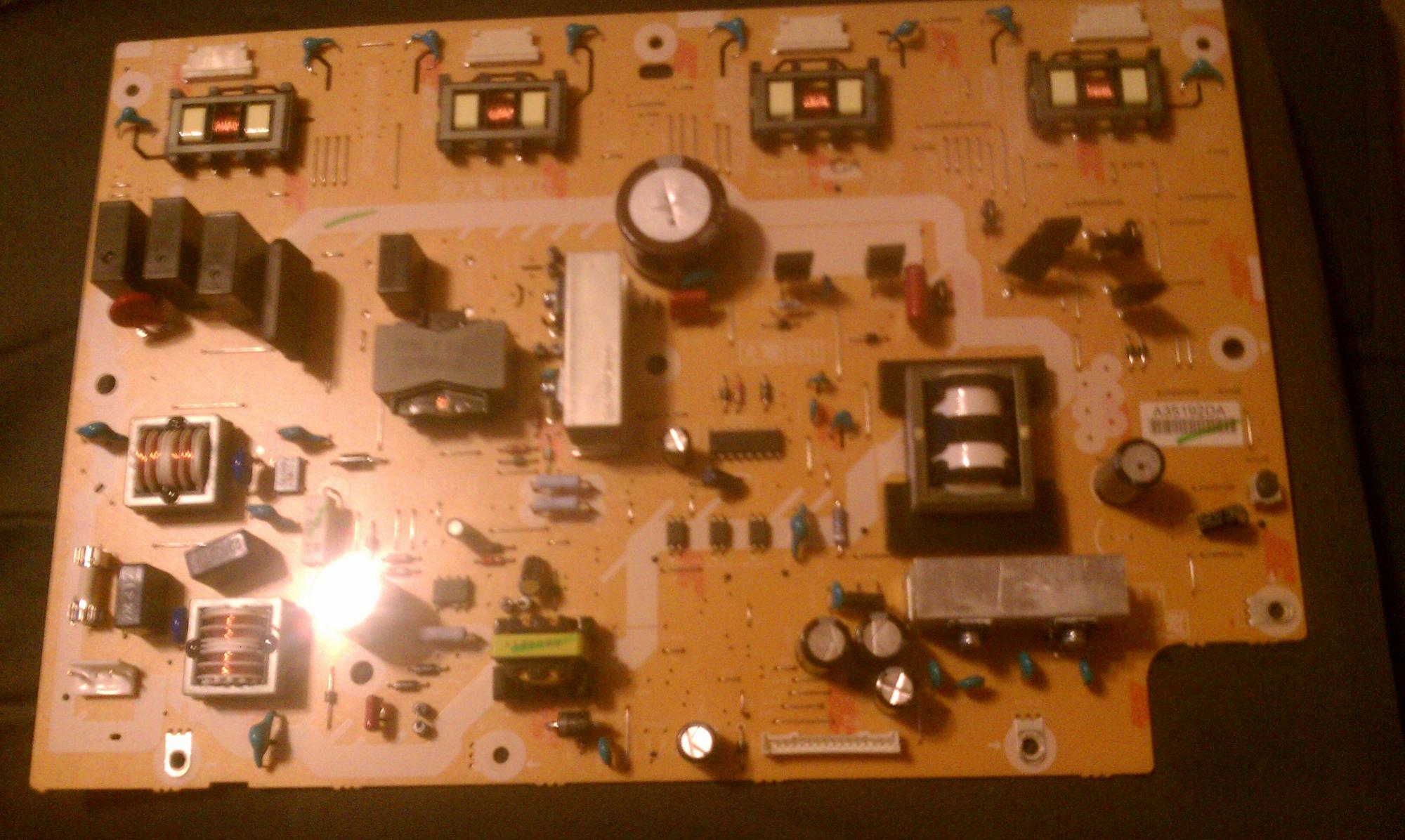

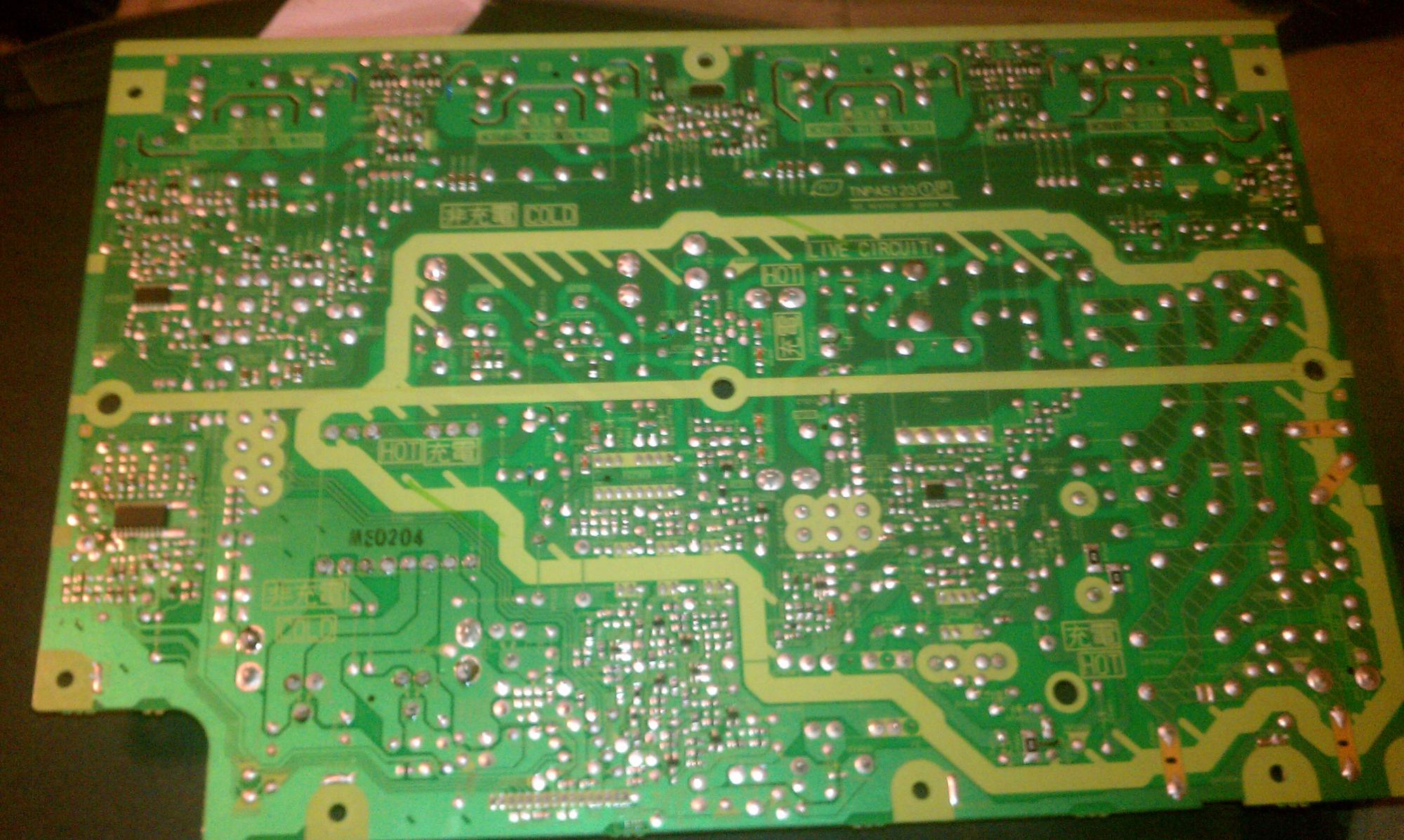

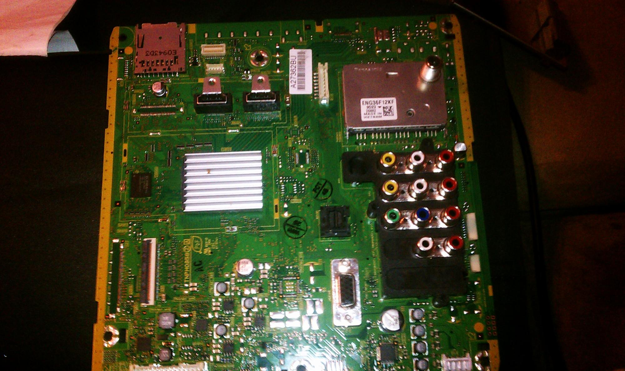

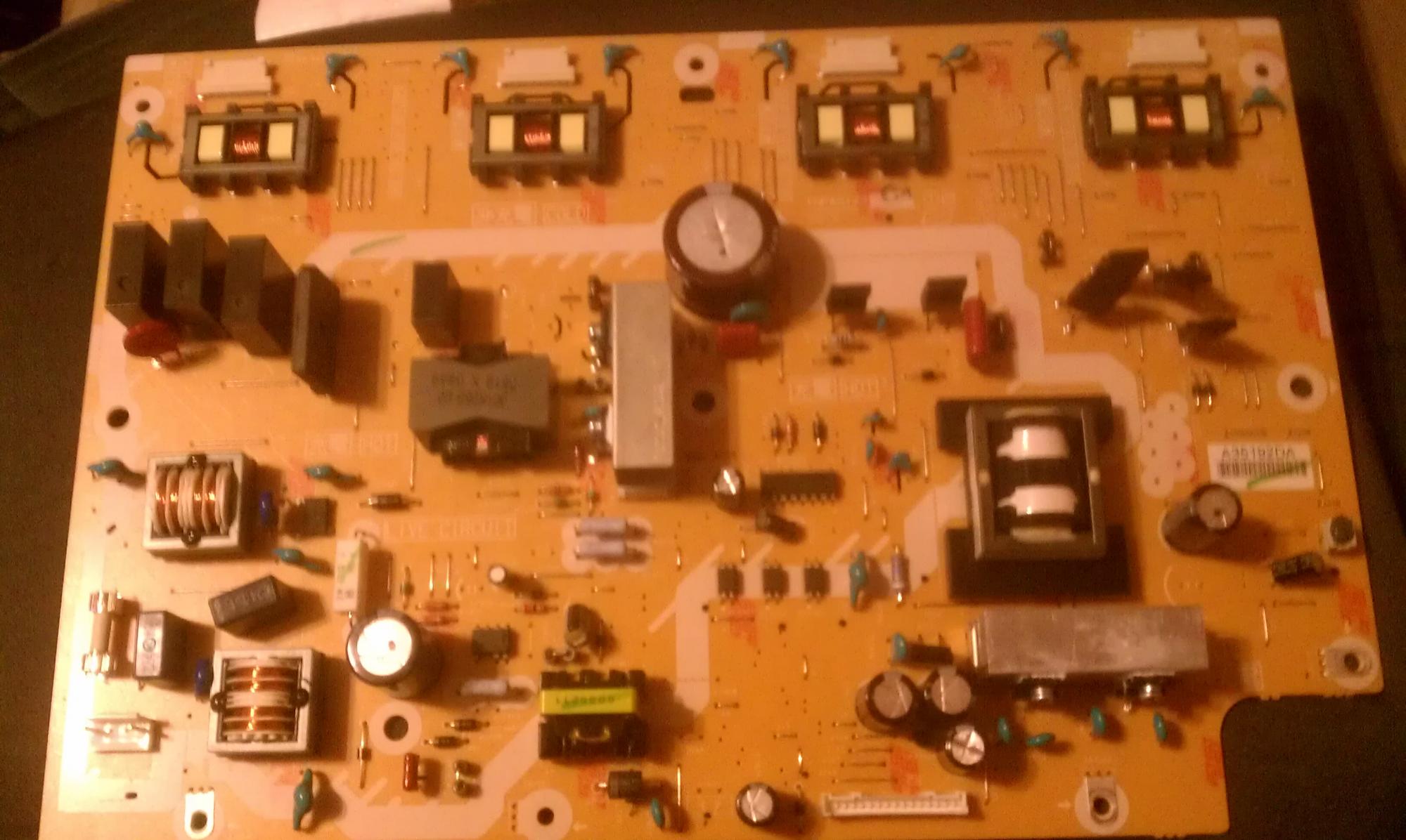

            OK - let us start again. Get the power board and the main board you used when it briefly started up and post a good clear in focus picture of each side of each board.
              Here are some more pictures
              Thank you

                  was trying to upload the entire pdf of the tech guide but for some reason i'm getting fail to upload So here's this hope it helps

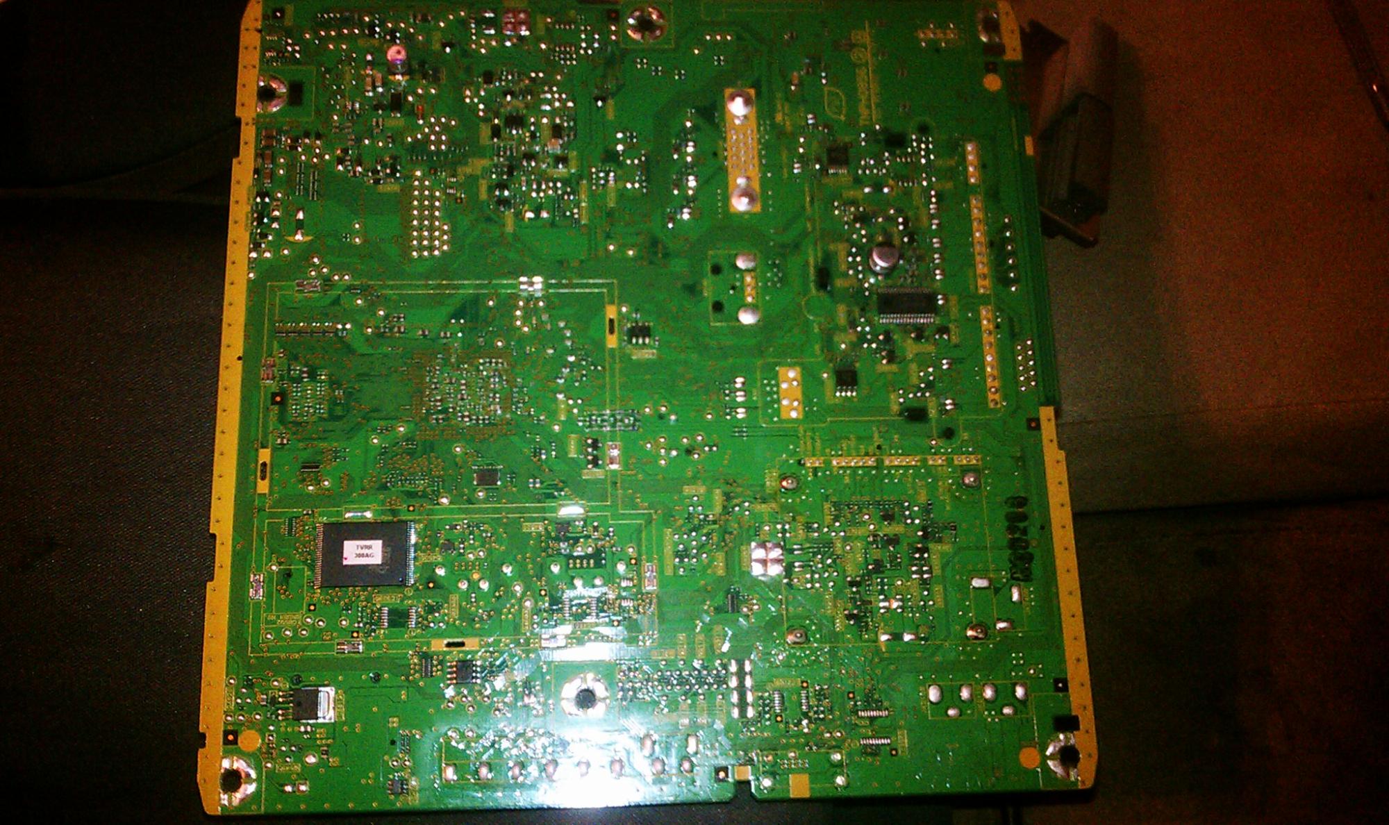

                      I am sorry I am not even going to try and look at them again - please can you look and enlarge them and tell me if you can make anything out of the blur. If you can then I am off to the opticians tomorrow.
                        #31
                        Here are some more

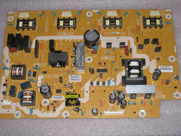

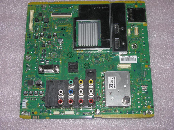

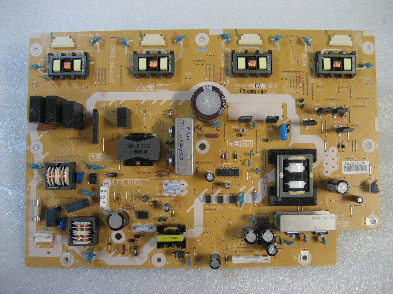

                              Right - First problem - according to the SM there are 4 fuses The main one is F7001 and I can find that cos I know where it should be. The others F801 F802 - not sure why they have 3 numbers not 4 I cant see - on another board?
                              and F7801 looks like it should be on this board but although the pics are better I cant see it - can you?
                                #35
