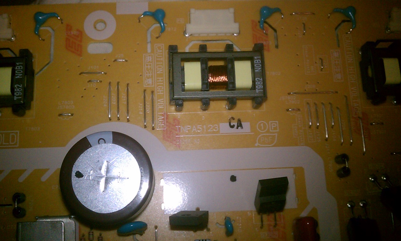

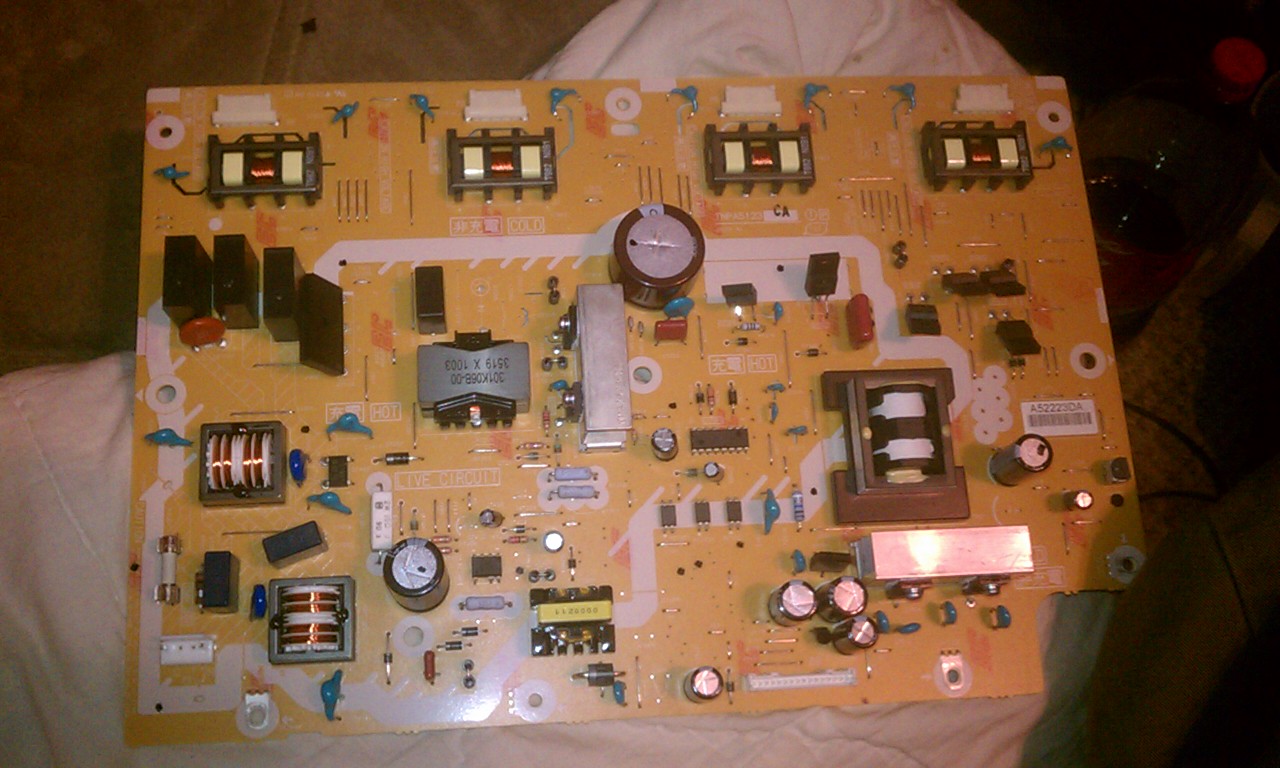

    Re: Panasonic tc-l32c22 lcd
    Here are some pics
    Any help please
    Thank you much

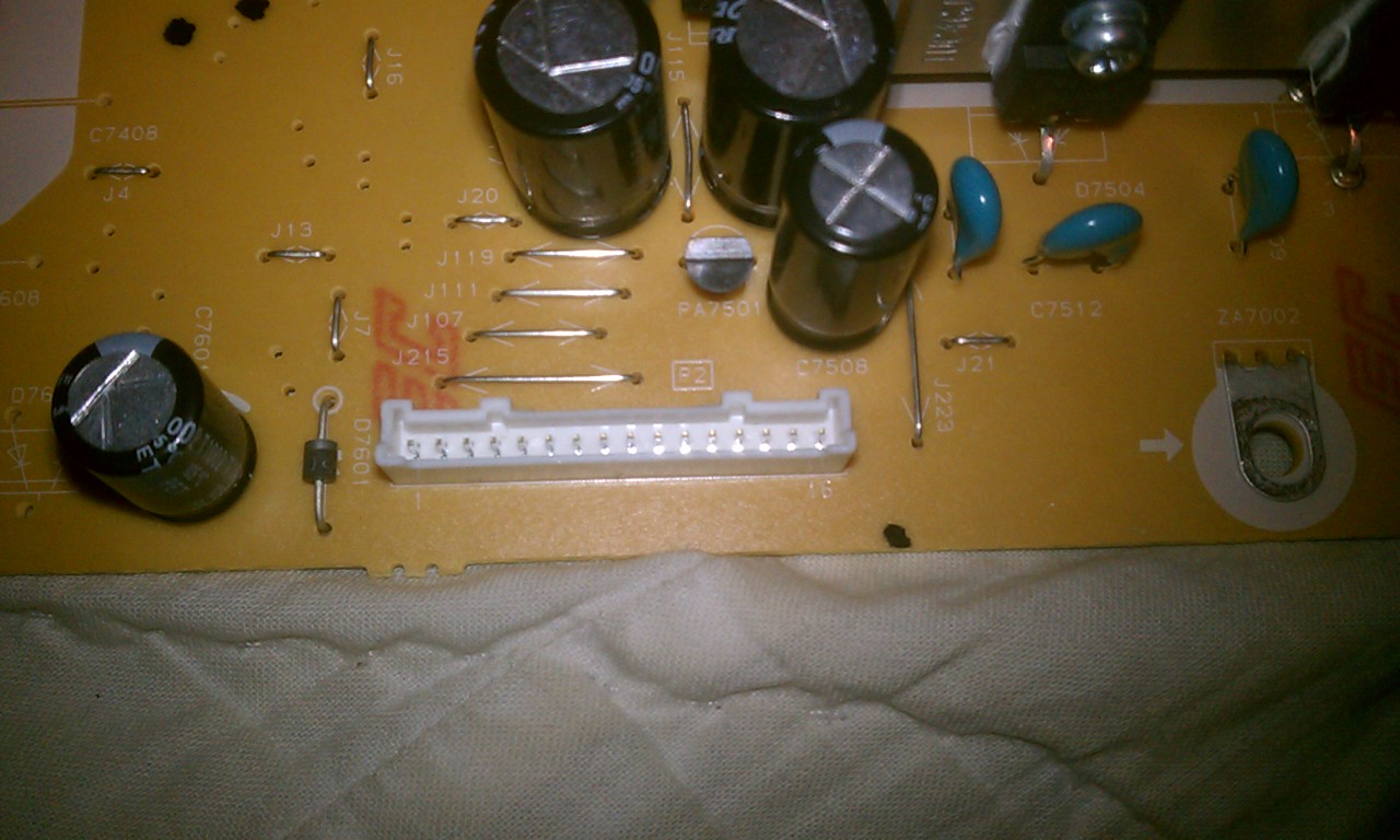

      Here are the voltages from the output connector
      1= 6.36
      2= 6.36
      3= 0
      4= 0
      5=0
      6=0
      7=0
      8=0
      9=0
      10=0
      11=0
      12=0.57
      13=0
      14=0.75
      15=0
      16=0
      This Forum absolutely the best and, the most helpful forum I have ever found anywhere. thanks to all the fantastic members here
      Help keep these from the landfills
      • electronicsurplus
        • Jun 2012
        • 210
        There is no markings on the connector. How can I determine which is the ps-on? any ideas how I can find ps-on or, to further test this set? Belongs to my neighbor and I would love to look like a hero to the kids. they would be very happy if their tv was fixed. they do not have much at all

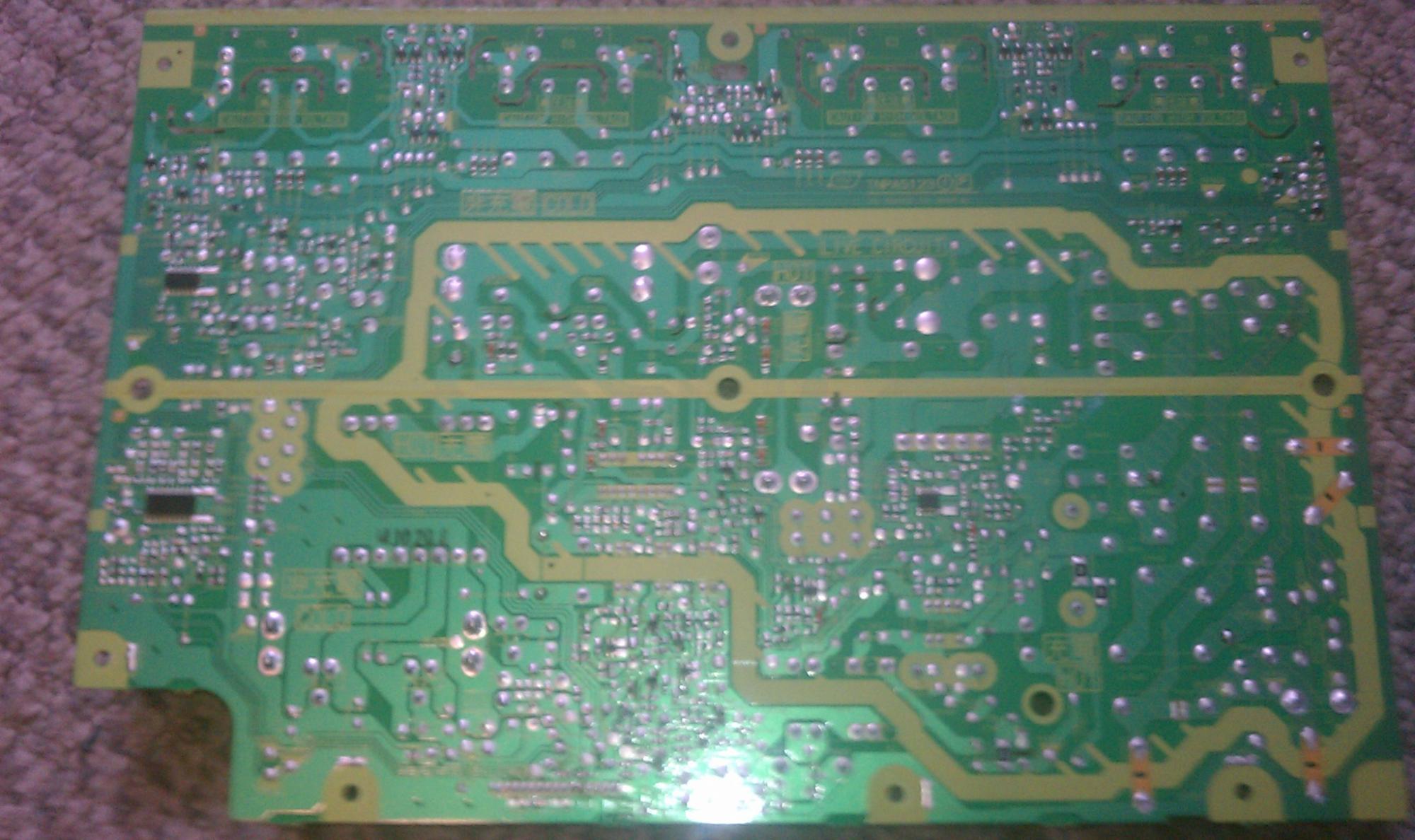

                  Okay post a shot of the green (under) side of the PSU PCB. Clear, detailed, and close as possible to 2000x2000 pixels but not exceeding. If necessary, break it down into multiple shots.
                  • electronicsurplus
                    • Jun 2012
                    • 210

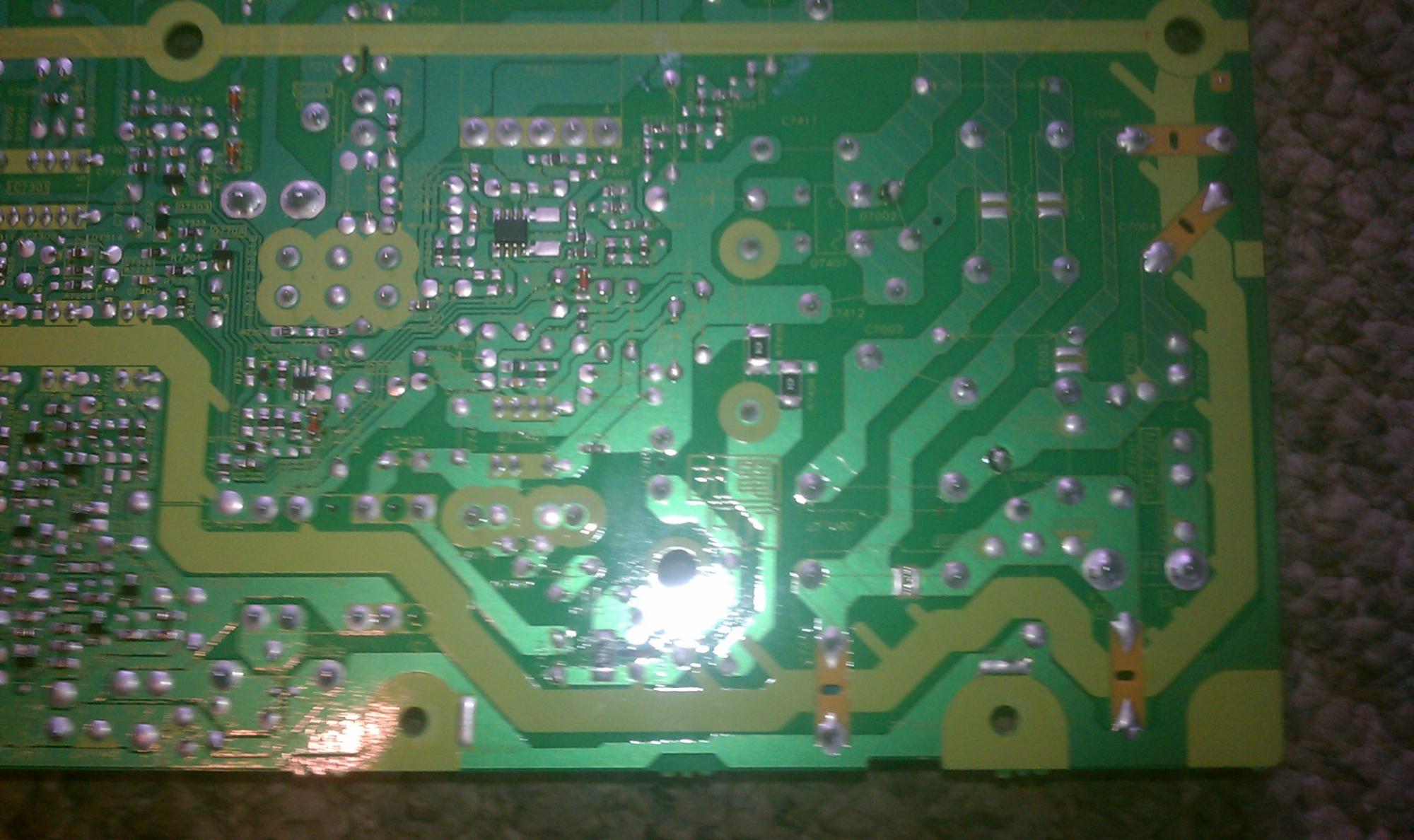

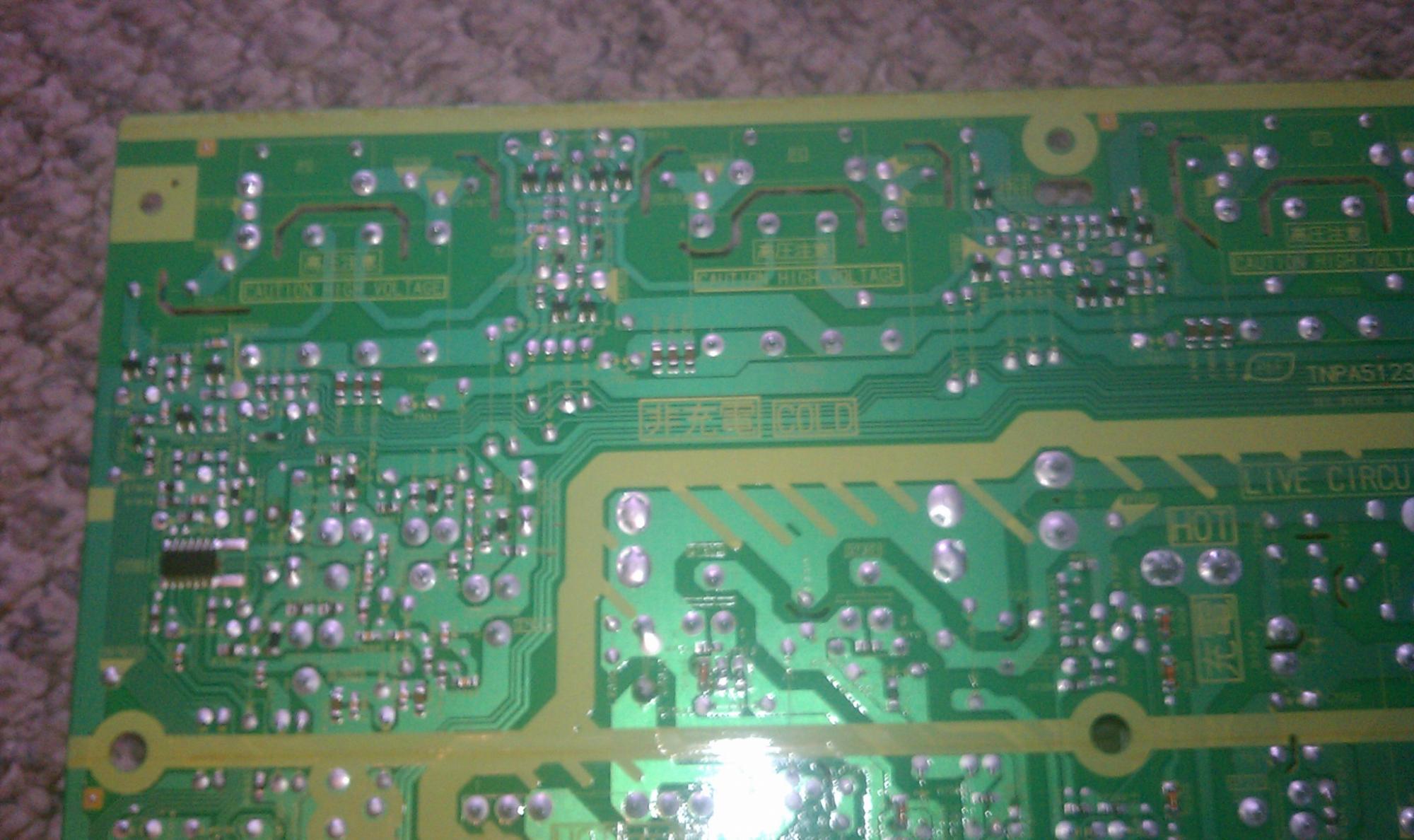

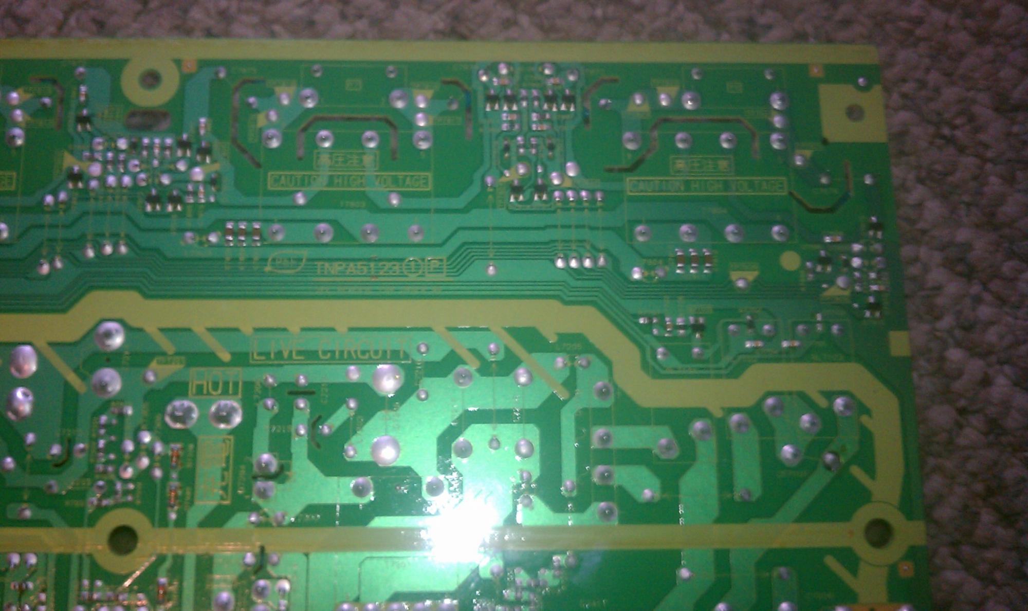

                    Ok
                    1 of the entire board and, 4 of the 4 corners starting with top left, top right, bottom eft and bottom right
                    Jon

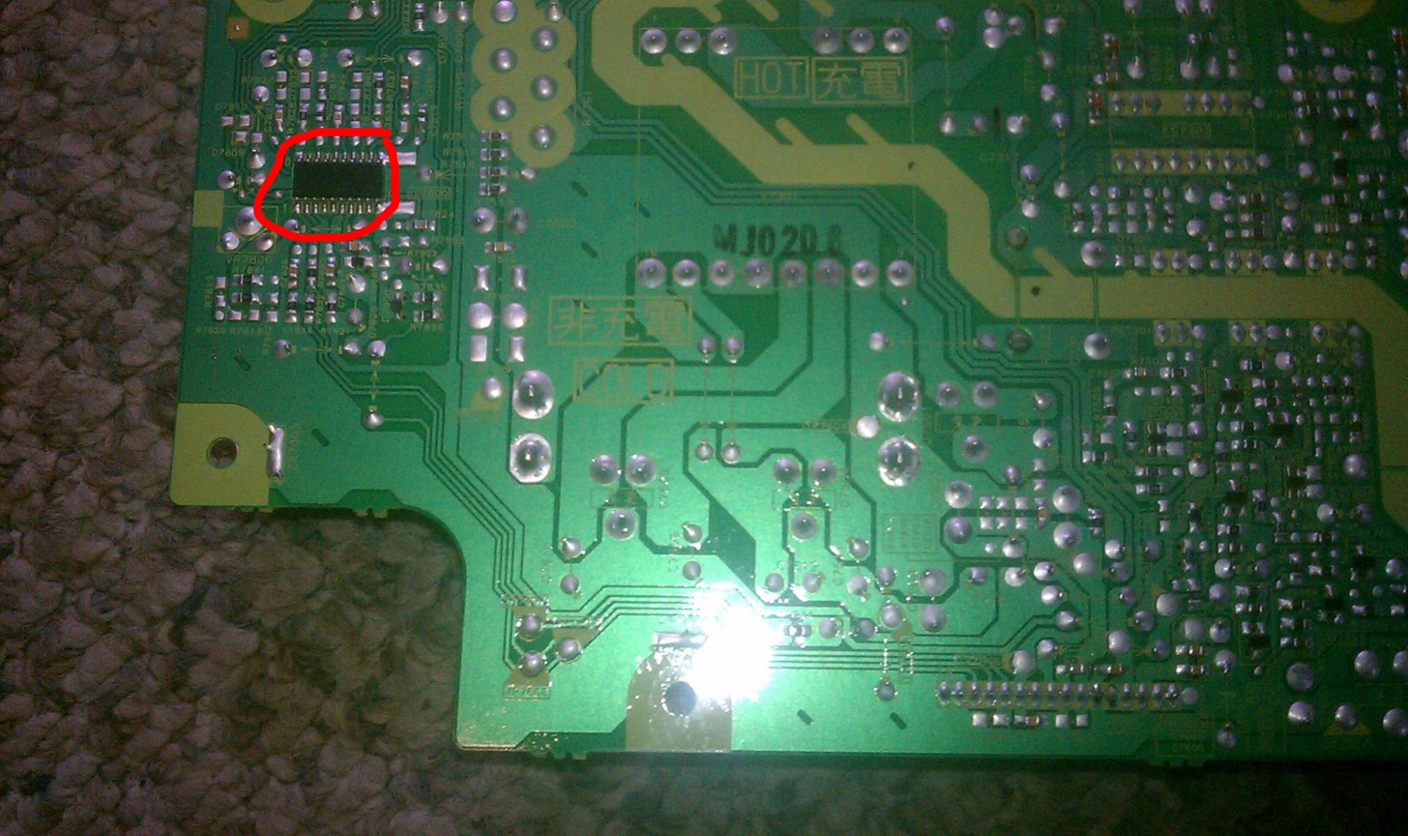

                      Thanks for the pics. What's the part # on this device?
                      • electronicsurplus
                        • Jun 2012
                        • 210
                        The Power supply is TNPA5123 CA , The television is TC-L32C22
                          What about on the highlighted device? I'll try to find schematics.
                          • electronicsurplus
                            • Jun 2012
                            • 210
                            The highlighted device is the TV model #
                            Panasonic tc-l32c22
                            • selldoor
                              Slow Learner
                              • Dec 2010
                              • 7870
                              Tom means the number that hopefully is on the IC with 20 legs that is ringed in red on the picture. You may need a magnifying glass and try rubbing it gently with isopropyl alcohol.
                              If it is the same as the tv number I apologise.
                                On the P2 Power board connector, the TV_SUB_ON (Power on from micro) is on pin 9, the Inverter On is pin 13. First, pin 9 should go to >3v to turn supply on, followed by the Inverter On pin.
                                • randtek
                                  • Oct 2011
                                  • 280
                                  • US
                                  By the way, are you getting any blink codes on the Power LED? Or is the unit completely dead.

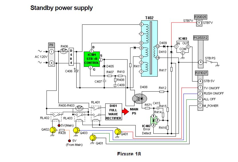

                                      Attached are for OP unable to send by PM
                                      • electronicsurplus
                                        • Jun 2012
                                        • 210
                                        So, correct me if i am wrong. It looks as though the 115V goes to the fuse and then to the Rectifier, then to the 5V standby transistor so, if no 5V I should look to this transistor
                                        I think i will find a properly working power supply to determine
                                        I apologize IF i seem dumb but, I obviously am. I must be skipping some chapter or something because, I am surely missing something here
                                        Thank you for your help in trying
                                        I guess I will just need to study more to hopefully someday understand
                                        Jon
