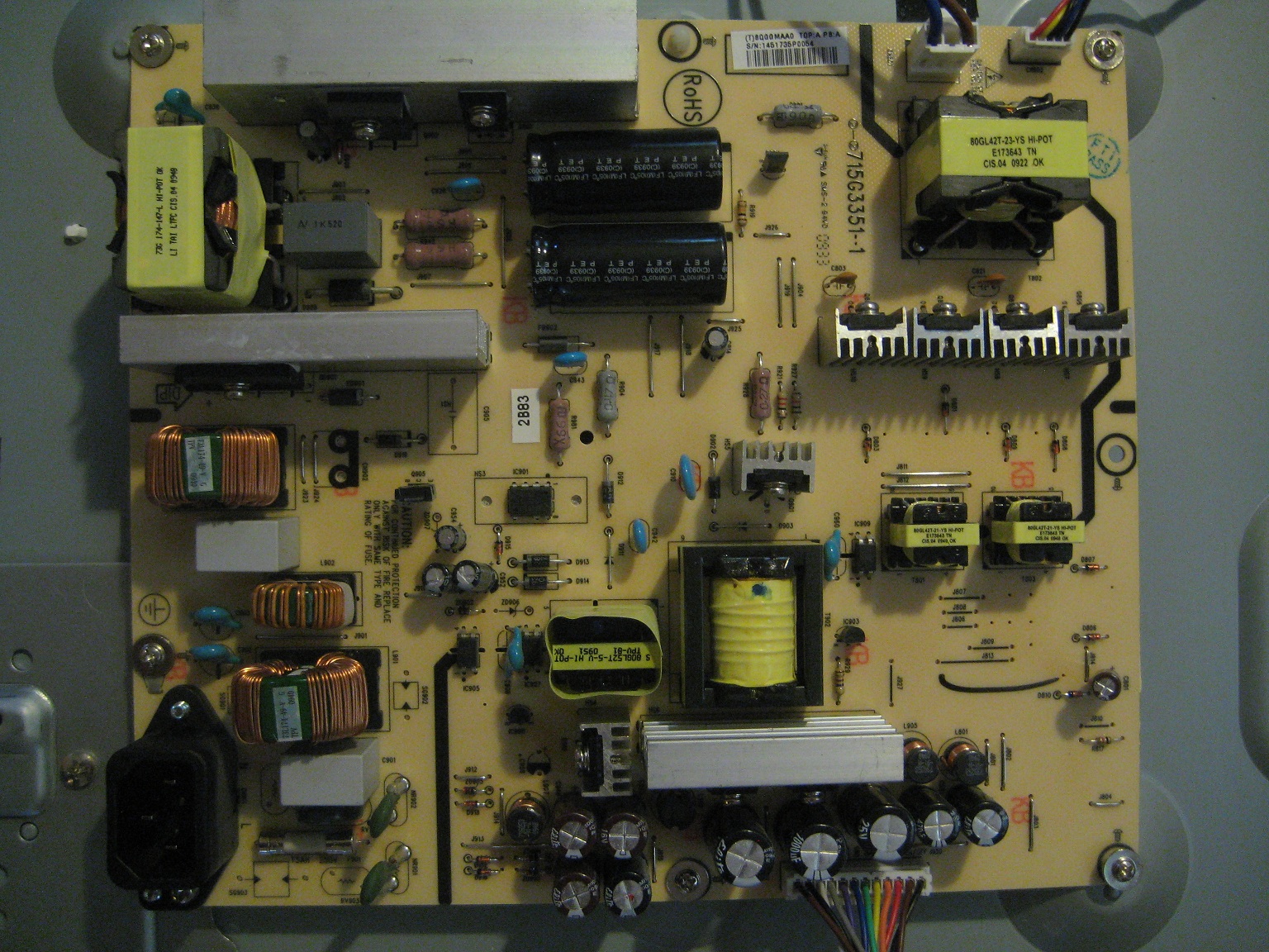

The latest mini-head scratcher for my week is the unit described in the title.
The TV turns on, blacklight kicks on, but no picture. Sound works. Typical problem.
My reservations - no blown capacitors, that I can see. And there's plenty of them. Previous owner stated the "video card" was dead. I could believe that... though I also know I've fixed LCDs with the same problem that had bad caps in the PSU, not the logic board.
Is there a good first stop for testing? Front (or side) buttons connect to the mainboard.
I'd post pictures but there isn't much to see unless one wants them for reference. No scorch marks, no popped caps, nothing out of the ordinary. I scoured over it pretty well, I thought. I will at first request.

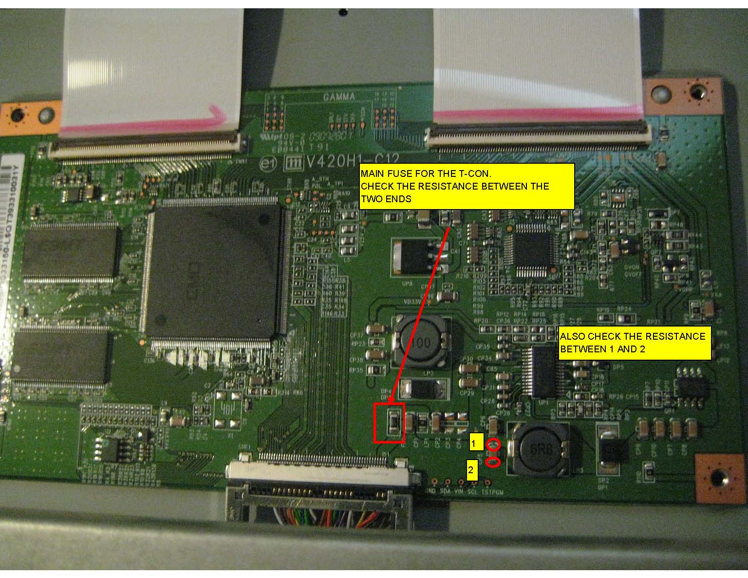

- I hope its just the fuse. If not can you do pics of the long inverter board either in 2 or 3 shots.
