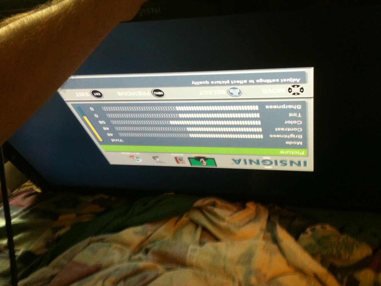

                                Re: Insignia NS L42Q 10A
                                "When you say the back light comes on does it stay on so you have a totally white screen?"
                                Selldoor, I'm waiting for pictures, but I believe I have this model tv that is turning on, but with a very bright white screen. Apparently, you can still see the picture on the tv, but with a very bright white screen and limited color. Any thoughts?
                                  #56
                                  @playa: It sounds like bad GAMMA Voltage problem on the T-CON board, will need to see the screen shot and the pictures of the T-CON board.
                                  If this is your T-CON board, then more thane likely to have bad GAMMA V ref IC AS15.

                                    @budm Thanks! Unfortunately, you lost me on the "more thane likely to have bad GAMMA V ref IC AS15". lol I don't know anything about these things. I'm curious if this problem is a simple fix (ie. maybe just needing to swap a board). Not sure if I'll be able to get access to the board (the tv isn't mine, at least not yet). I should be able to get you a picture of the screen, though. If all I need to do is swap the T-Con board, is that basically just a plug and play (just the 3 ribbons)?
                                      #58
                                      "If all I need to do is swap the T-Con board, is that basically just a plug and play (just the 3 ribbons)?" Yes.
