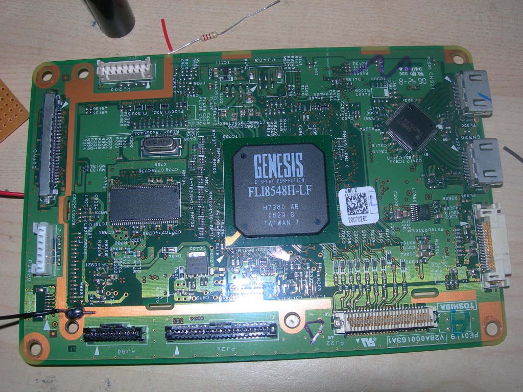

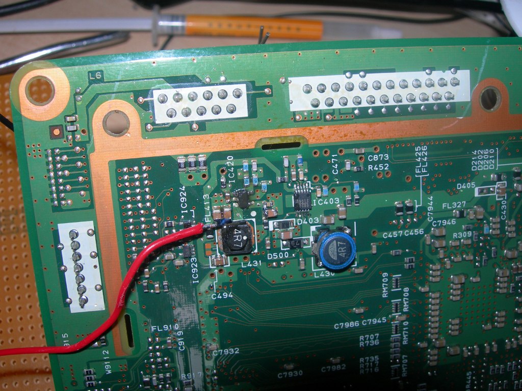

      Yeah, I just tested the 2.5V output (at the switcher), measures 2mV, so it's looking like that's the fault.
      I'll see if I can bodge in the LM317T shortly.
        Re: Toshiba 32WLT66S - No power (completely dead)

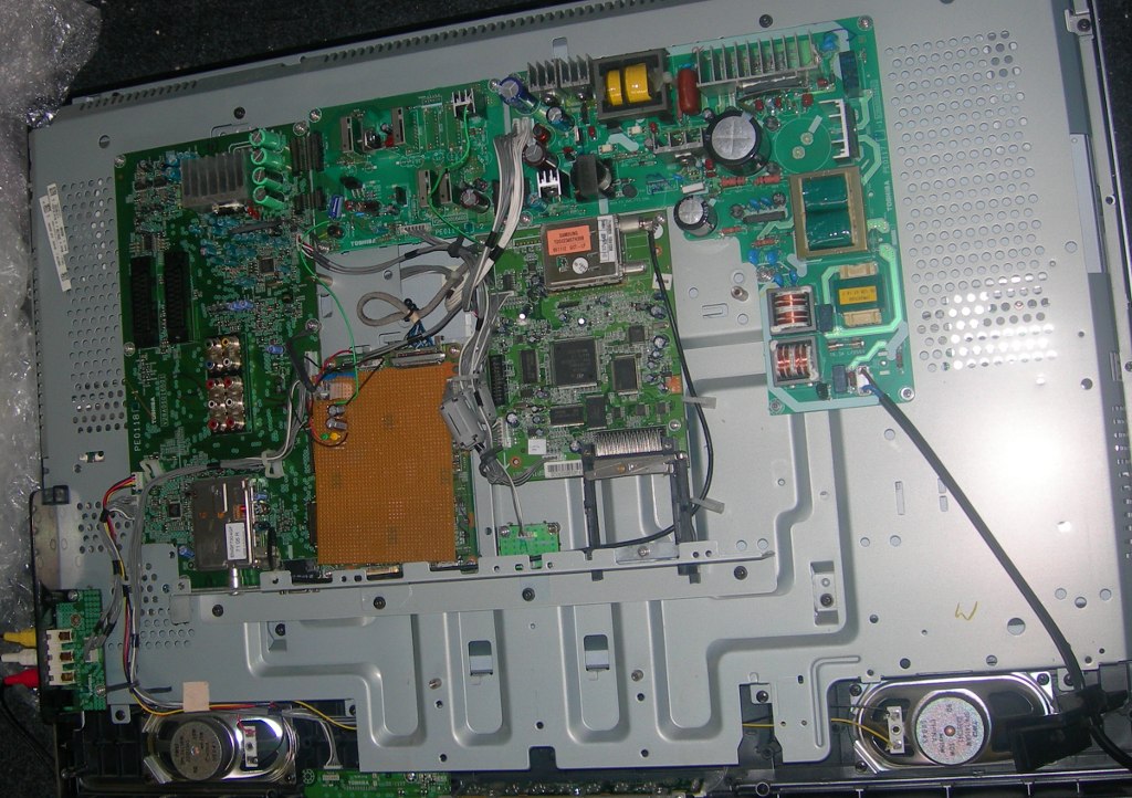

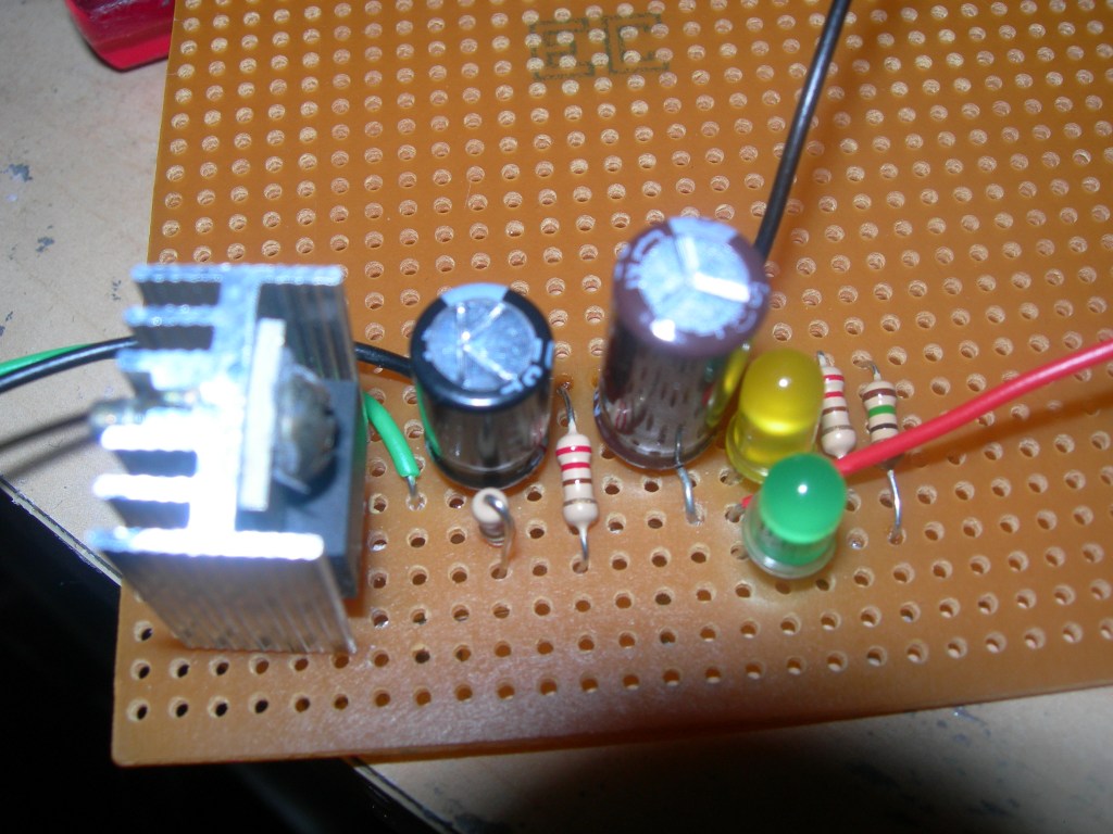

        I built a little +2.5V regulator on stripboard using an LM317T, heatsink, a few caps and LEDs to indicate input and output (for debugging.) The board takes 4.5V to 30V in, I'll probably wire it to the 5V2 (switched 5V) line.
        I've disabled the switch node of the switcher so it can't short to ground and I've wired it into where it should go. I've tied a ground close to the board to minimise noise or the chance of a ground loop. I need to cut the board to fit and find somewhere to put it if this works.

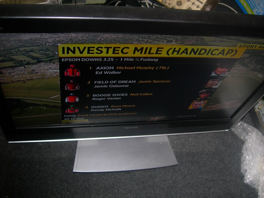

            ^It works .
            Another one fixed.
            REALLY obscure fault there. Surprised it didn't have an LED fault indicator as it would have been one of the checks ("Talk to Genesis display processor") or something.
            Still need to do a burn in test - the LM317 doesn't get very warm so I think this is a permanent solution.

                                        I still need to cut the board down and fix it properly in, then fully assemble it - but it looks like it will be ready soon.
