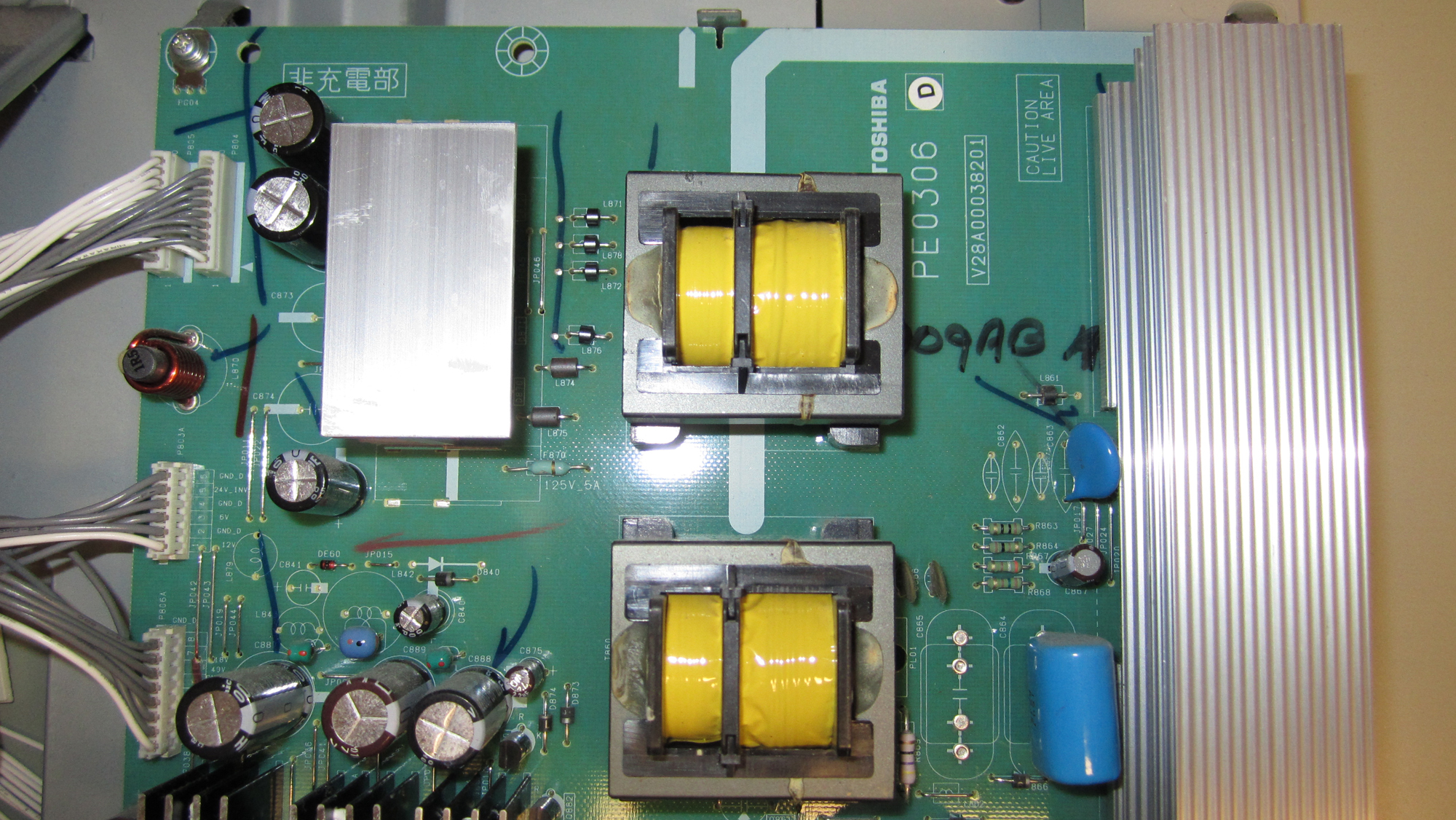

    I am working on Toshiba 42" LCD. The the was hit by lightning. I tested the main fuse right as the 120v comes into the tv and it is good and is passing voltage.
    I also checked all the diodes on the power supply and they all seem good. I tested a few resistors on power supply as well and they seem good.
    So, what should I look for or check next? I was reading some other post about sets that get by lighting and few mention testing 5v line and standby 5v....if this is the case, can someone explain how to do this?!?! Thanks
    I have no led light coming on the front at all.

      I am not sure how well you know about testing the voltages on the primary side of the power supply, if you do know enough, then check and see if you do have 120Vac at the two inner pins of the bridge rectifier mounted on the small heat sink.
      You should remove the pictures and use the attachment to up load the pictures instead, a lot of people may not want to reply or look at the=is post due to the way the pictures are being displayed.

                      awyatt2, the TV does have main and sub power supply boards, so he should look to see if he as AC at the main rectifier bridge, and also see if he as any DC on those two large electrolytic caps and check all the fuses. The pictures do not look very clear, they have really high contrast looking pictures so it is really hard to see what are on the boards.

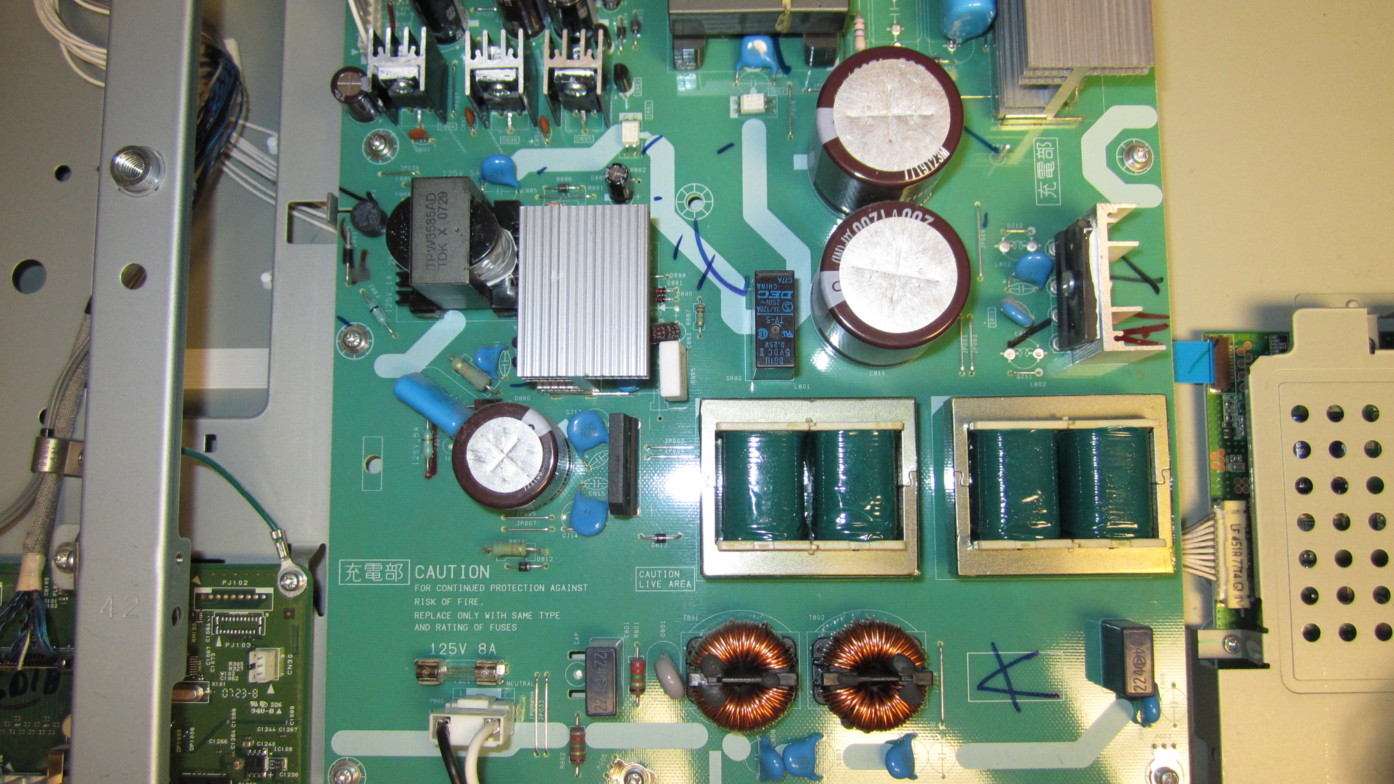

                        check f882,f884,f885,f870. then check the bridge and see if it is open they always dont go shorted. post back what you find.

                          Are there two bridges on the main power supply, one in on the heat sink (bottom of the picture), one is not on the heat sink (about top left of the picture).

                              good call bud, yes, i looked on shop jimmy one is non heatsinked and one is on a smaller heatsink

                                  Your Pictures are no use for troubleshooting they should look like this
                                  We can help a lot more if you please post good clear pictures of the whole chassis, and then pictures of each board, front and back and close up of connectors, (max resolution 2000x2000 and 2MB) using the manage attachments button, which is found by clicking "go advanced" under quick reply.

                                      Here is the best I could do giving better shots of the power supply board. I had to break it up in upper and lower pictures.

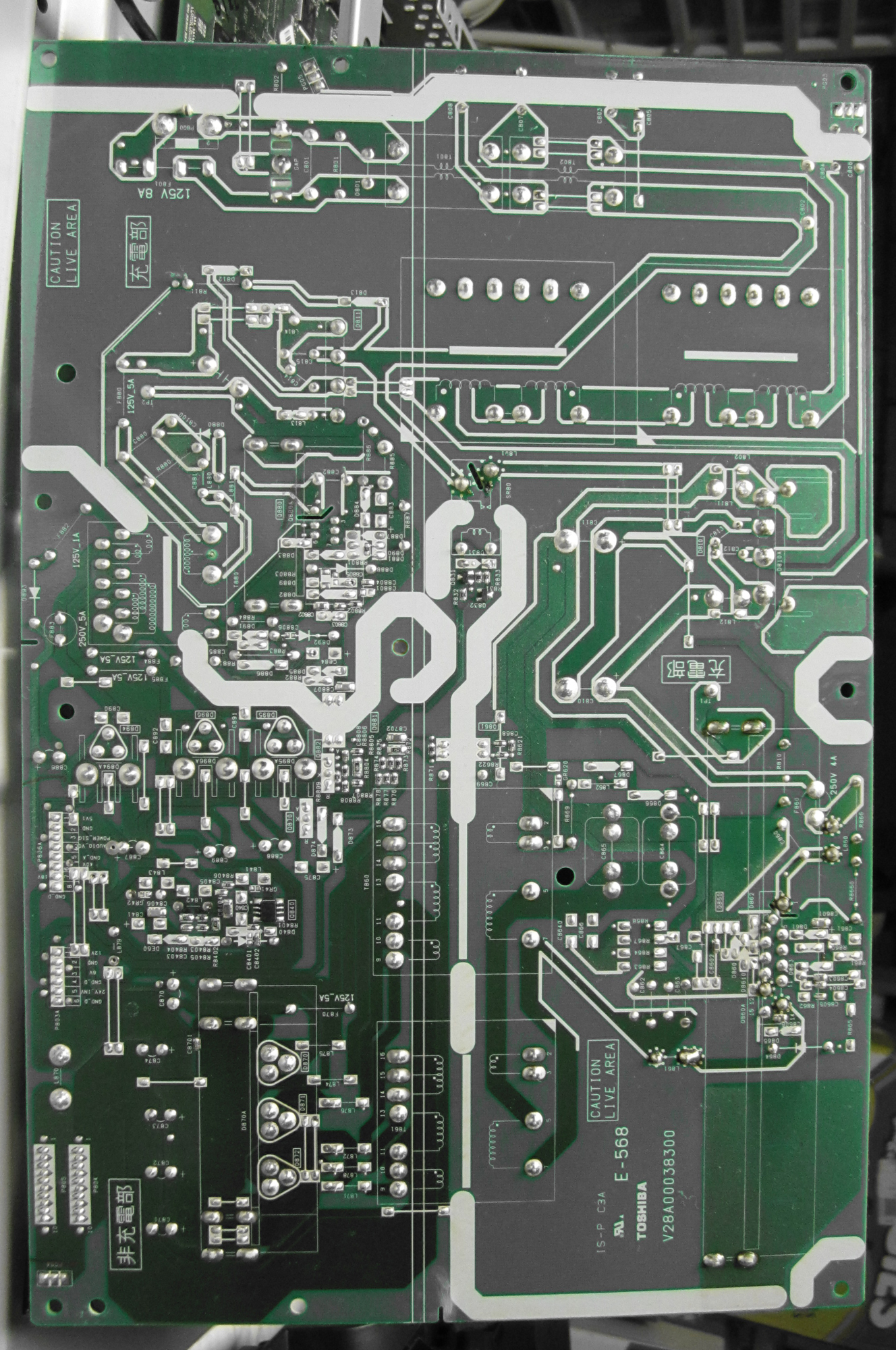

                                        Re: Toshiba 42HL67 LCD no power at all "hit by lightning"
                                        Back of the board...
