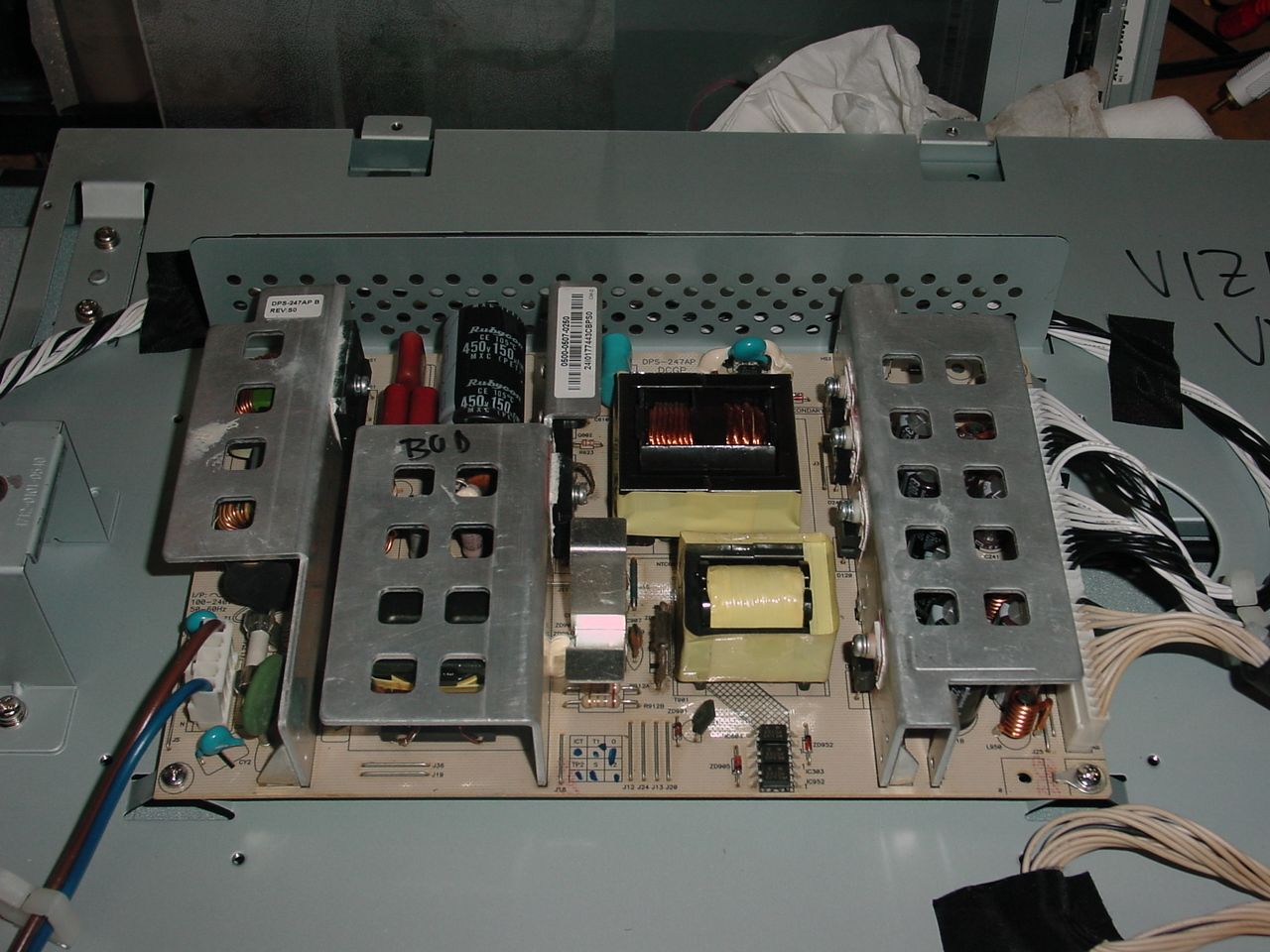

    Does you board look like this?
    http://s807.photobucket.com/albums/y...37L%20HDTV10A/
    Otherwise post the pictures of the boards using attachment upload.

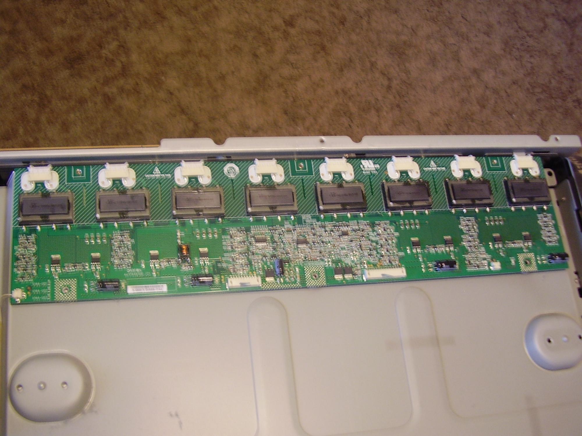

    Did you check the components on the two backlight inverter boards? Your 12/24/5v power supplies are wotking per your reading, so the problem can be the inverter boards, or it is not getting the Backlights on signal from the main board.

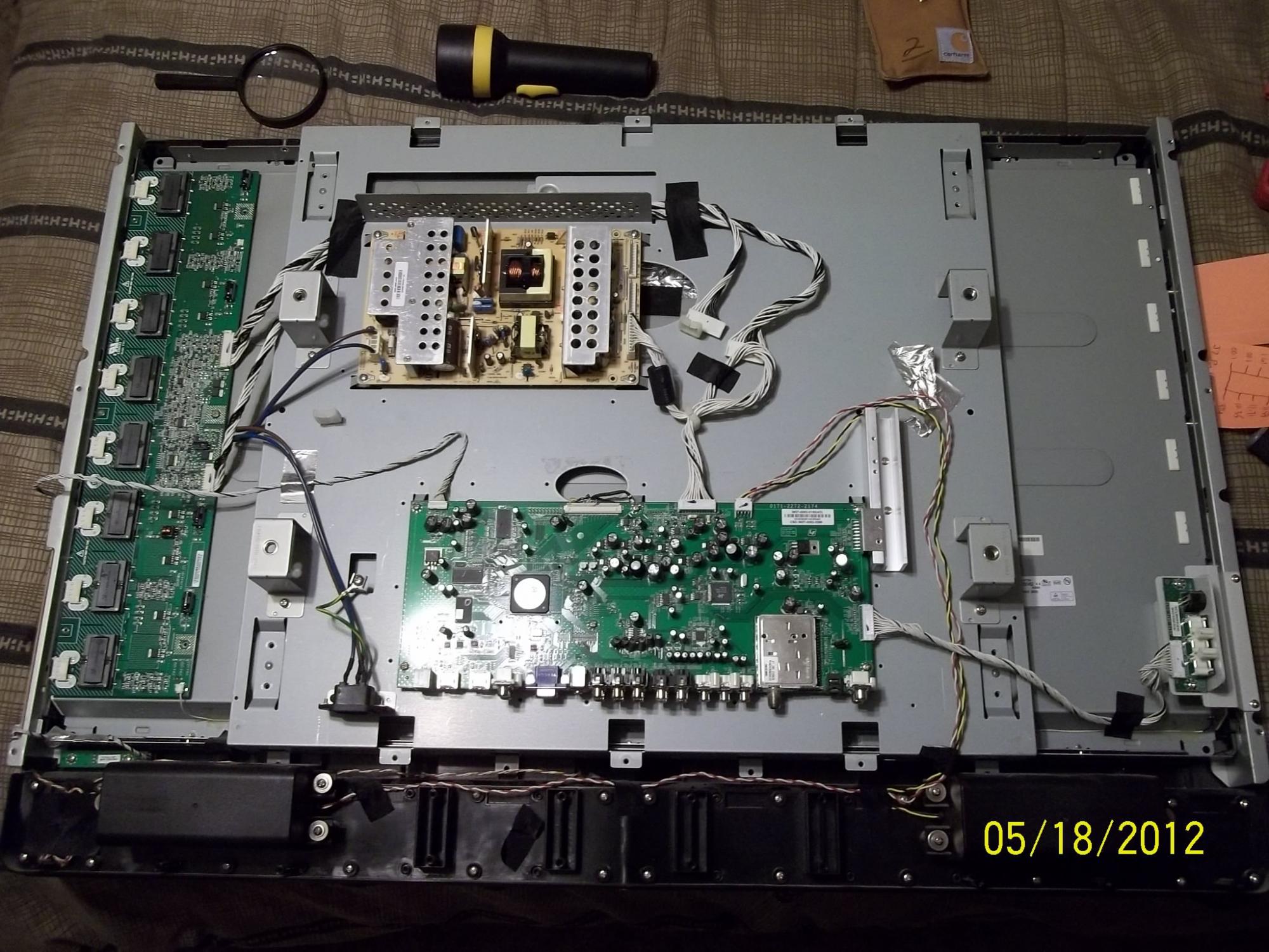

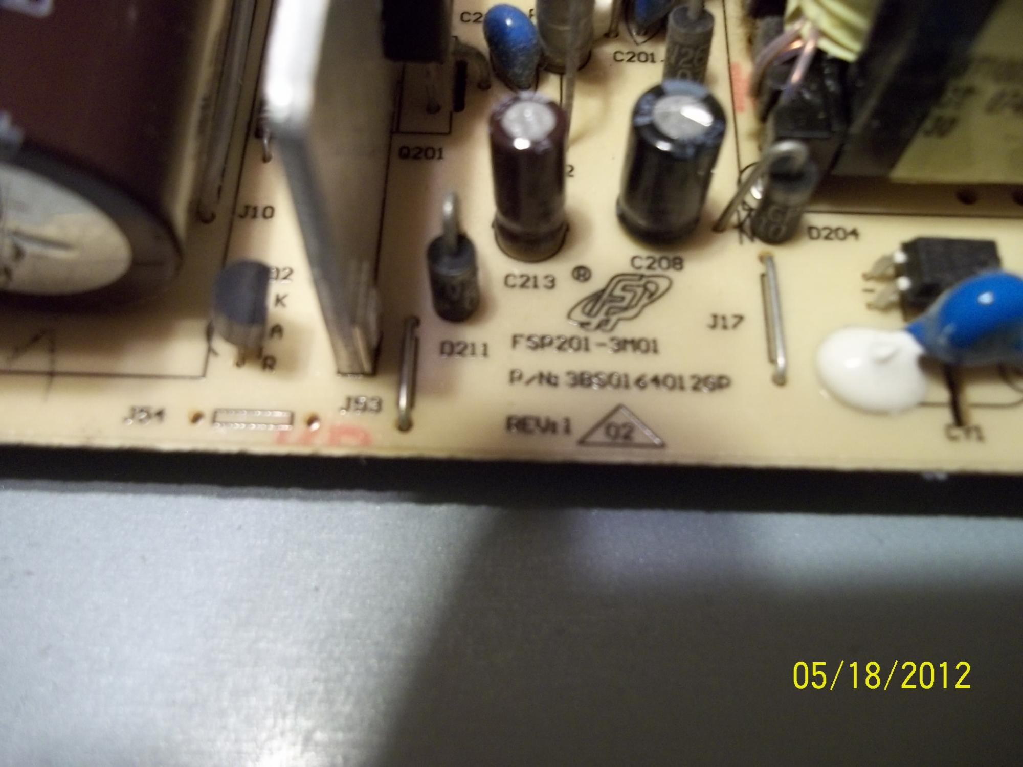

        I have the 1 inverted board on the left and the p/n on U7 is amc1117 f0734f and the 23.8 is correct and not a typo. Ok I can't figure out how to do pictures from my phone so I will have to get out the camera then put them on the laptop then go to the library to connect to the internet.

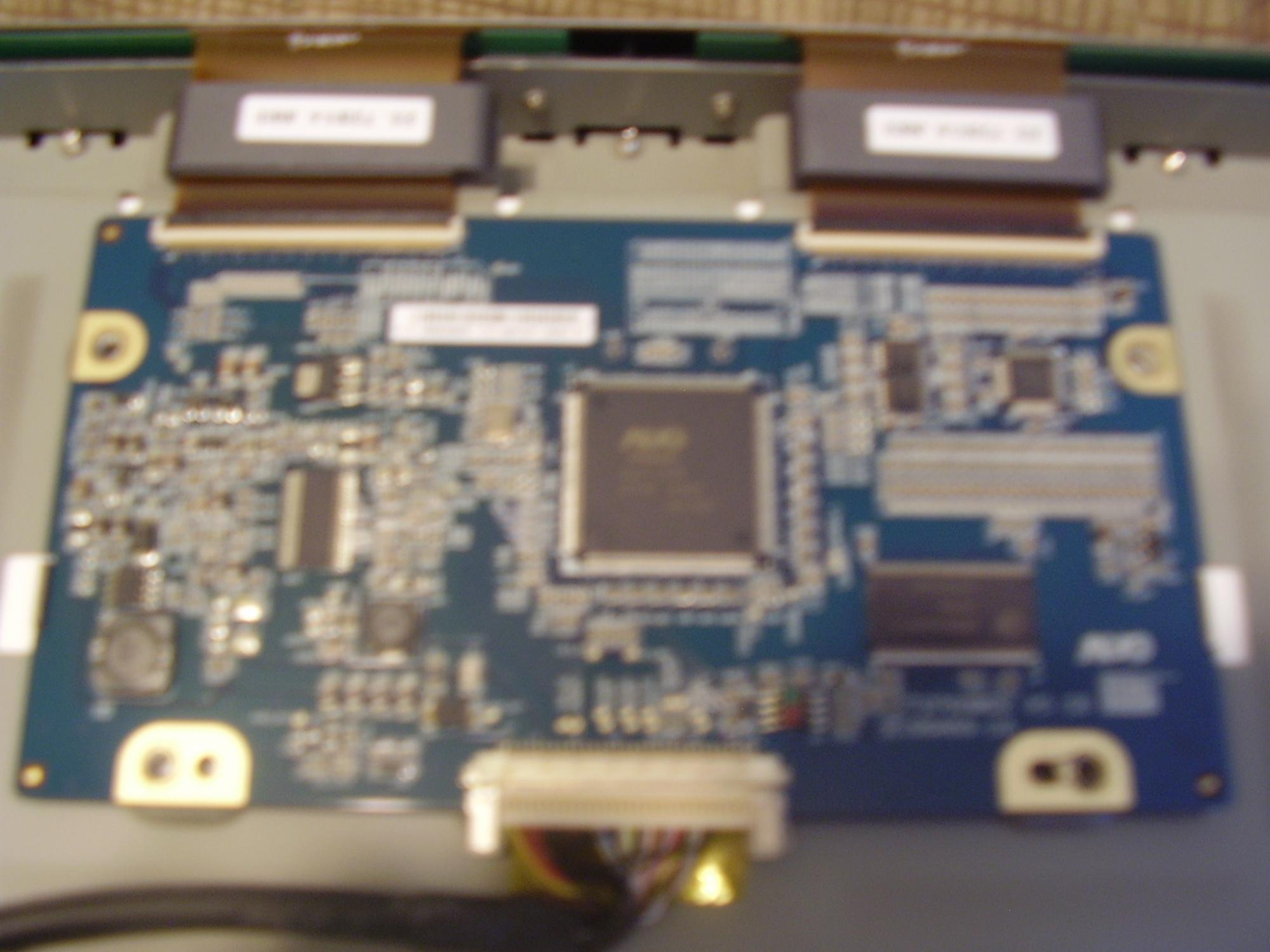

        • eagle00799
          • May 2012
          • 322
          Re: vx37l no picture no sound

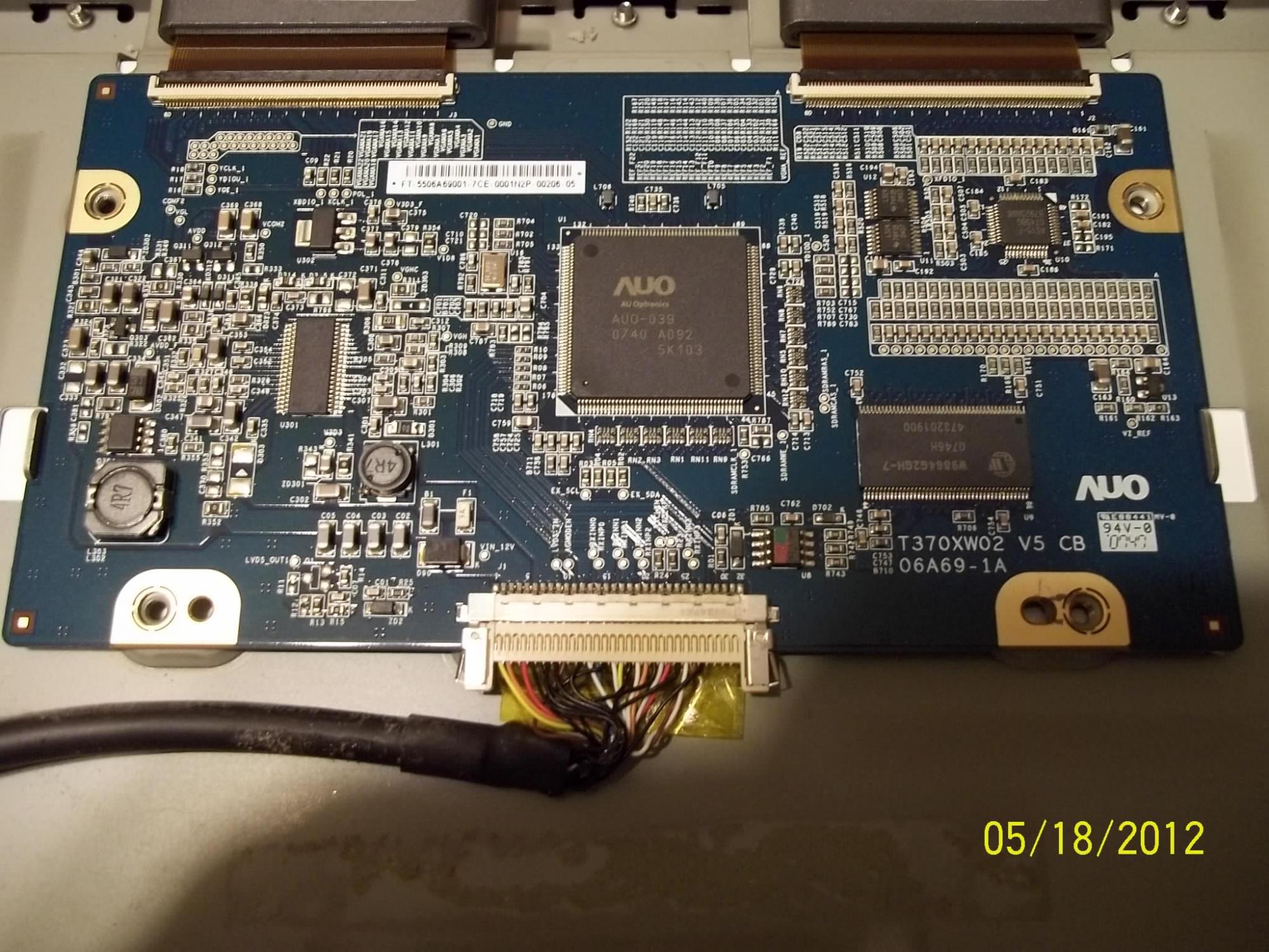

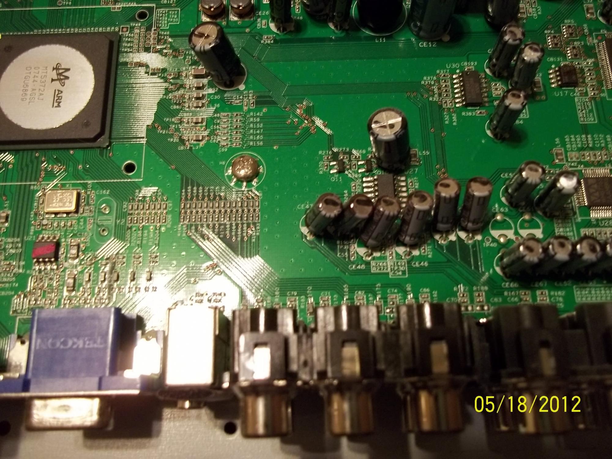

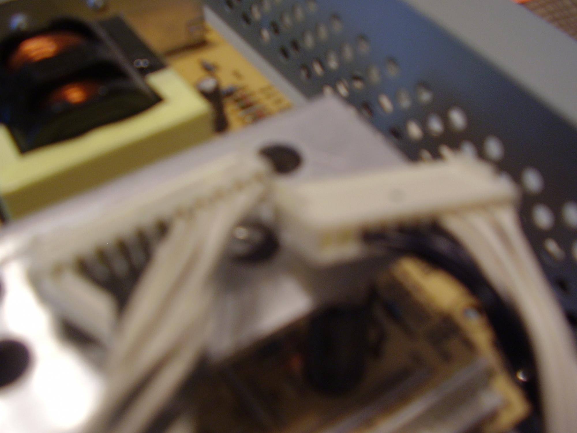

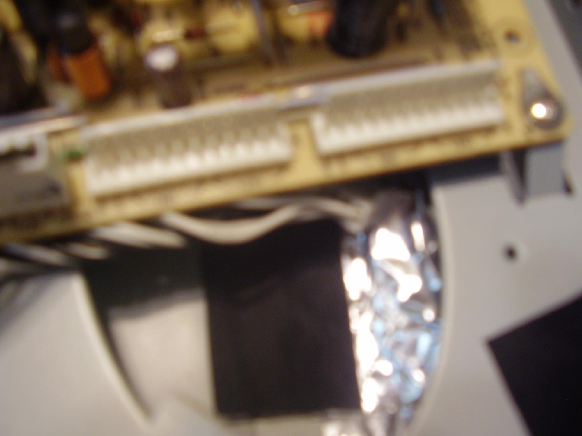

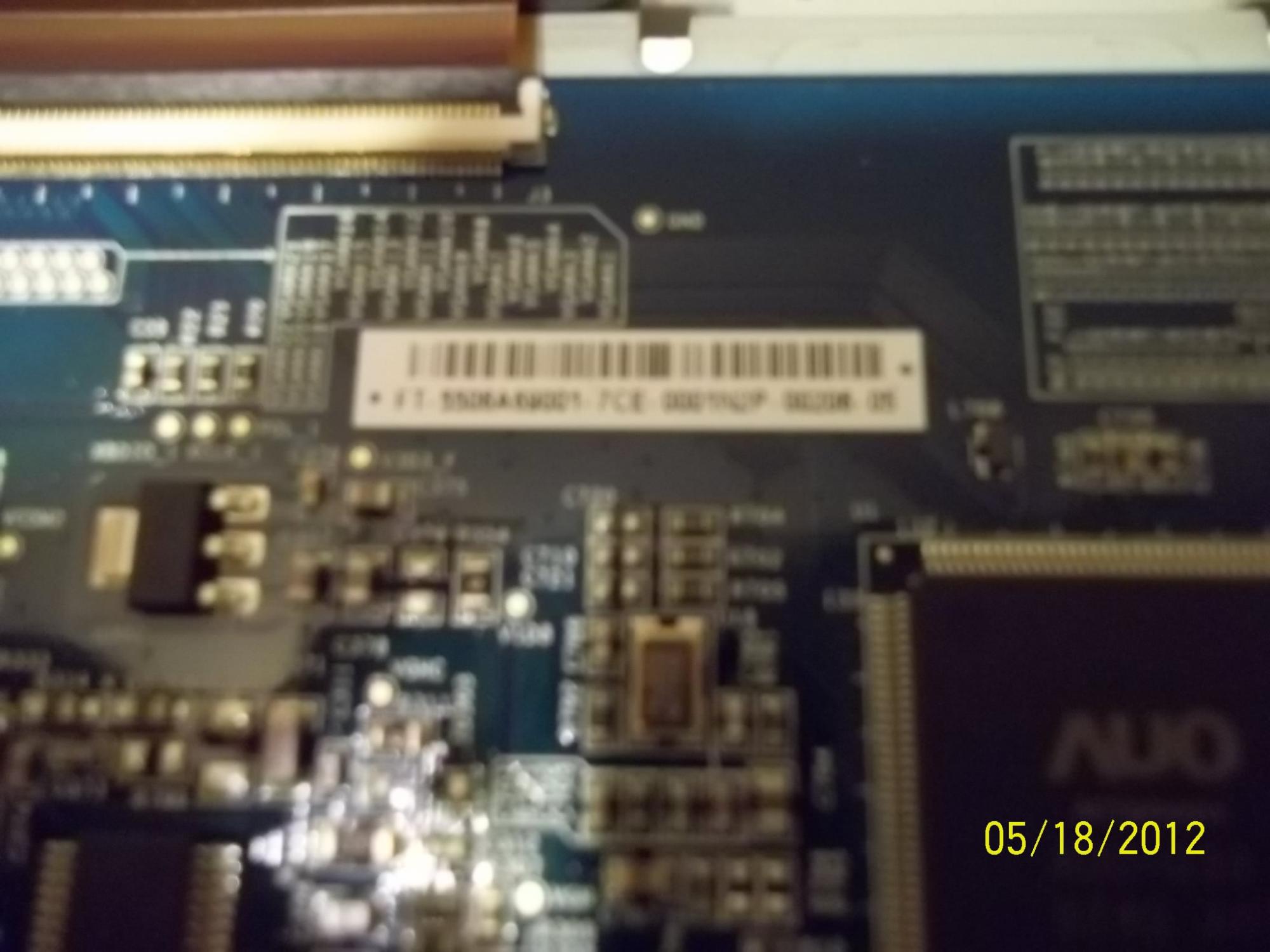

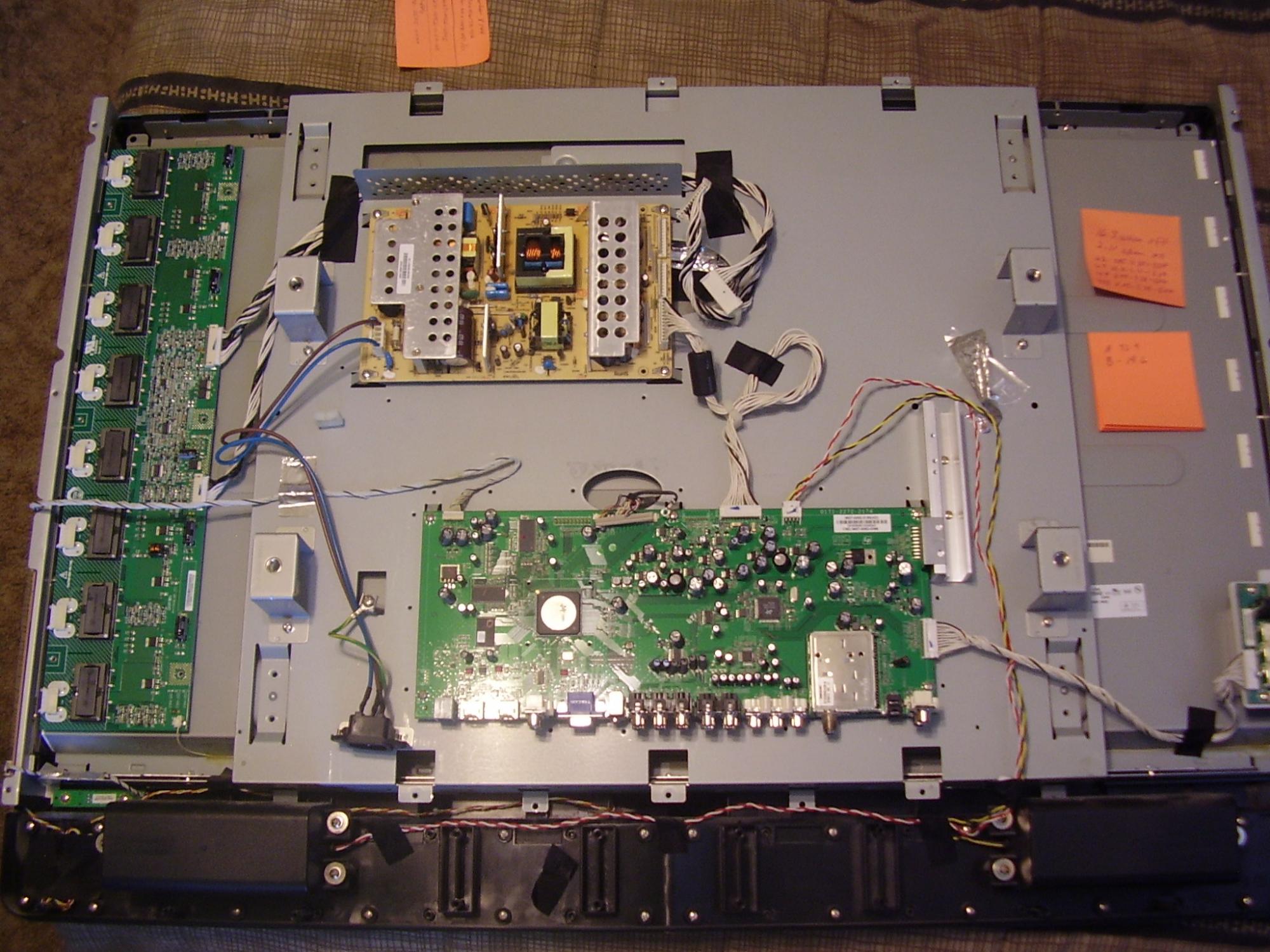

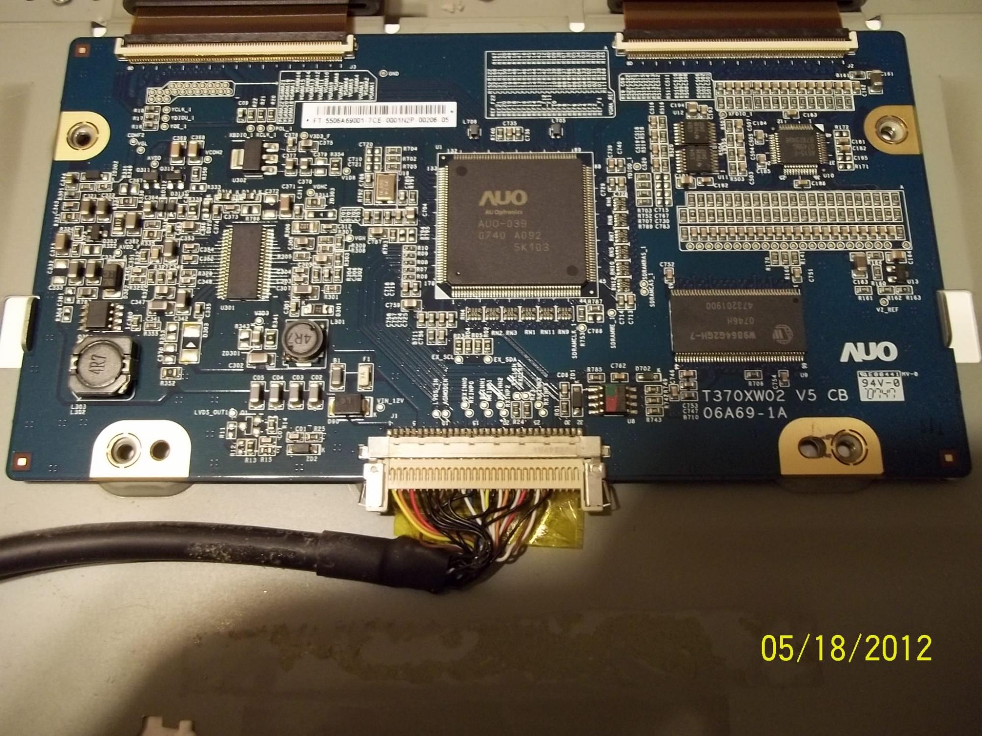

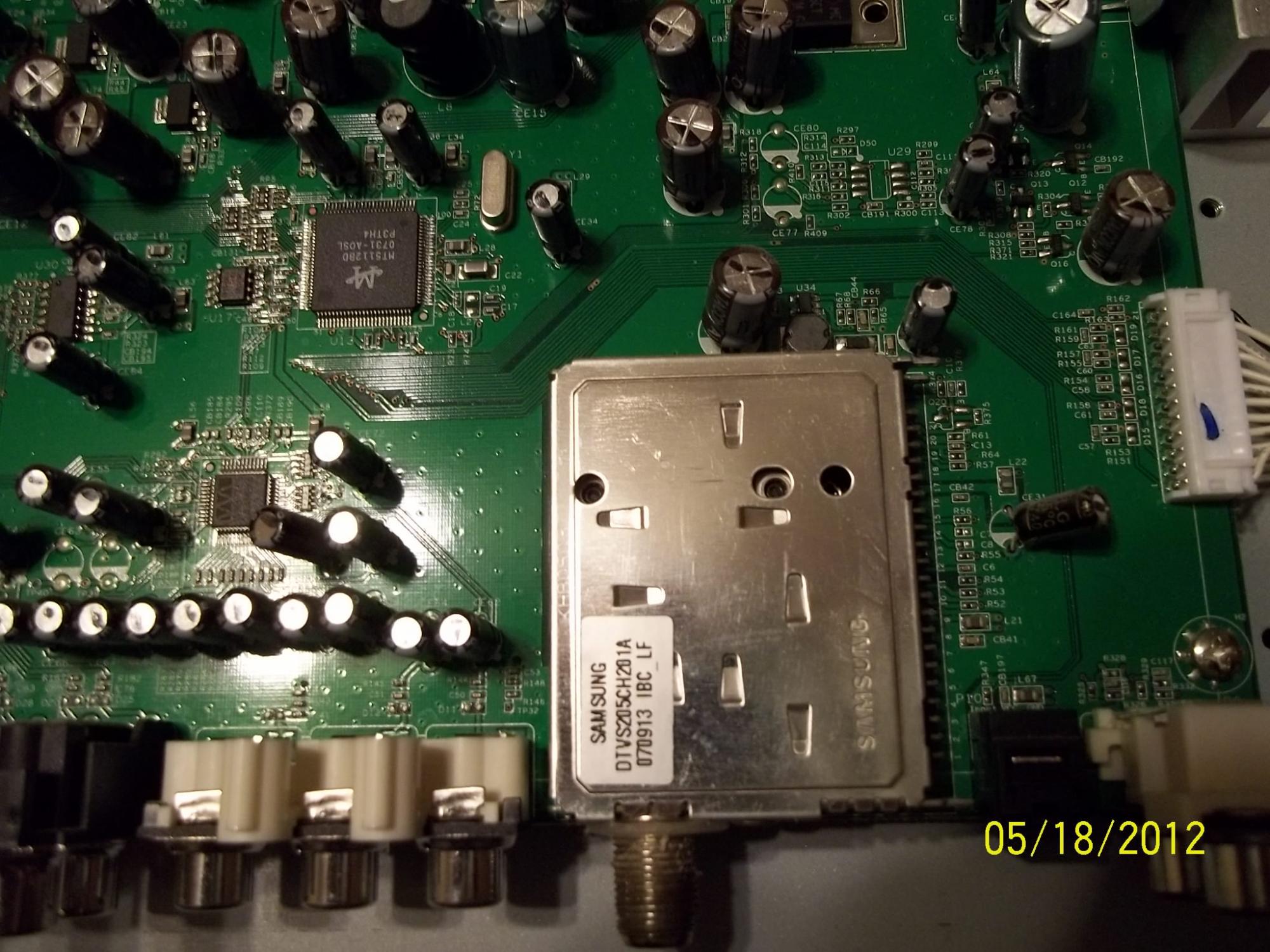

          Ok here are some pics of what i am working with,sorry they are not the best but hope they will work.
          • tibimakai
            • Jan 2012
            • 3680
            Those pictures are not good at all. You should be able to read the part numbers from those pictures.
            • eagle00799
              • May 2012
              • 322
              Your right Tibi and i will get a different camera and try again.

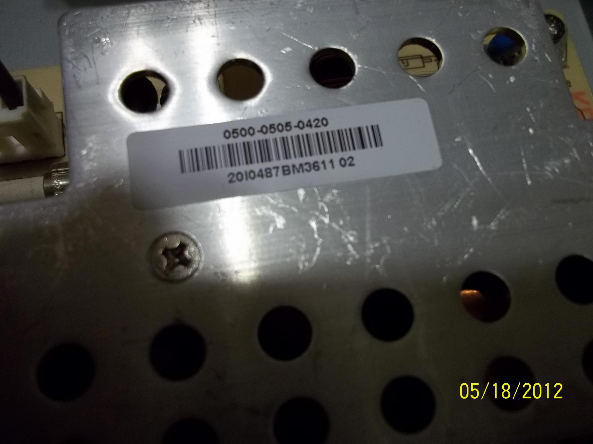

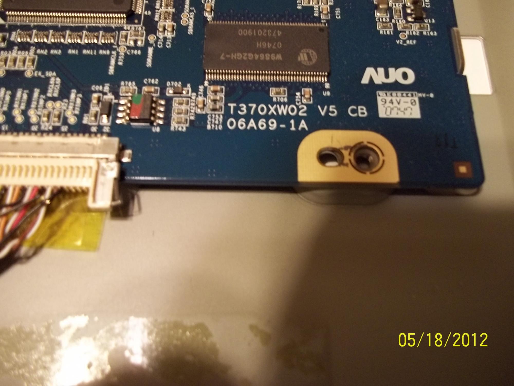

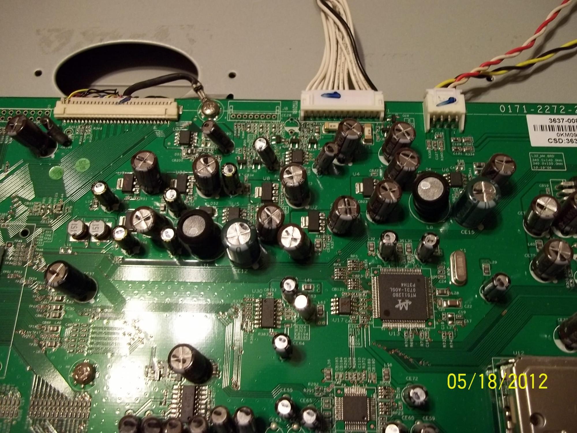

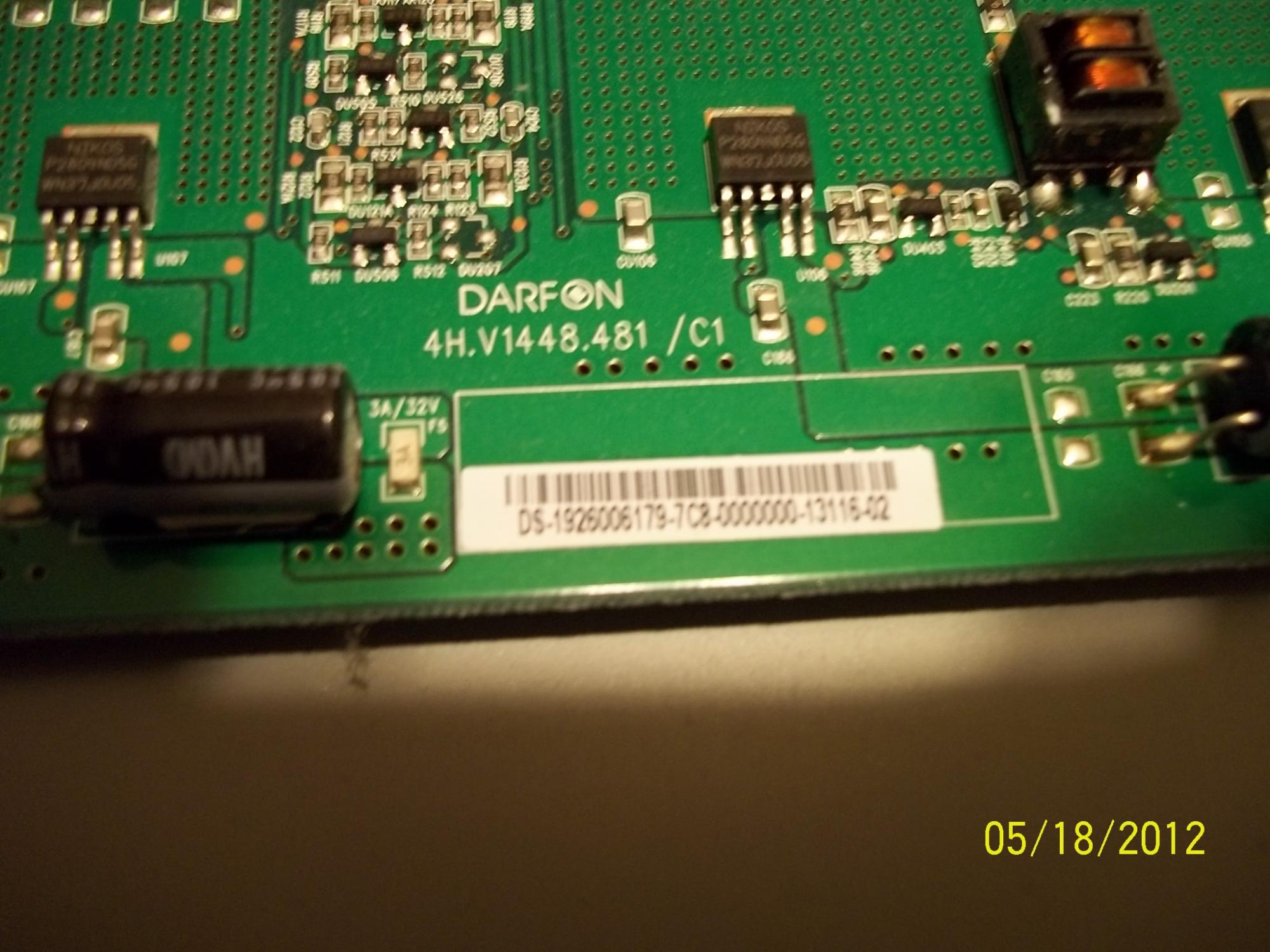

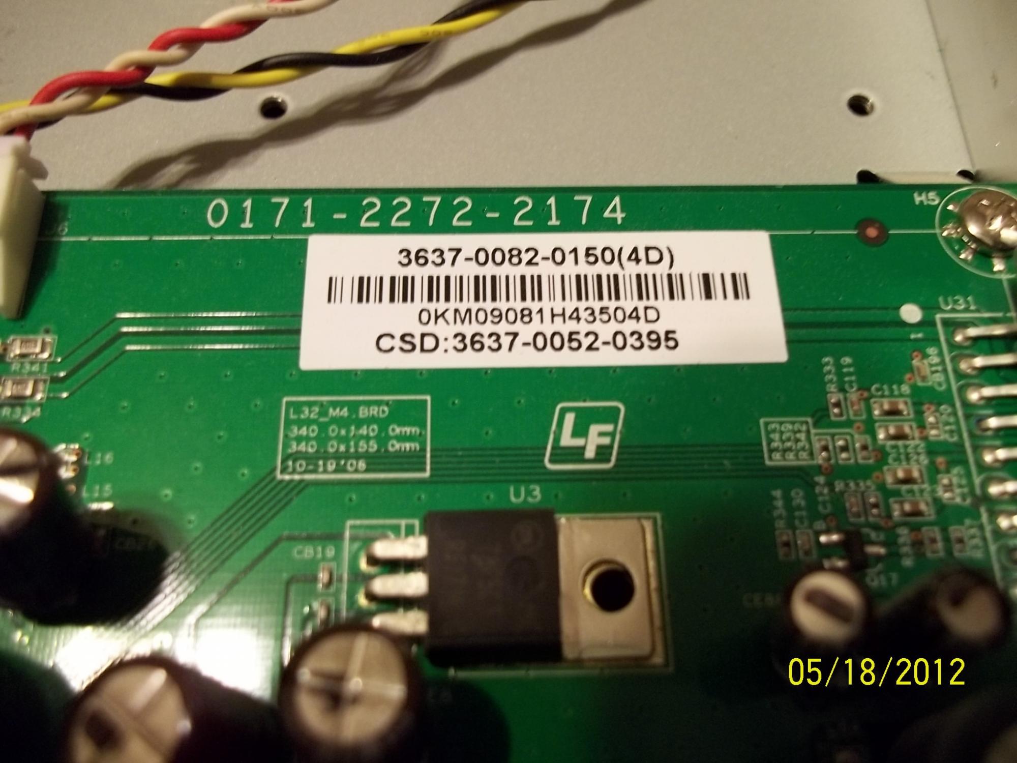

                                • eagle00799
                                  • May 2012
                                  • 322

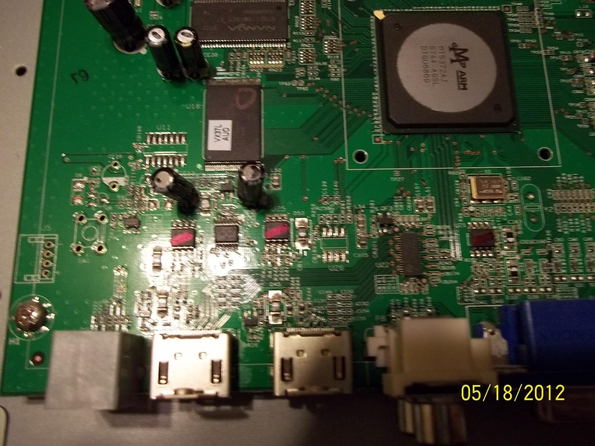

                                  • eagle00799
                                    • May 2012
                                    • 322

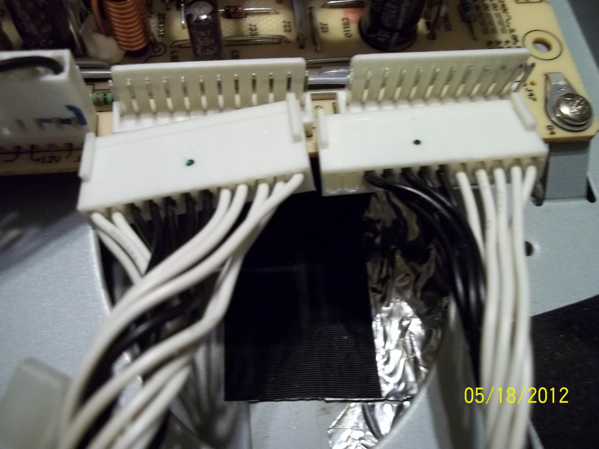

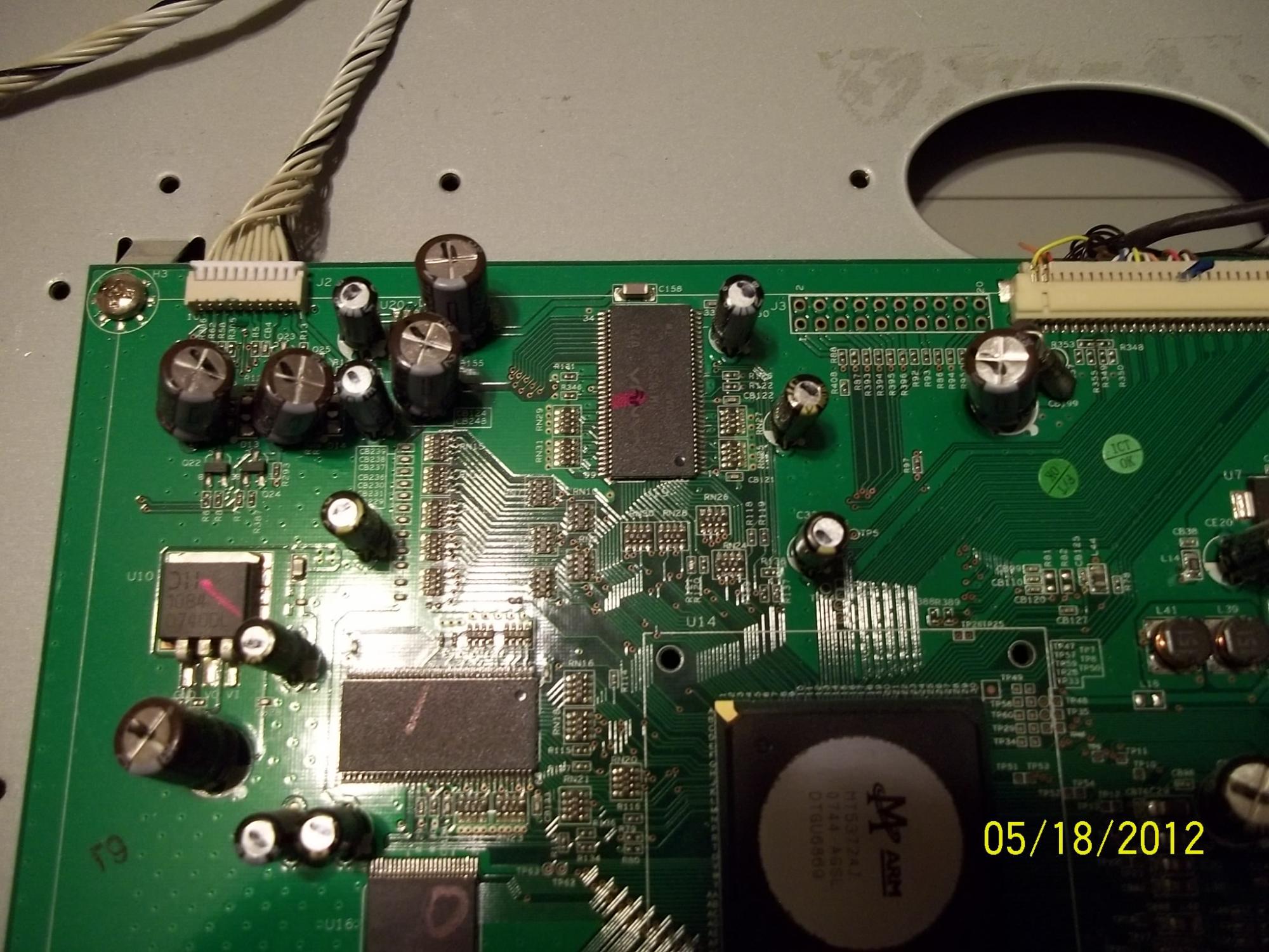

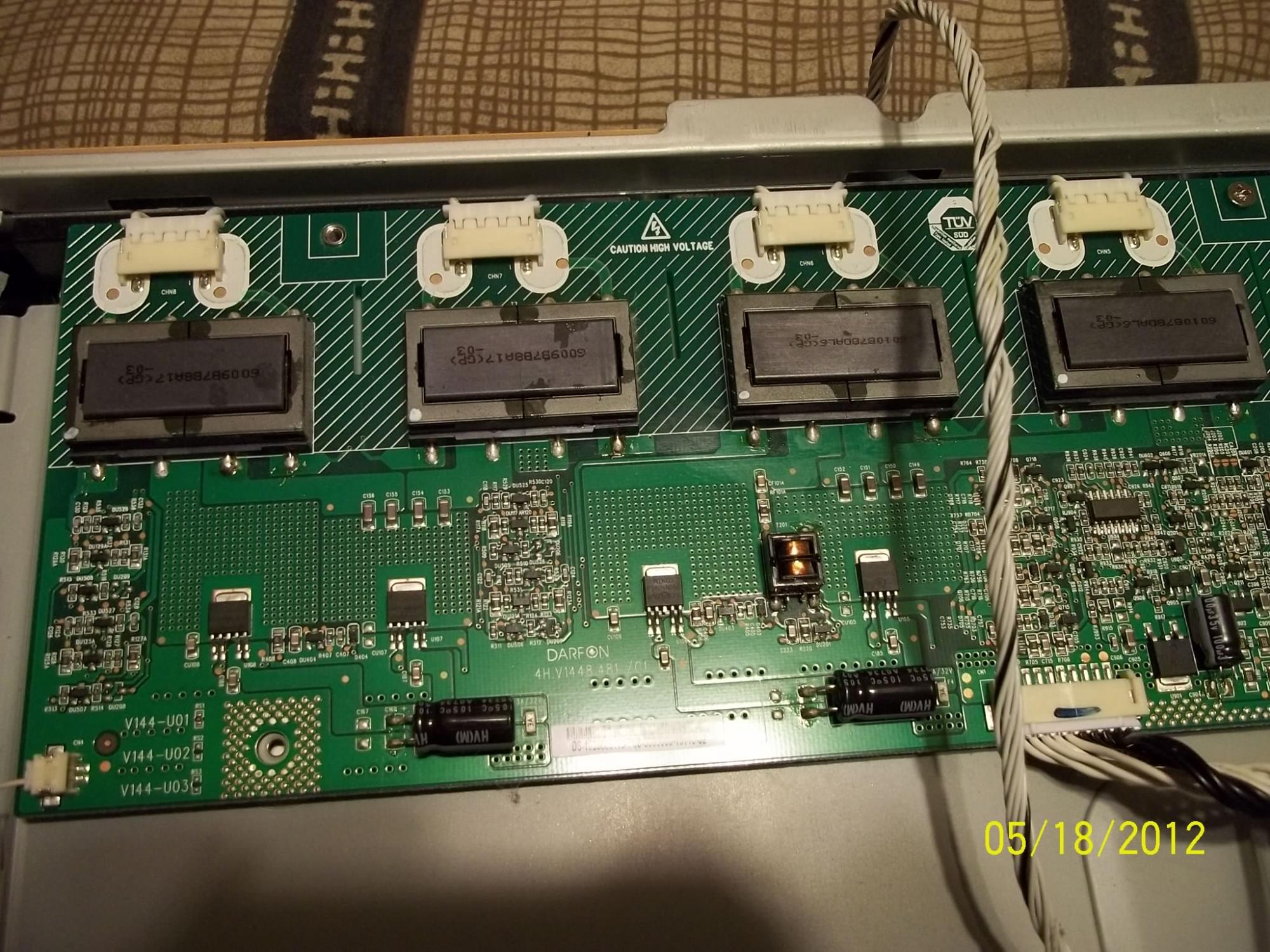

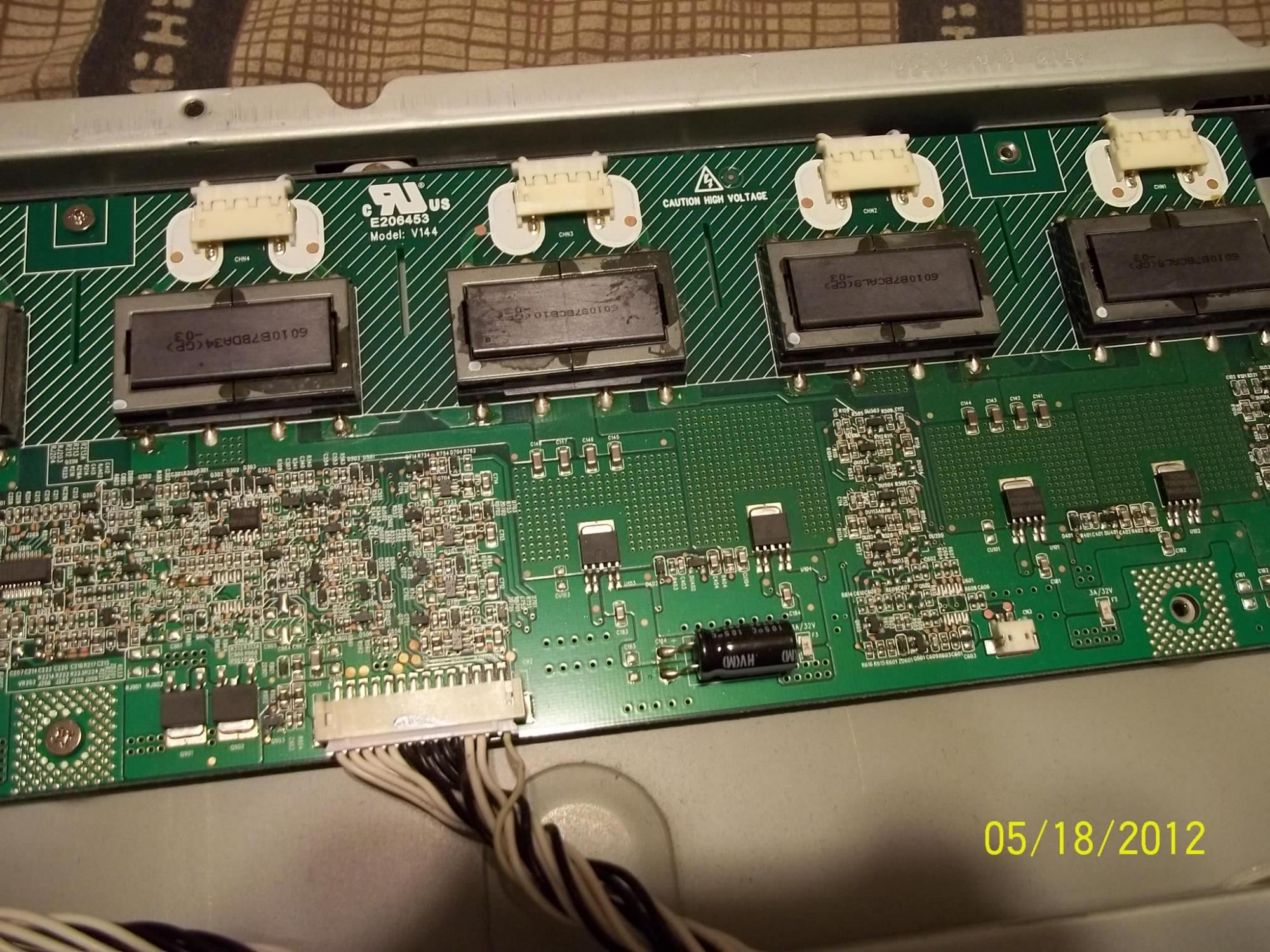

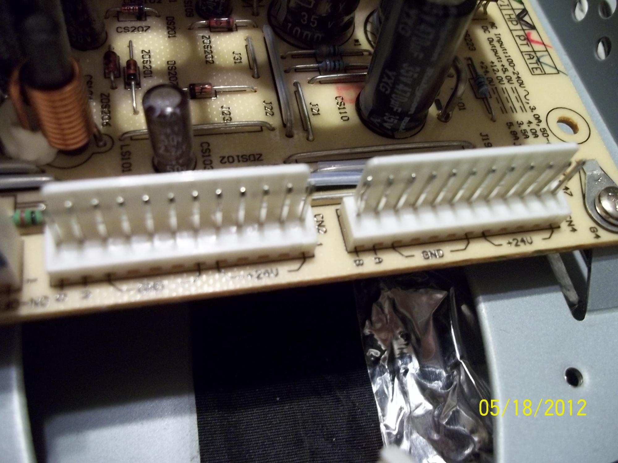

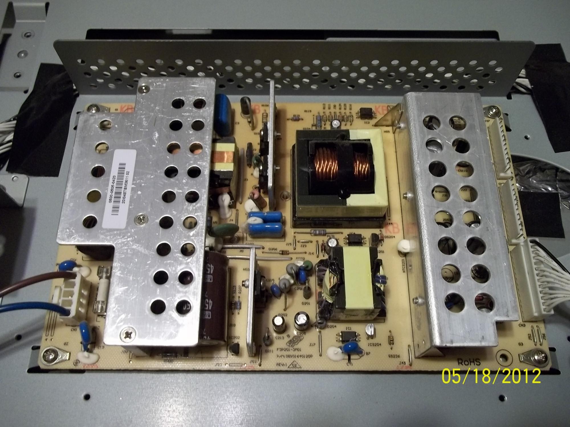

                                    Sorry the first one's are running down the page but here are the pics.
                                    • selldoor
                                      Slow Learner
                                      • Dec 2010
                                      • 7870
                                      Good effort - I think I have cracked the easy bit with help from budm
                                      http://i807.photobucket.com/albums/y...A/DSC02553.jpg
                                      The top socket appears to have the additional white wires?
                                      • selldoor
                                        Slow Learner
                                        • Dec 2010
                                        • 7870
                                        While the set is in pieces I want you to test some parts on the inverter board. By each of the capacitors and one on its own there are fuses. Please test them using 200 ohms setting on your meter. post the result ( should be the same as touching the probes together.)
                                        Next with meter set on 2000 ohms I want you to test accross
                                        both ends of the eight inverter transformers.( i think it is across pins 1 and 8 and 4 and 5.Post results like this
                                        T1 1-8 xxxohms 4-5 xxxohms
                                        T2 1-8 xxxohms 4-5 etc etc etc
                                        Also going back to fuses in pic 17 and 18 just above the left hand side of the bottom socket there is a fuse at F1 marked 3A please check that as above.
                                        Ok - i see a torch in one pic - two simple tests - you say there is no backlight.
                                        Next opportunity when it is all connected up - make sure the grounding is ok - you may have to add some extra ground wires or screw the boards firmly back in switch it on in a dark room to make sure there is absoluetely nothing flashes on the screen.
                                        Next - with a source connected pc or dvd? check with your torch at different angles to see if there is any image at all on the dark screen.
