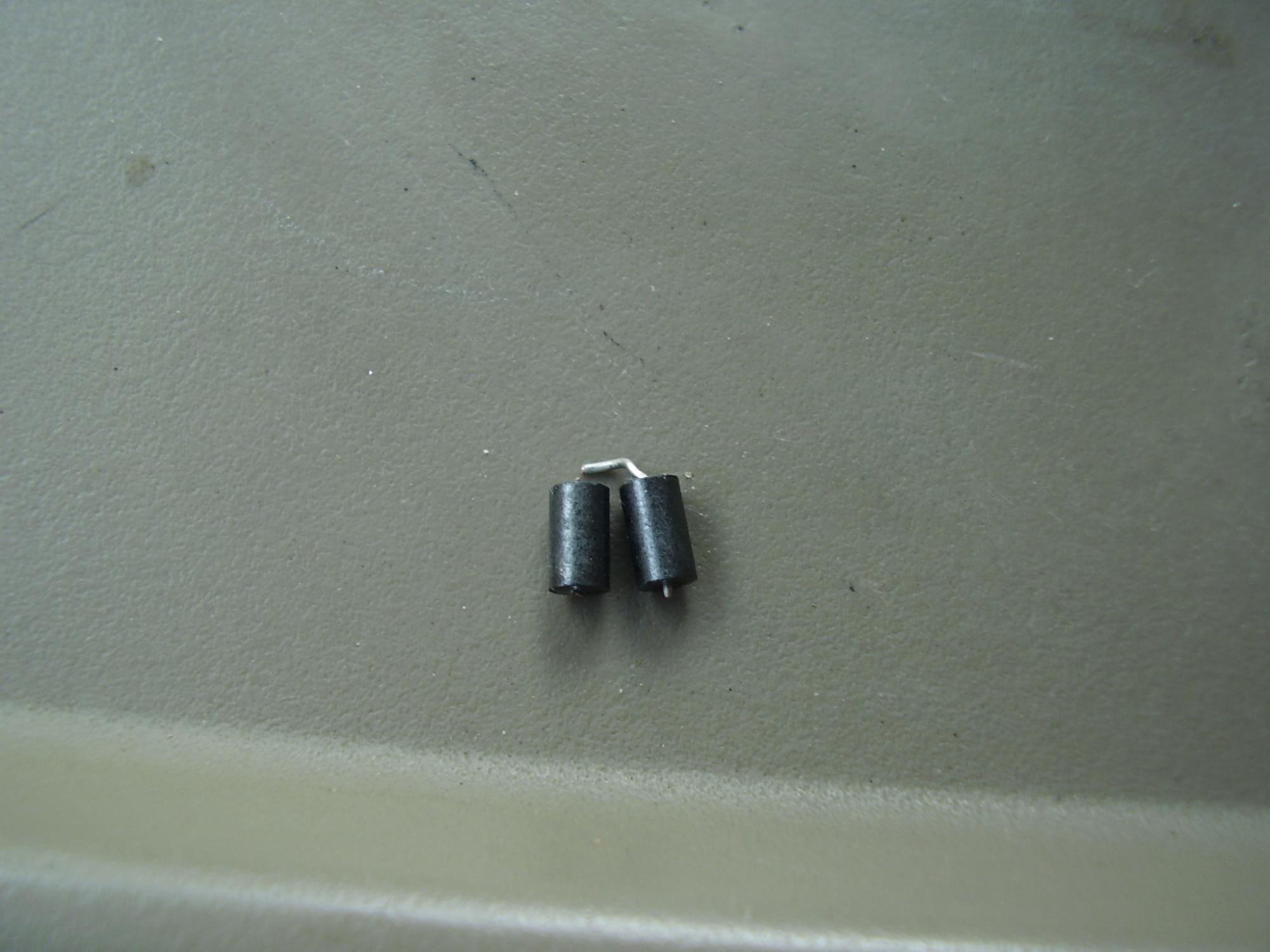

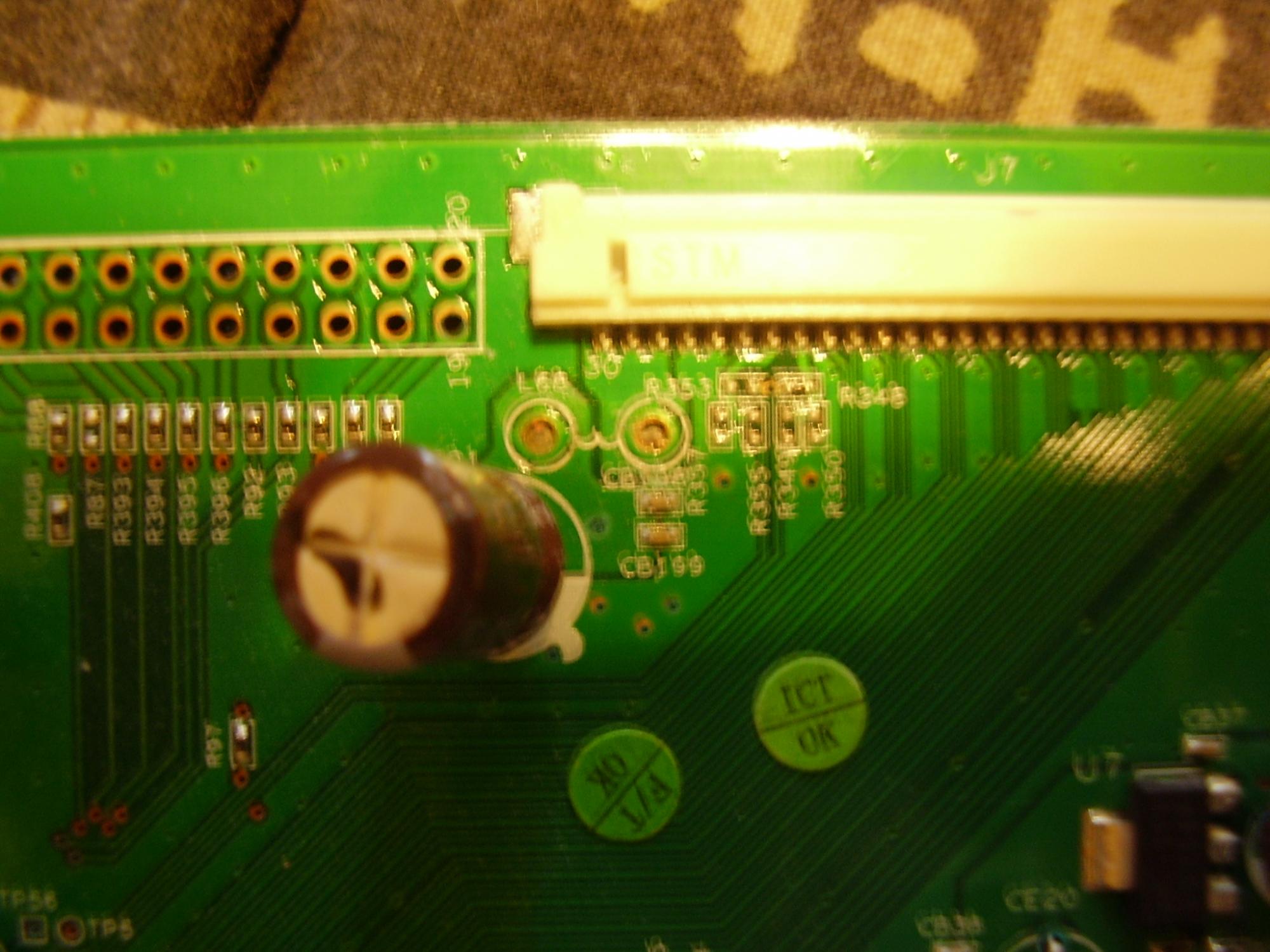

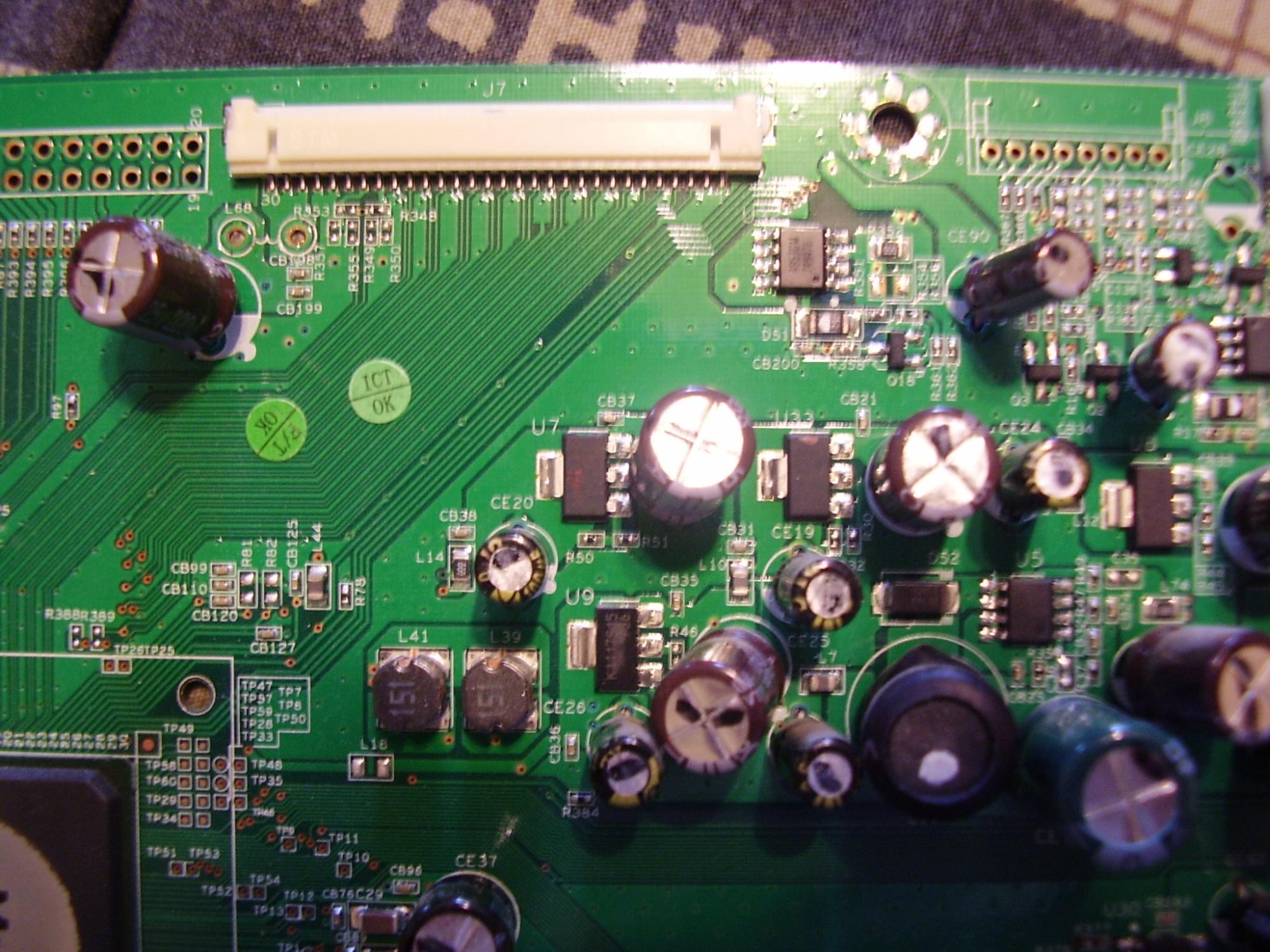

              Here is a pic of the U7 that i will replace and now i will need to replace another transistor?? here is a pic of the part and the location on the board is right below where the T-conn board plugs in, the 2 circles by the capacitor,can someone help me out? what is this called and maybe a part number?
                #47
                Re: vx37l no picture no sound
                That part in the picture #3 is just a wire with two ferrite beads on it to form a small inductor for filtering high frequency, you can use a new wire if the old wire is broken.
                The U7 is a 1117 series adjustable regulator, you can see the two resistors on pin one which determine the output voltage. One resistor should be connected to pin 1 and ground, another one will be connected between pin 1 and Pin2 (output pin). You can calculate what the output voltage should be if you know the value of the two resistor.

                  Well guys I tryed removing u7 and accidently took out a real tiny thing in the CB37 spot right next to it. I have to say a 30 watt solder iron is not sufficient for the job. I would guess a 60 watt would be recommended? Any way of repairing cb37? I cant imagine soldering something that tiny so do I chalk this up as a lose?
                    #49
                    CB37 is just a small value ceramic cap which is in parallel with large elecrolytic cap to by pass high frequency noise, you do not need it for now. You can install ceramic disc through cap in place later on.
