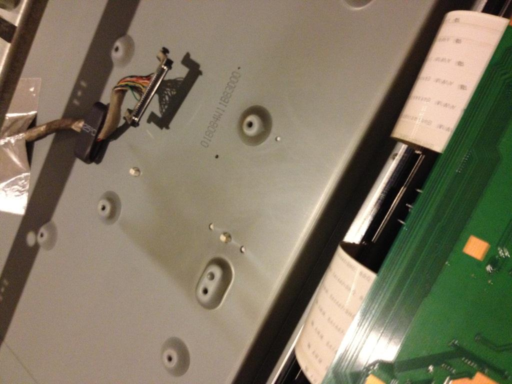

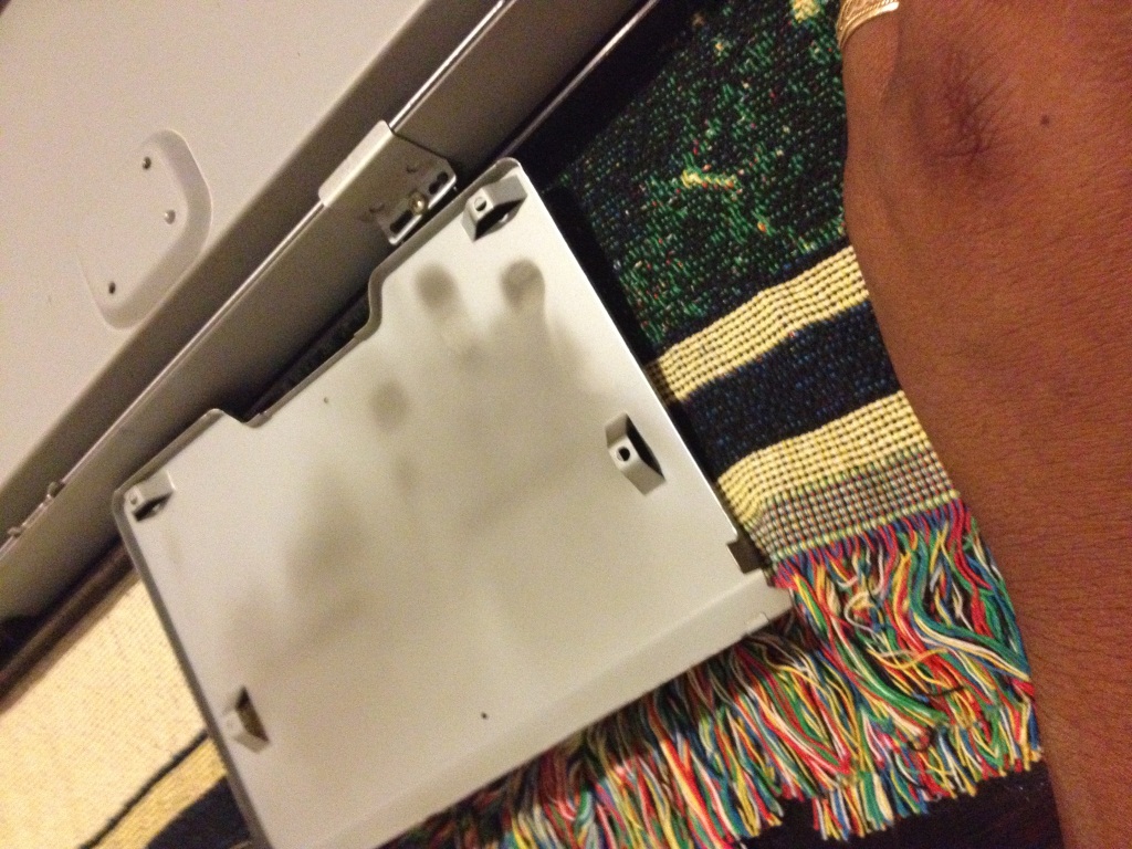

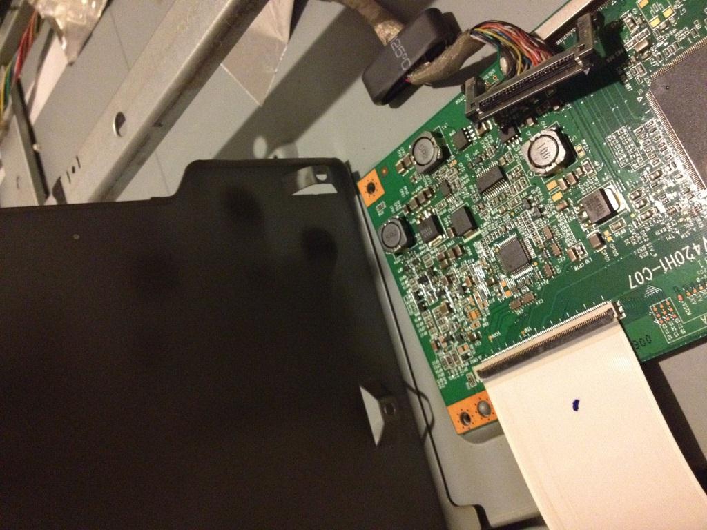

            Holy Skid Marks, Batman!!!
            Check this out .. I pulled off the TCON shell and look what I found...
            BURN MARKS!
            Running TV now with shell off / back of TV shell off / Fan pointed at TCON.
            Started at 10:30 will see how long it lasts.

              Sorry here are the pics.

                  Taking off the shell seemed to do the trick ... Has been running for two hours now. Thanks Mr. Bill and Budm for the assist. I will let it run overnight but so far this has been running longer than I have ever had it. Go figure ... After $220 in parts ... the fix was free!!!!
                    Re: Insignia 47 LCD (NS-LCD47HD-09)
                    The metal plate is used to heatsink the main processor. What is likely happening is some component under the heatsink doesn't like it. Without a heatsink the processor will probably overheat and fail.
                    I have several "well used" T-con boards (working ones) and they all show discolouring around the shield, it's not unusual.

                        Thanks all ... I will get a new TCON but for now the removal of the outer plate is keeping it cool enough to function as designed.
