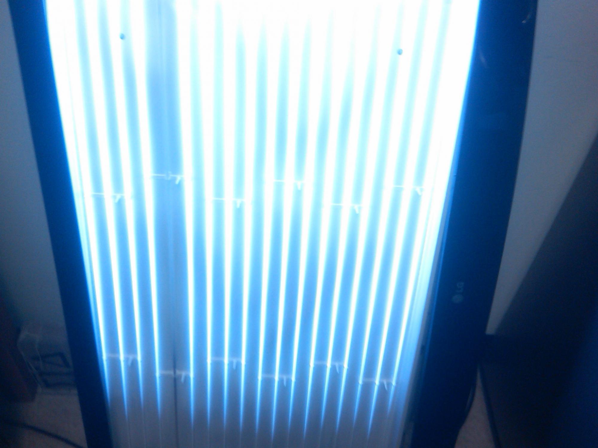

    In that thread they discuss several issues that may result in the issue. I decided to check the CCFLs in the back of the TV thinking that this could result in a faulty start-up. The attached image shows that the last 1/3 of a bulb is very dark. I'm assuming that it is burn out, and this is the cause.

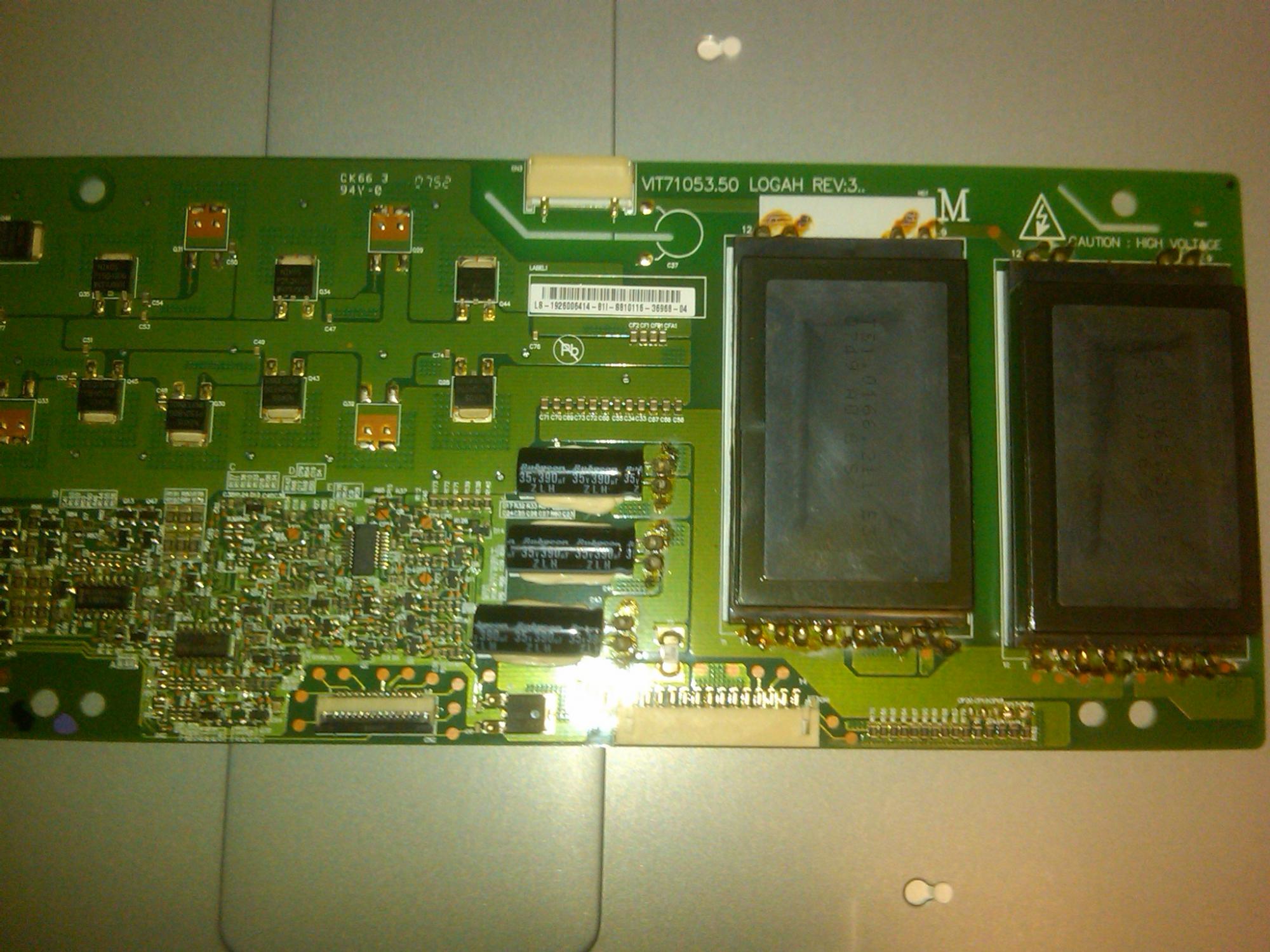

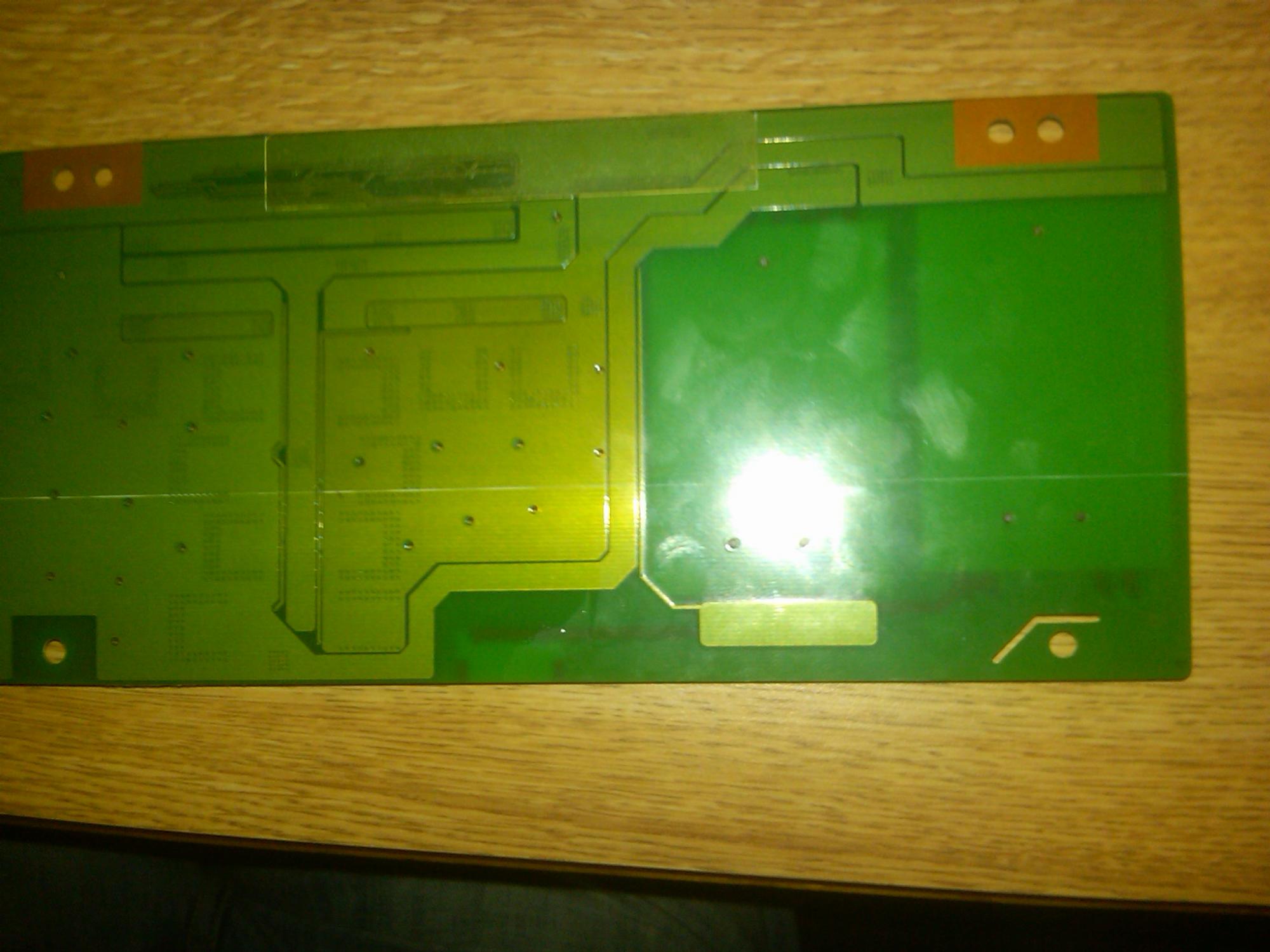

      Thanks for your response. To clarify are you asking for a picture of the board that the actual CCFL connects to or the inverter board itself?
      The inverter board has only 1 outgoing wire from the main and 1 from the slave board to all of the ccfls. I'll upload a picture of those in the next 5 mins or so to this post.

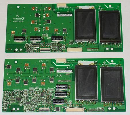

        Attached are the front's of the boards taken off from an ebay listing. I am waiting for my actual pictures to upload, but they are the same exact part #, and indentical.
          Re: 42" LG30-UA backlight/inverter issues
          We need to see yours, fronts and backs and really clear.

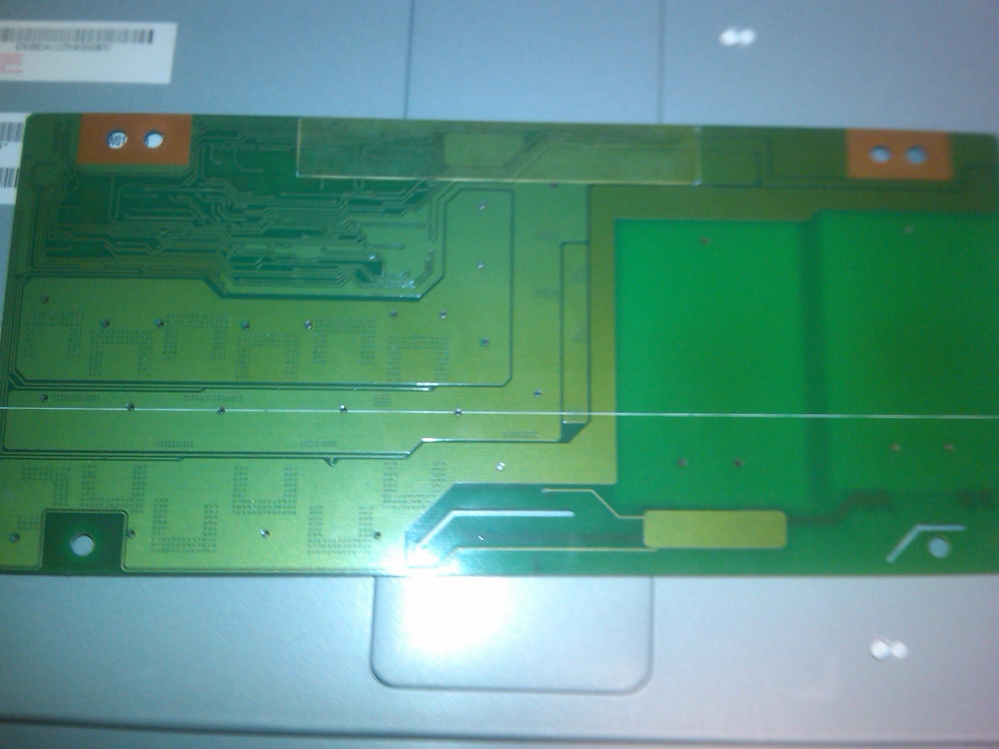

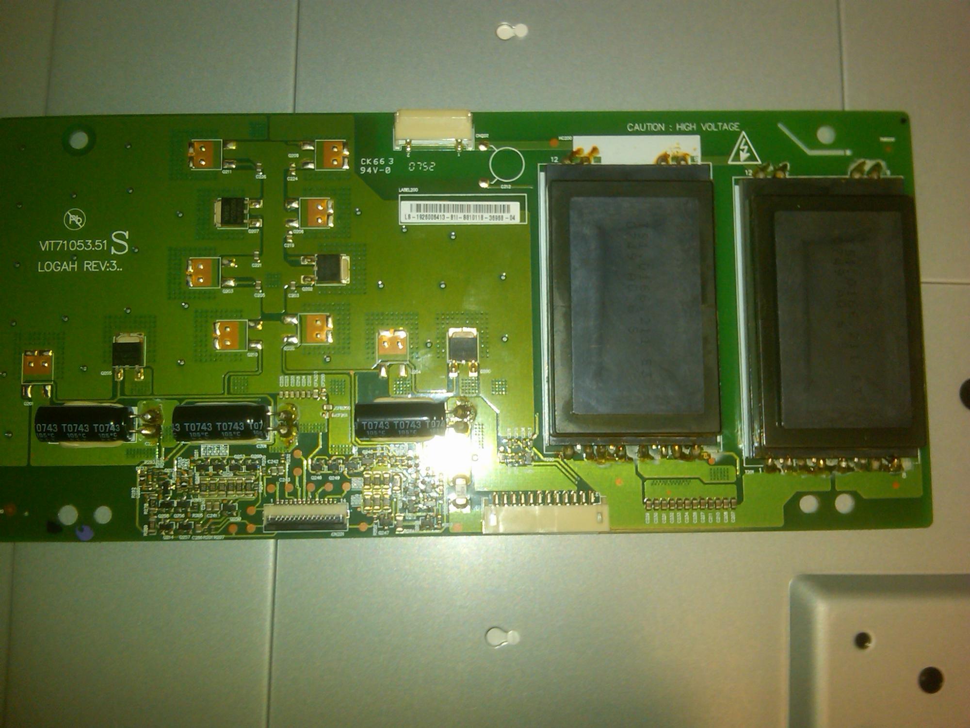

            Attached are fronts and backs of inverters let me know if I need a close up of anything in particular.
              With power disconnected check between pins 12 and 9 on each transformer on each board. They should both show the same value I think.

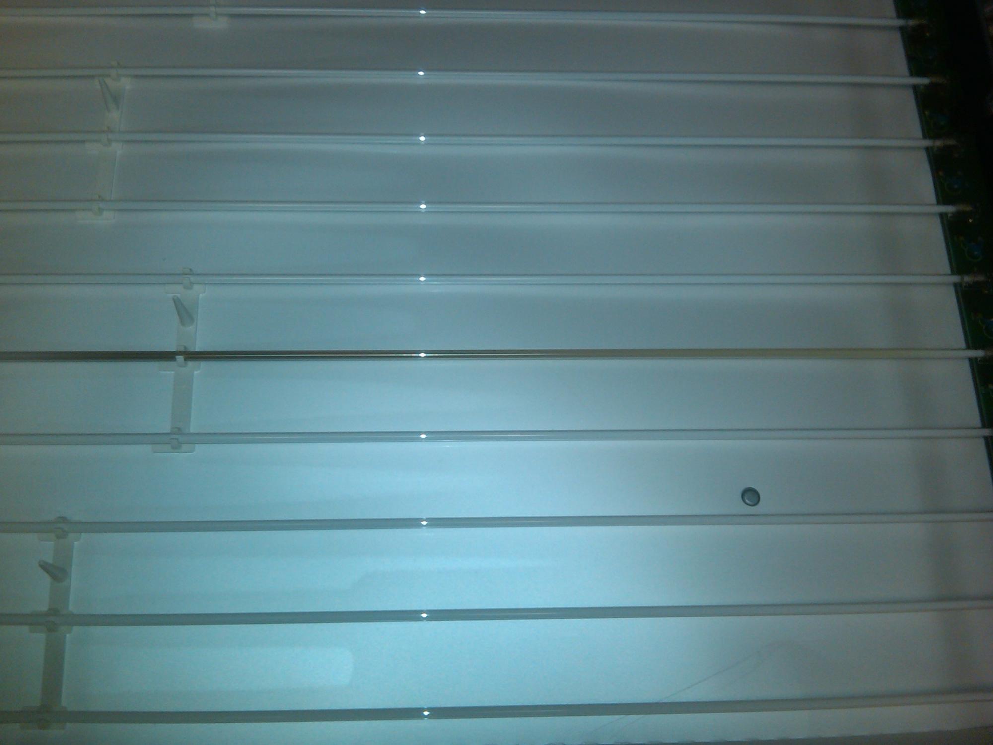

                I would replace that ccfl with another one and see if it will lit up there or not.
                If not then you need another on. check ccflwarehouse.com, just measure yours and get the same size dia. x length(only the glass).
                Be careful with everything, especially with the screen itself before you place back the top metal cover. Make sure that it sits where it supposed too, don't ask me how do I know.

                      Results done leaving multimeter in "auto range mode"
                      Left on Slave: 1 bar + .6 ohm
                      Right on Slave: No reading
                      Left on Master: 1 bar + .6 ohm
                      Right on Master: No reading
                      Results are done with multimeter checking continuity
                      Left on Slave: Short
                      Right on Slave: Open
                      Left on Master: Short
                      Right on Master: Open
                      According to multimeter manual:
                      Open-Open appears if circuit resistance is great than about 80ohms
                      Shrt& buzzer sound- If circuit resistance is less than about 80 ohms
                      This is the multimeter I am using:
                      http://www.radioshack.com/product/in...ductId=2103176
                        Use ohms, not continuity. We are looking for the exact ohms reading of the secondaries.

                                the cheapest is to move that bulb in another slot and see if it lights up or not.
                                  Hmm that requires reassembling the entire electrical system. Which I am not opposed to, just involves putting everything back together.
                                  And this system has only 2 wires from the inverters that power all of the bulb. It's not like some of the others that I have done where each bulb has it's own plug-in on the inverter. So I'm not sure if simply moving the bulb to another location will solve it?
                                  The original issue is that the TV only turns on for a few seconds, including the backlights, then shuts itself back off. So if simply switching the spots of two bulbs will tell me that the one that looks blown is then I suppose I will do that tomorrow. Will check back here before I go on that endeavor.

                                    This panel will have at least 3 ccfls bad and the slave inverter will have one or more shorted mosfets.
                                    All of the l/gs with -ua after the model number use this au-optronics panel.(junk)
                                    example: 32lg30-ua or 42lg30-ua ( Made for and sold by big box store? )
                                    The better l/gs are the 32lg30 or 42lg30 etc. Those use the better panel with a single inverter.
                                    The mainboard and t-con are different also and not interchangeable.
                                    The power supplies are the same.
                                    I have replaced the ccfls on these panels by using ccfls from other panels with no problem.
                                    I also solder them in since the ends may be different.
                                    A bad connection / ccfls will cause the inverter voltage to sore way over 1200 volts. (no load) and most likely take out the mosfets on the slave inverter board.
                                    You can unplug and remove the slave inverter and the tv will still turn and have the 2 seconds to black.

                                      I attached a picture of the ccfls with the slave inverter unplugged. It seems as though only 1 is not working. As you can see at the bottom, the last 1/5th or so of each of the bulbs are not lighting up. I'm assuming that this is because of the slave inverter being disconnected.
                                        Attached is the same slave inverter with the MOSFETs numbered and the corresponding writing & numbering on each:
                                        1)NIKOS P2504EDG WN37J0605
                                        4.1 ohms
                                        2)NIKOS P1504BDG WN37J0Q01
                                        4.0 ohms
                                        3)NIKOS P1504BDG WN37J0Q01
                                        9.96 Kohms
                                        4)NIKOS P2504EDG WN37J0605
                                        20.20 Kohms
                                        When I test all of the P250... on the Master they all test at 10.4ish Kohms
                                        When I test all of the P150... on the Master they all test at 10.8ish Kohms
                                        Is number 4 doubling because number 1 is essentially dead? And I'm assuming 2 is probably dead too?
