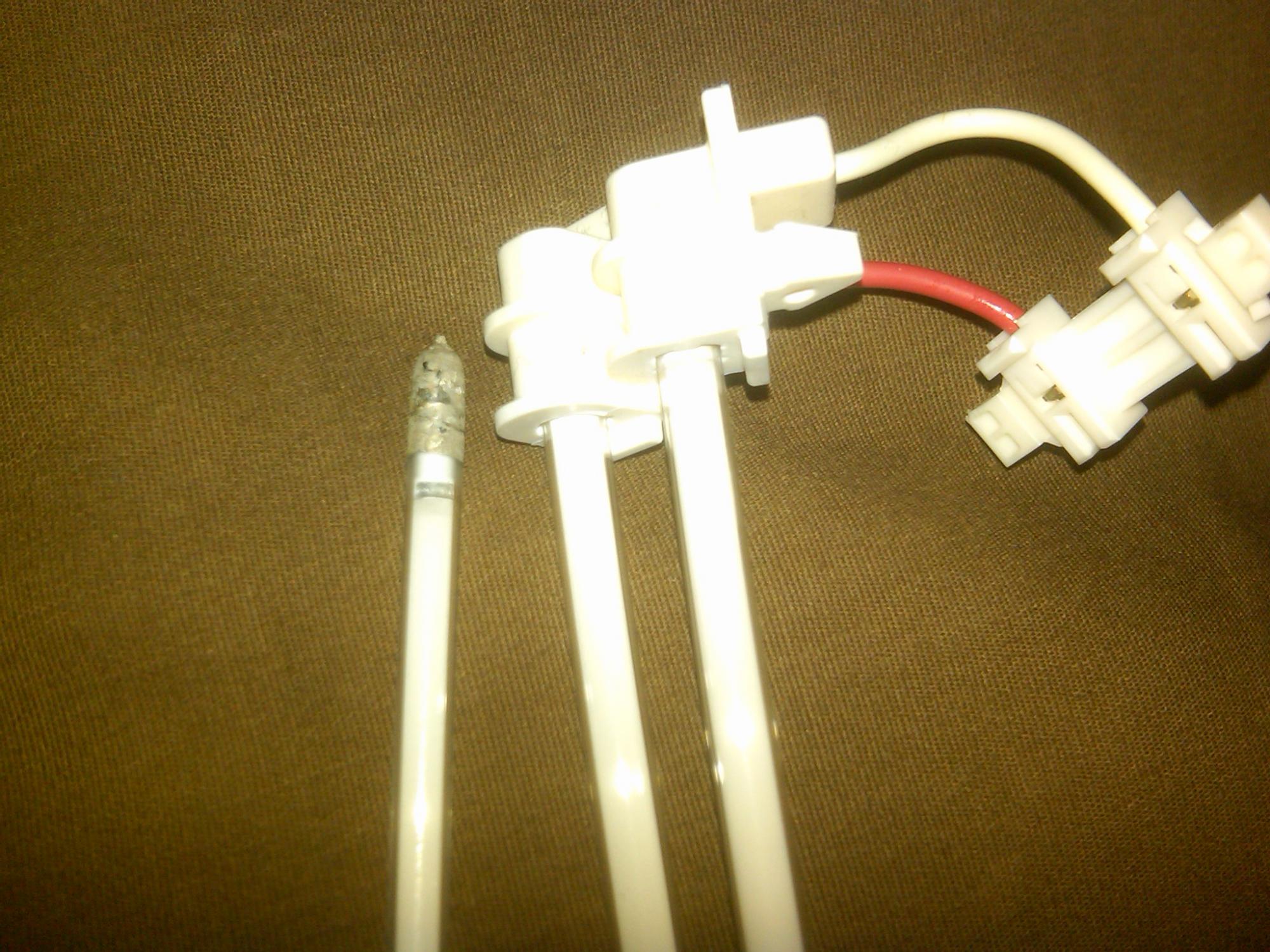

                So today on craigslist I found a guy selling CCFLs for $5 each, much better than the $25 each I just paid for 2 shipped from California. Anyways they are a 4mm diameter, but seem to be bigger than the originals. Earlier I stated that the 3mm was too small. It seems as though the ones I ordered (3.4mm) would be the correct ones.
                Anyways, the picture is below and my question is how do I remove these plastic caps without breaking the bulb. Or would it just be better to solder them in somewhere with the wires that extend? Where would I solder them/ can I use these? I don't care if they break they were $10 total and it's really just an experiment while mine are shipped.
                The originals were the ones without the plastic next to those with them. It's hard to see the diameter difference but I assure you that the plastic capped are 4mm and indeed wider.
                • retiredcaps
                  • Apr 2010
                  • 9271
                  Re: 42" LG30-UA backlight/inverter issues
                  This tutorial may help?
