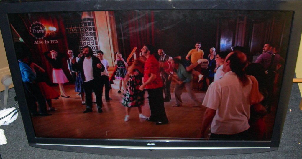

    I got an LCD TV for free today . A 42" Bush Full HD with Freeview set... Powers on and gives a picture.
    Problem is with screen, lots of mura on it, more like backlight unevenness. Can't fix it by just laying it down unfortunately.
    Completely tore it down to find two of the backlight layers have clear patches in them (where the fault is on the screen) so clearly they aren't going to work.
    I'm looking for diffusers for a 42" LCD. If anyone has a broken screen 42" LCD, please let me know as I may be able to get those diffusers to work in this TV.
    I am thinking of re-doing the diffuser, maybe with some kind of spray paint.

    have you tried large sheets of tracing paper?

      I'm not sure how well it will work, but I'll consider it. I've found a supplier in China of these diffuser sheets, so I may be able to buy replacements.

        i think you can get the standard tracing paper which has a slightly matt finish to it,and you can get a waxy type which might distribute the light better,ive never tried it, may work,both are translucent

          These do need to take a bit of heat.
          The ones I have taken apart looked very workable as far as taking from other panels and cutting to size.
          You need like 4 sheets and I wonder if they are polarized or set in a specific order.
          I always keep them in order and they may also have side A and B respectively, but not sure.
          I have worked with them on the 7" tablet panels and those are in a specific order and are different from one side to the other.

            Okay so I took out the diffusers. Cleaned them and laid them out to dry for a day.
            Put them back in... and it works . No mura .
            Damn! It is a difficult job. I spent an hour trying to get the LCD panel together and was so worried about damaging the panel which is so very, very fragile.
            Unfortunately I did scratch it with the speakers but the scratches aren't very visible.
            42" Full HD Freeview set.
            Not bad for free .

              So was the white part all removed after you cleaned the filters? or did the clear part return to being white??? Did you have to adjust the brightness after the cleaning?
              Your picture looks even, but the colors look a little off, might be from the filter not making all the light uniform white.

                I did a few things. I cleaned them so that the marks were only faintly visible. I put them in some sunlight and let them dry, which may have caused some of the sheet to clear up. (I'm not sure...) Then I swapped around the filters so that the bad filter was behind a good one. I cleaned the back of the LCD panel too. All of this made the picture look much better, to the point where it looks as good as most other LCDs, including my 42" LG (which has an LG Philips panel, not some CMO crap.) Strangely, the only remaining problem is the general backlight unevenness all LCDs exhibit - it's not related to the mura there, it is more like random clouds, like on my LG 42". (Sort of visible on dark scenes.)
                This LCD is pretty poor, it struggles with black and white. White appears a little cyan-y on the edges, and it has difficulty distinguishing between zero percent black to around 10 percent black - they look the same.

                I found it was set to Cinema mode, and set that back, the picture is pretty good now. The flash on the camera probably doesn't help.

                  How about the Polarizer sheets, did you have to cleam them also?

                    I cleaned that too, there was only one thick plastic polariser. It didn't have any marks on it, but I cleaned it because I got fingerprints on it. One thing that is so very difficult with these things is that you can touch something and get marks on it and you'll only notice when you put it all back together. However, I checked at every point to avoid this... would advise anyone trying the same to do this.
