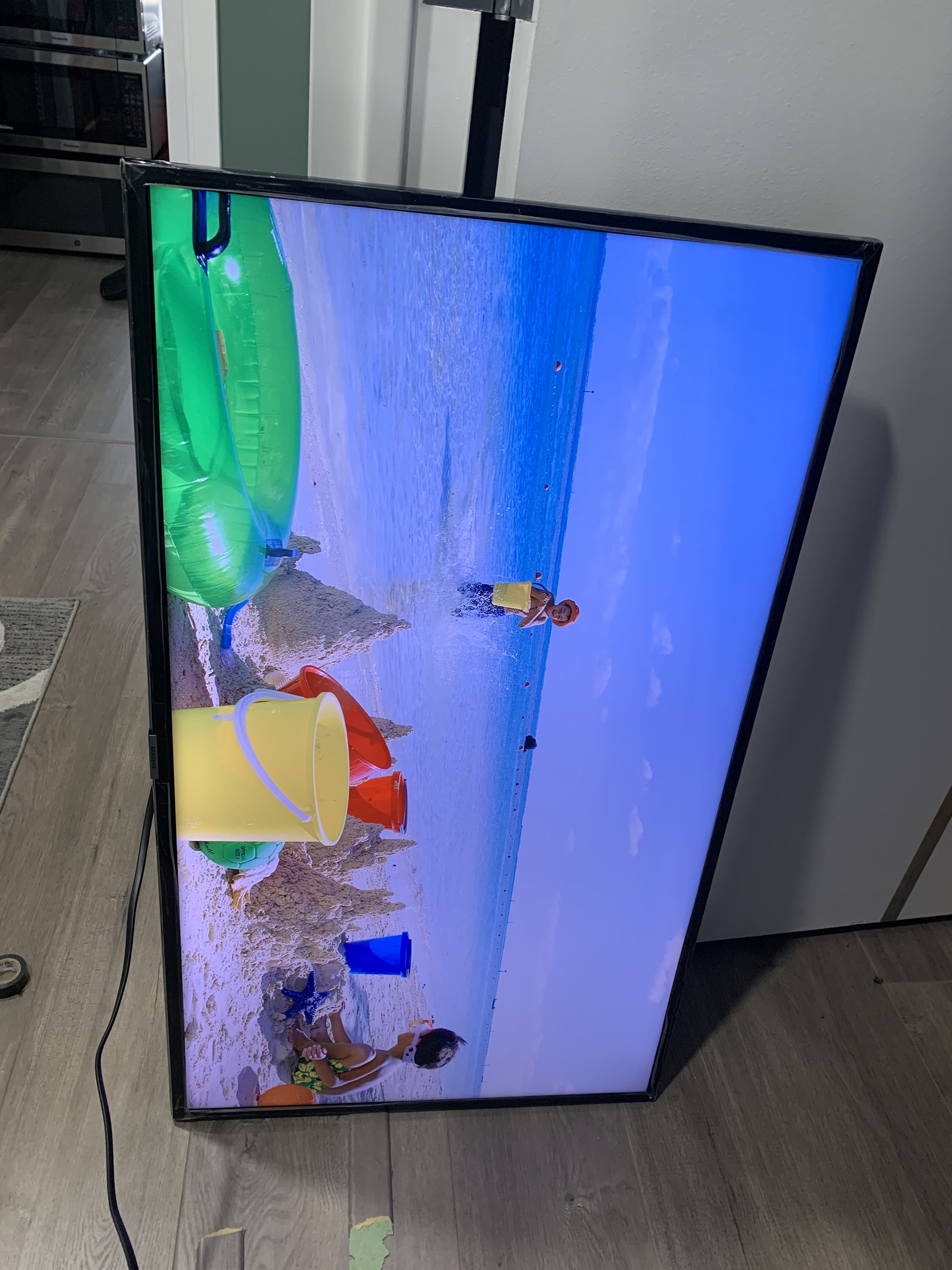

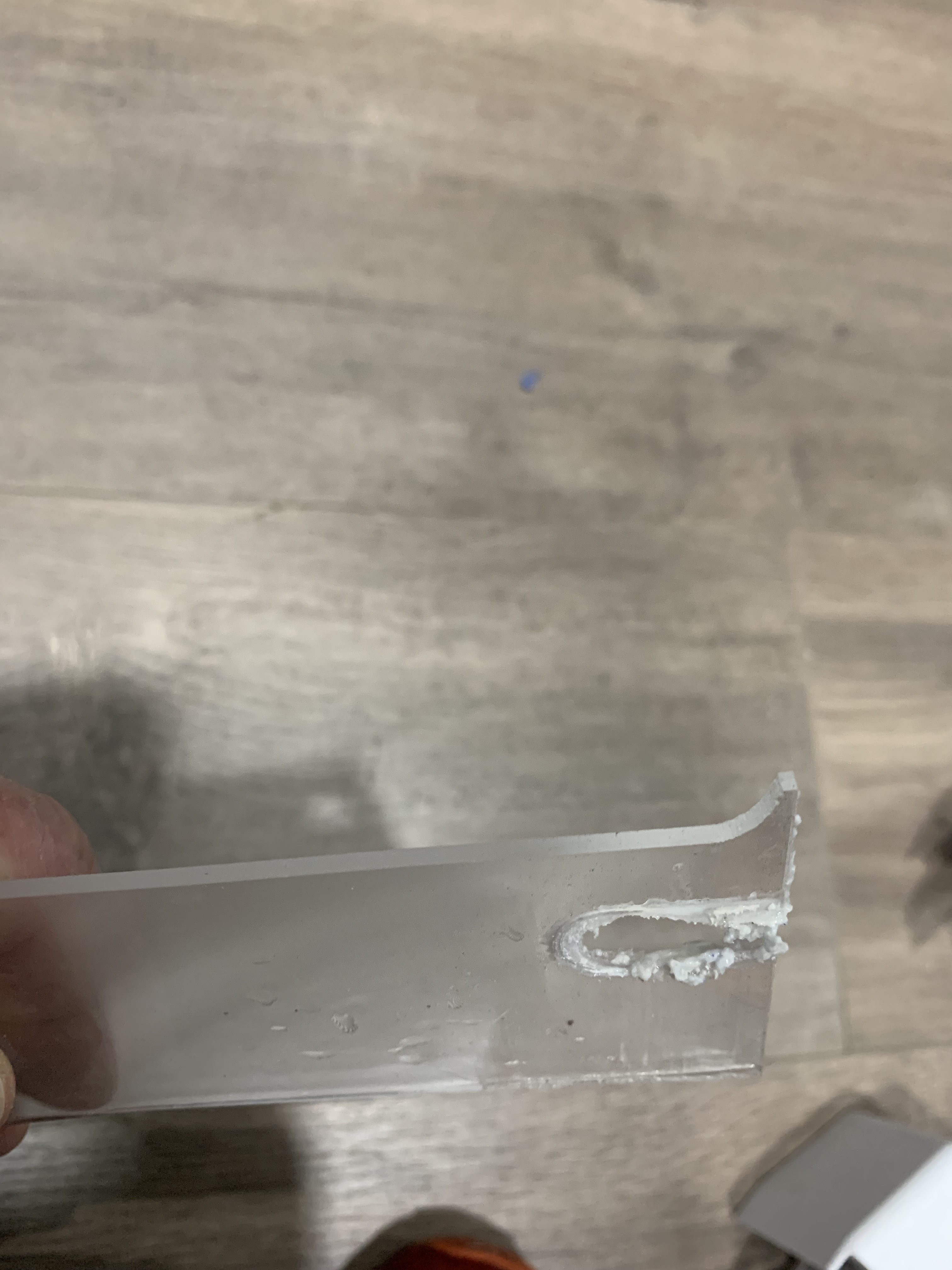

    I have a Samsung 40” NU series tv with the melted cracked diffuser I’m fixing. I replaced the backlights and I’m planning on cutting a new diffuser out of a 55” diffuser that just melted but didn’t crack.
    Question is do I have to keep the top edge factory for the diffusing to work properly or does it matter?
    only get one shot at cutting it so wanted to make sure.

    i assume its edge BL .. then that's right... big matter the edge site on the top which opposite to LED surface, need to being also on the top so don't cut it. because it had coating on the edge to reflect the light and keep it focus inside the plate

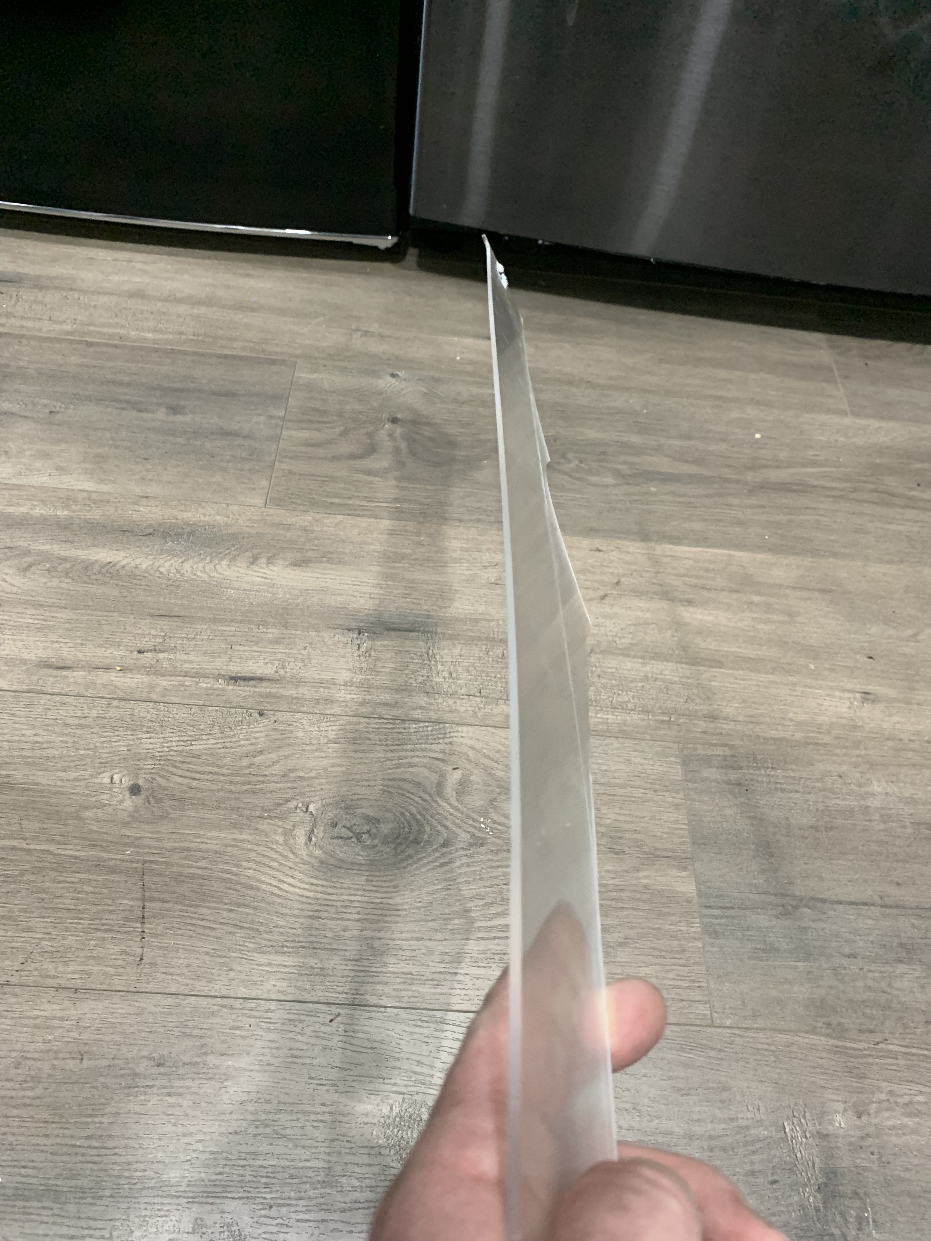

                            • Storyteller12
                              • Jun 2020
                              • 624
                              Update:
                              i tried to score and cut like Daido mentioned and it does give a clean cut edge. However I couldn’t get it to snap in 1 piece. Maybe with a better setup and even pressure.
                              Router worked great though and gave me a clean cut edge as well. It’s a lot of mess though compared to Daido way.

                                    • Storyteller12
                                      • Jun 2020
                                      • 624
                                      These are the scrap pieces I tested on first. But you can see the nice edge the router left
