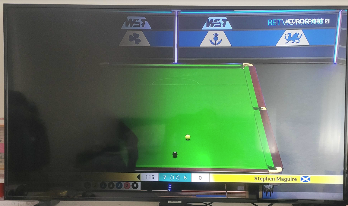

    I'm trying to repair a UE50NU7022KXXH with a cracked diffuser/lpg and now also with burned leds
    There are 4/5 white spots on the bottom that are not visible since the left side is dark now so I want to change the diffuser/lpg
    Looking the samsung spare parts, I see that there is a DIFFUSER PLATE and a LPG so I'm wondering what is really broken?
    https://www.samsungparts.eu/samsung-...n61-15659a.htm DIFFUSER PLATE 1125x625x2,5mm
    https://www.samsungparts.eu/samsung-...n61-15661a.htm LPG 1101x619x2,7mm
    Thank you

    You need new LEDs and a new diffuser. If you look on marketplace for a 50 with a cracked screen you can transfer it over also. I don't know the acronym lpg so can't comment on that. I've never bought a new diffuser because they are too expensive. $40 ain't bad for you, usually they are $300+ here. Maybe 50 inch is small enough

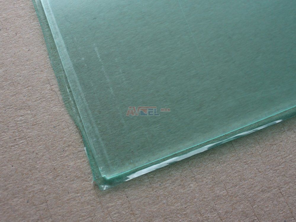

      Actually is a typo, it is LGP (light guide plate) or plexiglass as here https://www.avelmak.sk/produkt/89733?lm=1878

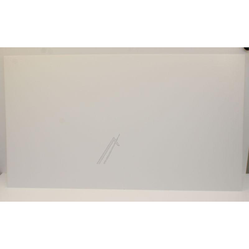

      The diffuser looks like a transparent white panel https://fixpart.co.uk/product/samsun...ate-television but on this link I see a comment that the part is not good for ue50nu7020 which is basically the same TV

        OK apparently the broken part was the LGP panel (plexi) but my TV died completely before getting the parts so I gave up
