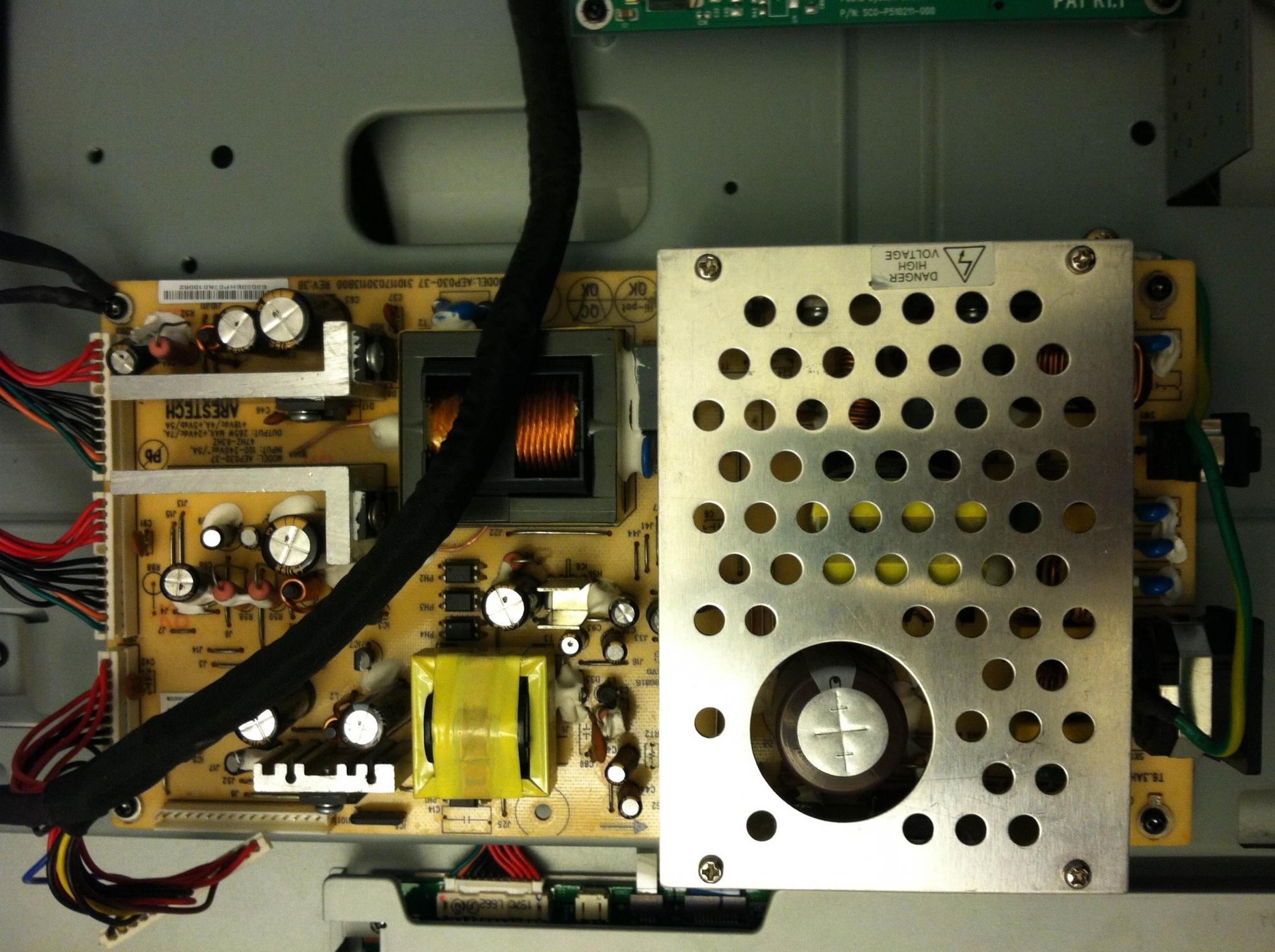

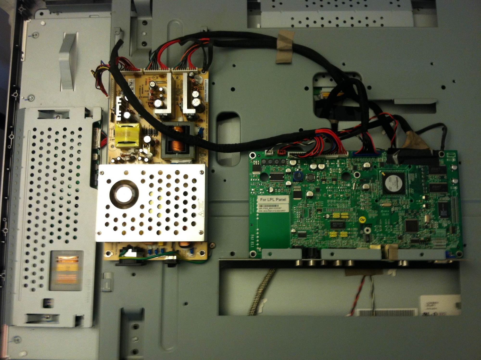

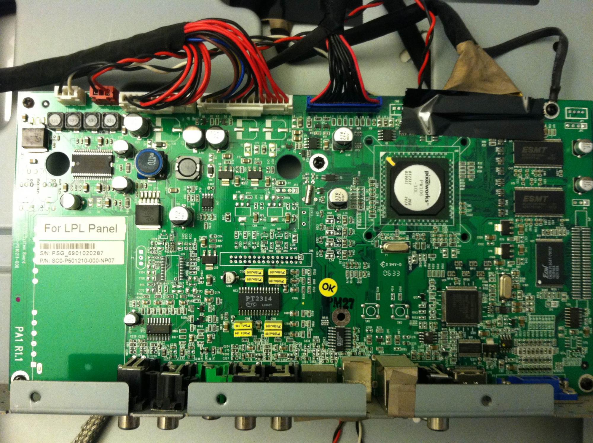

    Got another puzzler here. The patient is an Olevia 37 inch LCD TV, model 337-B11. The previous owner told me he had the power supply replaced, it worked for a while then would not turn on.
    Get it home, it works perfect. Great picture, no problems. It worked all night, watched a few movies. Turn it on the next day, nothing. No picture, no sound. On Olevia TVs, the power light is on when the TV is off, and off when the TV is on. The behavior of the power light indicates the TV is turning on, the light turns off when I press the power button from standby.
    If I turn the TV off, the power light comes back on, indicating the TV is in standby. If I turn the TV on and off a few times, it will eventually come on. Once it's on, it doesn't ever stop working. Turn it off, it's a crapshoot if it will work.
    Opened it up, didn't see anything 'obviously' wrong. Pictures are below. Any thoughts? I'm wondering if the mainboard is having an issue. Thanks in advance!

    Re: Olevia 337-B11 Only turns on when it feels like it
    A replacement power supply, unless brand new from the manufacturer, could be questionable quality.
    It sounds like a classic case of caps with high ESR. As the caps warm up, the ESR drops allowing the TV to work.
    A hair dryer may come in handy?
    Alternatively, when the TV doesn't work, see if the DC voltages are fluctuating or low.
    Pictures are below.
    Take a look at the inverter board as well.

      No hair dryer, and it hasn't failed yet today to check voltages. I pulled the power supply out and used and ESR meter on all the caps on the secondary side; all of them appear to be good (none over 1 ohm except a 22uf which read 1.9 ohms). Some of the caps did seem to take a bit to 'settle' on a number, is this indicative of a problem? Also, do I need to worry about the primary side capacitors? I tried to measure one and it bounced all over the place for a good couple of seconds, longer than any on the secondary. Not sure if this is due to the switching circuitry interfering or what.

                    Got the new caps in, still having the same issue. I only replaced the caps on the secondary side; I've been told those are the ones under the most stress. Would it be worthwhile to replace the primary side ones, or should I be looking elsewhere?
                    Retiredcaps: I checked the voltage, there are no descriptions of the pinouts, so I'm guessing here. What looks like the 12v line only has 8 volts when the tv won't turn on. Standby line does go low though, it drops from 5v to 3.5v.
                    I also have the original power supply, I put it in the tv and the front standby LED started blinking. Checked the voltage, and it is all over the place. Hard to tell the exact range as I have a digital meter, but around 2-5v. Maybe I should try to fix this one instead?
                      Yes, on the primary side is the very important startup cap. It is usually 47uF 50V.
                        Hi there is usually a small 50v cap on the primary side which is the startup cap.
                        Perhaps you could list the caps and we could make a guess which one it is.
                        I will look through that other thread to see if I can spot anything.
                        In the meantime perhaps you could try retiredcaps hairdrier plan.
                        Before you try and turn it on heat the small caps in the primary area with the hairdrier and see if it comes on straight away.

                          Here are all the caps on the primary side:
                          470uf 35v
                          22uf 50v (5x)
                          47uf 50v
                          4.7uf 50v
                          150uf 450v
                          One unknown, they put this stupid hard glue right over the numbers, but based on the size and location I figure it is 47uf 50v.
                          All are Lelon RXW series caps, except the big kahuna which is a Nippon Chemi Con KMQ
