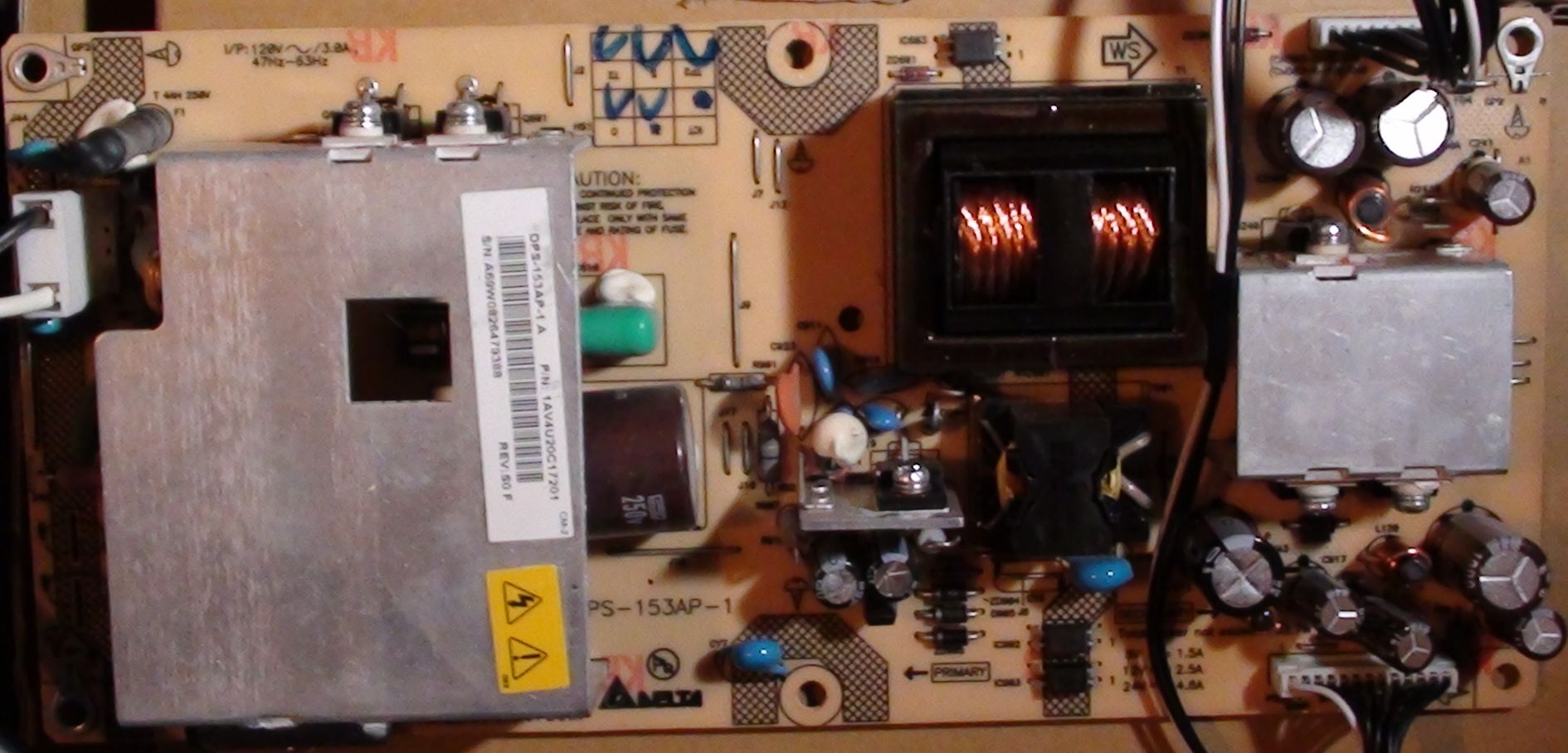

        Okay, so I got the service manual but I'm having some problems. I attached a file called T-CON BD and above the fuse, there's a test point showing VIN_12. That test point reads 1.8vdc. Does VIN_12 mean 1.2vdc or does it mean 12vdc?
        There's a power failure circuit that can get tripped but I don't think that's the problem. Pins 32 and 22 on the IC800 chip go low when something's wrong, they're both high. The fuse on the T-CON board checks out okay. I'm getting the back lights lighting up but nothing on the screen.
        I ordered an Atlas ESR meter but it won't be here for a couple more weeks so testing caps isn't too much of an option yet. I thought maybe one of them was bad but since I have no way to test it, I'd like to maybe test some other stuff. Anyone got any suggestions?
        -- Law of Expanding Memory: Applications Will Also Expand Until RAM Is Full
          Re: Dead Sanyo DP26648 logic board, need service manual.
          Yes, that 12vdc is from the switched transistor on the main board. There should a transistor close to the connector that goes to the T-CON board.
          Are you getting just the white glowing screen (backlights are on?)? Sound?

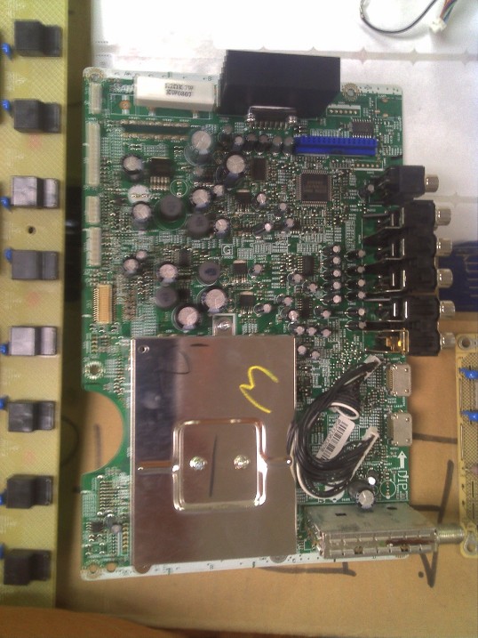

              I'm getting just the white glowing screen. As far as I can tell, no sound. The friend that wants it fixed had no remote. There's no sound when I have a source hooked up to either HDMI port or coax. The laptop I use can provide sound over HDMI. I'm not certain about the TV though. Coax should of brought something up though.
              I tested what I believe was the transistors. They're a bit weird though. I've attached some files with their values. If a prong doesn't have a value next to it, it was either 0vdc or close to it like 1.5mv. I thought they'd at least have values on two of the prongs. Are these the parts I should be testing?

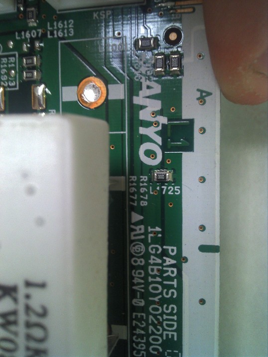

                            Originally posted by cashkennedy
                            But as long as you pay the shipping, Id be happy with that, but you could throw in 10-20 if you want to pay for it.
                            Just be sure it will have the part you need, before paying for the shipping and all.
                            I'd definitely pay you for it. Is there a part number on it? This one has a part number of 1lg4b10y02200. The part number on this one is next to the big heat sink. Real close to the left corner when you have the plug in connectors facing to the left.
                            Anyway, I need to get some sleep so I'll talk to all of you guys later. Thanks for all the help and good night!
                                Ill get you the part number from the main board tomorrow. But as budm sugested, you might want to try testing what you can first, to make sure nothing else is wrong.

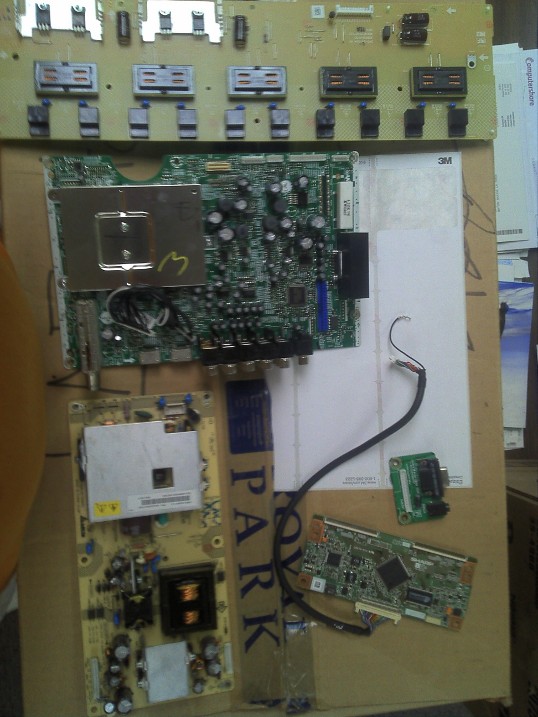

                                • cashkennedy
                                  • Aug 2011
                                  • 668
                                  Part number on the main board is 1LG4B10Y02200. So looks like you might be in luck if you need any parts from it.
                                  I attached pics to show what all i have, though theres speakers, and cables that arent shown.
                                  Fixed so far 12 lcd's , 1 plasmas, 5 monitors, 0 dlp's (plan to keep the dlps at 0). and 3 atx power supplies, and 2 motherboards.
                                  • Spork Schivago
                                    • Mar 2012
                                    • 4734
                                    • United States of America
                                      Hey, thanks for doing all that. That logic board is the same one I have here. I think I want to try replacing this Q6360 part first. I'd hate to purchase that one for 10-20$ if I can fix this one first. Not because I don't want to spend the 10-20$ but because I'm almost certain you could get more for it on E-bay.
