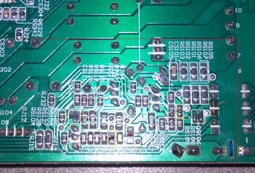

OK, I had the time to trace out the VCC for the 12v SMPS IC 201 (I need the P/N of this IC also to verify). Please see PDF. I am sorry that I have to ask a lot of questions and a lot of pictures request, it is not easy to do remote troubleshooting. I hope we will get some where, and may be other people will see something I may have missed.
I am not getting the 12v feed from the power board to the main board while the vizio is white. get 2volts off the inverter on/off pin. not sure what to start checking next, all caps look ok.
