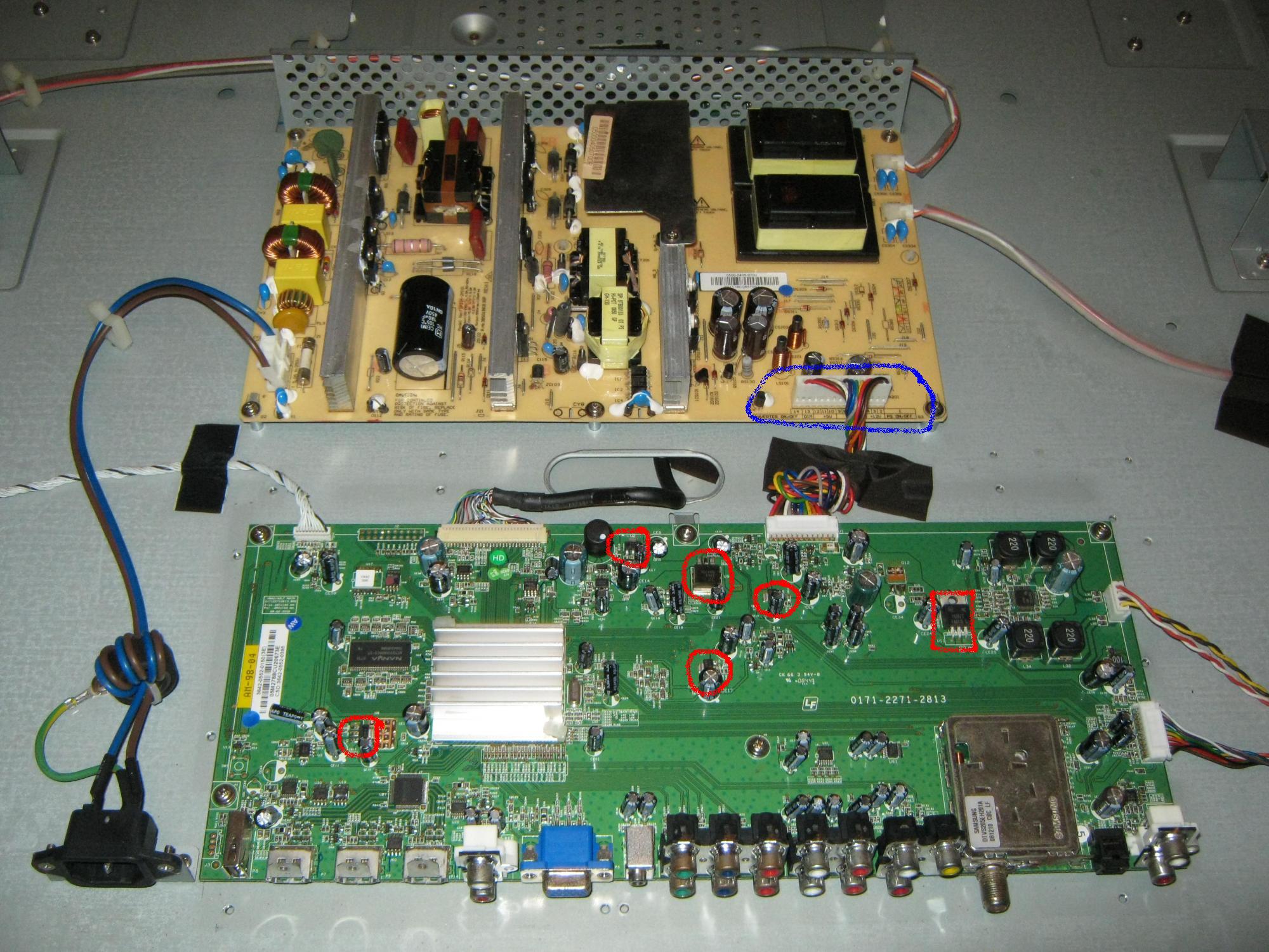

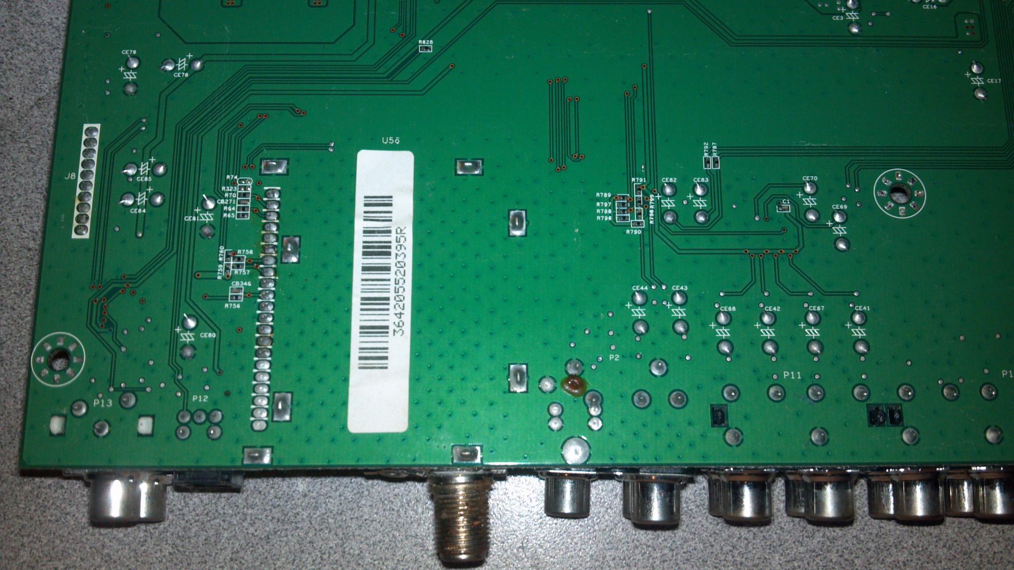

    Ive got a Vizio VS420LF1A and having an issue with it:
    When power is connected, Vizio logo glows orange,
    i press power button... the logo turns to white and that's it. I see nothing on the screen, i don't see the back light come on, just a solid white Vizio Logo showing its powered on.
    I opened it up and looked for the obvious things like bulging/leaky caps
    and everything appears ok.
    I also took a flash light and tried to look closely at the panel when it was on to see if i could see anything on the screen (like if the back light wasn't working, but the display itself was) and i see nothing.
    Any suggestions on what to look into fixing/replacing would be much appreciated.

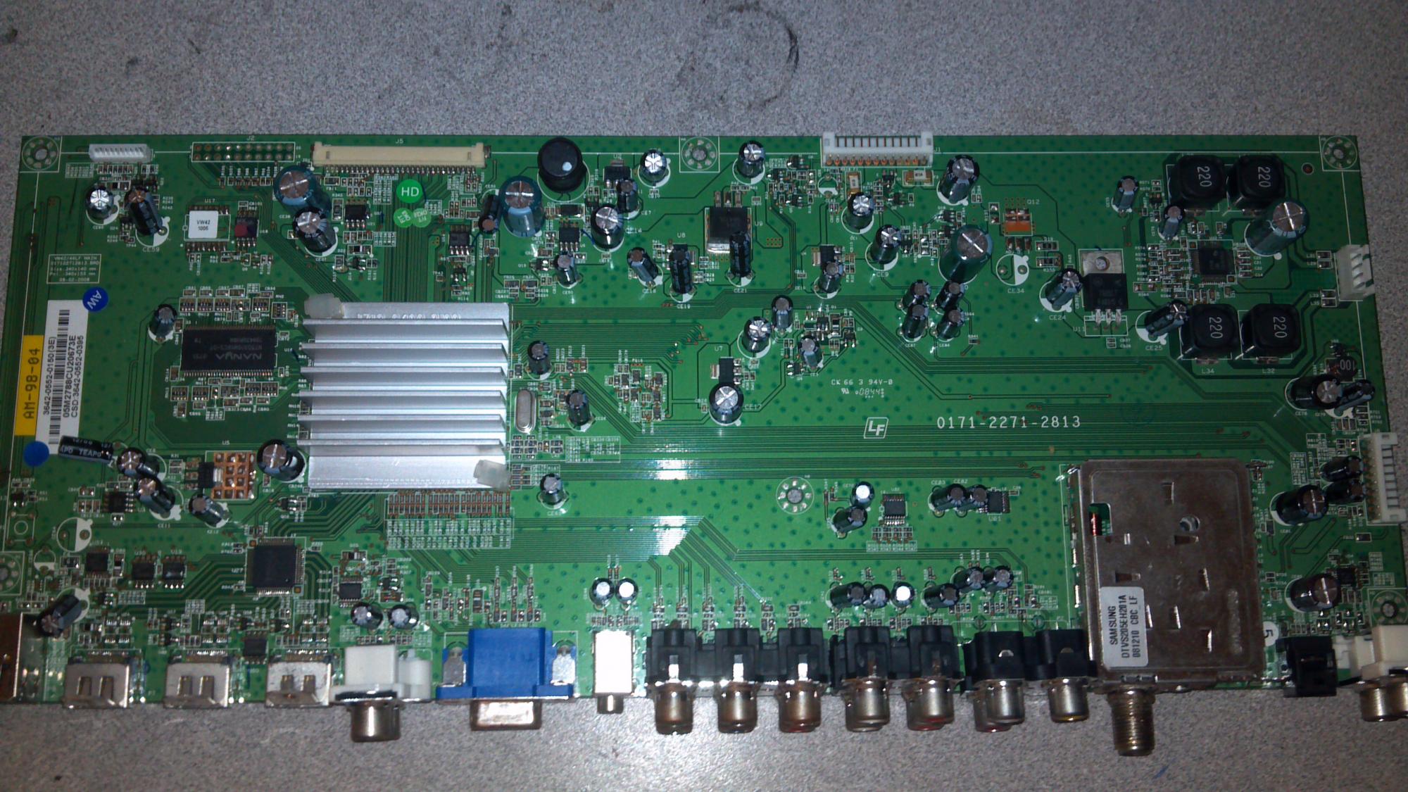

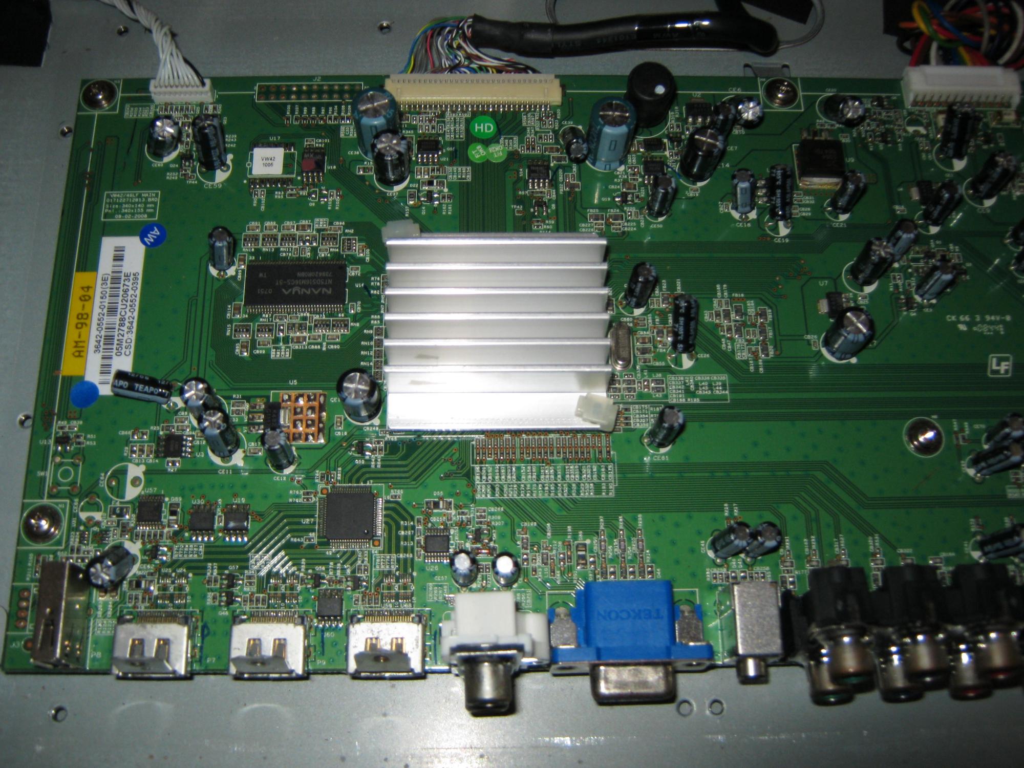

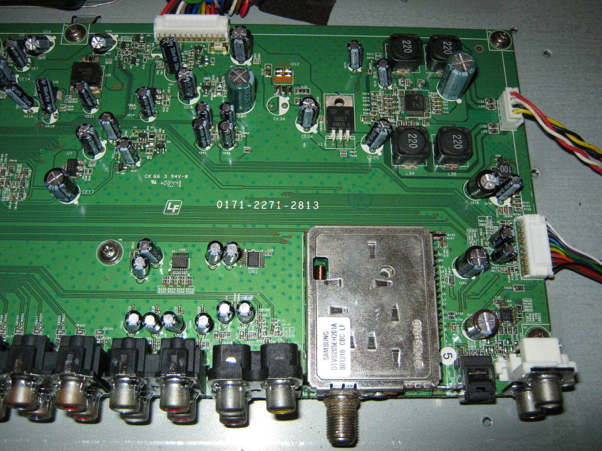

    1) Please post clear focused top down view pictures of all your boards following my instructions in my sig file below exactly.
    2) Please state if you have a multimeter and are familiar with measuring voltage and resistance?

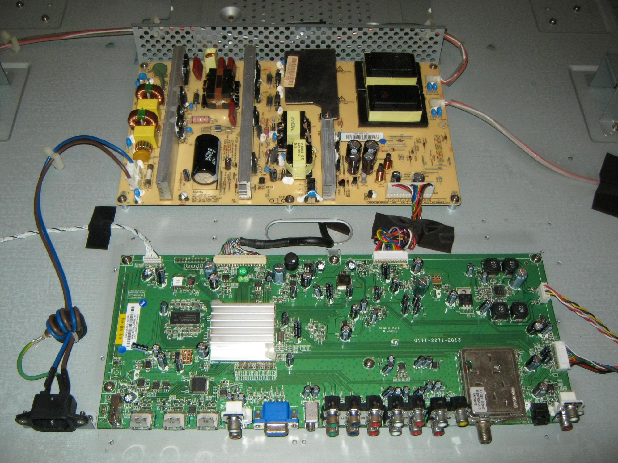

      Re: Vizio VS420LF1A No picture/backlight
      Attached are the pictures, I do have a multimeter and I am familiar with how to use it.
      Thanks for your help

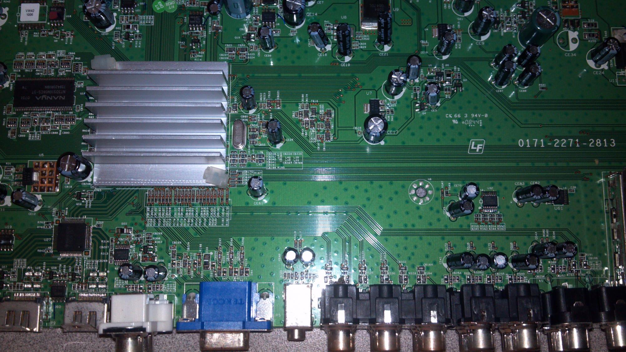

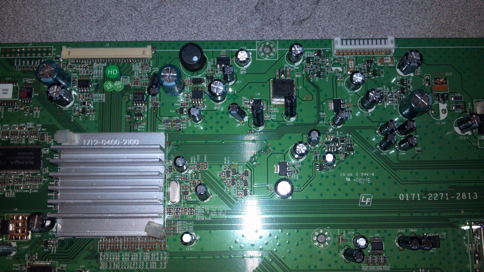

            1) Vizio TVs, for whatever reason, seem to use or have bad voltage regulators.
            2) All the red circled components are regulators.
            3) List the part number for each.
            4) Measure the DC voltage of each pin (ignore the fat tab) for every regulator.
            5) Report each part number and readings.
            6) The blue circled component is the connector. Measure the DC voltage of each pin and report the legend (what is written on the pcb) and your findings. Pin 14 is your inverter on/off.

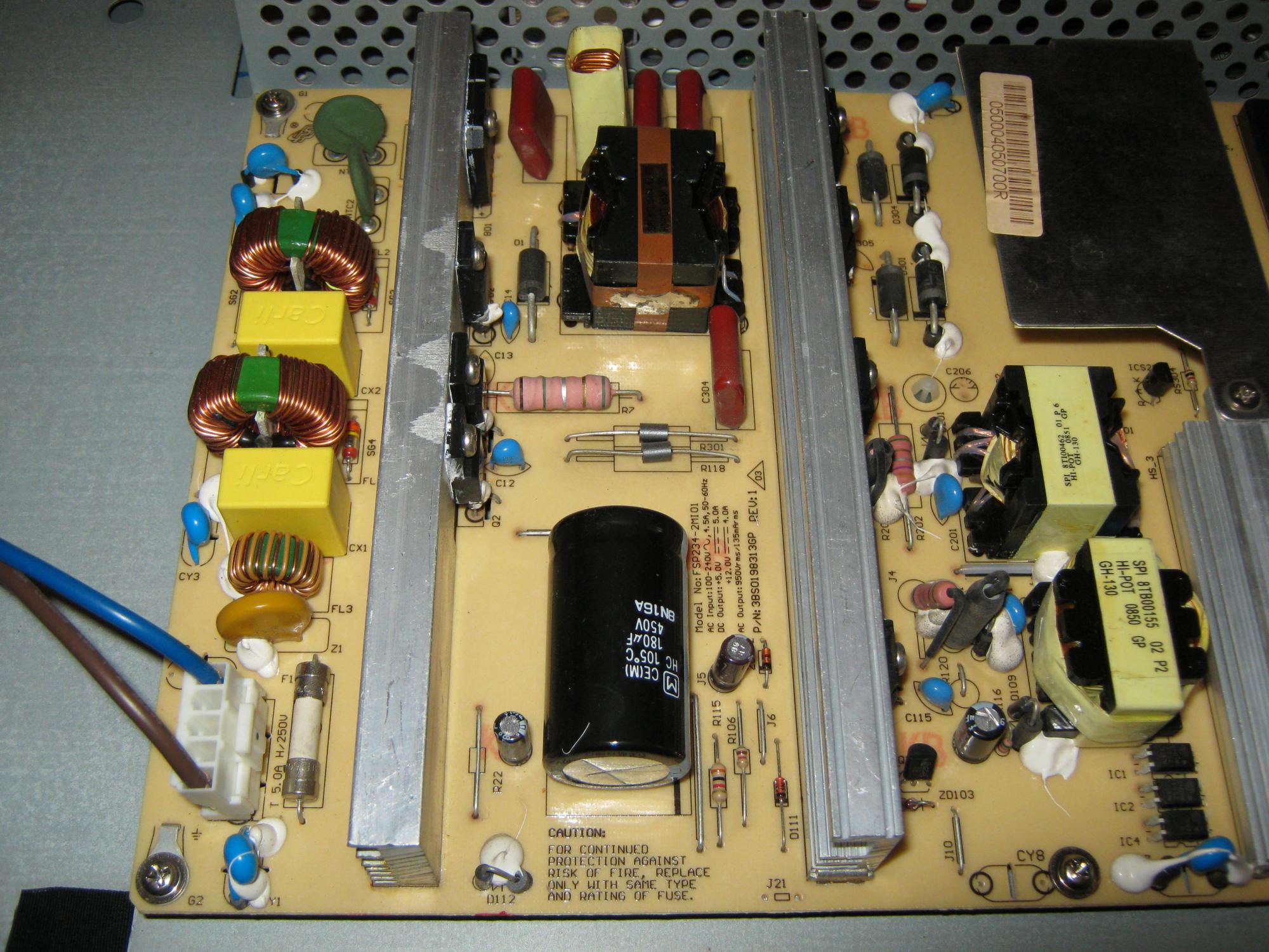

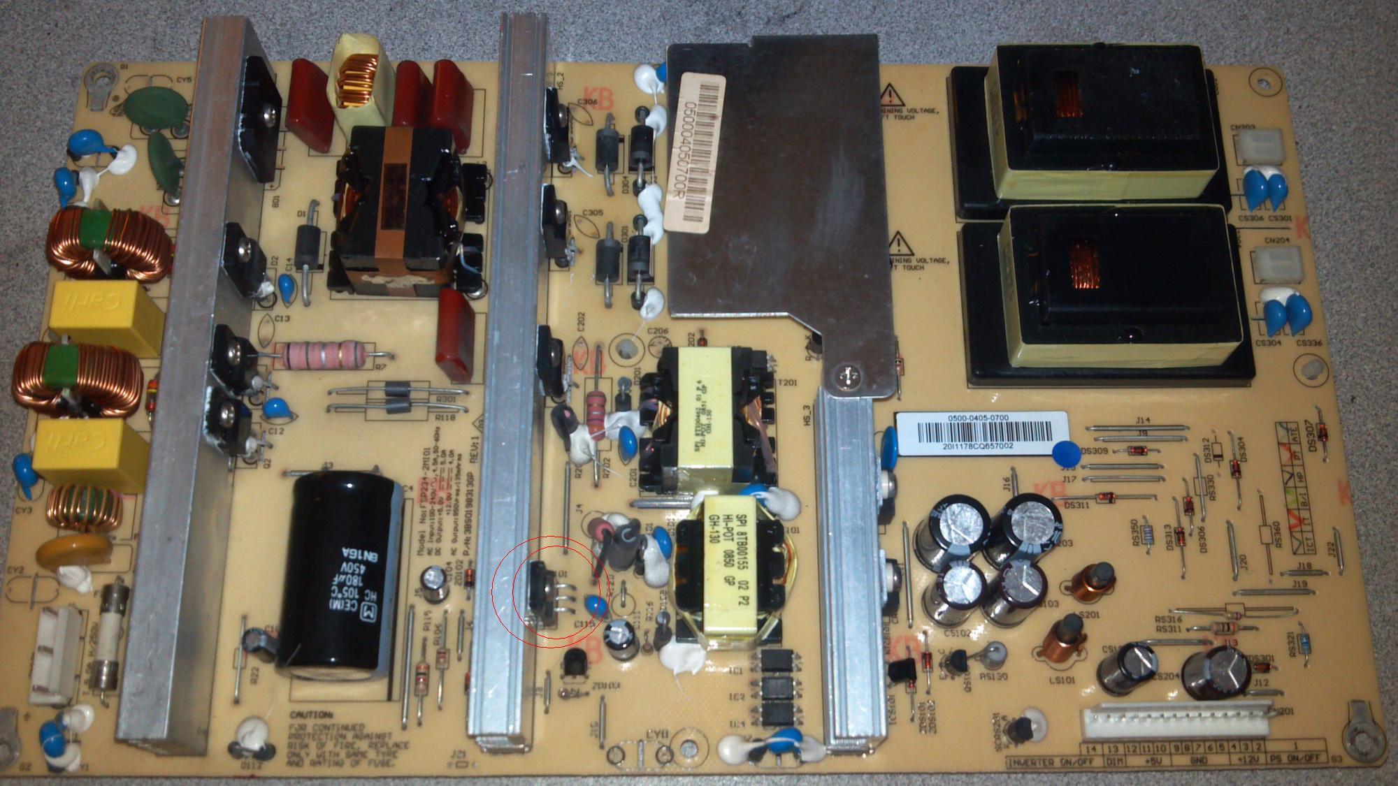

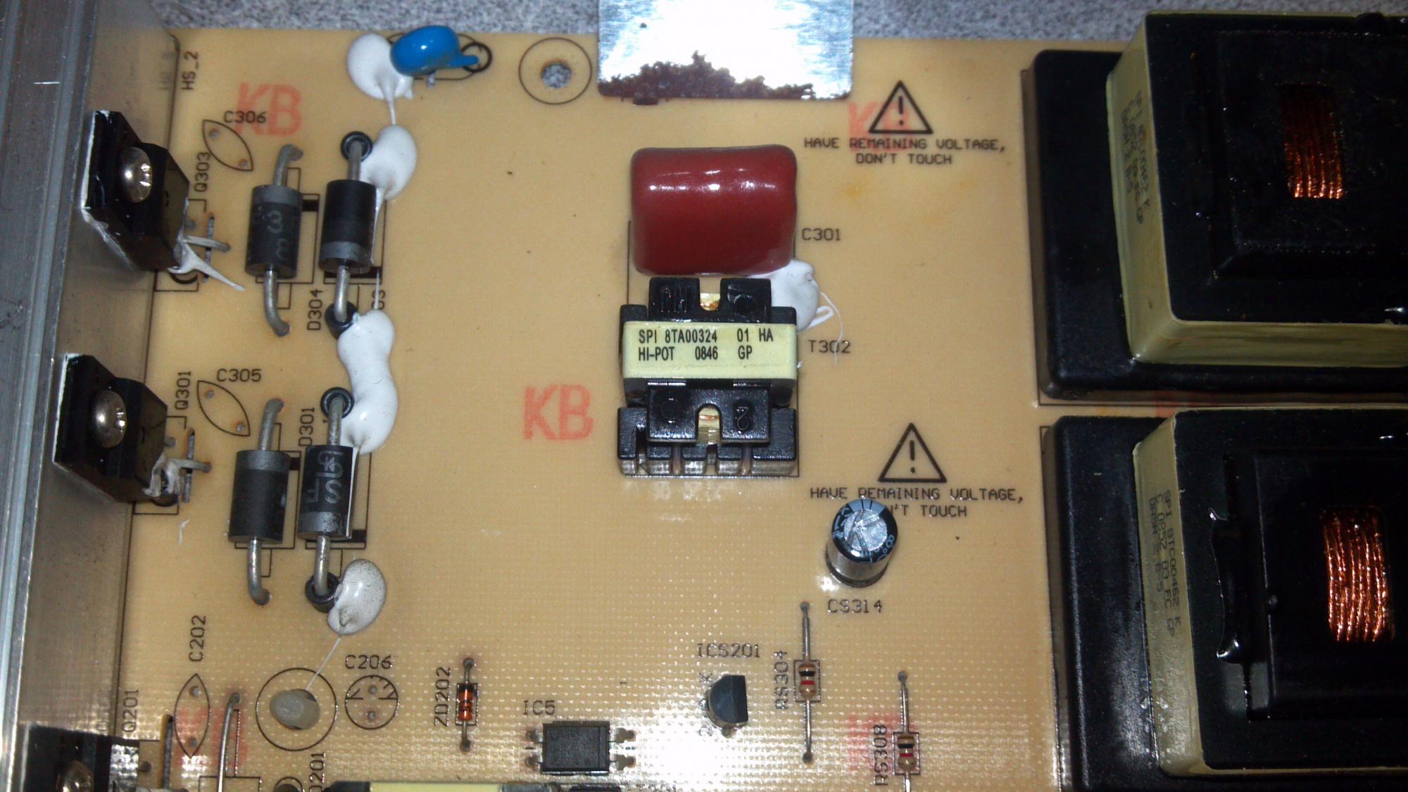

                  You have power supply with PFC Voltage booster plus inverter. it is all in one board.
                  Check the DC voltage on that large 450Vdc with the TV OFF, you should read about 165~175Vdc, then turn on the TV, you should see the voltage goes up to about 380~400Vdc if the PFC is working, if it does, that means the PS_ON signal is OK. If not then it can be bad PFC or no PS_ON signal from the main board.
                  The two inverter transformers on the right of the pictures are driven by MOSTFET's which uses the 380~400Vdc voltage for the inverter circuits instead of the usual 24Vdc power supply.
                  Can we get the close up pictures of the connectors on the power supply/Inverter board so we can see the labels on them.
                  By the way, do not run the board without the high voltage wires from the lamp assemblies connected (the two white connectors on the top right of the picture of the power supply/inverter board)
                    Ok i read the voltage on the 450vdc
                    it read 165v in standby, after powering the tv on, it went up to 387v.
                    Attached is the requested pics
                      OK, PFC and PS_ON are OK. We will now have to find out why the 12vdc PS not putting out. What do you get at Pin 14 the inverter ON/OFF line?
                      By the way, we nned real good pictures of the power supply board top and bottom sides, then picture 1/4 section each of the baord that we we can see the deatils of how the traces are connected. I need to trace out where the PS_ON goes to beside the PFC section.

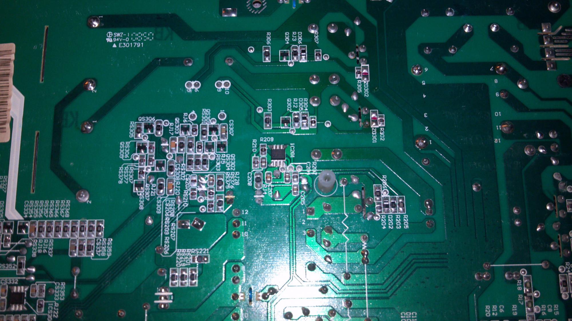

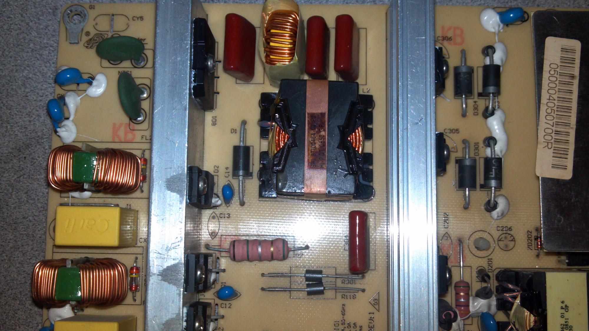

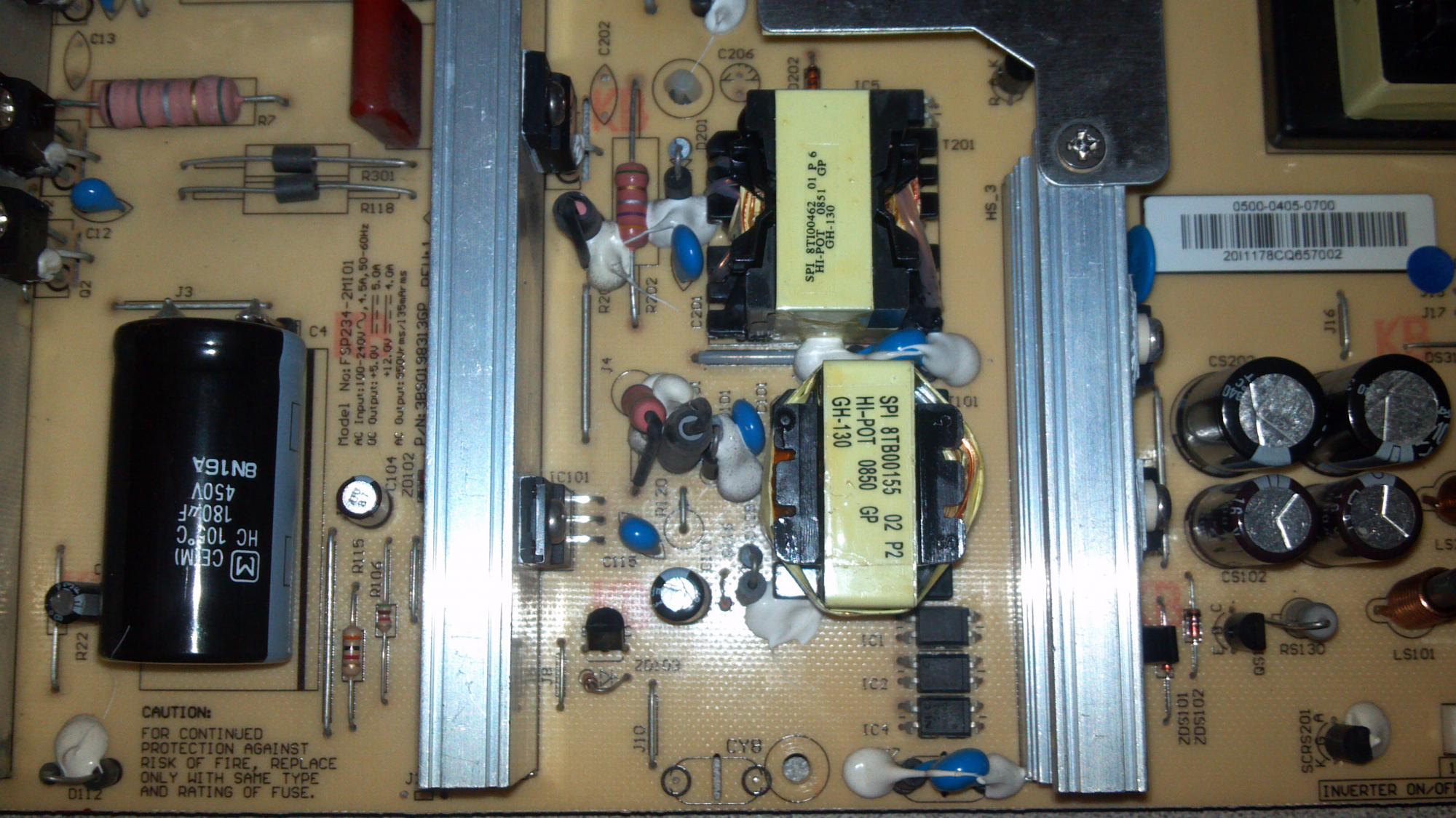

                              Did you need different pictures then the ones already posted? If so what exactly should i take pics of?

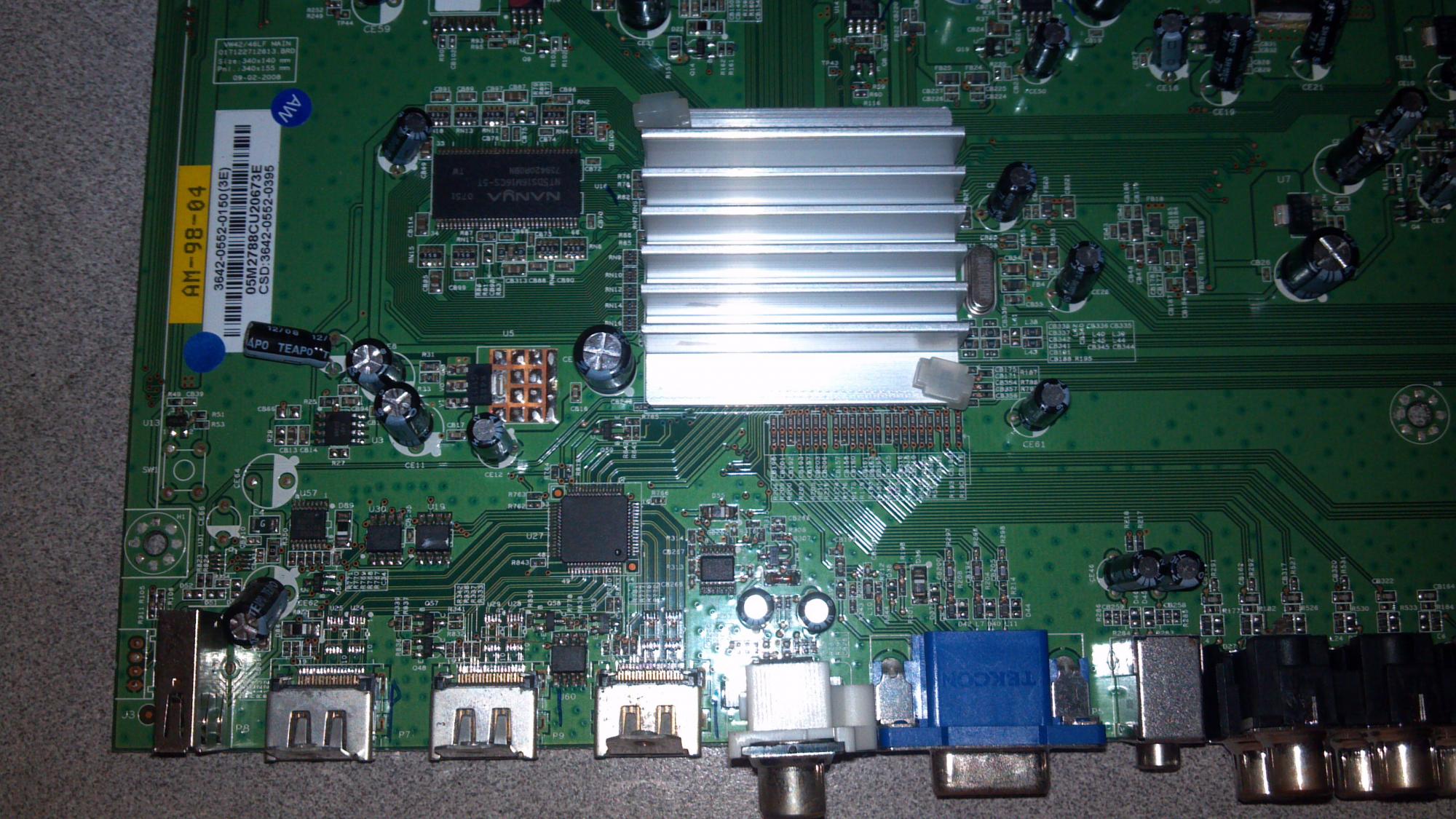

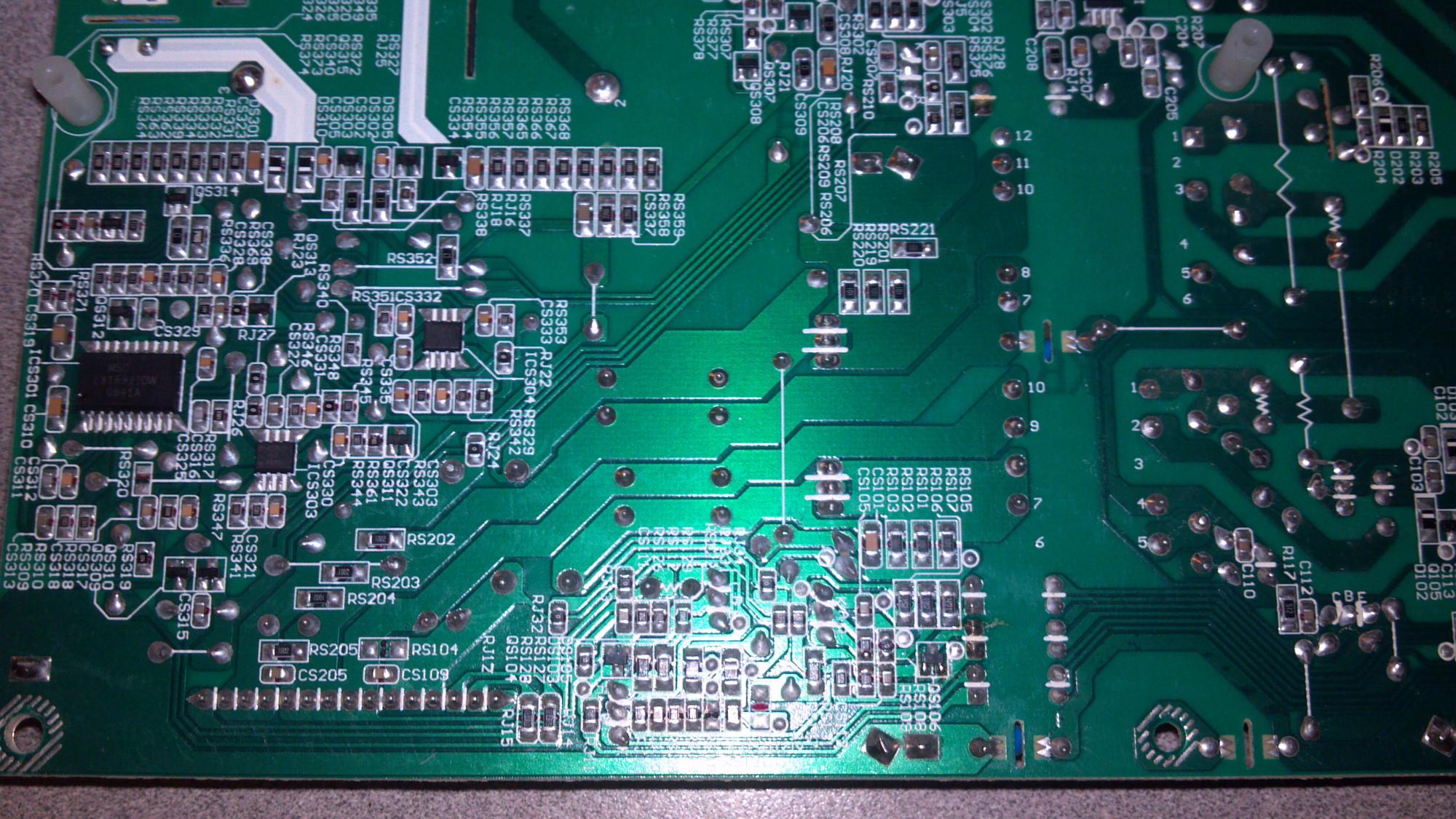

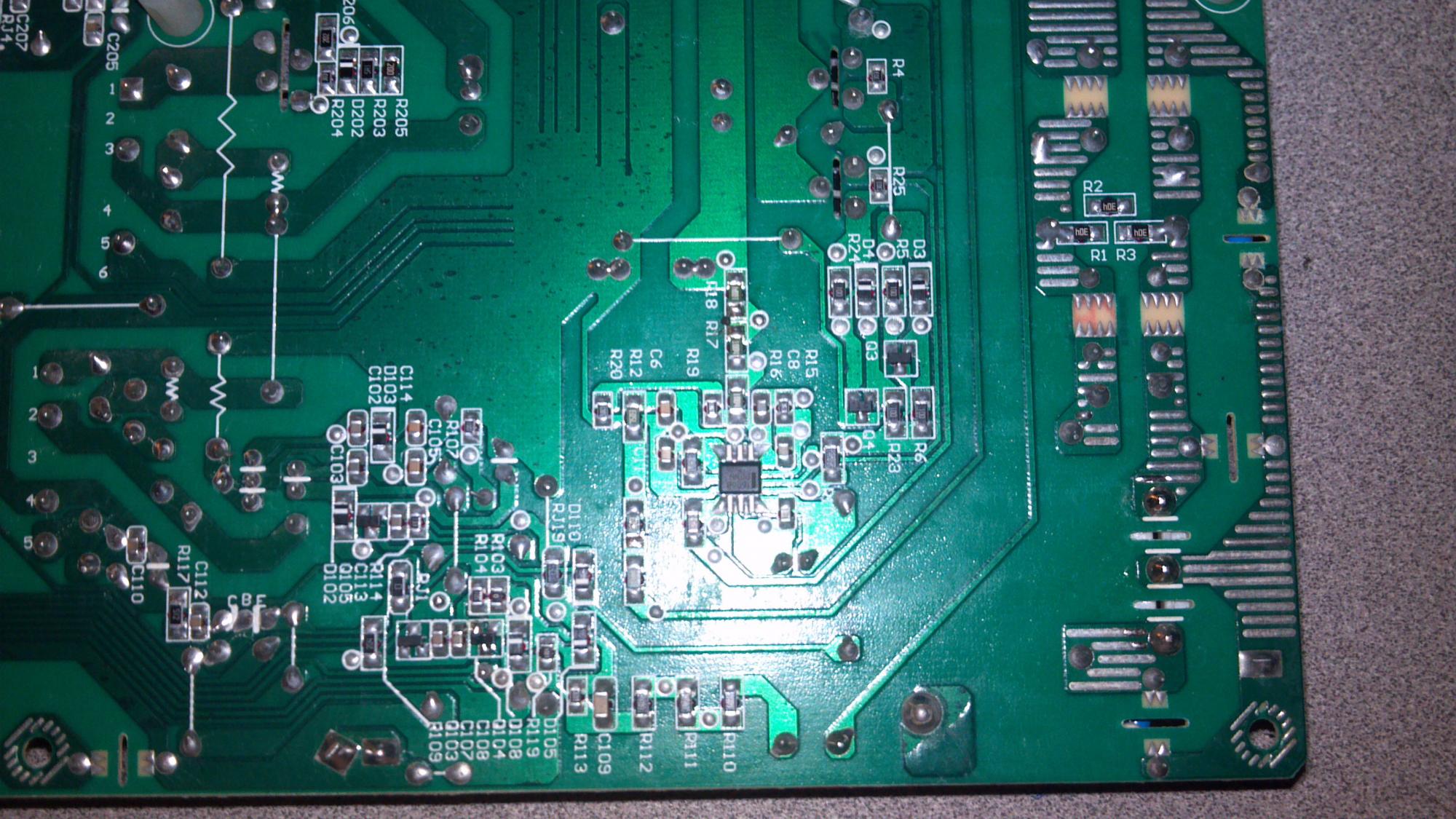

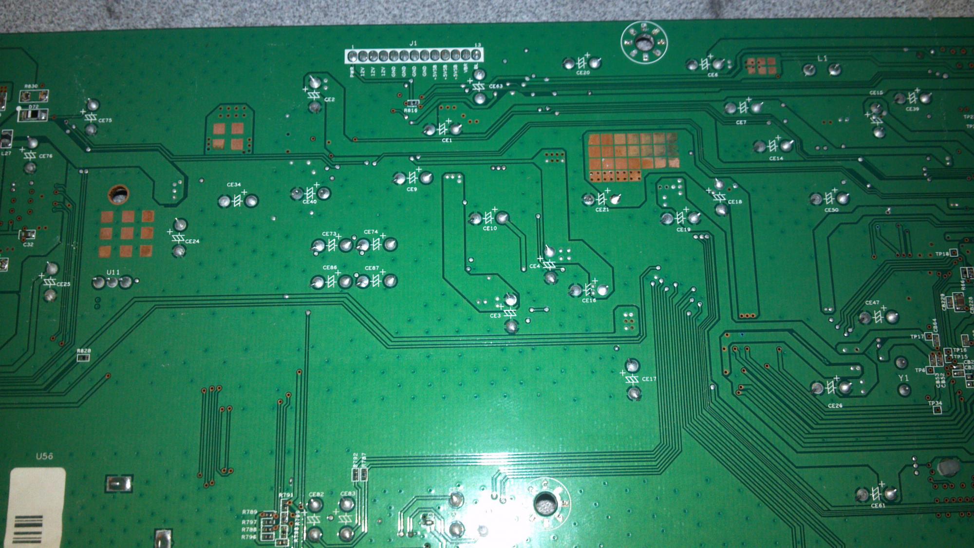

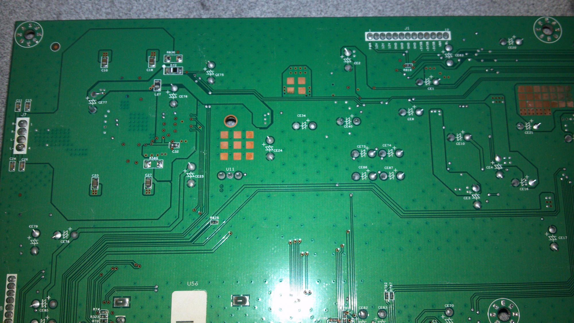

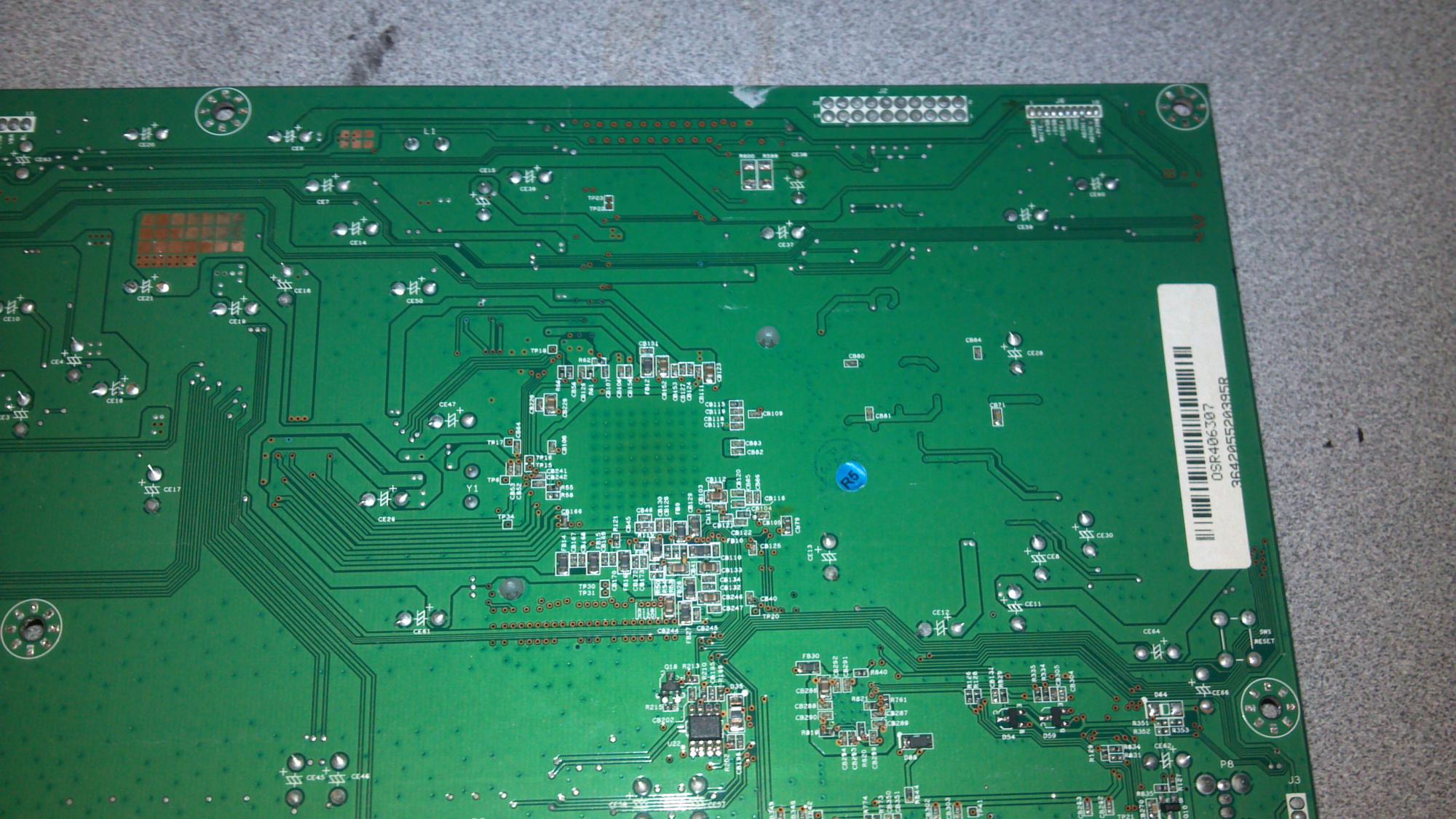

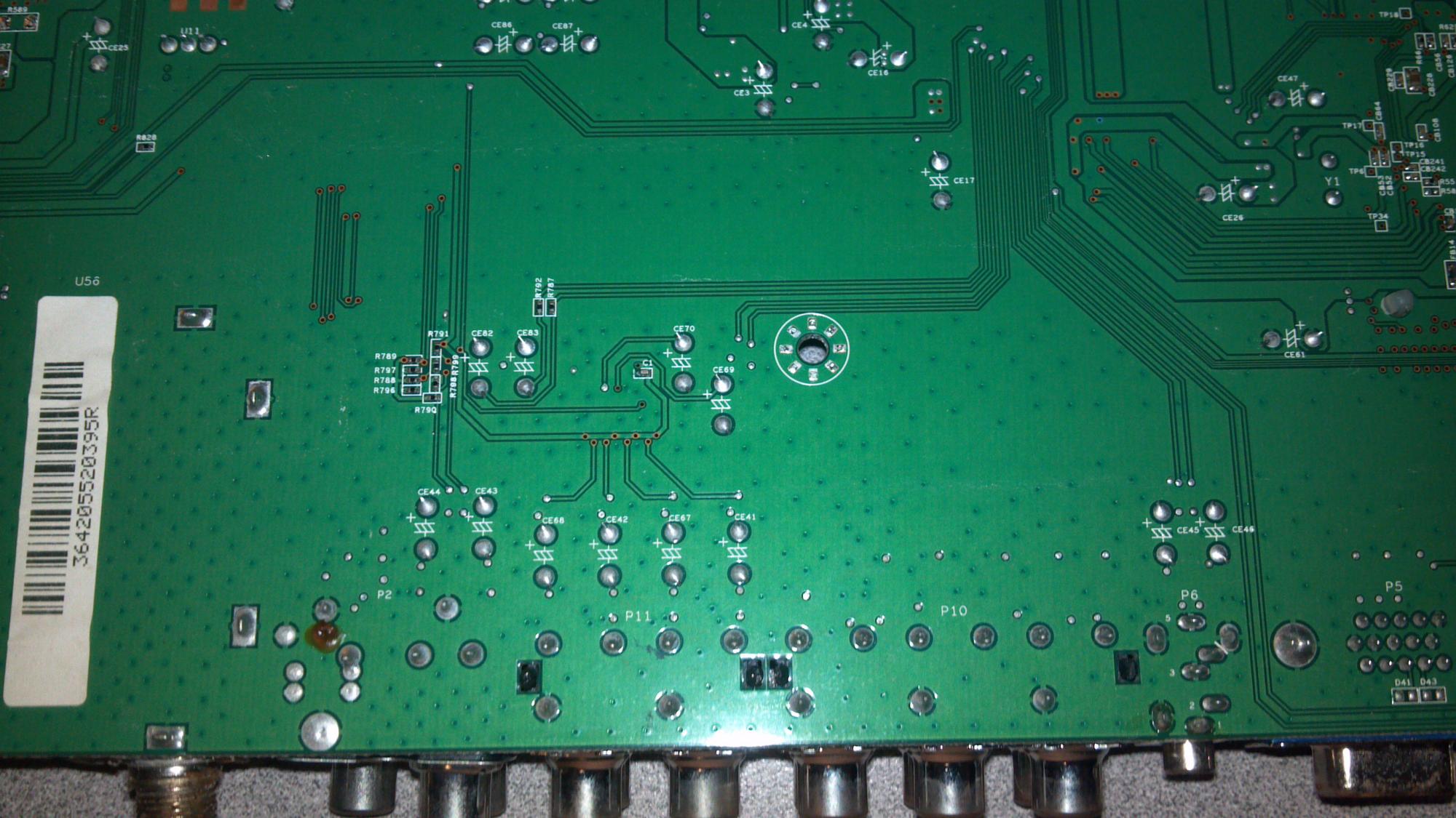

                                I cannot see the whole board, I need to be able to see the components side, traces on the board VERY CLEARY so I can trace out the connections, without that it will be just impossible to troubleshoot down to component level from long distant. It is like trying to do surgery blindfolded.
                                Pictures of the whole board top and bottom, and 1/4 section of the board each.
                                At this point it looks like the problem is in the power supply/inverter baord, but we need to verify first.
                                  Here are the pics, please let me know if you need any retakes, i tried to do the best i could but my camera isn't so great.
                                  Also just wanted to say thanks for spending your time helping me out with this.
                                    And heres the rest...
                                      OK, thanks for the pictures, I will download them and see if I can trace out the connections, it will be awhile.
                                        Can you please get the number as printed on the IC circled in red?
