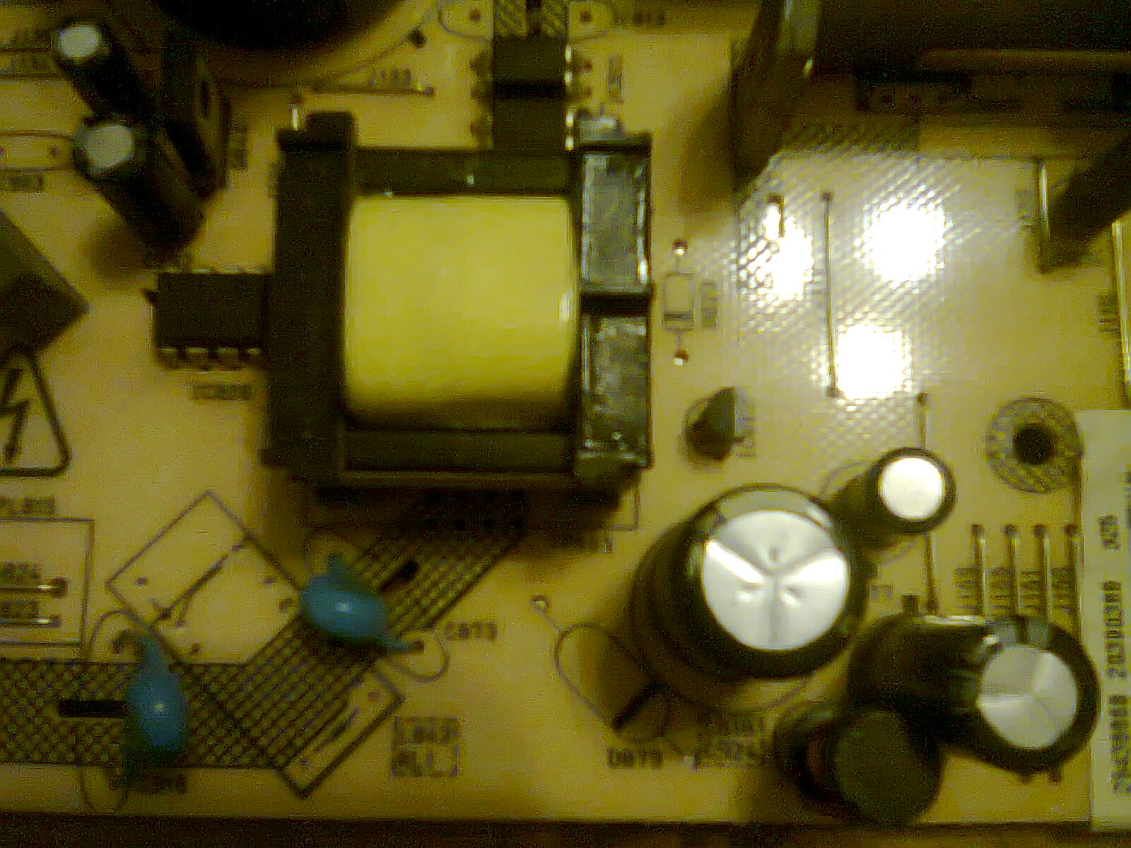

Acoustic solutions LCD26761HDF no backlight
  • sienoki
    replied
    Re: Acoustic solutions LCD26761HDF no backlight
    Originally posted by selldoor
    Rubber gloves and wellies!!
    Set your meter on 600volts DC - Red positive lead on positive leg of capacitor and black negative lead on negative leg of capacitor. Put the meter where you can easily see it without moving.
    That was scary but no permed hair lol
    standby .946VDC
    tv on 2.874VDC
    .045 VAC &1.380 VAC from OL the readings werent steady they were up & down
    Forgot i had this buried in cupboard..it read 400V in standny & tv on..thx
    http://i1068.photobucket.com/albums/...5/P1000823.jpg
    Should i recap all the psu caps with panasonics as they are all different named brands..or just hang on for now..thx
    Last edited by sienoki; 03-03-2012, 06:22 PM.
    Leave a comment:
  • selldoor
    replied
    Re: Acoustic solutions LCD26761HDF no backlight
    Rubber gloves and wellies!!
    Set your meter on 600volts DC - Red positive lead on positive leg of capacitor and black negative lead on negative leg of capacitor. Put the meter where you can easily see it without moving.
    Just looked at your meter DC is the Flat bar with 3 dots under it and the V. Take care as I notice the
    probes are broken and possibly cracked? For this voltage Id tape them up a bit.
    Last edited by selldoor; 03-03-2012, 05:38 PM. Reason: meter
    Leave a comment:
    replied
    Re: Acoustic solutions LCD26761HDF no backlight
    Originally posted by sienoki
    Your wanting me to get blown up lol..how am i testing this safely..thx
    Am i black probe to ground screw and red to + leg of big cap..thx
    http://i1068.photobucket.com/albums/...5/P1000822.jpg
    heres my borrowed multimeter..thx
    Set meter to 1000V or closest range >=500V.
    Red lead on one terminal black on the other.
    Nothing touching ground and don't touch the cap yourself or you'll find out that it hurts a lot.
    Leave a comment:
  • sienoki
    replied
    Re: Acoustic solutions LCD26761HDF no backlight
    Originally posted by tom66
    What is the voltage across the big main cap in operation and when in standby?
    Your wanting me to get blown up lol..how am i testing this safely..thx
    Am i black probe to ground screw and red to + leg of big cap..thx
    http://i1068.photobucket.com/albums/...5/P1000822.jpg
    heres my borrowed multimeter..thx
    Last edited by sienoki; 03-03-2012, 05:14 PM.
    Leave a comment:
    replied
    Re: Acoustic solutions LCD26761HDF no backlight
    What is the voltage across the big main cap in operation and when in standby?
    Leave a comment:
  • sienoki
    replied
    Re: Acoustic solutions LCD26761HDF no backlight
    Originally posted by sienoki
    http://i1068.photobucket.com/albums/...5/P1000811.jpg
    http://i1068.photobucket.com/albums/...5/P1000812.jpg
    http://i1068.photobucket.com/albums/...5/P1000813.jpg
    http://i1068.photobucket.com/albums/...5/P1000814.jpg
    http://i1068.photobucket.com/albums/...5/P1000816.jpg
    http://i1068.photobucket.com/albums/...5/P1000817.jpg
    http://i1068.photobucket.com/albums/...5/P1000820.jpg
    http://i1068.photobucket.com/albums/...5/P1000818.jpg
    http://i1068.photobucket.com/albums/...5/P1000819.jpg
    Any help plz to where i can start testing..thx
    Leave a comment:
  • sienoki
    replied
    Re: Acoustic solutions LCD26761HDF no backlight
    Originally posted by sienoki
    Are these pics better for tracing 24v line..thx
    My pics wont upload can i show them with another method..thx
    http://i1068.photobucket.com/albums/...5/P1000810.jpg
    http://i1068.photobucket.com/albums/...P1000796-1.jpg
    hope its ok for now using this method..thx
    Leave a comment:
  • sienoki
    replied
    Re: Acoustic solutions LCD26761HDF no backlight
    Originally posted by sienoki
    Im still stumped for getting my hands on a decent camera for now..i came across another forum while googling this model faults & 1 suggestion was to replace C802 & C934 the 2 block reddish caps which markings are 105K 450MFF & IC802 which is underneath them 2 caps ic marking E131 FAN7529..can any1 shed any light on this..thx
    On the schematics ive attached that IC802 is a IRF7314 but i dont know owt about schematics..thx
    Are these pics better for tracing 24v line..thx
    My pics wont upload can i show them with another method..thx
    Last edited by sienoki; 03-03-2012, 02:44 PM.
    Leave a comment:
  • sienoki
    replied
    Re: Acoustic solutions LCD26761HDF no backlight
    Originally posted by sienoki
    I missed 28 pin just realised doh..can retest if needed..too many paint fumes from decorating..what would be my next step..thx
    Im still stumped for getting my hands on a decent camera for now..i came across another forum while googling this model faults & 1 suggestion was to replace C802 & C934 the 2 block reddish caps which markings are 105K 450MFF & IC802 which is underneath them 2 caps ic marking E131 FAN7529..can any1 shed any light on this..thx
    On the schematics ive attached that IC802 is a IRF7314 but i dont know owt about schematics..thx
    Last edited by sienoki; 03-02-2012, 05:55 PM.
    Leave a comment:
  • sienoki
    replied
    Re: Acoustic solutions LCD26761HDF no backlight
    Originally posted by sienoki
    Sorry for measuring white pin out not properly 1-27
    1--0v 2--0v
    3--0v 4--07.9
    5--0v 6--0v
    7--0v 8--0v
    9--0v 10--0v
    11--11.8v 12--11.8v
    13--0v 14--05.0v
    15--03.2v 16--03.2v
    17--05.0v 18--03.3v
    19--05.0v 20--03.2v
    21--0v 22--03.2v
    23--0v 24--0v
    25--24.3v 26--24.2v
    27--24.3v
    I missed 28 pin just realised doh..can retest if needed..too many paint fumes from decorating..what would be my next step..thx
    Leave a comment:
  • sienoki
    replied
    Re: Acoustic solutions LCD26761HDF no backlight
    Originally posted by sienoki
    From the underside the 1st smd from the black connector is D861 a small black diode im presuming?this reads 806 one way & 198 the other..if this is a diode im guessing this is faulty right?..ive tested the other small smd black diodes & readings 1 way & stays on 1 the other..thx
    Tested that diode with my fluke as i tested it prior with my cheapy multimeter..readings from .OL it gives 1 beep & .208 the reverse .722
    The only markings on that D861 is AP..thx
    Ive found this while googling does it help till i can chase a decent camera thx..it was in another tv forum & said it was same layout..thx
    Sorry for measuring white pin out not properly 1-27
    1--0v 2--0v
    3--0v 4--07.9
    5--0v 6--0v
    7--0v 8--0v
    9--0v 10--0v
    11--11.8v 12--11.8v
    13--0v 14--05.0v
    15--03.2v 16--03.2v
    17--05.0v 18--03.3v
    19--05.0v 20--03.2v
    21--0v 22--03.2v
    23--0v 24--0v
    25--24.3v 26--24.2v
    27--24.3v
    Leave a comment:
  • sienoki
    replied
    Re: Acoustic solutions LCD26761HDF no backlight
    Originally posted by budm
    Please make sure to put the camera in MACRO mode for good close up pictures.
    From the underside the 1st smd from the black connector is D861 a small black diode im presuming?this reads 806 one way & 198 the other..if this is a diode im guessing this is faulty right?..ive tested the other small smd black diodes & readings 1 way & stays on 1 the other..thx
    Tested that diode with my fluke as i tested it prior with my cheapy multimeter..readings from .OL it gives 1 beep & .208 the reverse .722
    The only markings on that D861 is AP..thx
    Ive found this while googling does it help till i can chase a decent camera thx..it was in another tv forum & said it was same layout..thx
    Last edited by sienoki; 02-24-2012, 06:23 PM.
    Leave a comment:
    replied
    Re: Acoustic solutions LCD26761HDF no backlight
    Please make sure to put the camera in MACRO mode for good close up pictures.
    Leave a comment:
  • sienoki
    replied
    Re: Acoustic solutions LCD26761HDF no backlight
    Originally posted by budm
    The first two pictures are really out off focus, I can hardly trace out the traces from the black connector to the surface mounted components.
    I,ll have to borrow a decent camera as mine is s..t
    Leave a comment:
    replied
    Re: Acoustic solutions LCD26761HDF no backlight
    The first two pictures are really out off focus, I can hardly trace out the traces from the black connector to the surface mounted components.
    Leave a comment:
  • sienoki
    replied
    Re: Acoustic solutions LCD26761HDF no backlight
    Originally posted by budm
    One of those pin on the White connector with double-row pin on the right side of the P.S. board will be for PS_ON signal input from the main board, but since the board is not labeled, it will be hard to trace out the connections.
    The red wires on the balck connector on the left side of the board will be the 24vdc out put.
    I agree with Tom66, the good clear pictures of the bottom side of the board may help us tracing out the connections.
    Desoldered that schottky readings are same sequence as 1st test
    just stays on .OL
    1 beep .279
    1 beep .279
    just stays on .OL
    Leave a comment:
    replied
    Re: Acoustic solutions LCD26761HDF no backlight
    One of those pin on the White connector with double-row pin on the right side of the P.S. board will be for PS_ON signal input from the main board, but since the board is not labeled, it will be hard to trace out the connections.
    The red wires on the balck connector on the left side of the board will be the 24vdc out put.
    I agree with Tom66, the good clear pictures of the bottom side of the board may help us tracing out the connections.
    Last edited by budm; 02-24-2012, 03:39 PM.
    Leave a comment:
    replied
    Re: Acoustic solutions LCD26761HDF no backlight
    The STPS20S100CFP is a power schottky, see here: https://cdn.badcaps-static.com/pdfs/...b186bda3b6.pdf
    Post a picture of the underside of the board.
    It is probably 24V.
    Leave a comment:
  • sienoki
    replied
    Re: Acoustic solutions LCD26761HDF no backlight
    Originally posted by budm
    Are there any labeling on the white pin to the right of the power supply board? The one on the top left is for the 24vdc, dimm, and Backlight_ON connectionS which goes to the inverter board.
    All the mosfetts or schottky attached the the heatsinks are marked Q with no on psu...the white pin out PL816 has no labelling or markings any where on psu for output voltages
    Last edited by sienoki; 02-24-2012, 03:18 PM.
    Leave a comment:
    replied
    Re: Acoustic solutions LCD26761HDF no backlight
    Are there any labeling on the white pin to the right of the power supply board? The one on the top left is for the 24vdc, dimm, and Backlight_ON connectionS which goes to the inverter board.
    Leave a comment:
  • triplefour
    by triplefour
    09-13-2023, 10:43 PM
  • DanPoka
    Guide me through repairing a Dell p2210f LCD ccfl backlight monitor
    by DanPoka
    I bought this p2210f dell monitor to fix. Schematic is the same as p2210.
    Behaviour is that monitors comes on but then backlight switches off almost instantly. If I look with flashlight I can still find the "No signal message". So definitely a backlight issue. Trying to advance the issue I proved that the protection circuit is switching off the backlight by shorting out C3 and resistor to disable the INL chip then re enable by removing the short.
    This is where it gets interesting. When I disassembled the monitor to solder leads on c3 capacitor I noticed the backlight flickered...
    02-15-2025, 05:05 AM
  • Comp_Pro
    No Backlight Macbook A1990 820-01041
    by Comp_Pro
    Hello all,
    Am trying to figure out this backlight issue with this A1990 Macbook Pro.
    Tests performed:
    There is no backlight even with a good screen.
    Backlight IC is receiving the correct support voltages.
    Fuse F8400 ok
    Current sense resistor R8400 ok
    Backlight IC is receiving 3.3V on enable pin.
    Backlight IC receiving voltage from PPBUS_G3H, aprox 12.5V.
    Backlight IC receiving 5V from PP5V_G3S
    Backlight IC BKLT_SCL and BKLT_SDA both measure 0.545V diode mode to ground
    I2C_BKLT_SCL and I2C_BKLT_SDA both measure...
    05-06-2024, 10:23 PM
  • jimbofz
    lg 32LC46 backlight inverter board fault
    by jimbofz
    Hi this oldie had no backlight .after replacing caps on 24v rail ,
    still no b/l this uses inverter type:1315 B1-16A,
    im sure ive come across the same inverter in a samsung possibly le32r88bd ?
    all t/x in board test ok ,so i fitted 15k and led to pin 4 of oz964gn ic
    this allows protect to be temporary overridden.
    b/l now comes on
    but the left hand side of pic is gradually darker than the right side
    i have the cct for the tv
    but it does not have inverter cct.
    i opened it up to inspect the ccfl tubes
    and they dont have any...
    12-19-2021, 06:58 AM
  • cheebster
    iPad Pro 12.9 5th Gen Backlight Issue
    by cheebster
    Hello, got an iPad Pro A2378 12.9 5th gen with no backlight. Got another test unit without screen, tested the screen, still no backlight with the test unit.
    Figured out the backlight on the screen was bad, ordred a new backlight from mobilesentrix, *carefully replaced it* without damaging the lcd, oh well.
    Final result, issue is still there, the screen has no back lights. So i'm back to square one, with 3 hours less and 100$ out, issue still on the screen.
    The panel is still ok, i can see the apple in the middle of the screen when it kicks in, just no backlight.
    Anyone...
    05-20-2025, 09:17 AM
