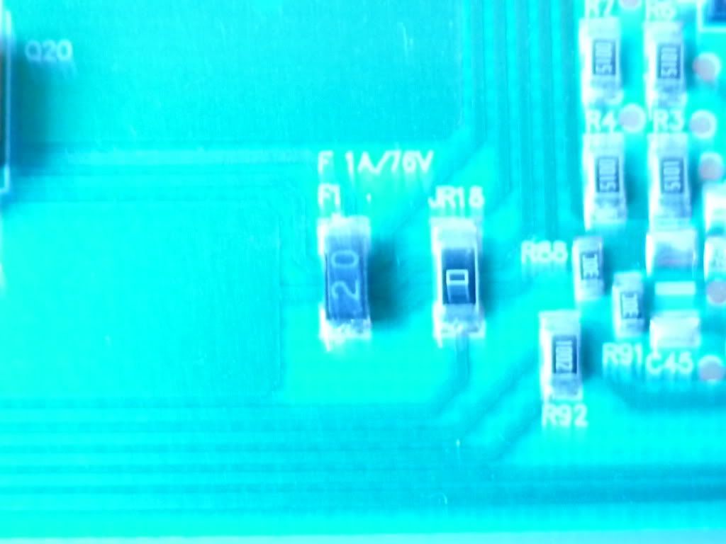

                        Budm while doing them last measurements id thought id check the 24v pin out since ive not checked that since IC fitted..all 4 red wires measure 24v..so i took the shield off & found another fuse F1A/75V which seems to be shorted as no continuity..its got 20 as markings only..thx
                        http://i1068.photobucket.com/albums/...5/P1000915.jpg
                          #92
                          Re: Acoustic solutions LCD26761HDF no backlight
                          That is 1A fuse as printed on the circuit board, where is this fuse at again? I thought you had checked to see if you are getting the 24vdc OUTPUT after installed the new IC!

                            #93
                            No m8 i never checked for 24v after installing new IC..the fuse is on the inverter board..its F1A/76v not 75...should i jump it for now with solder wire till i get a new fuse..what type fuse should i get..thx
                            I checked google for the type of fuse & came across this
                            https://www.badcaps.net/forum/showth...18526...should i try the same procedure..thx
