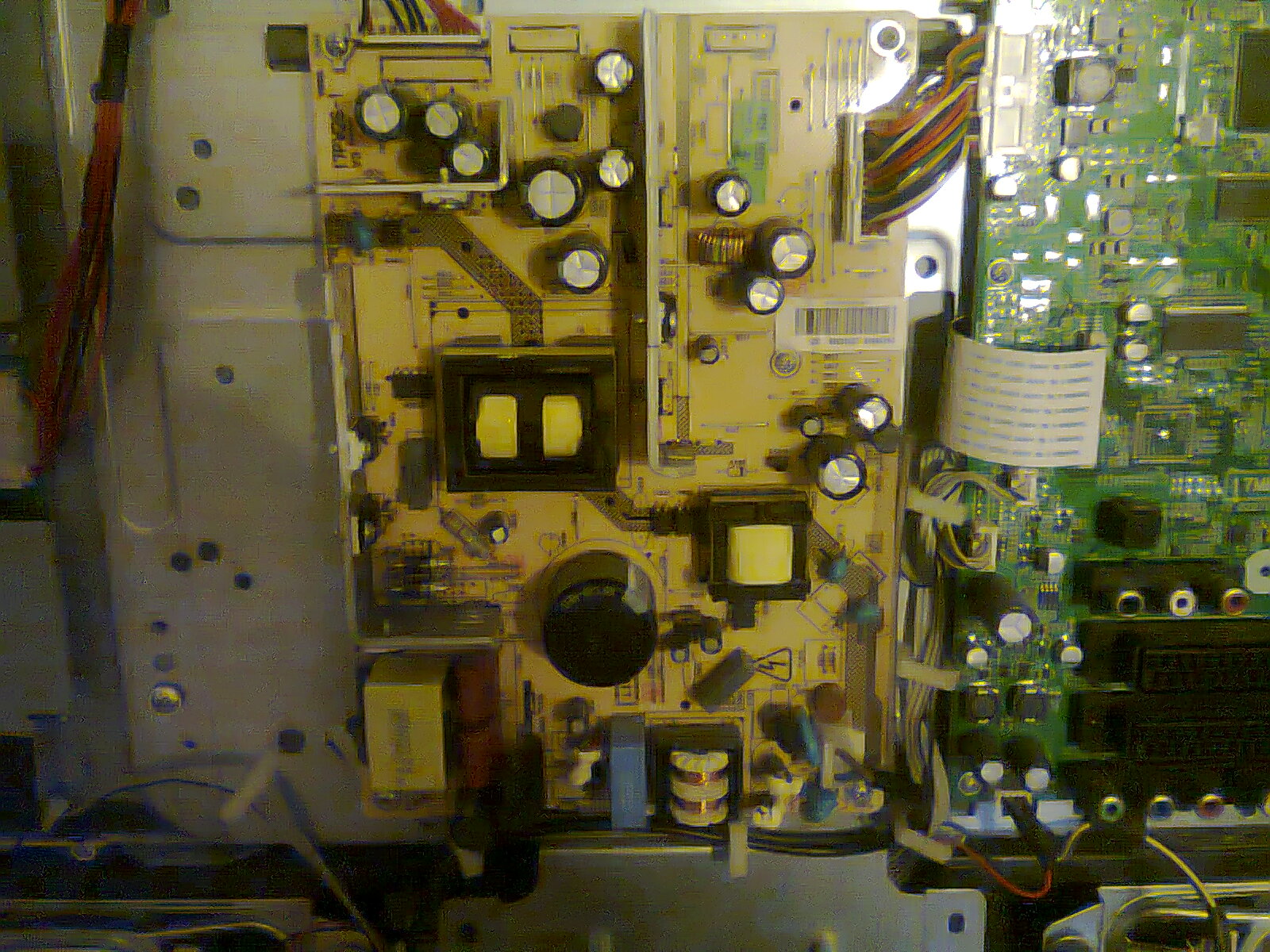

    This set will display an image under flashlight..its got 17PW26-1-V3 psu...17MB35-1 mainboard...VIT70063.50-REV3 inverter board.
    When arial in will only display no signal so not sure on sound..there is no bloated caps..several HEC..SAMXON..CHANG caps on psu.
    Ive tested fuse on psu that tested good..no power going to inverter from checking the 4 red wires as i get no readings

    The 24vdc to the Inverter will not be there until the PS_ON (ABOUT 3.3~5VDC) is supplied by the main board is sent to the power supply to turn on the 24vdc and 12vdc power supply to turn on.

      What should i be checking next..thx

        Readings from mb pin with multimeter on 20v setting & tv switched on
        1.0.00
        2.8.18
        3.2.88
        4.0.00
        5.0.45
        6.0.13
        7.5.09
        8.3.37
        9.0.51
        10.0.51
        11.0.51
        12.0.16

          can any 1 suggest my next step in trouble shooting this set plz..thx
            Re: Acoustic solutions LCD26761HDF no backlight
            Check the diode for the 24V output.
            Any audio?
            This supply might power the main board 5V and 3.3V directly from the standby supply and the inverter from the main supply only.

              Which diode do i test tom..a good diode will have a reading 1 way & OL the other way right?
              Theres dosnt seem to be any audio with tv areil in just says no signal..will get back on to this set when finished decorating house..
              Should i desolder 1 leg of the diodes for a good reading..thx
                The three legged device on the heatsink near the 24V connector is the device I am referring to.
                Fingers work as good antennas sometimes... at least where I am because we are fairly close to Hannington TX.
                I'm asking about the audio because I recall some Vestel sets used 24V to power the audio too so if this is missing you will get no inverter and no audio.
                No need to remove the device unless results are inconclusive.

                  The diode Q827 connected to heatsink closest to the inverter plug on psu is a STPS20S100CFP-7PAAF-VW is this the diode a power schottky rectifier?
                  if so the readings are R-red..B-black measured with fluke77 series II
                  B1-R2=1.069
                  R1-B2=.261
                  B2-R3=.261
                  R2-B3=1.069
                  Theres another 1 on another heatsink same part no schottky which measures
                  same B-R as above with readings of
                  .570
                  .250
                  .249
                  .555
                  do these readings appear correct?

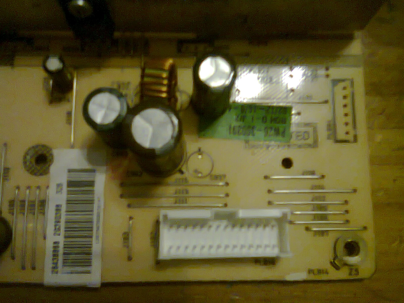

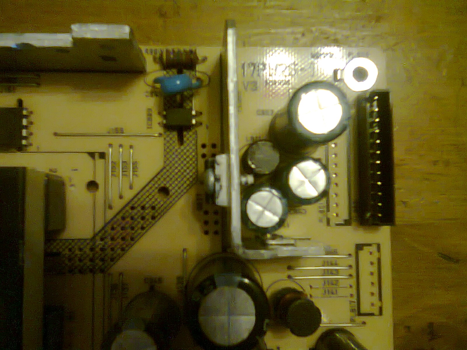

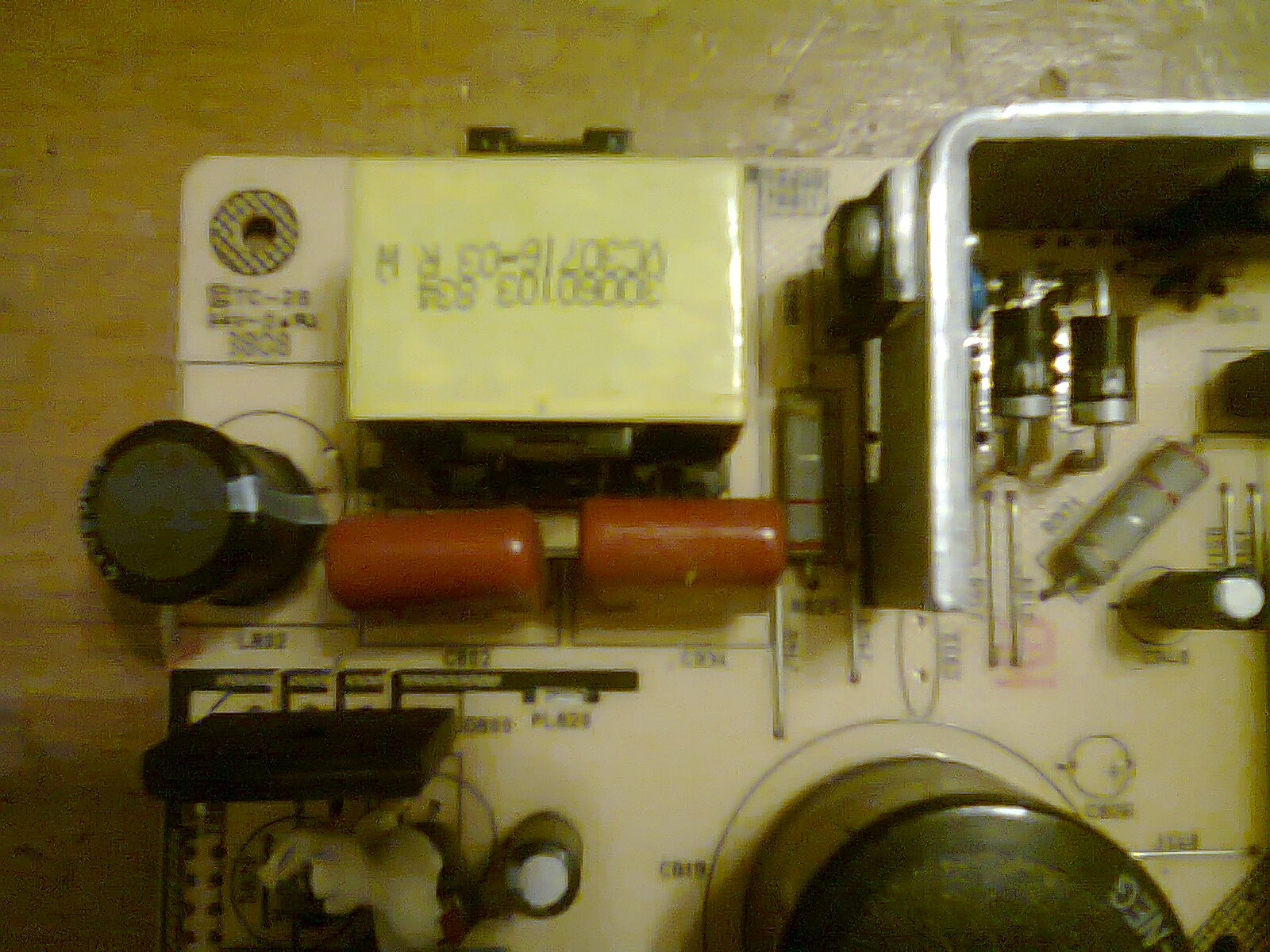

                    Is it definitely a "Q"? Might be a MOSFET then not a schottky. More difficult to test. You will need to remove it first to test it.
                      Are there any labeling on the white pin to the right of the power supply board? The one on the top left is for the 24vdc, dimm, and Backlight_ON connectionS which goes to the inverter board.
                      • sienoki
                        sienoki
                        • Jan 2012
                        • 314
                        All the mosfetts or schottky attached the the heatsinks are marked Q with no on psu...the white pin out PL816 has no labelling or markings any where on psu for output voltages
                          The STPS20S100CFP is a power schottky, see here: https://cdn.badcaps-static.com/pdfs/...b186bda3b6.pdf
                          Post a picture of the underside of the board.
                          It is probably 24V.
                            One of those pin on the White connector with double-row pin on the right side of the P.S. board will be for PS_ON signal input from the main board, but since the board is not labeled, it will be hard to trace out the connections.
                            The red wires on the balck connector on the left side of the board will be the 24vdc out put.
                            I agree with Tom66, the good clear pictures of the bottom side of the board may help us tracing out the connections.

                              Desoldered that schottky readings are same sequence as 1st test
                              just stays on .OL
                              1 beep .279
                              1 beep .279
                              just stays on .OL

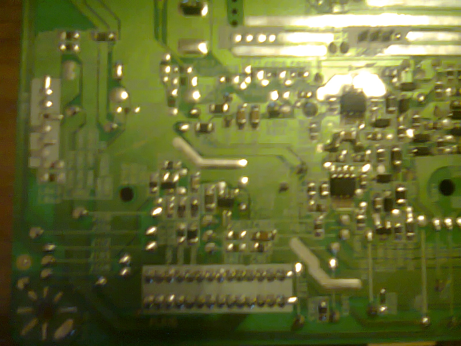

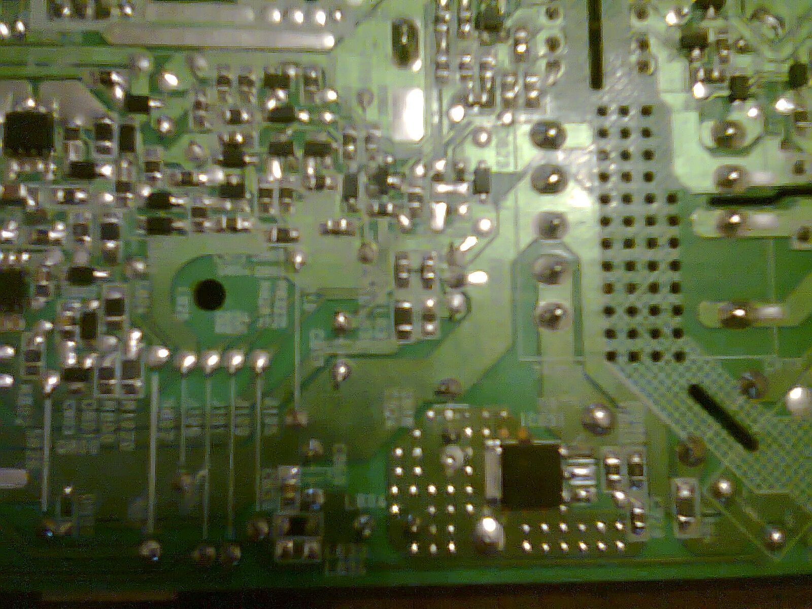

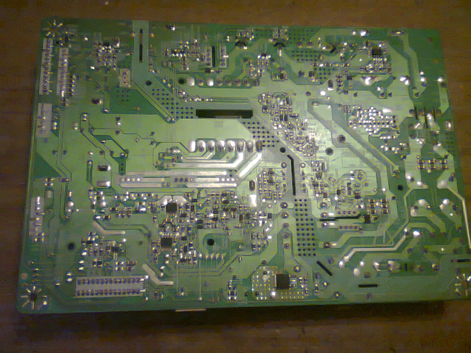

                                The first two pictures are really out off focus, I can hardly trace out the traces from the black connector to the surface mounted components.
                                • sienoki
                                  sienoki
                                  • Jan 2012
                                  • 314
                                  I,ll have to borrow a decent camera as mine is s..t
                                    Please make sure to put the camera in MACRO mode for good close up pictures.

                                      From the underside the 1st smd from the black connector is D861 a small black diode im presuming?this reads 806 one way & 198 the other..if this is a diode im guessing this is faulty right?..ive tested the other small smd black diodes & readings 1 way & stays on 1 the other..thx
                                      Tested that diode with my fluke as i tested it prior with my cheapy multimeter..readings from .OL it gives 1 beep & .208 the reverse .722
                                      The only markings on that D861 is AP..thx
                                      Ive found this while googling does it help till i can chase a decent camera thx..it was in another tv forum & said it was same layout..thx

                                        Sorry for measuring white pin out not properly 1-27
                                        1--0v 2--0v
                                        3--0v 4--07.9
                                        5--0v 6--0v
                                        7--0v 8--0v
                                        9--0v 10--0v
                                        11--11.8v 12--11.8v
                                        13--0v 14--05.0v
                                        15--03.2v 16--03.2v
                                        17--05.0v 18--03.3v
                                        19--05.0v 20--03.2v
                                        21--0v 22--03.2v
                                        23--0v 24--0v
                                        25--24.3v 26--24.2v
                                        27--24.3v
