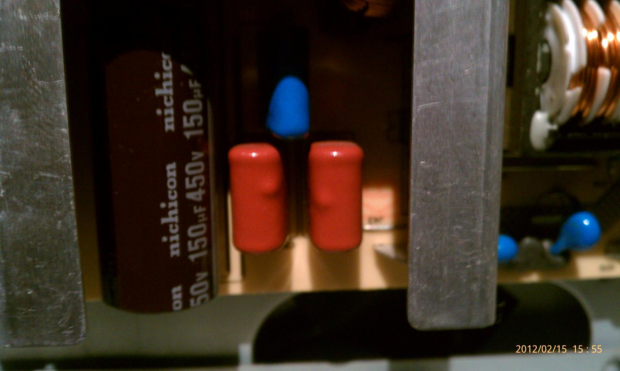

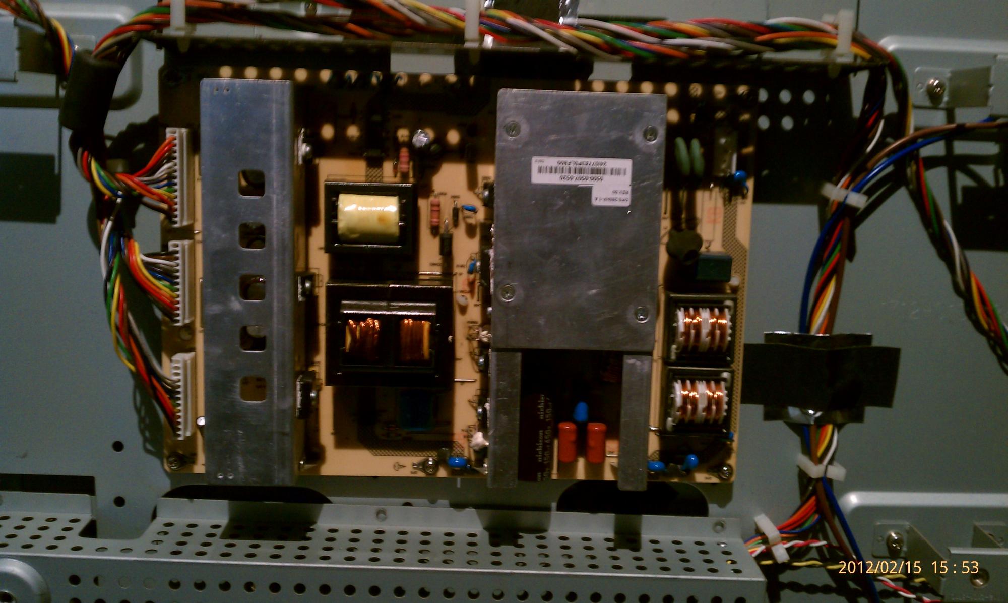

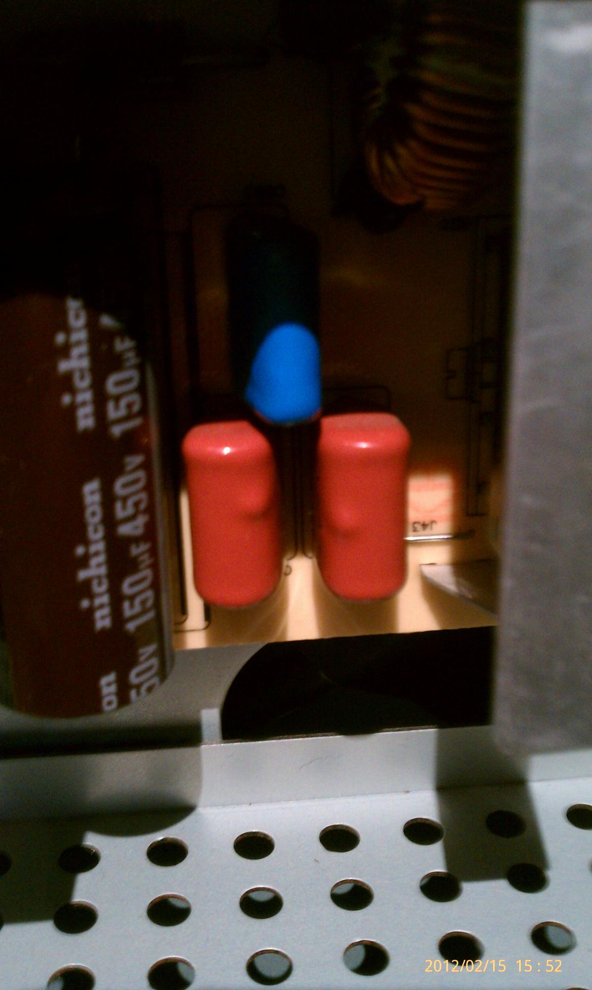

    VIZIO VO42L FHDTV10A:stand-by light (orange), power light (white) both work, but no image. I bought a replacement master inverter card and installed it. nothing changed. I have attached a few pictures of my power supply. I do not know the name of the part shown, but there is a bump on each one. Can someone tell me if I need a new power supply. Thank you.
    Re: Vizio vo42l fhdtv10a - No image
    Those are dipped polyester capacitors.
    With lights out & curtains closed, does the screen glow at all?

      thanks for the suggestion. with the room void of most light, with the power on (white vizio lcd light on) the screen does not glow at all. i think i wil have to buy a voltage meter to check the power output of the power supply. will post the results soon. thank you

          I think you need to do some voltage testing first , also look real close at both inverter board to see if the IC controller has blown, very common to this model.
          http://s807.photobucket.com/albums/y...VO42LFHDTV10A/
          The inverter boards should be changed in pair and also need to see if they need modification.
