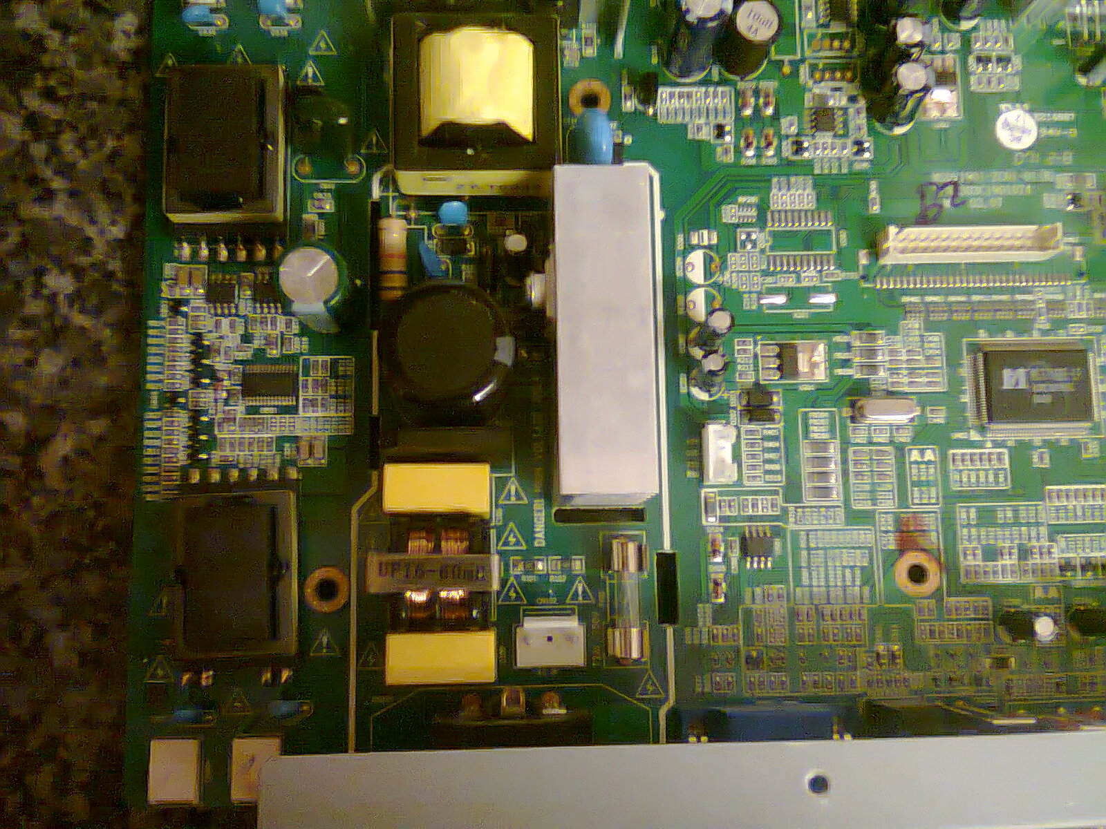

    Another project im hoping to fix..
    This lcd tv i got from a friend to try and fix..no power lights no nothing dead.. has a ticking noise from transformer..after googling the psu (MSDV1901-ZC01(B) there was a common fault with the 2 schotty diodes on the heatsink..so i replaced them with MBR20100CT-20a-100v..still same issue and ticking noise remains
    Re: Technosonic 1908
    check for shorts on the output(s) and replace the startup cap (usually 47uF 35-50V).
    That's usually the first thing I try for ticking powersupplies.
    If that's not it, look up the datasheet on the SMPS controller IC and start checking that one.

      Is the start up cap usually in the psu area if so mine was 50v 22uf i replaced that 1 but no joy..where would i start testing now..thx
        where will that IC controller be..thx
          See attached photo.
          Controller is usually on the underside. Small surface mount IC

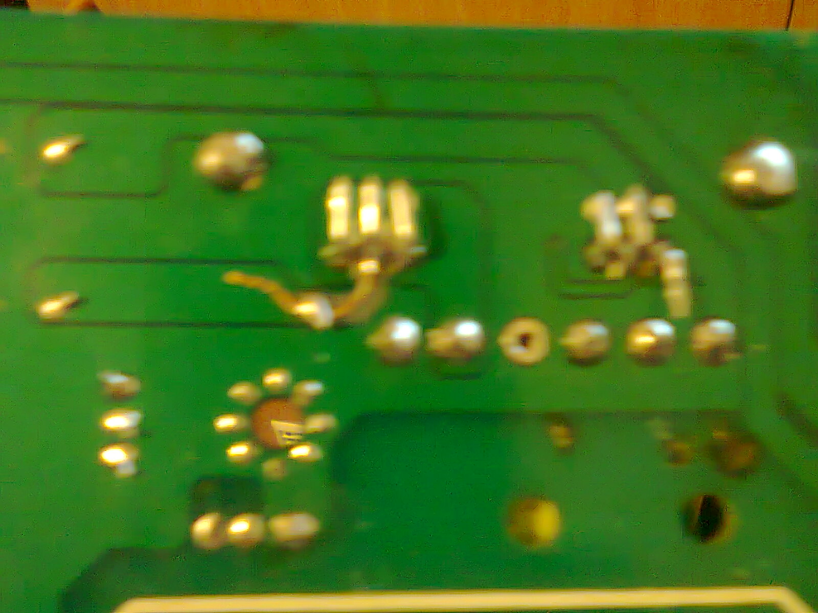

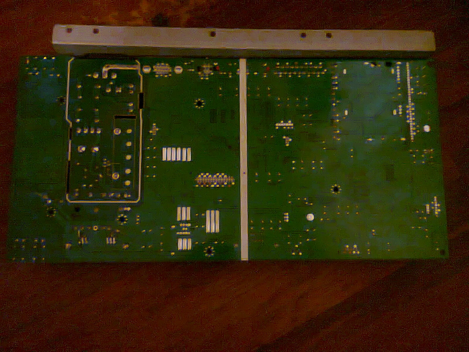

          Post a pic of the underside, and the number on any chips close to the startup cap on the opposite side of the board.
          I'm not the best person to be giving advice, I've got a PSU ticking at present and cant locate the source of the problem!

            You're going to have to give us a little more to work with. I really prefer that the picture cover the entire board.. including the edges.
            The controller could be the device fastened to the heat sink, it could be on the bottom of the board, or it could be on the top of the board, but in the shadows. It will be in the neighborhood of the very large cap.

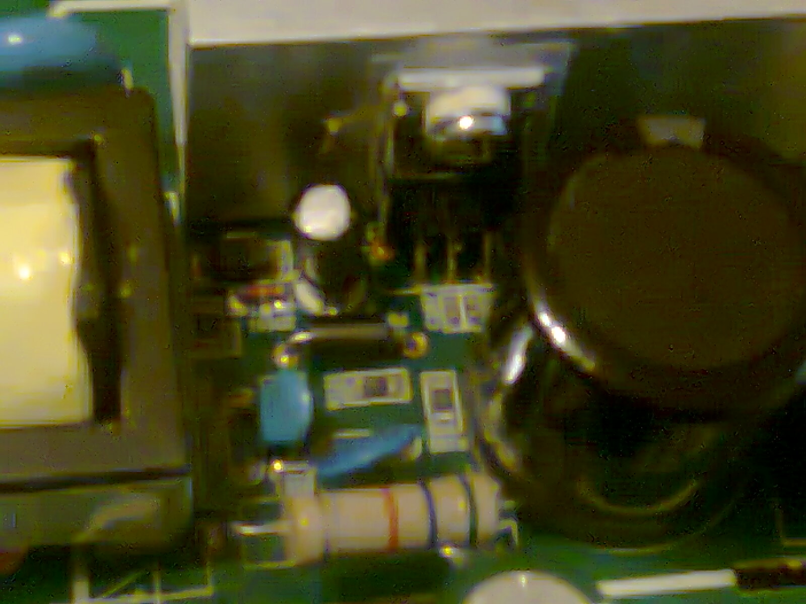

              The 3 blue disc caps are c103..103m-1kv..c102..101k-1kv..c114..472z-y1 250v
              how do i measure those..thx
              r101 & r102 both 105 resistors measure.948m
              r104..104 resistor..94.5k
              r121..104 resistor..94.5k
              r110..470 resistor..47.0
              c109 & c106 yellow box caps.22k275v..MCY/HT BOTH MEASURE 1.816m
              thx guys sorry for the poor pics im having to use my phone at moment..the circled cap was the 1 i replaced..theres no smds on underside of board..the ic attached to the heatsink has 6 legs & will need to desolder as i cant see any numbers on it clearly

                I removed the big cap to get a good view of ic..it reads F1G45-CW0765R

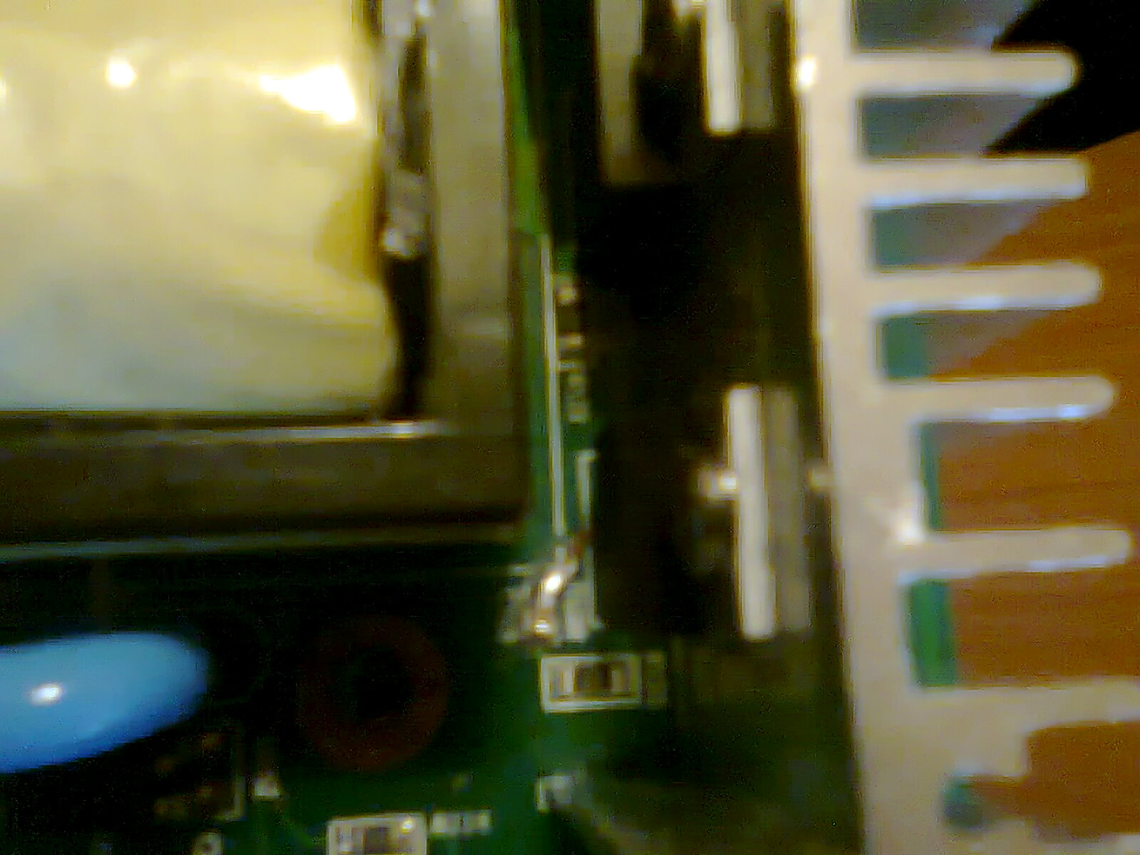

                also when i first changed the schotty diodes i kind of overheated the pads abit..so i added a trace..

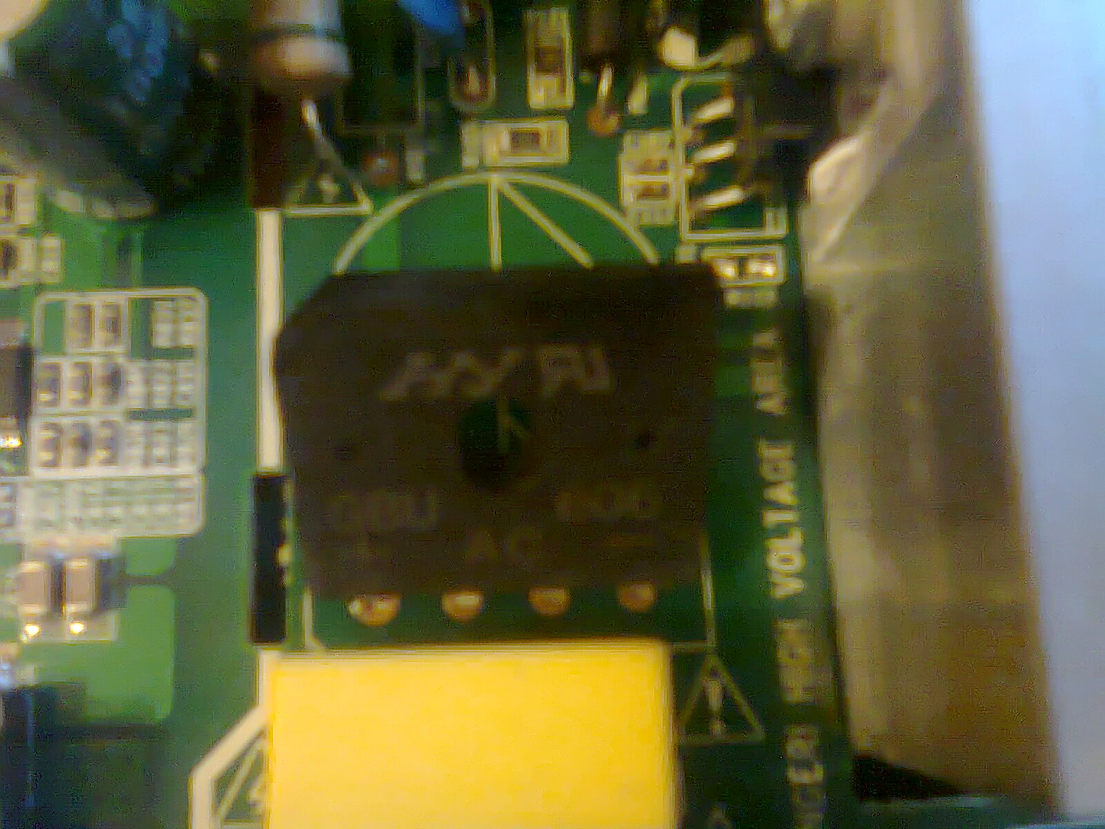

                  Whats this 4 legged item between yellow cupoid cap & large cap..

                    That's a bridge rectifier.
                    What do the output voltages measure at?

                        Use diode test.
                        BUT...
                        If the bridge rectifier is dead the fuse will blow or the power supply will not work at all.
                        It is probably not the cause of your problem.
                          I am butting in here just on the side of safety.
                          I believe that the Bridge Rectifier is in the HOT part of the board
                          and it turns the 250v AC into around 370v DC so if you set your meter on 20v there will be smoke.
                          I am not sure which pins are AC and which are DC - it might say on the board? or you could get a data sheet for the part number.
                          I think you can test it power OFF as well but not as a voltage but as a diode Take a multi-Meter and switch it to Ohm x 1
                          Test between one of the "~" and "+" legs.
                          You should get either an almost-zero reading in one direction, and when you reverse the test probes, you should get an almost infinite reading.
                          Now try the same between this "~" leg and "-".
                          Same as above.
                          Now repeat the same tests with the other "~" leg, and "+", and then "-".
                          Same as above.
                          If you either get almost zero or almost infinite in BOTH directions, then the rectifier burnt out.
                          Reading previous bits it is unusual for the blue ceramic caps to fail and same goes for the box caps and even the BIG 400v or 450v cap

                                When measuring this rectifier in dioide mode with above sequence i get .512 then .OL the reverse is .512 an almost zero?..thx
                                  That's half the test -looks good to me- picture worth a thousand words:
