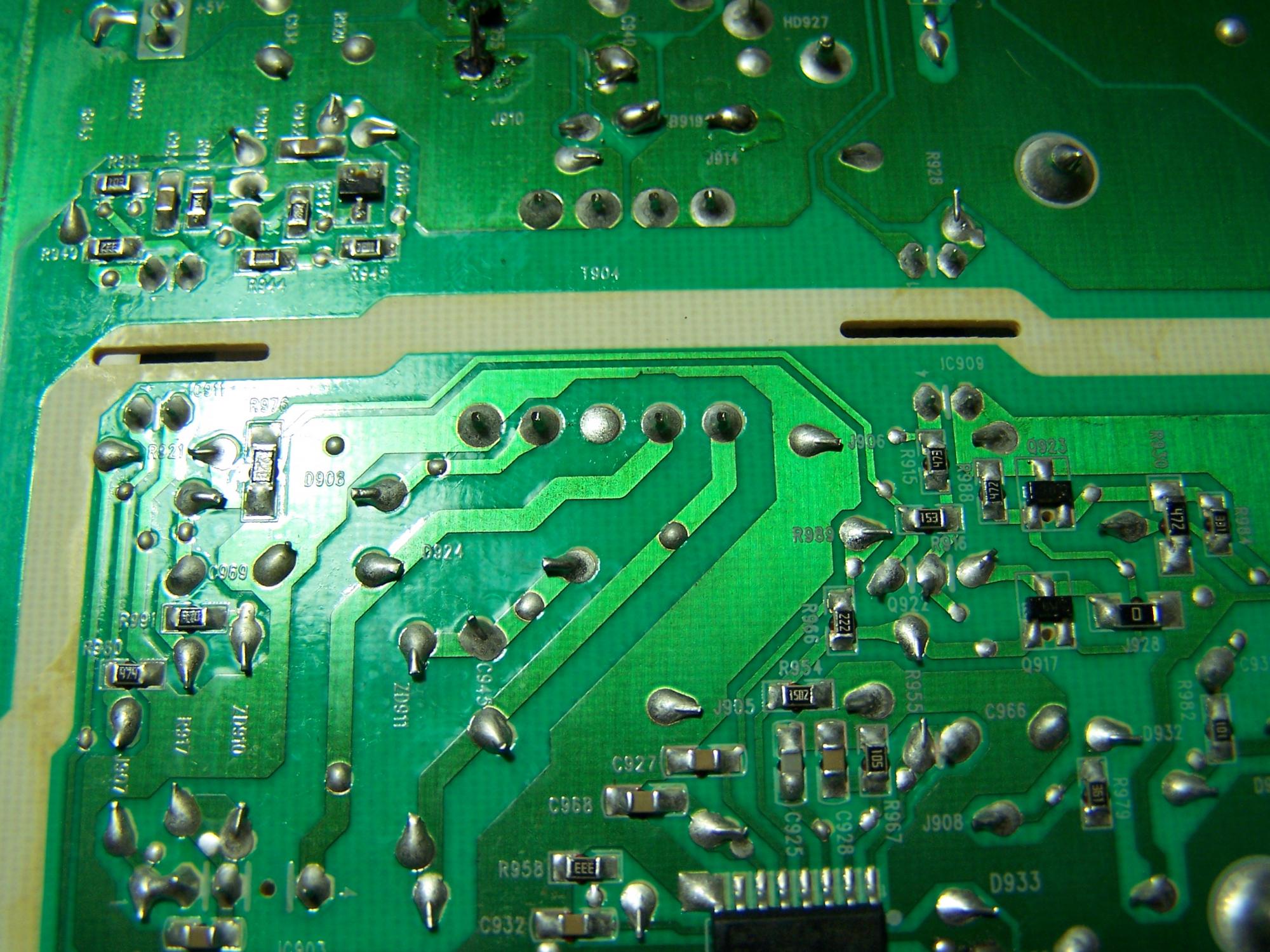

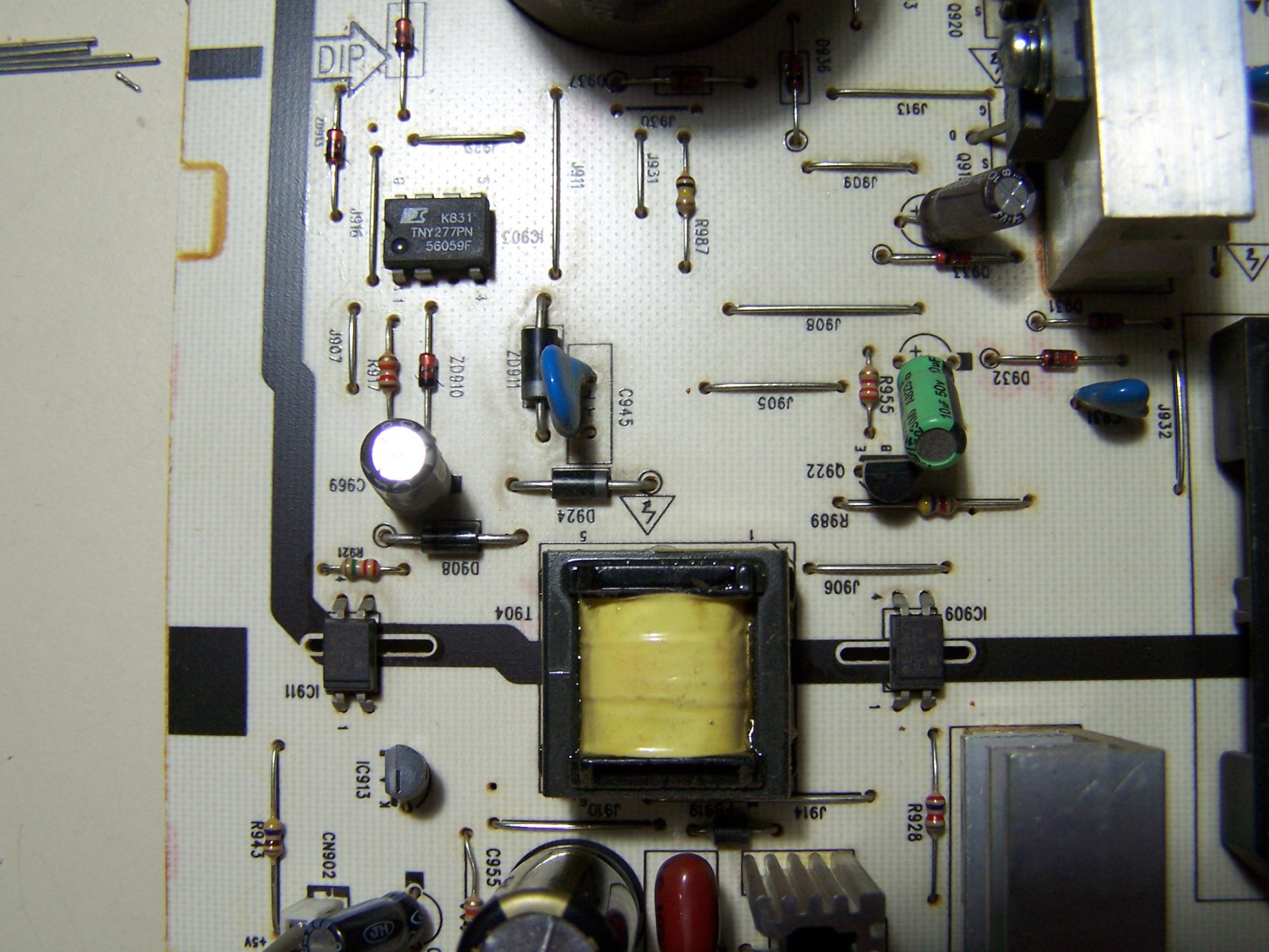

        2) Can we get a close photo of the area in question (both sides of the board)? The closeup will help and then I can markup the pins to test.

          Re: Sharp lc-42sb45u no response... at all.
          Here's some closer pics. Lemme know if they're crap.

            I use the 'arm waving' approach to analyzing this circuit. All components EXCEPT Q918, R920 and R947 are straight out of the TL431 application note. The simple explanation is until the voltage at pin 3 of IC913 gets up to 2.5 volts no current flows through the emitter of IC911, so the SMPS controller is driving to output full power. As soon as IC913, pin 3 reaches 2.5 volts current flows, and the SMPS controller throttles back. It's the electronic equivalent used in the first steam engine Edison used when he the Pearl Street generating plant.
            Q918 and associated resistors is an unusual addition. When STANDBY is low Q918 is turned off, so R947 has no effect. When STANDBY is high, R947 results in a boosted output voltage.

                          My suspects here are the zeners ZD910 or ZD911, the switcher IC903, or the cap at C969. Also check any chip resistors of <500Ω value for burns or discoloration, like R991(47Ω) or R976 (22Ω).
                          What is the voltage across the mains cap C907? (strangely, no one asked this question...?)
                          Should be present at the anode of ZD911 (junction T904 - pin1/C945/ZD911).
