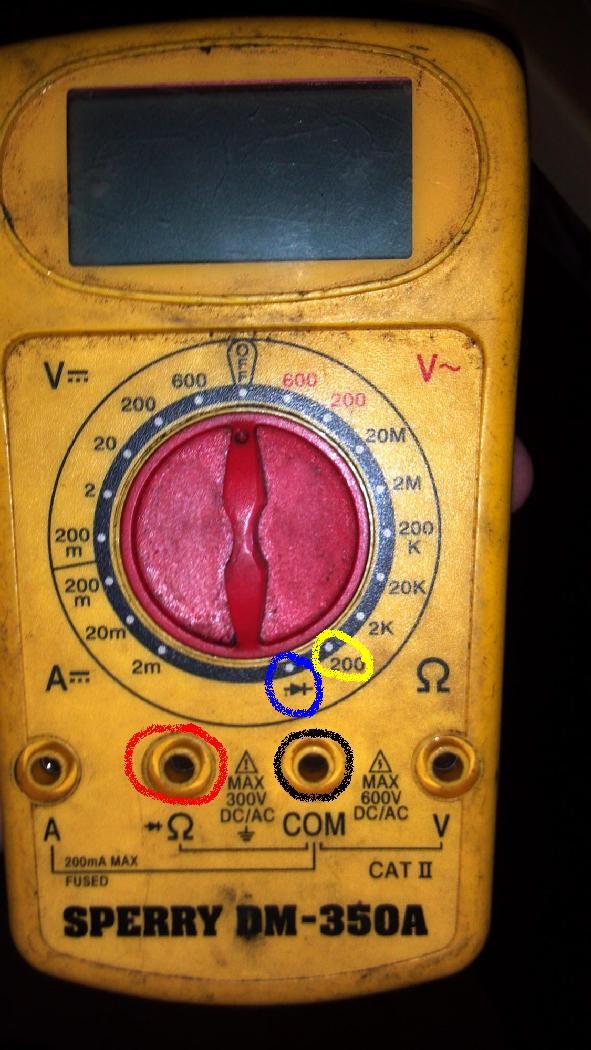

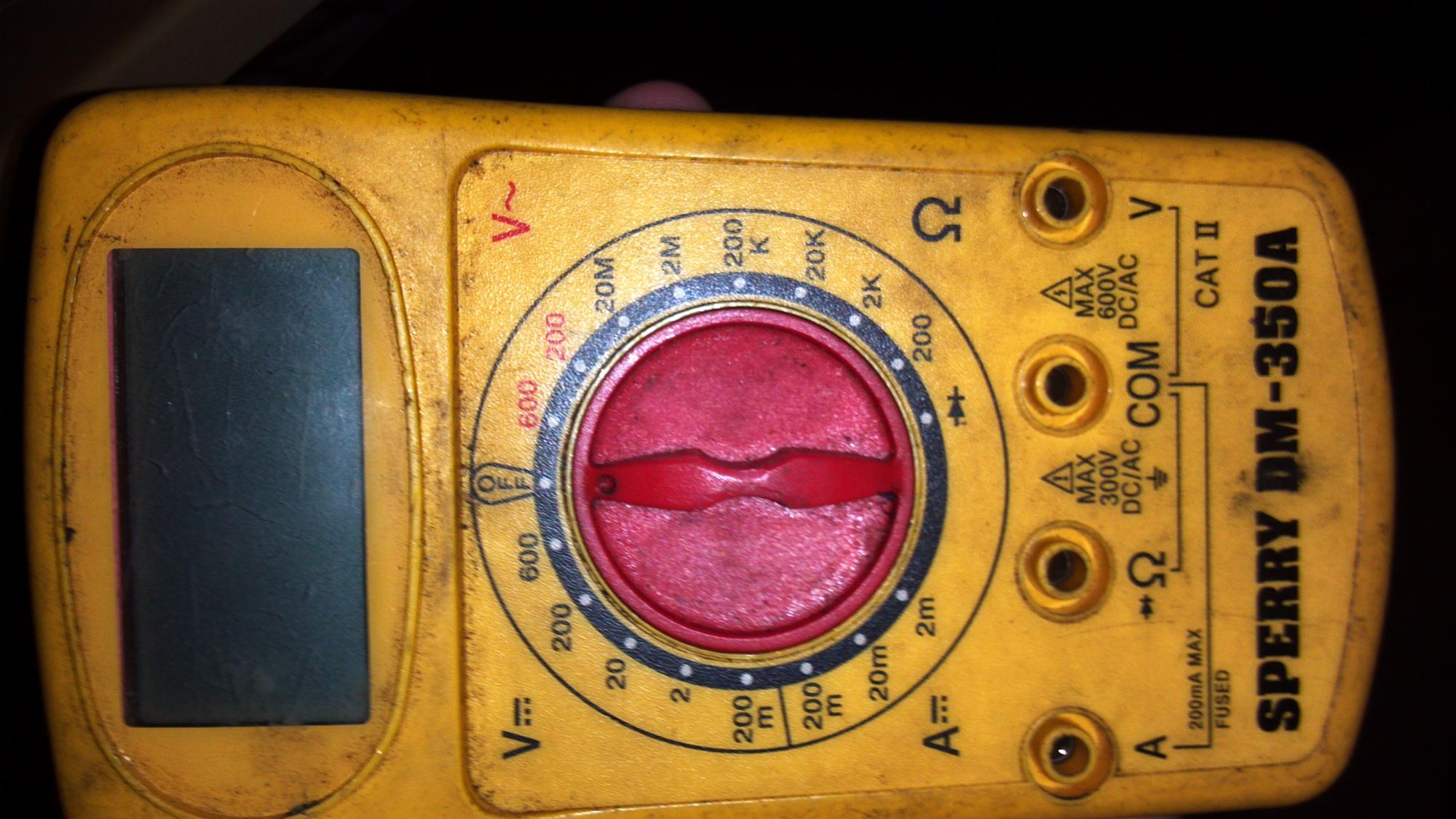

            Re: Phillips 42PFL5432D/37 Chirping and No Picture
            Got everything ready.
            • retiredcaps
              • Apr 2010
              • 9271
              Plug your red probe into the red circled spot. Black probe into COM. The black probe will always stay in COM.
              1) For the diode test, set the meter to the diode test function (blue).
              2) For the resistance test (fuse), set the meter to the 200 (two hundred) scale (yellow).

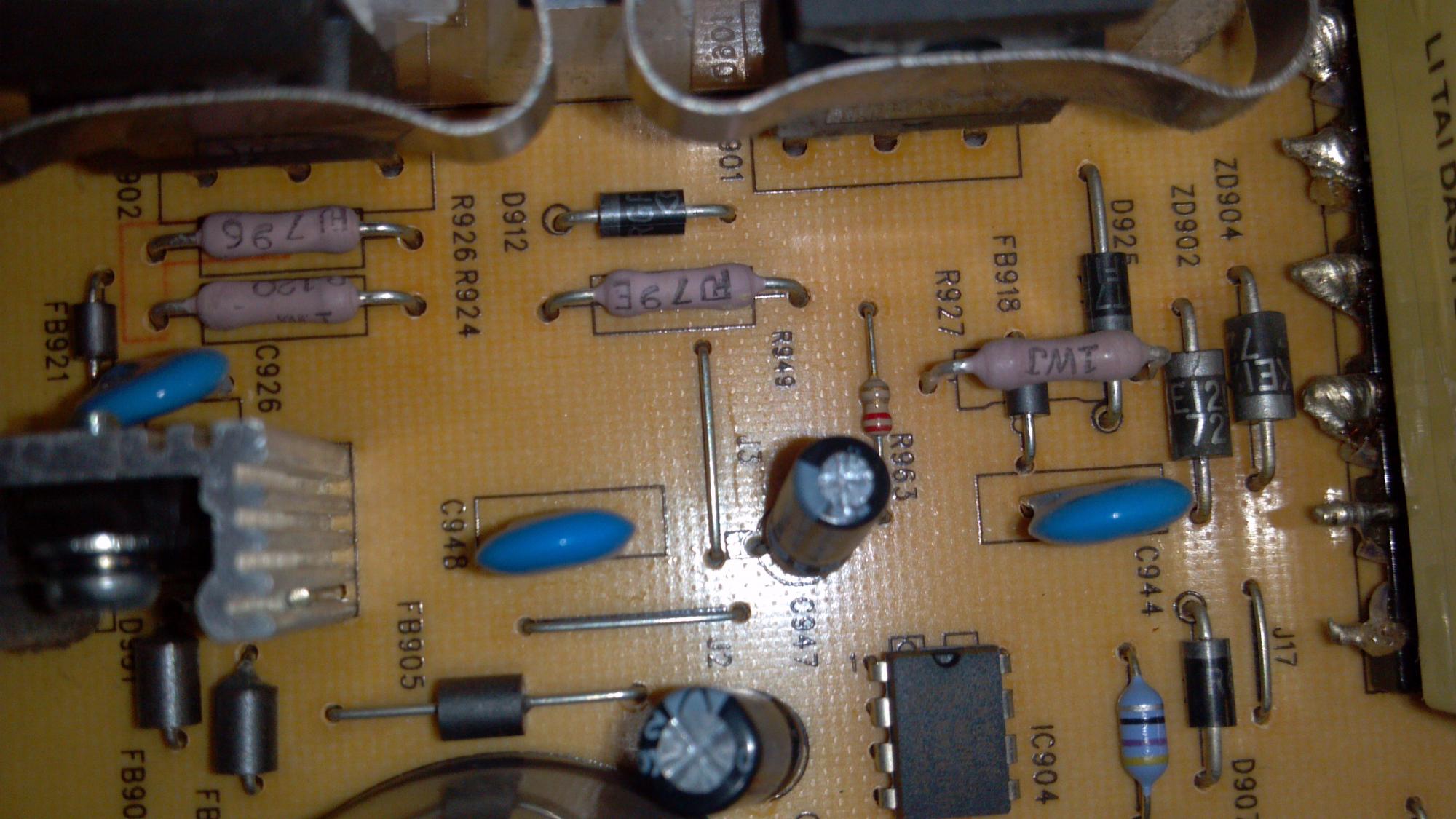

                Ok, first results..
                ZD904 .02 and .02
                ZD902 .05 and .05
                D925 .07 and .07
                D912 .000 and .000
                I should desolder one side from each to retest now? I've repeatedly been getting the same results. There are other D and ZD diodes that the results came back fine.
                Edit: checking fuses right now, so far so good
                  Originally posted by tw1ztid
                  Ok, first results..
                  ZD904 .02 and .02
                  ZD902 .05 and .05
                  D925 .07 and .07
                  D912 .000 and .000
                  If you switched the leads around, then yes all those readings suggest the diodes are all bad. You will have to desolder and retest out of circuit.
                  It is possible that something else on the board is shorted and causing all these potentially false positives.

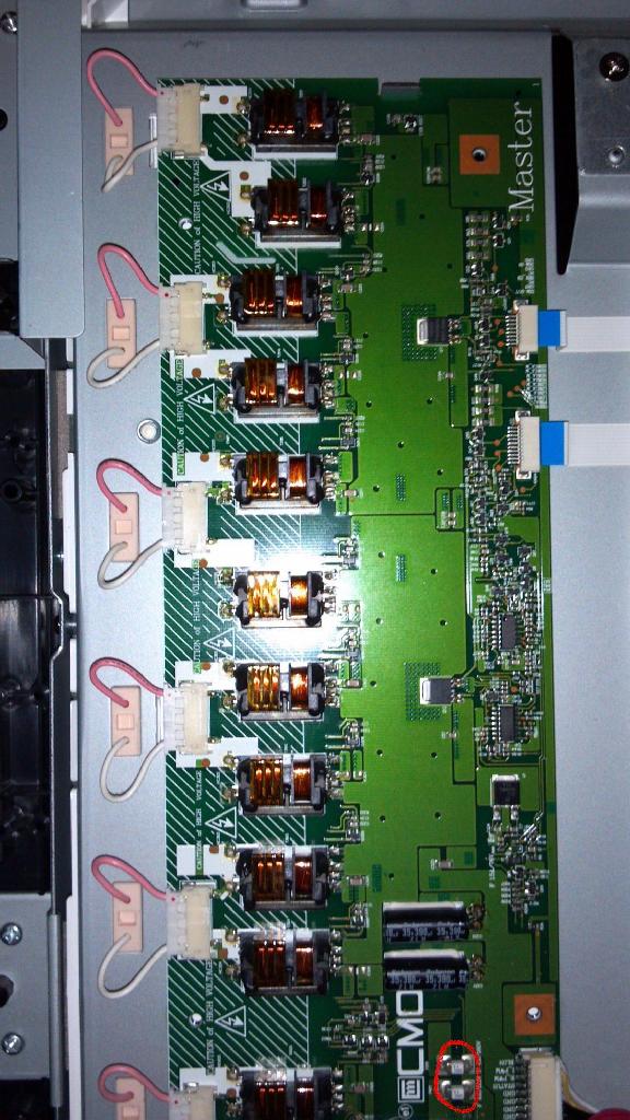

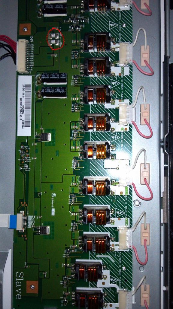

                      Fuses begin with the letter "F". For example, F100.
                      Your 4 fuses circled in red.
                        Thanks, never seen a fuse other than the glass looking ones.
                        All 4 read at .3, so they seem fine.
                        So far we're down to either
                        1) Diodes are bad and need replaced, casualties from when the Caps went bad?
                        2) Another (larger?) part of the power board is causing a false positive.
                        I'm leaning towards number one, like Mr. Bills situation, but I know to expect the unexpected.. I'll start off by removing one leg of each diode and checking for false positives. If they are, what do you recommend for being my first plan of action?
                          Remove them and test them out of circuit. Report your multimeter results for each one.
                            ZD904 .02 and .02
                            ZD902 .05 and .05
                            Havin a bitchin time trying to get these things out.
                            Starting on removing the next two..
                            • tw1ztid
                              • Jan 2012
                              • 36
                              #34
                              After removing it, D925 now gives me .463 and no reading the other way. So it looks good after all
                                ZD904 .02 and .02
                                ZD902 .05 and .05
                                ZD904 and ZD902 are bad for sure.
                                Add fresh 60/40 solder to the joint first to help with thermal transfer.
                                  D925 is good. What about D912?
                                  BTW, there is no such thing as "no reading". If it reads "1" on the left hand side, that means "out of range" or "infinity".
                                  Remember a diode lets current one way and blocks the other way.
                                      D912 is out of range, and .43
                                      it's good.
                                        Okay, time to order parts. Remember tom66's suggestion and you might want to get 4 just in case they blow for some other reason. I'm guessing these diodes should be under $1 each?
                                          I'll start searching for FR4007 thanks!
