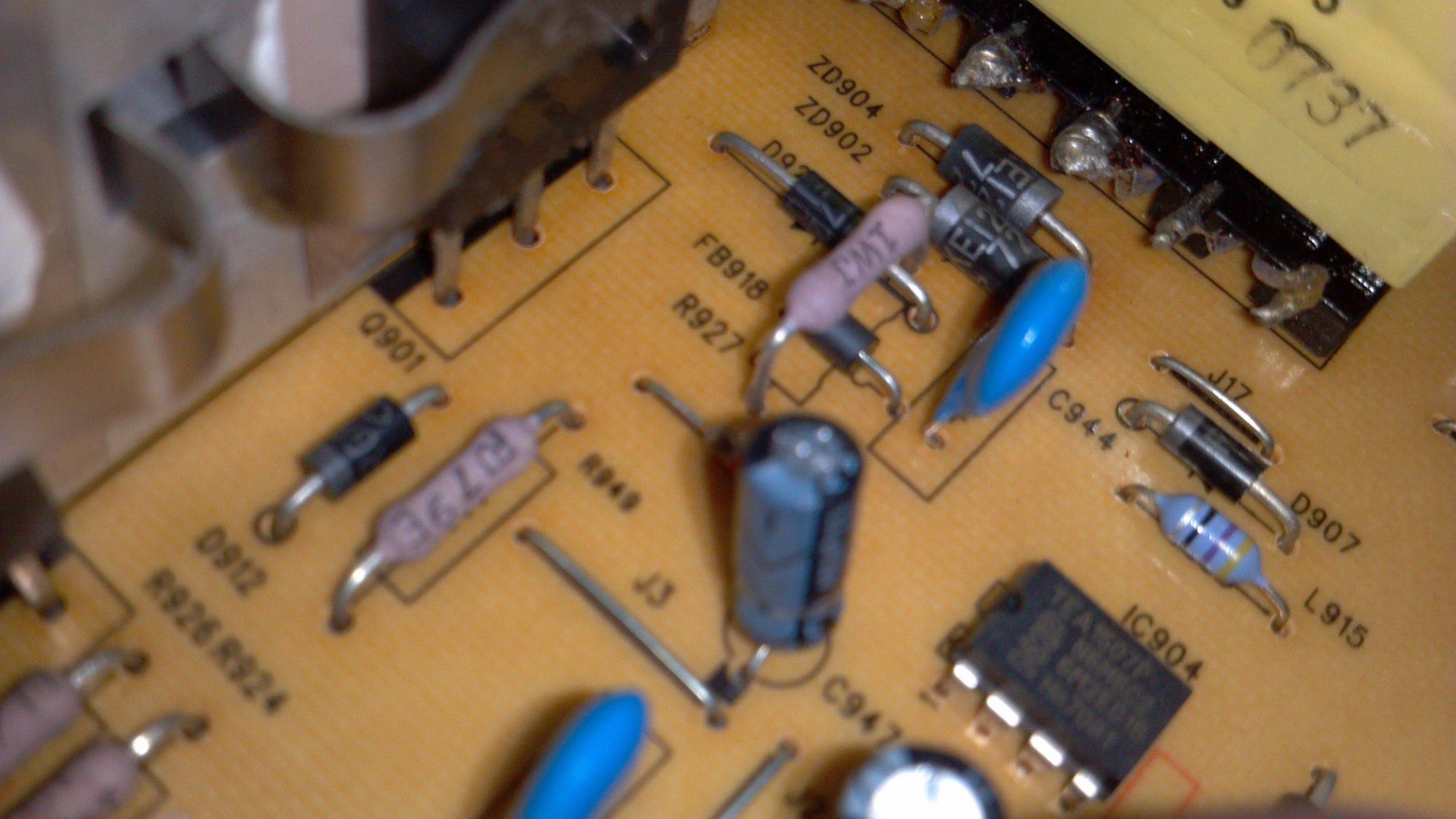

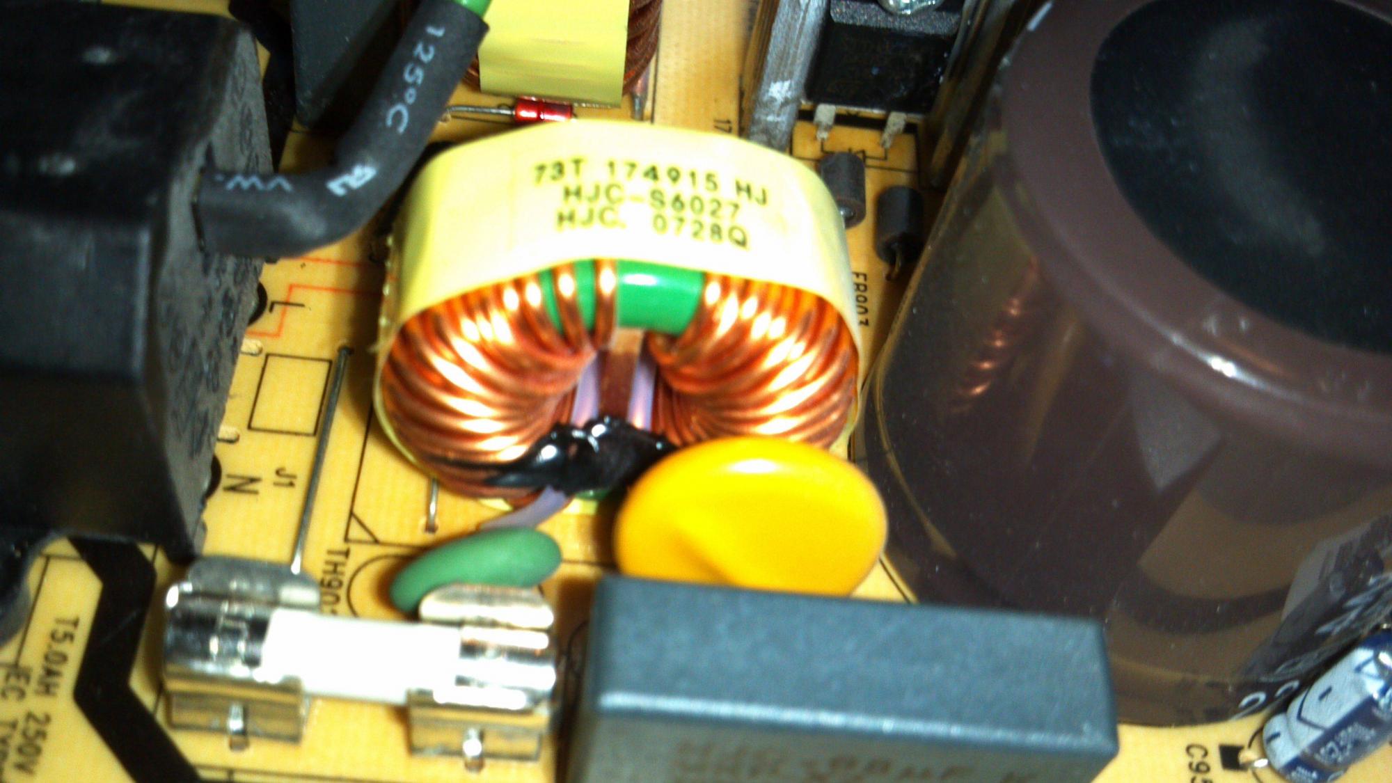

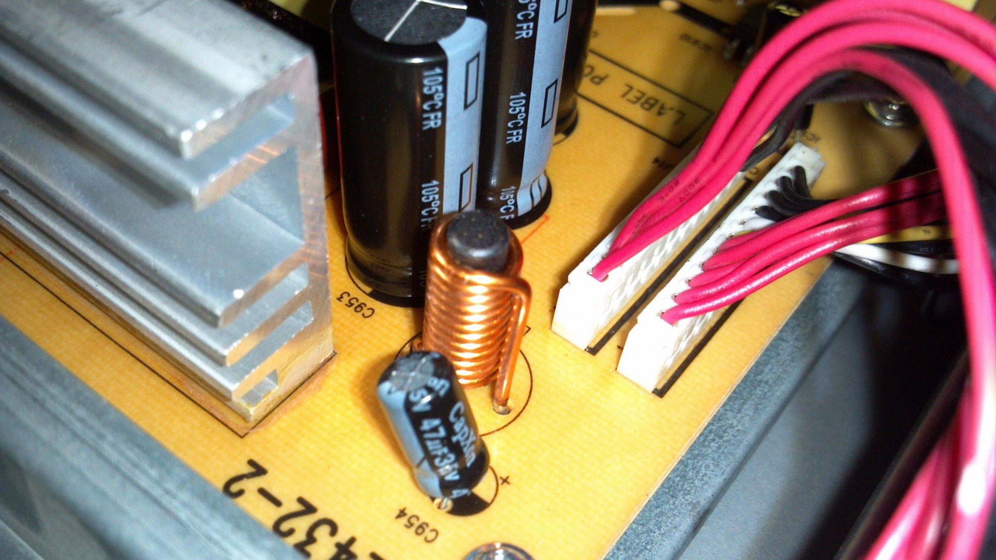

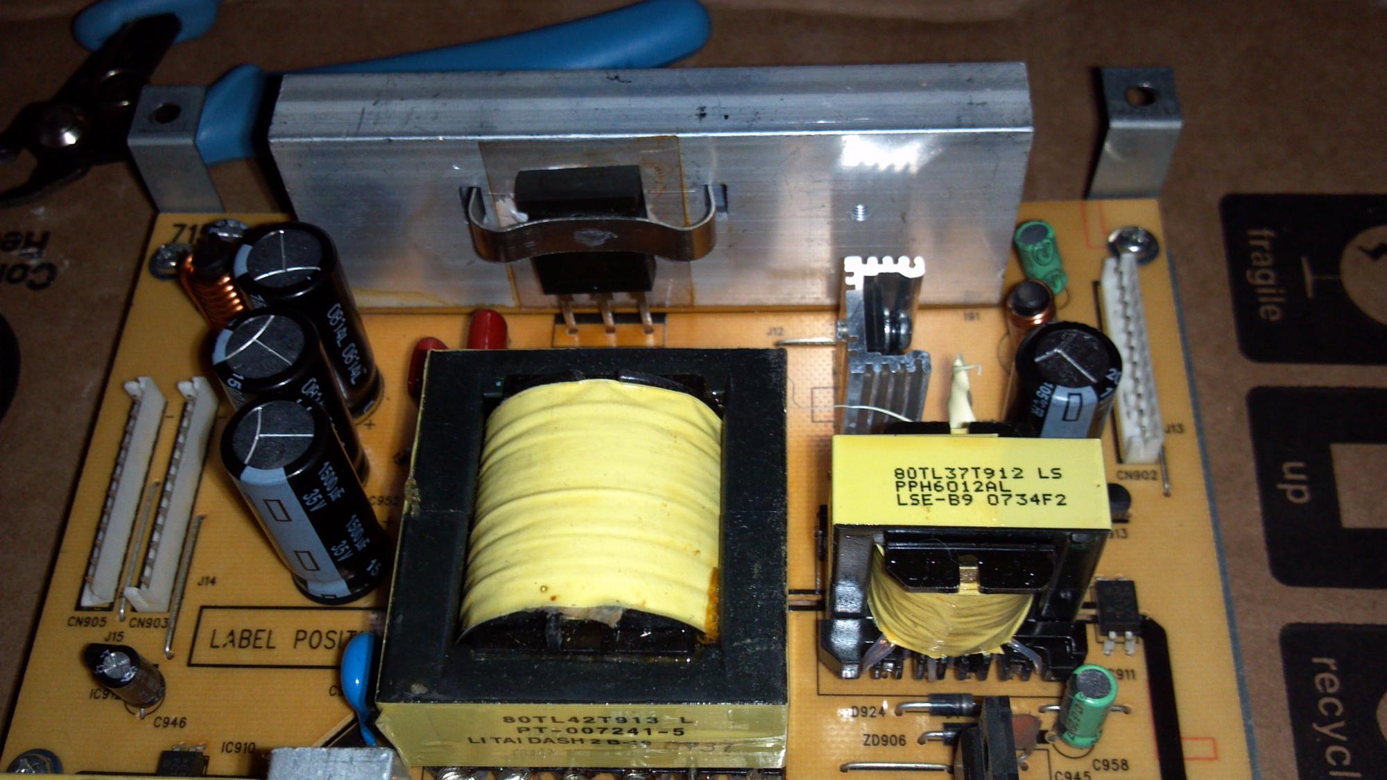

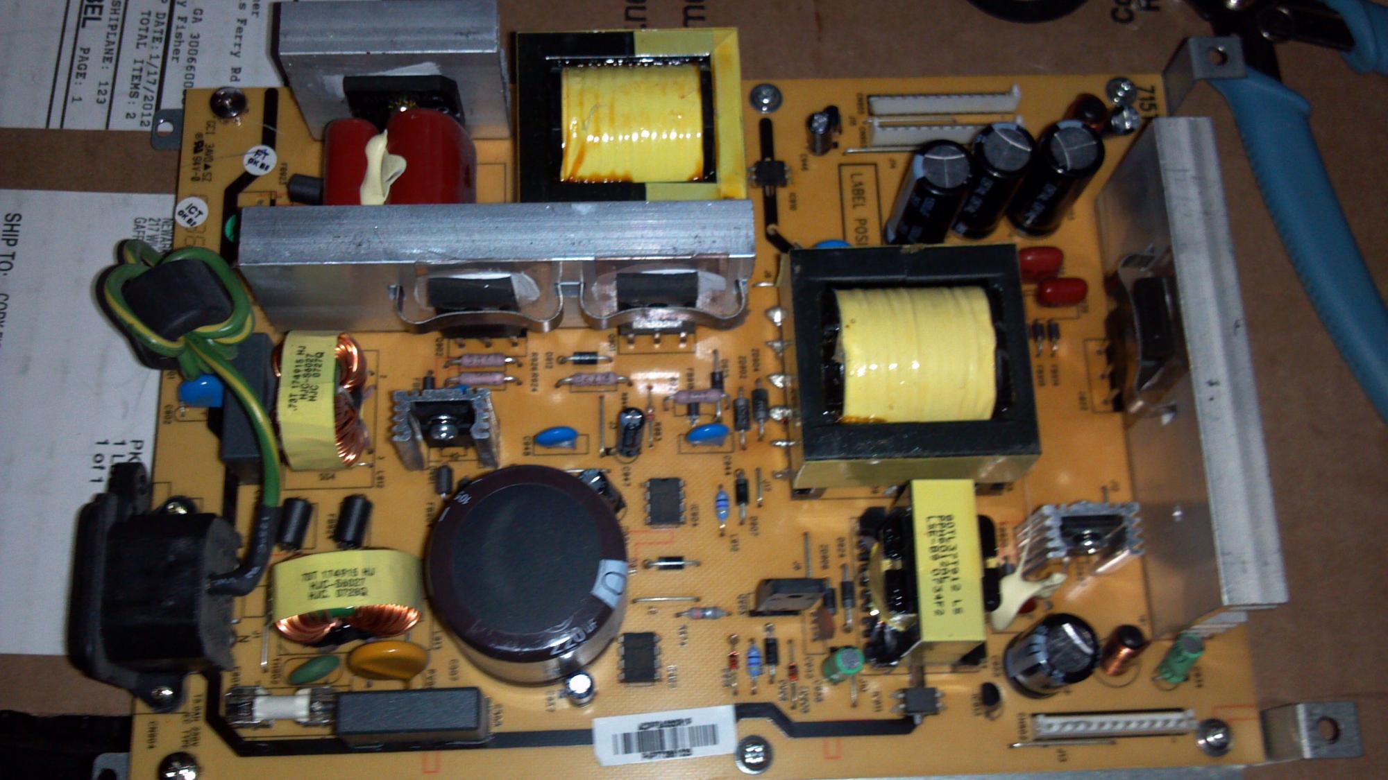

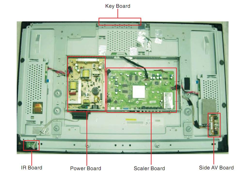

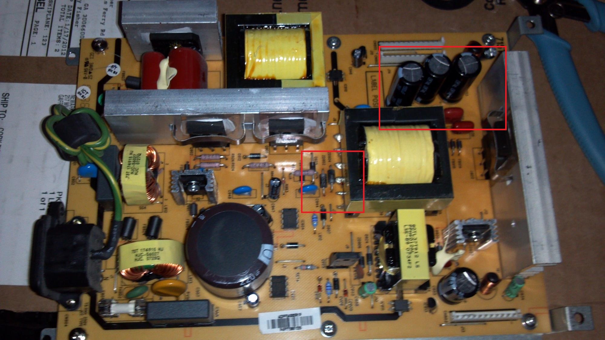

    I have a Phillips 42PFL5432D/37. I have had no prior experience with this sort of thing.
    When I plug it in and turn it on it lets out a single odd chirp, then repeats the chirping sound at a high frequency. The power LED on the front stays lit up and GREEN. It continues until I hit the power button on the TV again.
    There were 3 visibly bad capacitors, and a 4th that did not look bad.
    I found a place that sold Panasonic brand online and actually had them in stock and ordered all 4 to be replaced in case the 4th was bad as well. I just replaced them with tutorials and such throughout badcaps and youtube. The Chirping is still there.
    Capacitors I ordered:
    http://www.newark.com/jsp/search/pro...sp?SKU=74R3419
    http://www.newark.com/jsp/search/pro...sp?SKU=74R3454

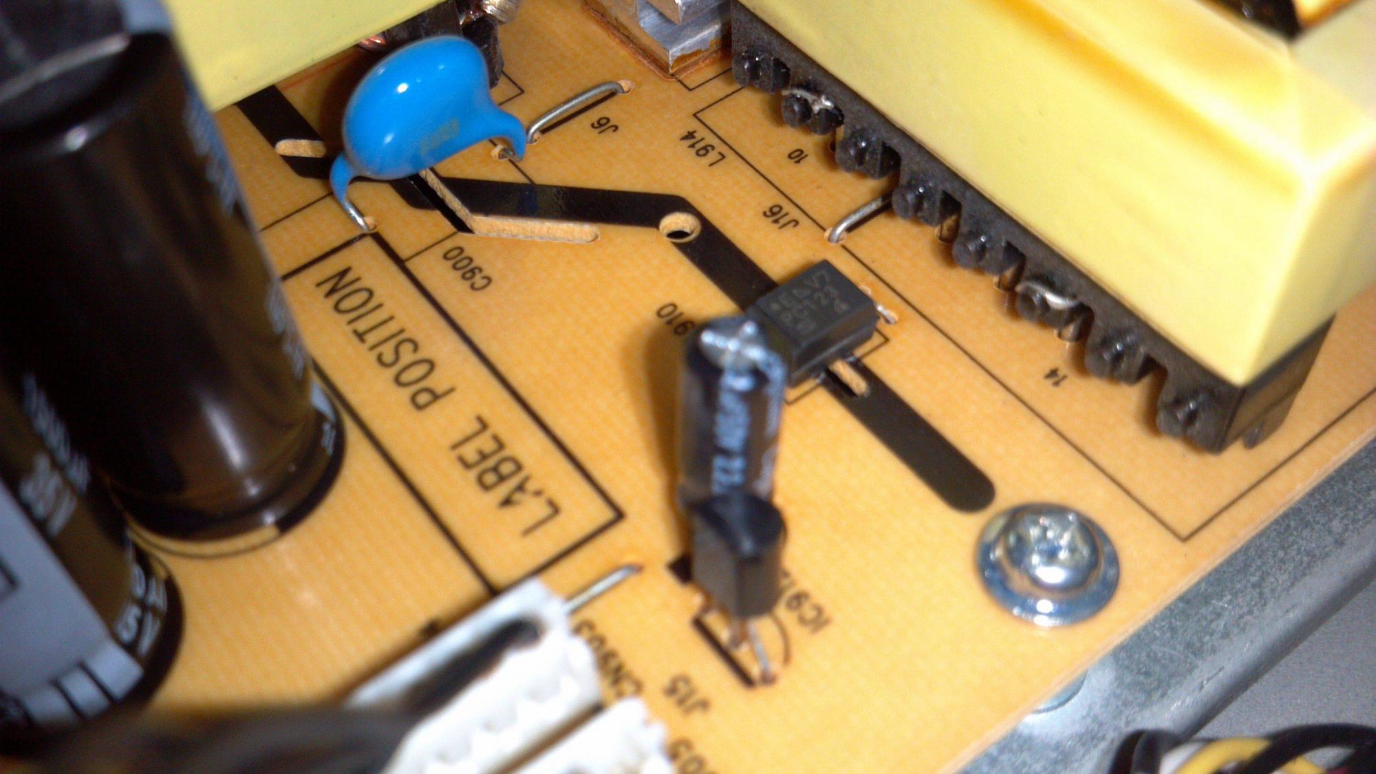

    I cannot tell exactly where the chirping is coming from, seems around the group of 3 capacitors.. I tried the "cold spray" in case that would really help but it did nothing with helping me locate the source.

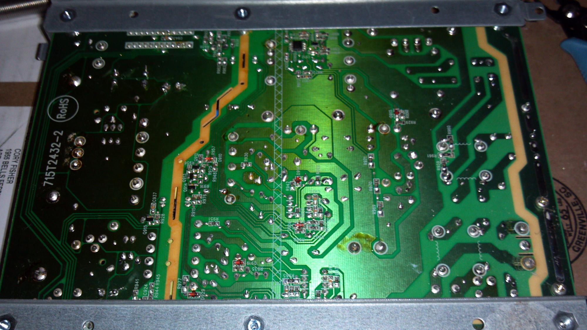

    Underneath there are a couple spots that have a brownish crispiness that can be scratched away kind of, doesn't look like a burn mark that i've seen picture of but not 100% sure.. They are around soldering points. Could this be the problem?

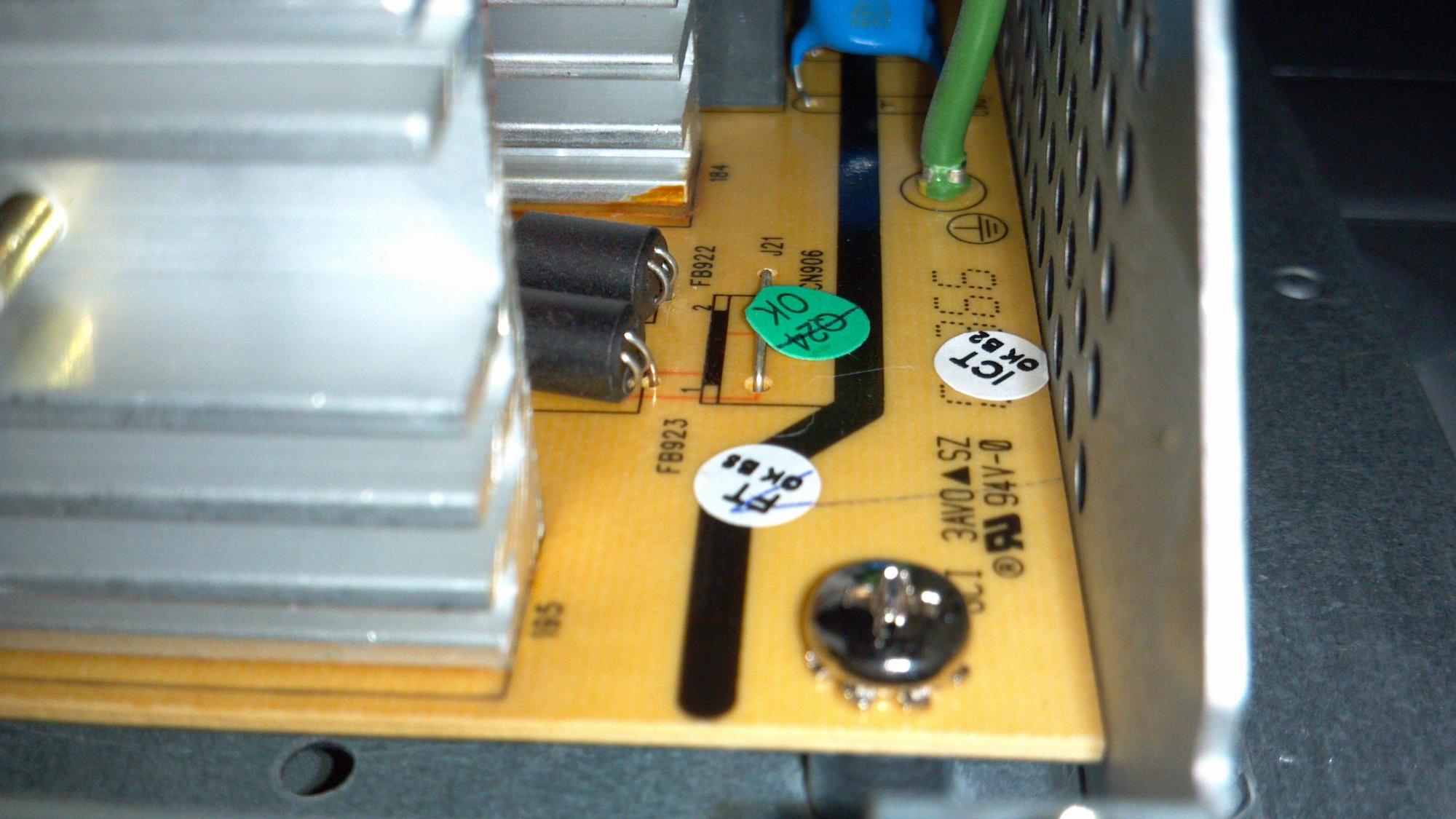

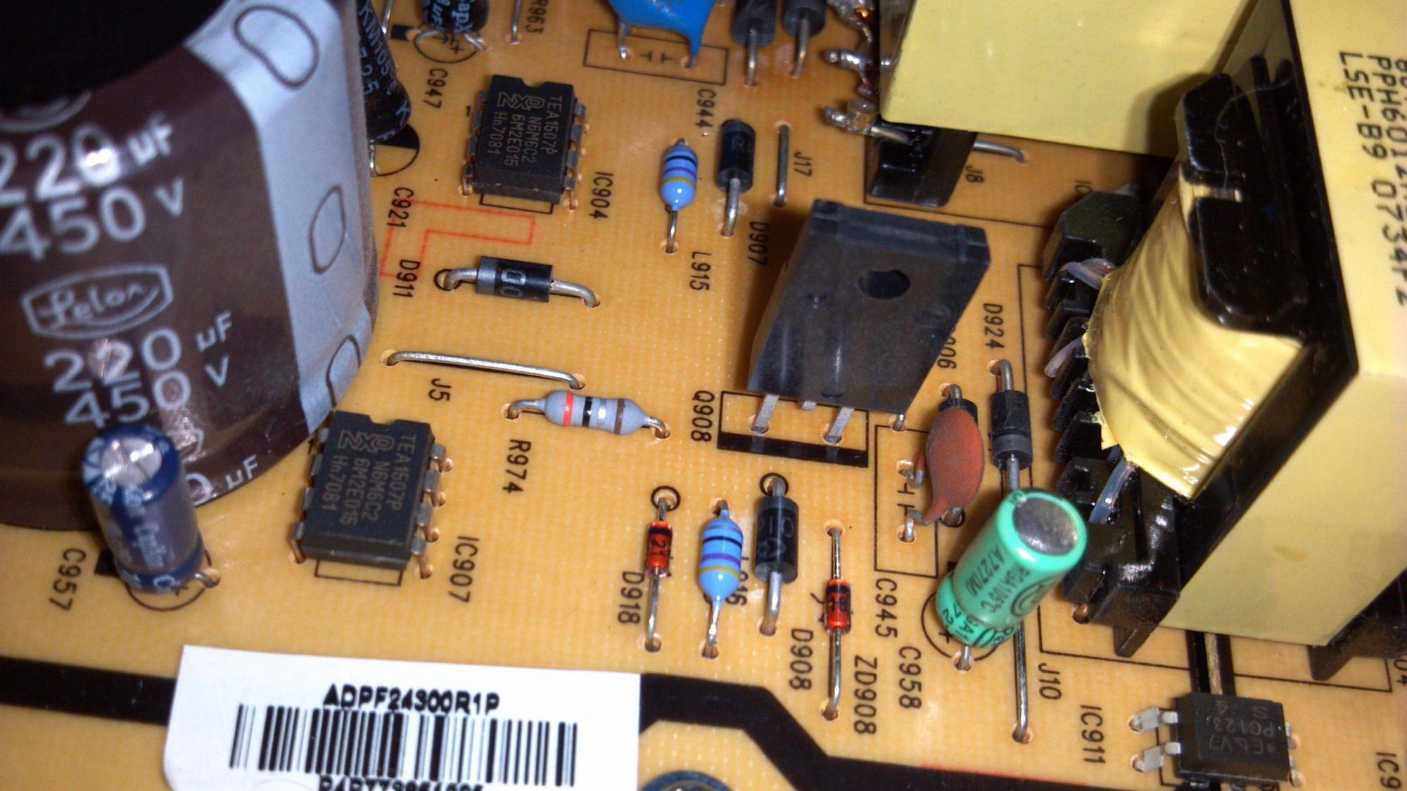

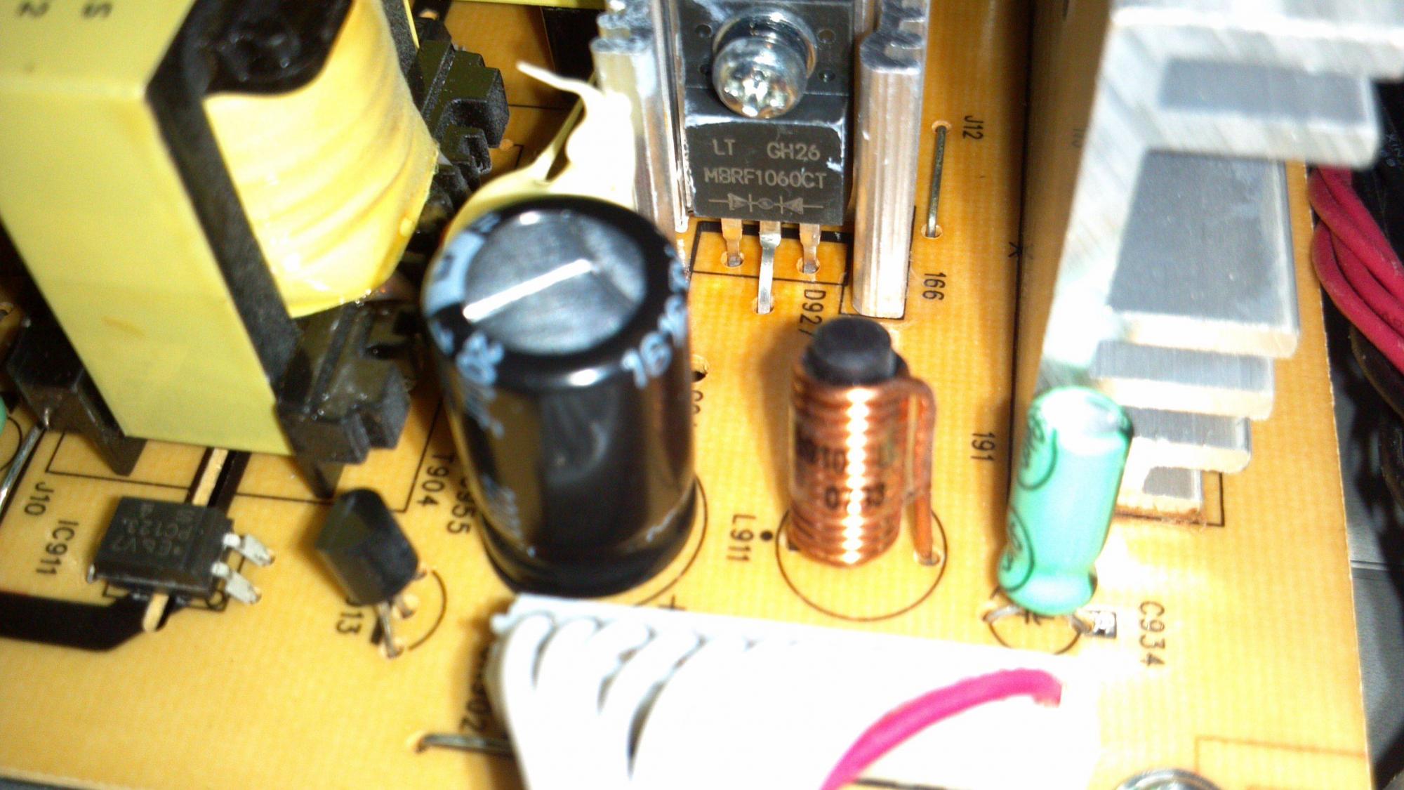

    I've uploaded various pictures, if there is anything else I need to supply please let me know. I also have pictures with the old caps that were bad..
    You can see the crusty looking spots in one of the close-ups. It is on all of the soldering points for that lond thin tall silver thing with what looks like a chip and plastic on the inner side, and It resembles a heatsink.
    Thank you! This is bugging me not being able to figure this out, spent hours on this making sure everything has been done properly and researching.
    edit: The first picture/diagram of the whole case IS for my exact model. It was actually posted by PlainBill iirc, I figured it would be fine since it has been doublechecked to be for the same model and looks the same as my tv.
    1) If you hookup a dvd player, do you get a picture?
    2) Do the backlights come on?
    3) The chirping could be due to a small cap that has gone bad. Smaller caps rarely bloat so you can't tell by looking at it.
    4) That is solder flux left over from the manufacturing process. It won't cause your TV not to work, but you should use isopropyl alcohol to wipe that away as flux can be corrosive.
    5) Do you have a multimeter? Are you experienced in using it?

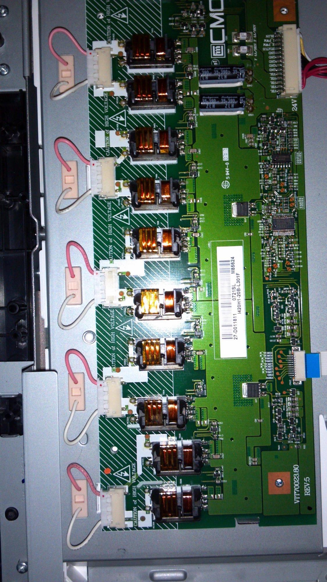

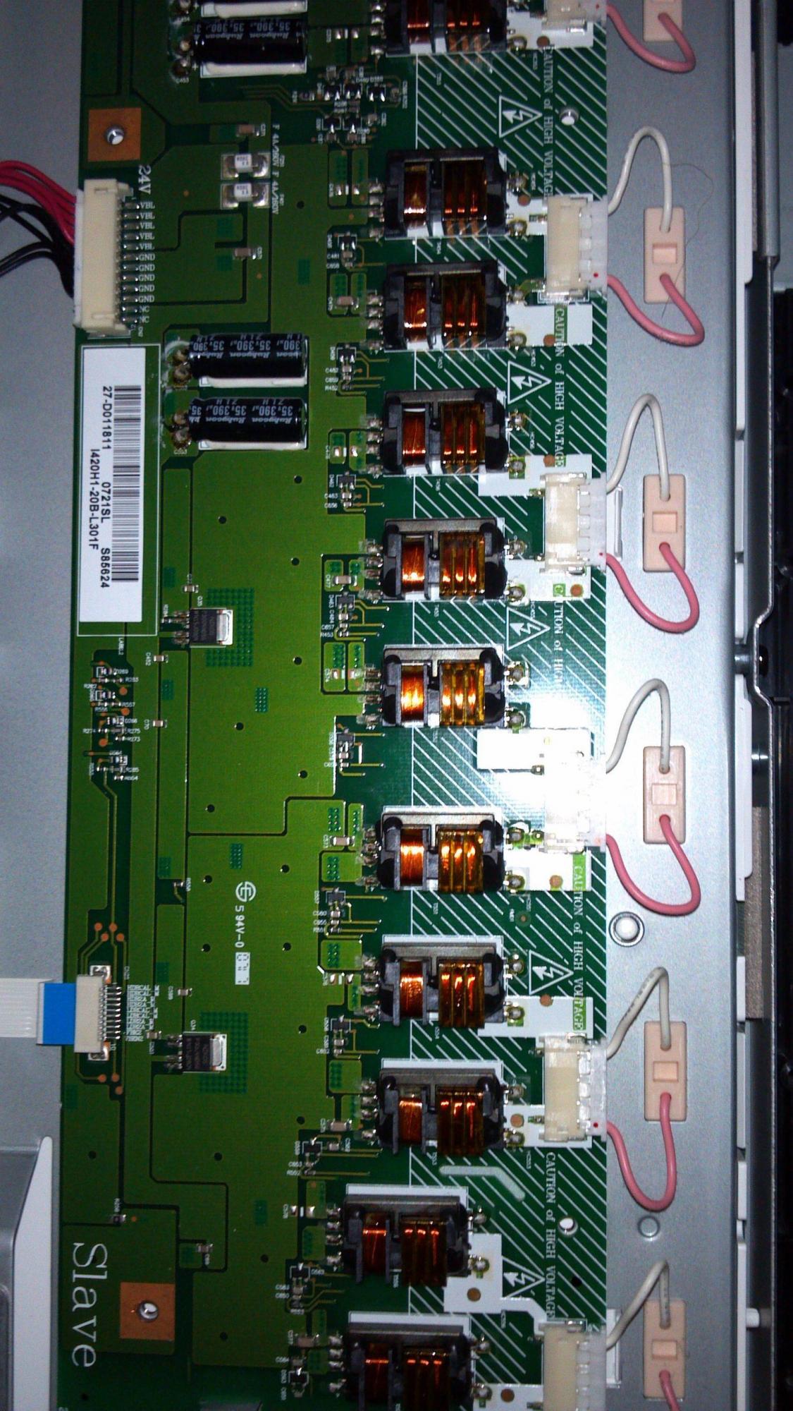

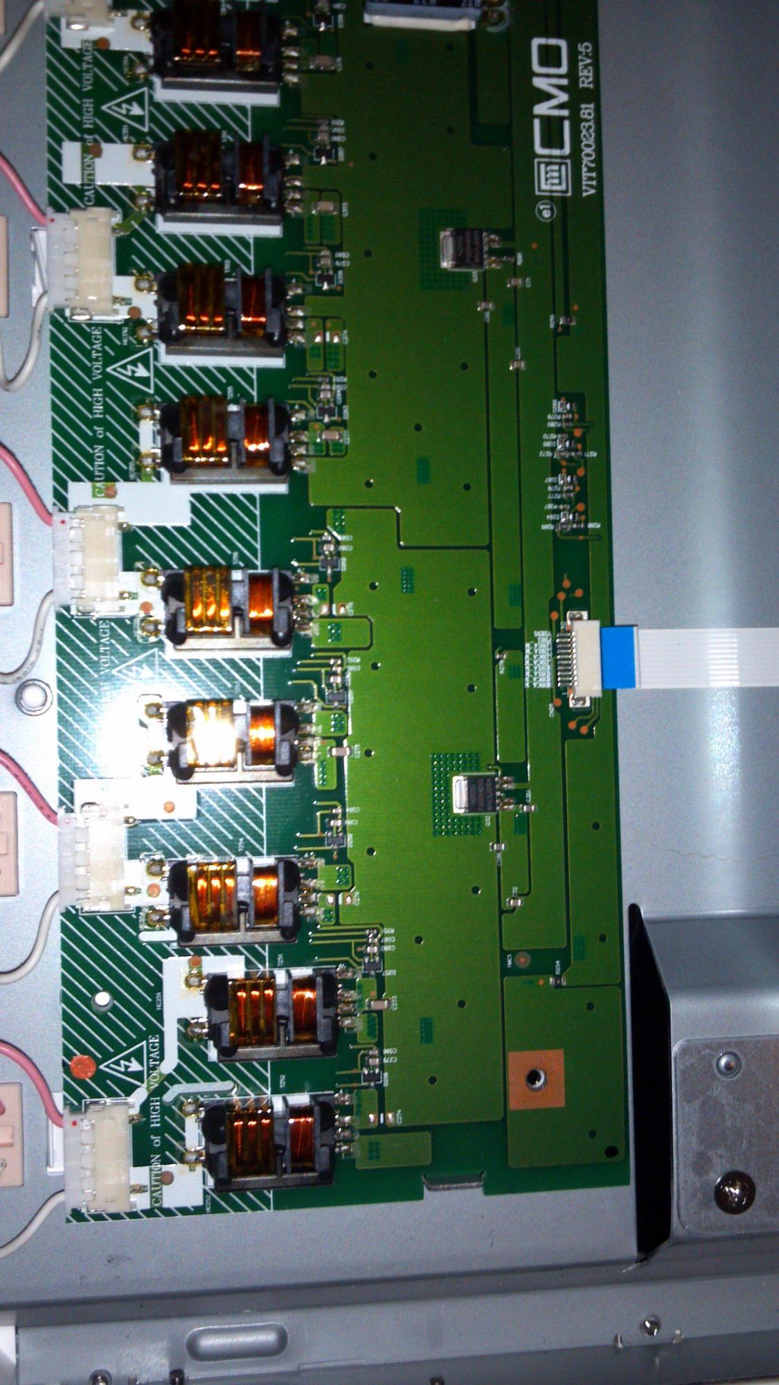

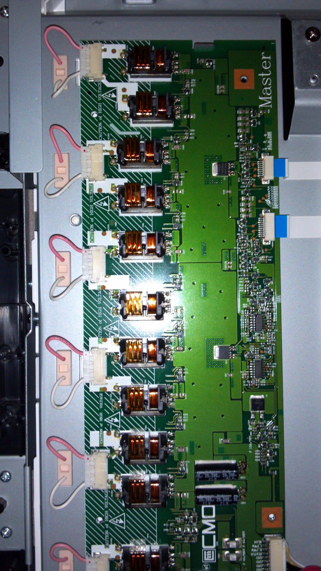

    6) We will likely need pictures of your inverter boards (master and slave). Thet are found near the edges of your TV underneath the metal shielding (follow the red and black cables).

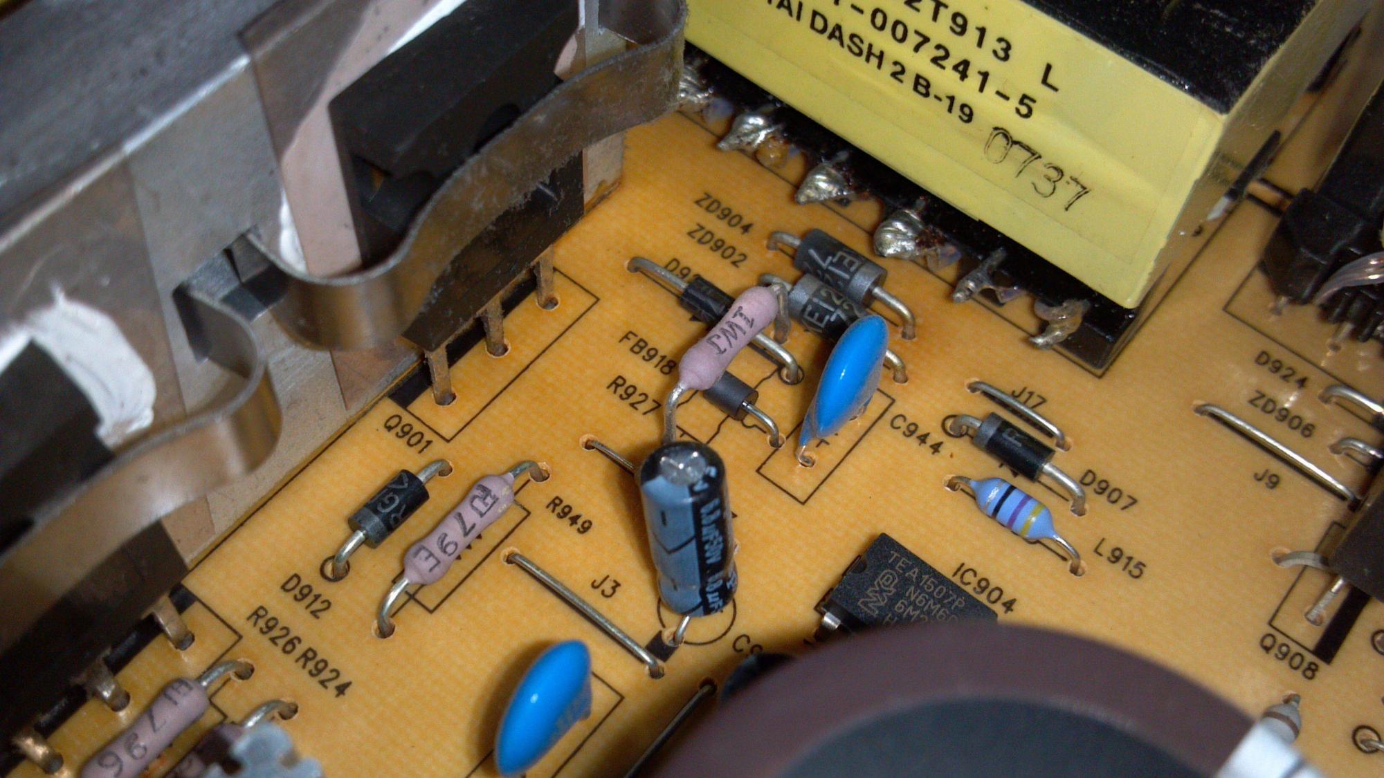

      Take a real close look at the two diodes i put the box around. My cousin has a philips 37PFL5332D/37 that died. The 3 caps were bloated. We changed them and the tv started chirping. The light on the front lit up solid just like you describe but we didn't get a display. The chirp noise was a first long screech followed by shorter chirps until we turned it off. The noise was also coming from the transformer area next to the 2 diodes.
      The 2 diodes are the same and from your picture the one closest to the transformer looks different compared to the other on right next to it.
      If you can post a good zoom in of that area and if you have a multimeter check them to see if they are open/shorted.
      Once we replaced the 2 diodes the tv fired to life and has been working solid ever since.
        I don't have a DVD player.. been using a old box tv with built in one.. I'll try to dig out the ps2 to test. The guy who gave it to me said it wouldn't work at all for him but we'll see.
        Not that I can see
        I recall seeing some smaller caps, i'll check them out and order them when I get the chance.
        Thanks i'll pick some up when I get the chance, it bothers me knowing it's there.
        I don't have a multi-meter or any experience with one.
        Uploading
        Edit "Your submission could not be processed because a security token was missing."
        It was just working last night. Going to try through URL

          That sounds identical to my problem! Maybe it is just a simple diode. I'm uploading some more images close-up, and including some of the other areas.
          I'm going to have to buy a multimeter for this when I get paid because I can't visually see anything wrong.

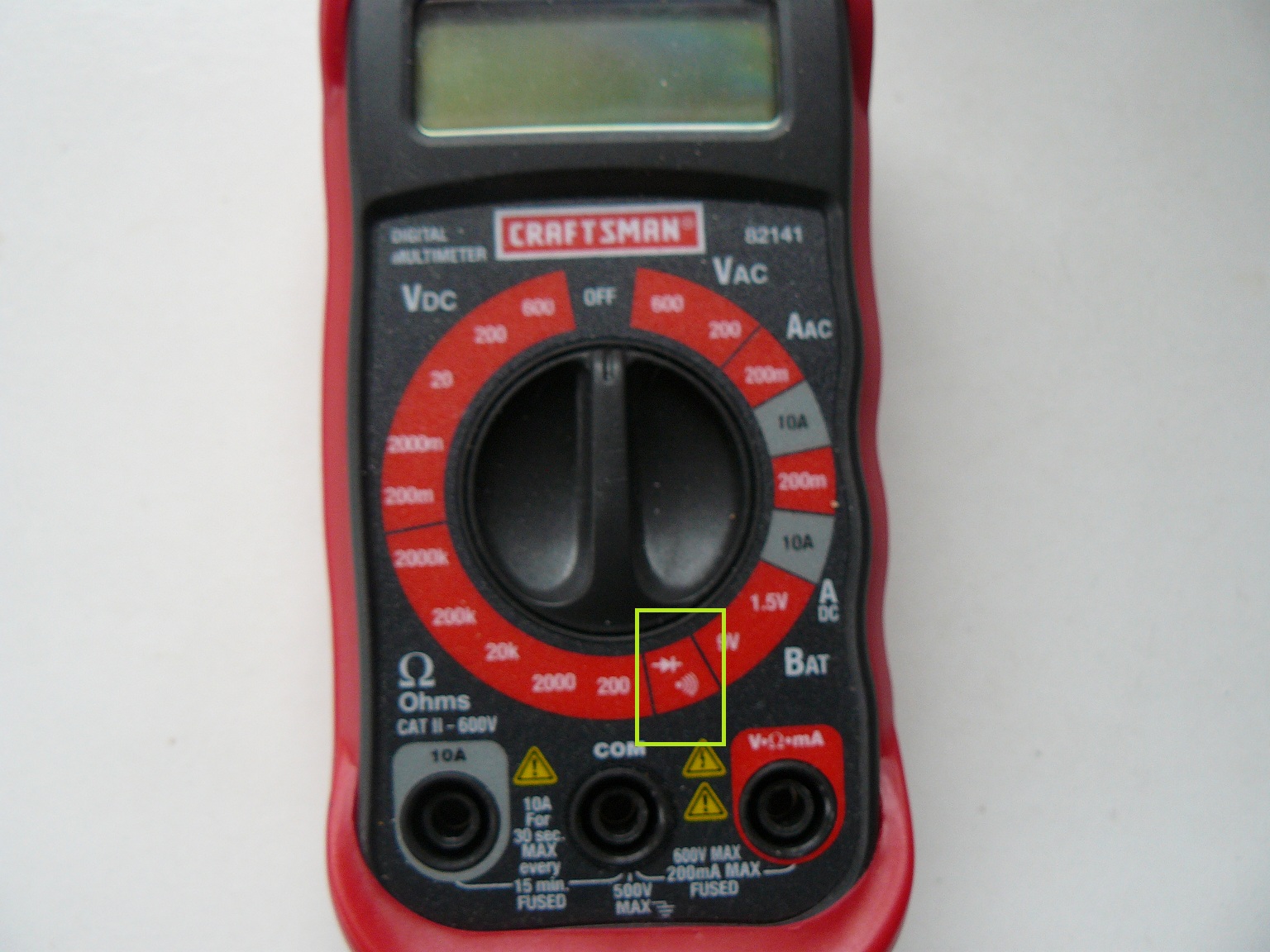

            Just make sure it has a diode check function for it. I'm sure even the cheapest multimeters should have that function. I pulled up my photos from my cousins power supply and the 2 diodes we changed we ZD902 & ZD904

                If you want to do it blindly (though i don't recommend). We went to radio shack and got a 3 pack of diodes (276-1114). Swapped them out and the tv worked. If this does work get the numbers off the actual diodes so we can help you get the correct one. Also, try to not damage the 2 originals removing them if possible so if this doesn't work you can atleast put them back in the board.
                And make sure the new diodes are put back the exact same way. There should be an arrow under the diode on the board. The gray stripe goes to in the direction of the arrow.
                  Re: Phillips 42PFL5432D/37 Chirping and No Picture
                  Make sure to use a 600V rated PIV diode or higher. Like 1N4007. Probably has to be fast recovery so FR4007 would be better.

                    There are 2 SMD fuses on each inverter board for a total of 4. If they are open (bad), then your backlight won't turn on.
                    If you don't have money, try to borrow a multimeter from someone to test the fuse and diodes as Mr Bill as pointed out.

                              FR4007 is 1kV not 600V, but any fast 1000V or 800V silicon diode should be fine. Don't get a standard 1N4007; it's nowhere near fast enough.

                                Any recommendations on a video teaching me how to use this thing correctly?
                                Or will this do, with same basic idea for fuses..
                                http://m.youtube.com/#/watch?desktop...i_X7Ew3Y&gl=US

                                        Ok. Continuity is fine to test the diodes though? Be nice to not to have to remove diodes unless its the right ones if possible.
