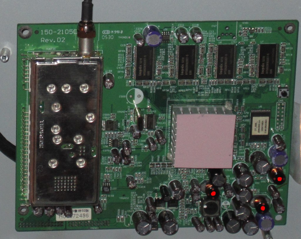

                  They sure didn't make this TV easy to service.
                  Uploaded with *************
                  The connector you see coming out of that bottom board makes its connection in the upper left quadrant of the board in the upper right.
                  here is a link to a very high res version of the photo:

                    Re: Repairing PSU FSP271-4F01
                    I've marked coils with a red dot.
                    Does this thing use three main boards? Crazy... I've seen two before, never three...
                    Take a piece of newsprint or magazine and roll it up to create a tube - use this to locate the source of the noise exactly.
                    Also what is that parallel-port like connector at the top of the main board?

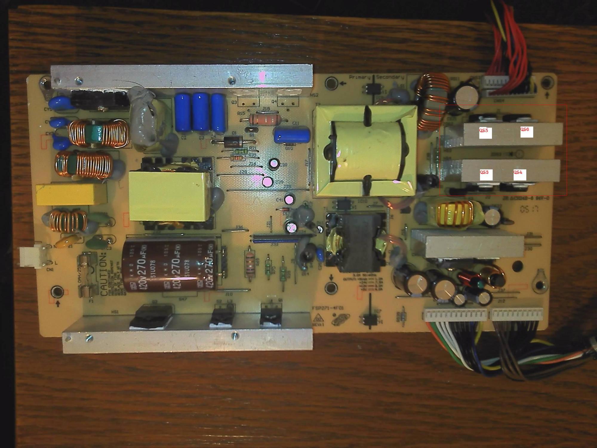

                            selldoor, thanks for the reply. Unfortunately I don't have the TV set with me, my brother removed the power supply and asked me to take a look at it to see if I could fix it. The fuse on the power supply blows immediately, even if not connected to the TV. I used to be a bench tech back in the 80s repairing complicated 300 plus chip count telecommunication circuit boards to component level. I can remove and solder these basic electronic components of this type of power supplies.
                            The TV is the same as the OP, Olevia LT42HVI 42" LCD TV.
                            After looking at QS6, I see QS3, QS4, QS5 which are all part number SUP40N10. I cleaned up the QS6 I pulled and looked at it with a loop and was able to make out the part number as a Fairchild FDP2552.
                            I wonder if the p/s manufacturer replaced the Fairchild FDP2552 with the SUP85N15 as it looks to be a higher current MOSFET? I guess I should order the Fairchild FDP2552 just to be safe.
                            Here is a picture of the power supply from the OP, I have outlined the MOSFETs and labeled them.

                              It has been said a number of times on here that posting a picture of another board is like going to the doctors when you are unwell and taking your brothers X-rays along to help with the diagnosis.
                              Does the fuse still blow with the mosfet out?
                              If so did you test Q2

                                selldoor, That is a great analogy, I currently don't have my camera, so I couldn't take a picture. I only posted the OP pic so that you could see the location of the mosfets. I will post pictures of my actual p/s once I get my camera back.
                                I tested Q2 for shorts with a DVM to make sure it was not shorted I did not pull it or test the operation. With Q3, Q4 and QS6 removed the fuse does not blow. I did remove the bridge rectifier and it tested good, then put it back before powering it up.
                                Since I know know the part number of the mosfet, I just need to order the Fairchild FDP2552 at location QS6. Looks like it should be under $10 shipped.
                                I would just hate to replace the 3 mosfets and have them blow again, so I'm trying to trace the path from the mosfets to see if anything down stream is fried that caused them to blow.
