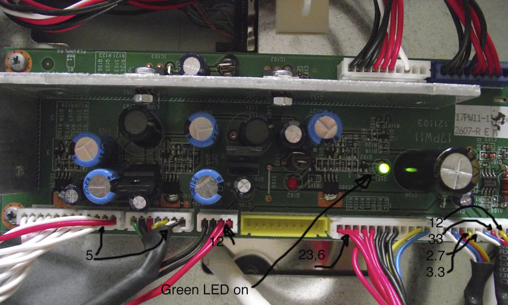

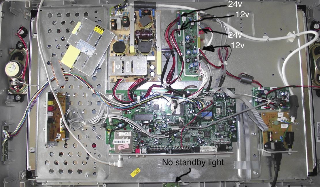

    This set has the normal 12 and 24 volts going [see picture], but there is no standby light on.
    [A privately imported set with no backup of any kind on the Internet or manufacture, it appears. Model is DigitalArt DA-32TW04, anyway.]
    There is life in the signals board with some hot ICs.
    It looks like this board could be faulty.
    What do you think?

    If I'm not mistaken that's a Vestel set. They are made in Turkey.
    Vestel TVs are some of the worst to service. The ugly, nearly impossible to follow wiring, poorly laid out main board, intermittent faults (especially caps that don't bulge and bad solder joints) and the difficulty of finding service manuals are just some of the reasons.
    Vestel power supplies usually output 3.3V standby, 5V standby, 5V run, 12V and 24V. Check all are present. Check for ~395V across main bulk cap when running (should be 320V in standby.)
    Note these sets sometimes turn OFF the standby indicator when running so check the backlights aren't faulty. And do you get sound?

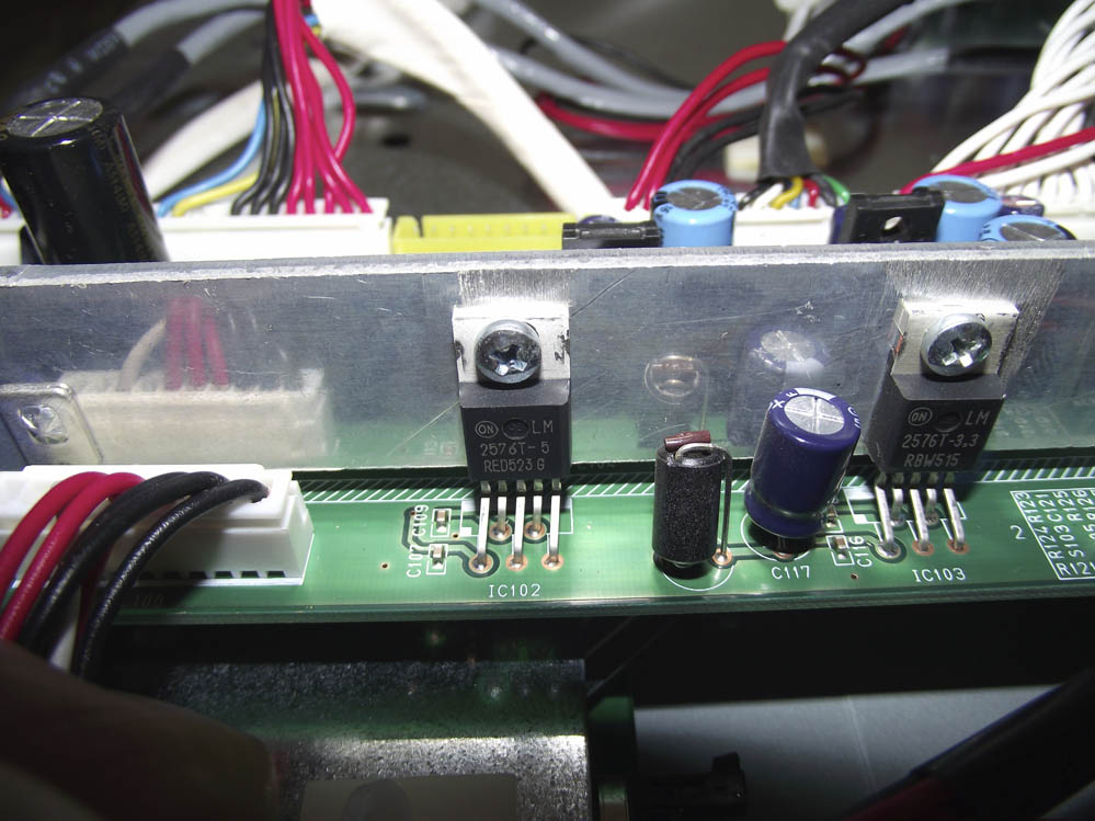

            The board next to the PSU seems to have regulators and whatnot on it. Post some close-up shots of that board so we can identify what they are. Also post a few pictures of the PSU. Looks like a single, always-on power supply (i.e. no standby circuit) with PFC, but I can't confirm that without good pictures. It could be that this power supply only provides 12v nad 24v and the rest of the voltages are derived from that other board next to the power supply (so the PSU may actually be working fine).
            • burntfingers
              • Jan 2011
              • 148
              Re: Dead screen, no pilot light
              Yes, the regulators work fine - voltages as per photo - although the 23.6 for inverters is not switched on sometimes - I need to turn the on/off switch two or three times; the green LED comes on all the time.
              There is also 5 volts on the standby LED, but it does not turn on.
              HS plate is rather hot after a while.
              In other words, all voltages seem to be OK, but the set remains dormant.

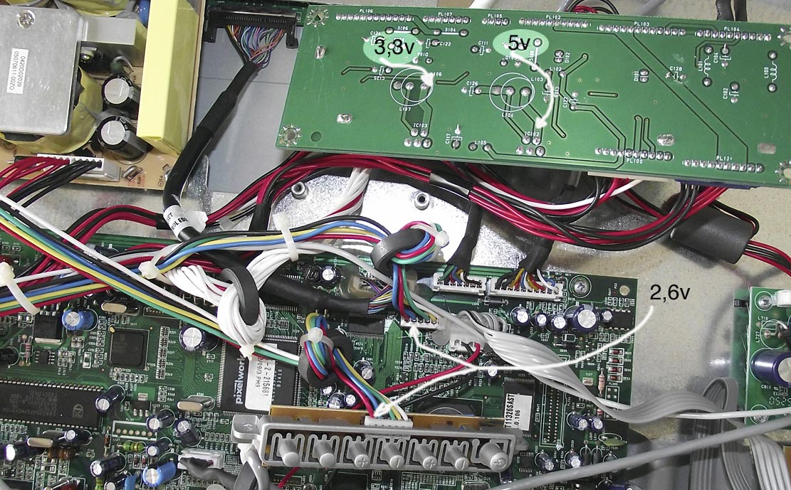

                  5v is OK, as the 3.3v too.
                  Power supply seems to hum normally.
                  I noticed that the supply to the control buttons is only 2.6 - not sure if that is OK.
                  Nothing happens, even if I remove the supply to inverters.
                  I still suspect the signals board is faulty.

                            Well, found Plug 602 which goes to plug 104 on the PS interface board.
                            Pin 1 is dead, no voltage present on both ends of the cable, and also checked under the interface board.
                            Pin 6 reads .017 volts.
                            I could not locate in the diagram any source for that pin 1 voltage, like I did not find the 8 volt supply mentioned in the PS description of the manual.
                            All other voltages are present and accurate, and green LED is happily on, the set being absolutely dormant!
                            I also measured the caps in circuit and look fine.

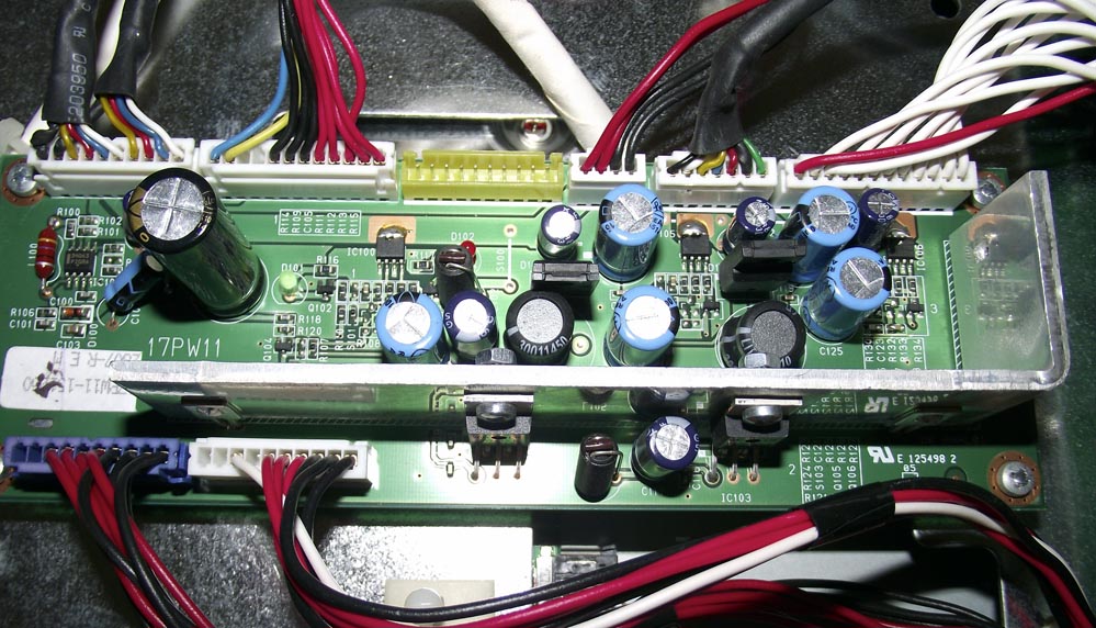

                                        I didn't notice this board is using an add-on DC-DC converter. Check the output voltages on this converter, across the main caps. They should be 5V and 3.3V. Were these the voltages you were reporting when I asked you to check 5V and 3.3V?
                                        Those Lelon caps could be bad, too, but I think that would cause a low supply voltage, which would be obvious. Also, Lelon seem to think copying Panasonic's T-vent is fun, they can't seem to make up their mind about whether to use an X or a three-way star.
