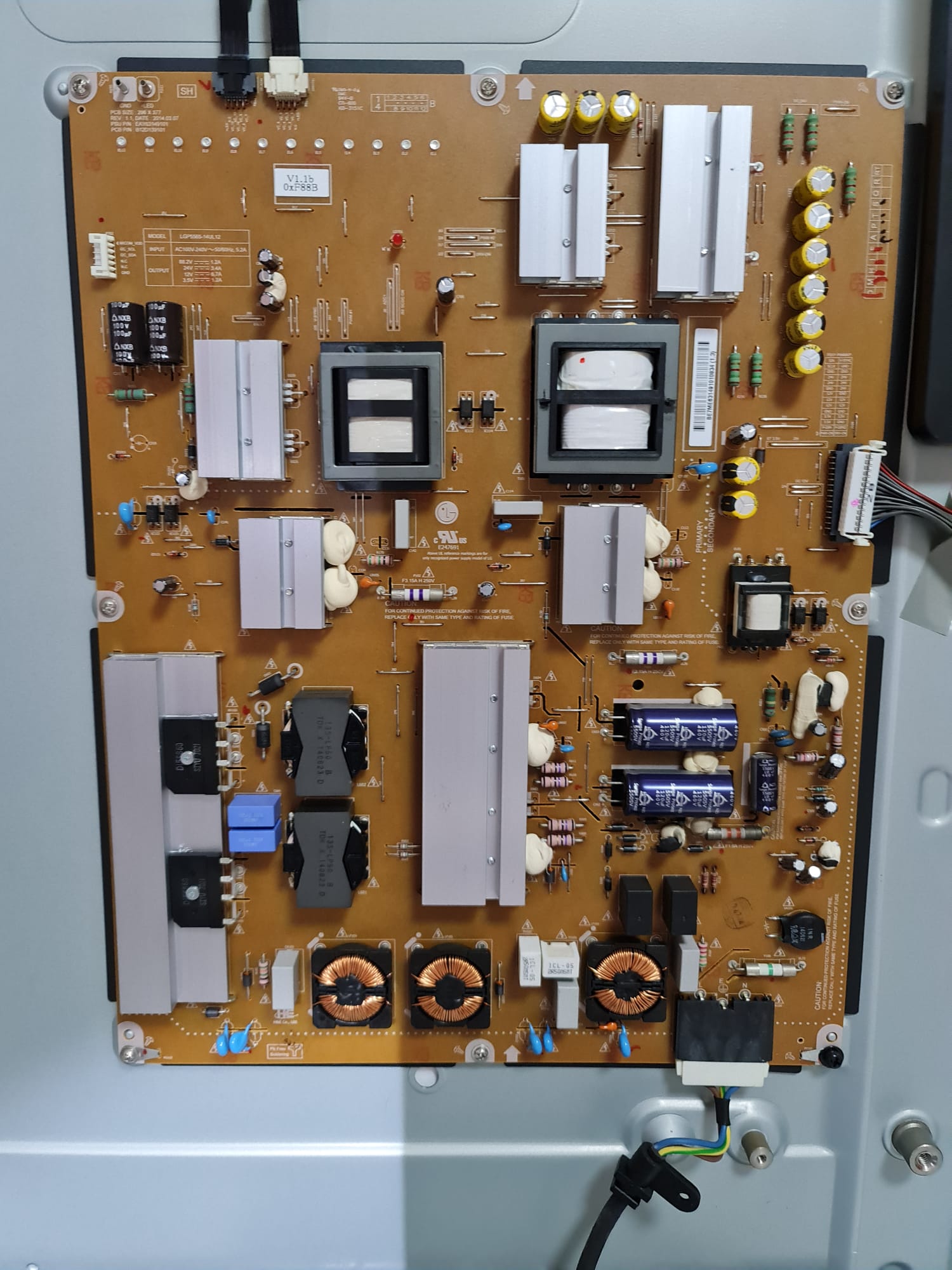

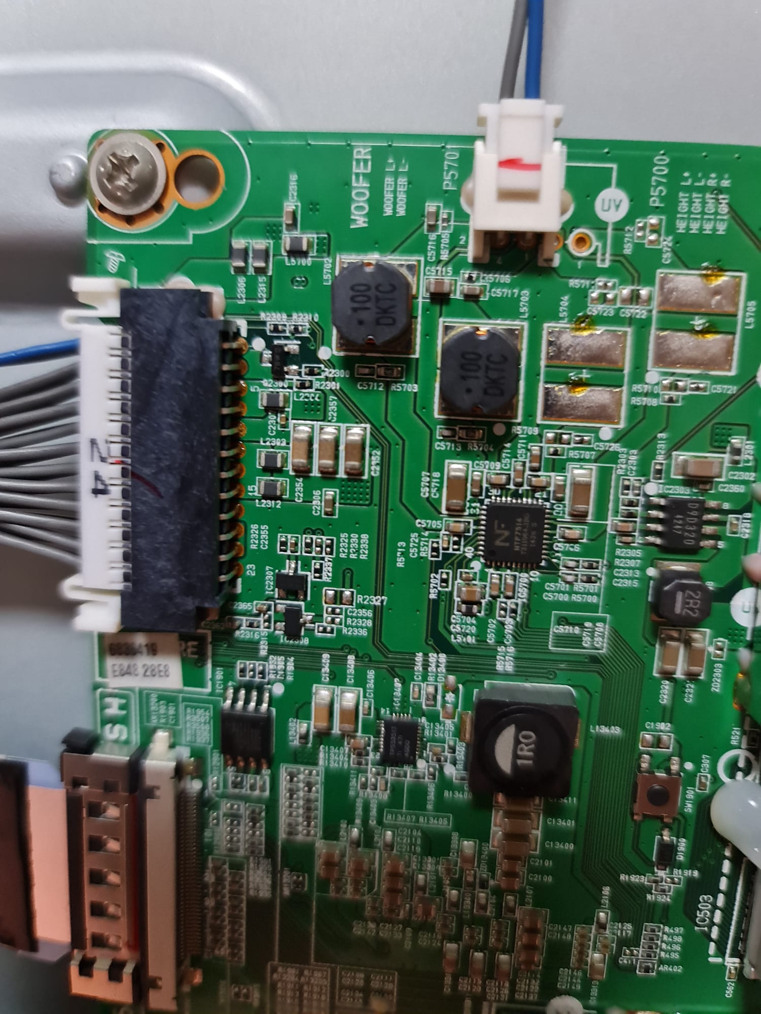

    The problem: When remote controller is press, the TV seems to wake from standby light goes off; but there is no backlight, image and sound. The relay did click on.
    I have removed the power board to check. Using 2 x 10K resistor from 3.5V to PWR_ON AND DRV_ON, all the voltages is correct.
    The main board has a red LED and is lited, but the optic link does not light up.
    The Power board after sometime will start to blink x 5 interval.... I would assume this is to indicate DRV_On not working.
    Any expert here came across the same problem? I suspect is the main logic board but cannot confirm.

    try to put yours DMM probe on BL LED+ and - on each group of the white and black socket and compare the high and low voltage on each group at start up
