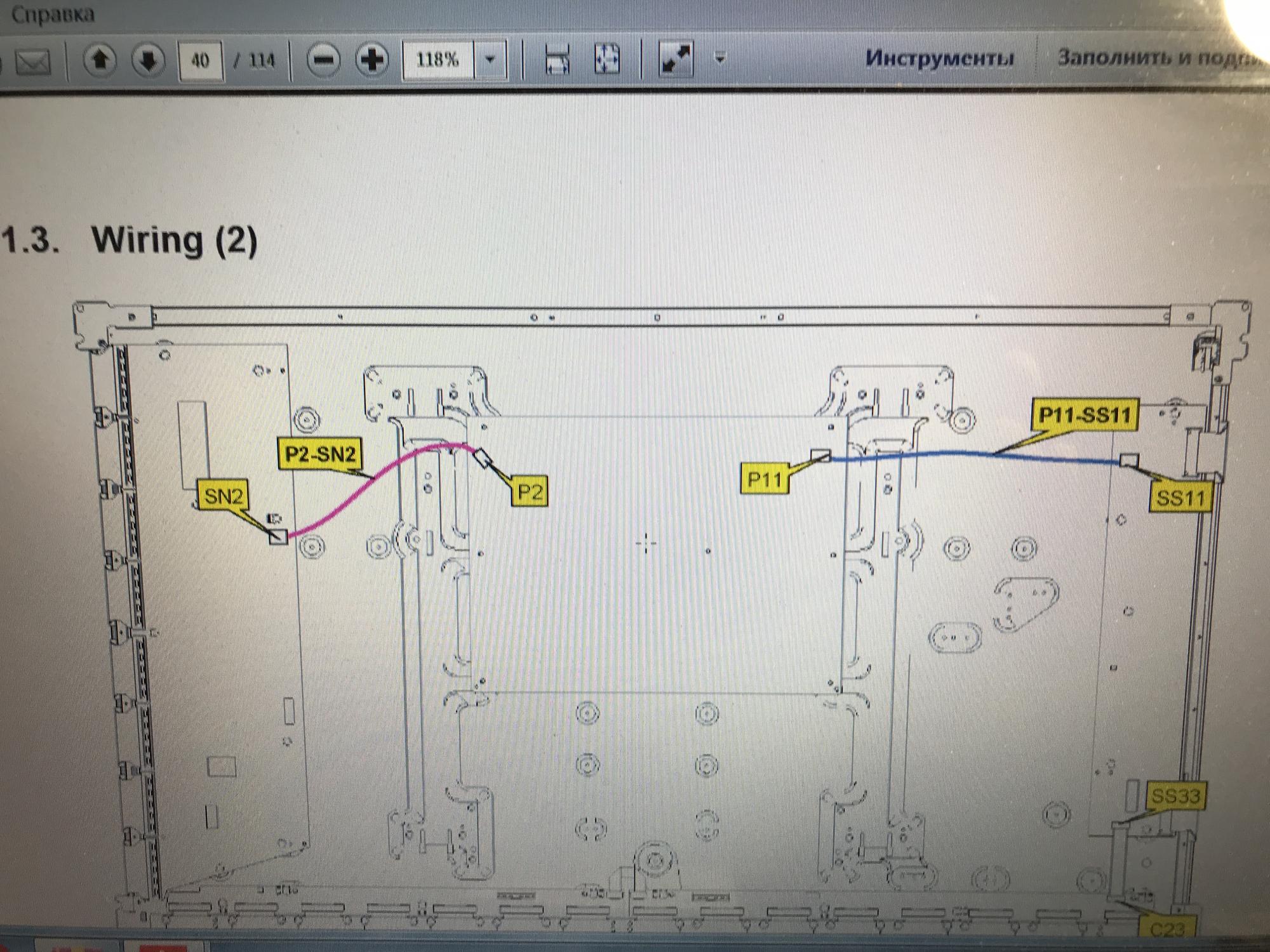

    Hi, haven't been on the forum for a while. But I thought I'd ask here incase this has already been solved.
    Anyway, I have this Panasonic TX-P50UT30B. It's completely dead, no red standby light, nothing. I took off the back and had a look at the fuses. All of them are intact. No shorts when testing the mosfets of the Power supply either.
    And the capacitors look fine also.
    I'm guessing it's a main board issue. But I don't really know tbh. Maybe a corrupt firmware flash, dunno.
    Re: TX-P50UT30B Dead - No Standby light.
    Check if there is a short circuit on P2
