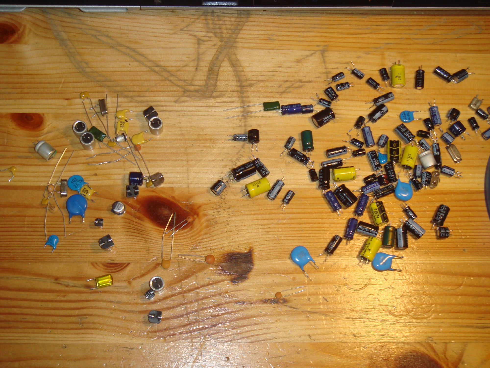

    I have a few electrolytic capacitors that would fit, but I will only be able to fit one (I was thinking I may add up a few to get the correct values, but there is not enough space).
    One is labeled 33 μF and 16v, and has a multimeter reading of 36.6 μF. The next nearest is a 22 μF and 50v which has a multimeter reading of 20.5 μF.
    A picture of both caps is attached. Any opinions on the matter?

      More capacitance doesn't generally do any harm.
      If you use an electrolytic make sure to secure it down, for example with a weak glue. The leads won't be enough if surface mounted; if you move the TV it could fall off the board.
      I would highly recommend you use a ceramic though.
      Have you tried powering it up without the failed cap?

            Ok, I just started it up without the caps and it worked - at least for the time I left it on (about 10 seconds). It displayed the blue "stand by" screen, and had the channel number in a box in the upper corner. Nothing seemed to blurry, but I didn't really test it with much graphics - I was just really psyched it is working. I swear I am going to frame the tiny single burnt out smd capacitor as a trophy.
            Anyway, now that the issue is almost completely resolved, why are you (tom66) against electrolytics for the repair and budm is recommending them? How much of a difference would it really make (especially since it will run with no caps at all)?

              I'm against using electrolytics because the designers specified ceramic for a reason. Ceramic capacitors are more expensive than electrolytics. They could have used surface mount electrolytics but they didn't. Sort of like most of these boards are gold plated, because signal integrity is crucial.

                                  That area of the board is the switching power supply (the IC, inductor, diode next to the caps) section, make sure to use low ESR type capacitors, also connect the DC Voltmeter to check the DC voltage on the cap to see if it comes and goes when the pcitures black out.
                                    #157
                                    Re: Vizio VW37 Power Supply PSON working but no 12v or 24v output
                                    Originally posted by Tetranitrate
                                    Also, is there any reason why I can't use a much bigger capacitor, tape it down elsewhere, and just run a pair of wires to the traces?
                                    Inductance.
                                    Adding series inductance to the circuit may introduce more instability. You will form a resonant LC-tank circuit if you are not careful. The R will damp some energy leading to extra heat dissipated in the cap but most importantly the control loop may be unstable.
                                    This is why I recommended ceramics. Low inductance and ultra low ESR.
                                    You don't need -more- capacitance. You need less ESR. The goal of the capacitor is to kind of act as a sink for all that high frequency noise from the switching action of the MOSFET, and to provide energy to the load during the off-time. It also forms part of the transient absorbing circuit, providing energy during sudden load changes. A capacitor helps do all of these things but in all cases the ESR is effectively in series with the load or FET leading to higher ripple, poorer transient response and lower output voltages.
                                    The ESR of the cap is probably several ohms, so it's effectively useless.
                                    While the TV is working make a note of the output voltage. Then find the largest capacitor in 1206 you can find with the nearest voltage. E.g. if you measure -10.5V, choose a 16V 22uF ceramic in the 1206 package.

                                          Roughly 70kHz - 3 MHz, probably around 500kHz.
                                          You could scanvenge one off an old Pentium 4 (or later) computer motherboard; near the 12V DC VRM input (4 pin P4 connector) there are sometimes a couple of 1206-size ceramics.
                                          Or a graphics card, I have an old X1900 which has bad BGAs and plenty of ceramics near the 12V input.
