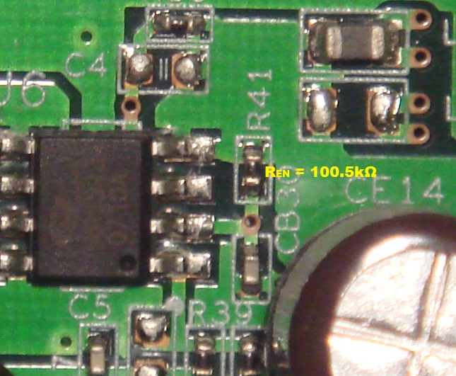

    I think it is just the photo that makes the U6 soldering joints look a bit bad.
    As for D4, I don't want to get my hopes up just yet (I have done that many times previously throughout this process), but I think it may be faulty.
    With my multimeter set to the diode check function it reads (and the power off):
    .177 VDC with the red probe on the ground side (left side in the photo)
    .607 VDC with the black probe on the ground side (left side in the photo)
    Is this diode the problem?

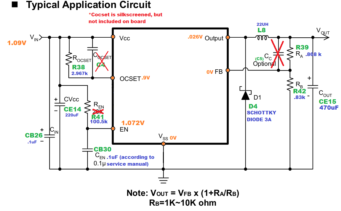

                AP1513 (Datasheet attached)
                Also attached is a photo of how the diode was tested, that also shows U6 more clearly.
                The input Vcc has to be higher than what the output of the chip is, right? Is there any way to know what the chip should be receiving at Vcc? If I knew that would I be able to work backwards to where the voltage is correct?

                  That's the right way to test the diode. Make sure to install it properly now as it should be fine.
                  Measure the resistor values next to pin #1, these determine output voltage.
                  Pin #2 should be >2.0V to turn the converter on, check this is the case.

                    R39 (RA on the schematic) reads .868kΩ, and R42 (RB on the schematic) reads .83kΩ
                    I added these values to the attached filled in schematic.
                    According to the service manual, both of these resistors should be 1kΩ.
                    Pin 2 is at 1.072V

                      On the second to last page of the chip datasheet, it says that the chip uses "under voltage lockout". If the Vcc falls below 3.3 volts then lockout will occur. It seems like pin #2 is low because my Vcc is low (1.09v).
                      I have attached an updated typical application circuit, Vcc and EN are related to each other by REN. In their theoretical sample circuit REN is listed as being 20kΩ. I just measured REN (R41) as 100.5kΩ, which matches up with what is should be according to the Vizio service manual (100kΩ).
                      So if the low Vcc is the culprit, then I need to track that down, but am having a hard time finding out where it originates on the board.

                        So I have been staring at this portion of the circuit for a few hours trying to find traces that lead into Vcc or out of Vout and I have not been able to find anything.
                        Would it make sense to have a portion of a circuit like this completely isolated from everything except for the ground plane? From what I can tell there are no traces that lead into this portion of the circuit or out of this portion of the circuit.
                        I have attached an image with the isolated are circled in yellow. There are five traces that pass by on the bottom right portion of the circuit, but (as far as I can tell, although I am pretty certain) they do not connect with it. On the underside of the circuit board there is connection between the positive portion of CE15 and L8. The negative lead of CE15 is tied to the ground plane on the underside of the board, but besides that there are no other connections.
                        I have also included an even further updated schematic diagram of this portion of the circuit, which I think is correct, although I am not sure about Cin or CVcc, the values for those two might be reversed. CB27 and L16 are not included in my ms paint schematic, because I am not sure where they would go.
                        I can't imagine the purpose of having something completely isolated from everything but the ground plane, unless it is some sort of circuitry to keep watch on the ground, and make sure there are no stray voltages or currents floating about.
                        I really hope this makes sense to someone who reads it, because I am at a loss for how this magical portion of the circuitry is working.
