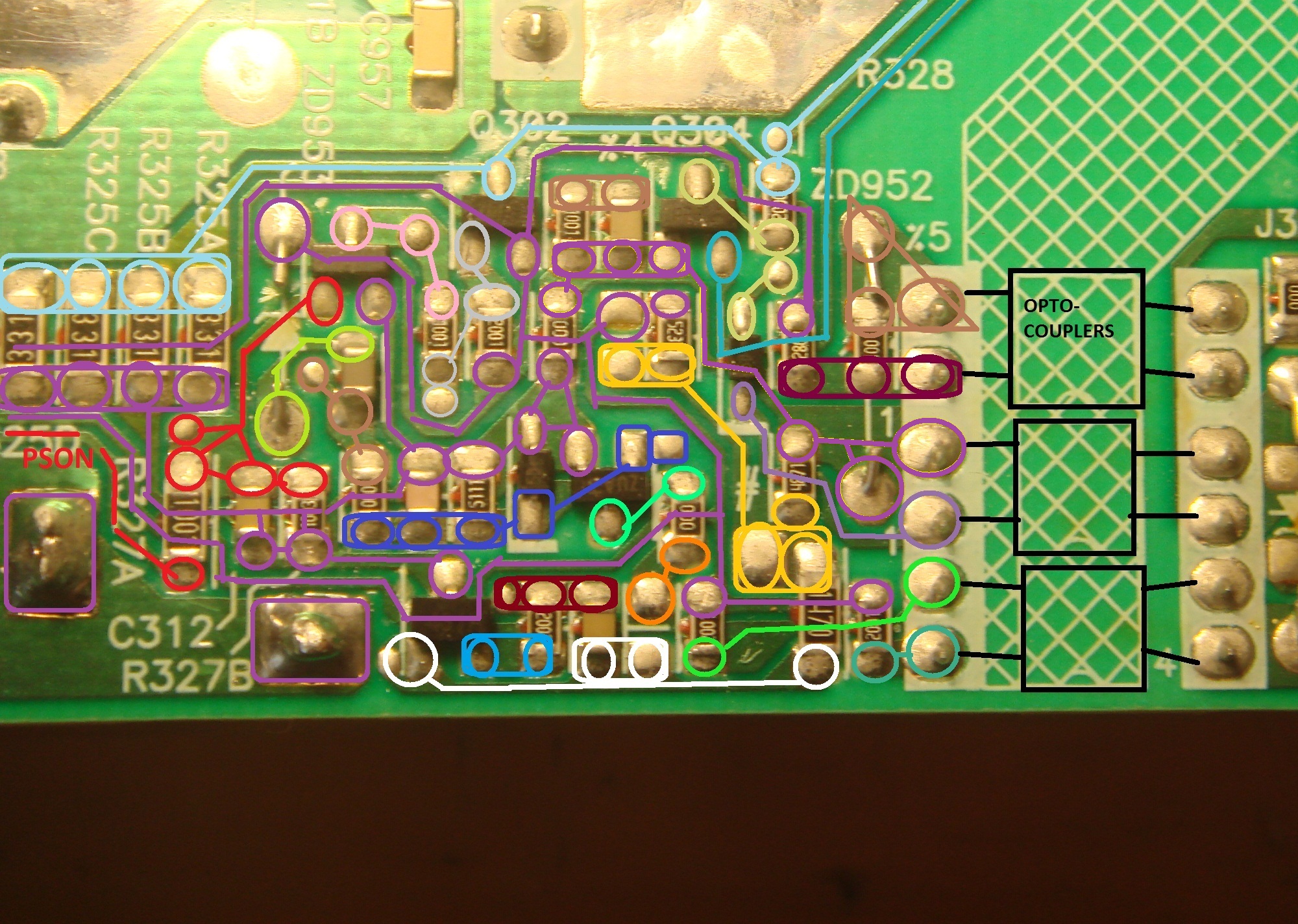

                                      I have traced out PSON to the opto-couplers, and attached a traced out picture. It is probably pretty useless in its current form, but I figured I would attach it anyway just in case someone recognized something that I should instantly check.
                                      I am working on drawing a schematic of it, either by hand or using orcad cadence.
                                      In the picture the PSON line comes in from the left and is show in red. The dark purple connections everywhere are the ground.
                                      It sorta looks like the PSON line goes through two transistors, and then to the light blue line on the middle/right top.

                                        Further modified the picture a bit to account for a 0 ohm resistor, so the circuit has some more ground.
                                        **Now with 20% more ground!**

                                          Likely, only one of those optocouplers is for sending a PSON signal. Do all the optocouplers face the same way, or different ways?
