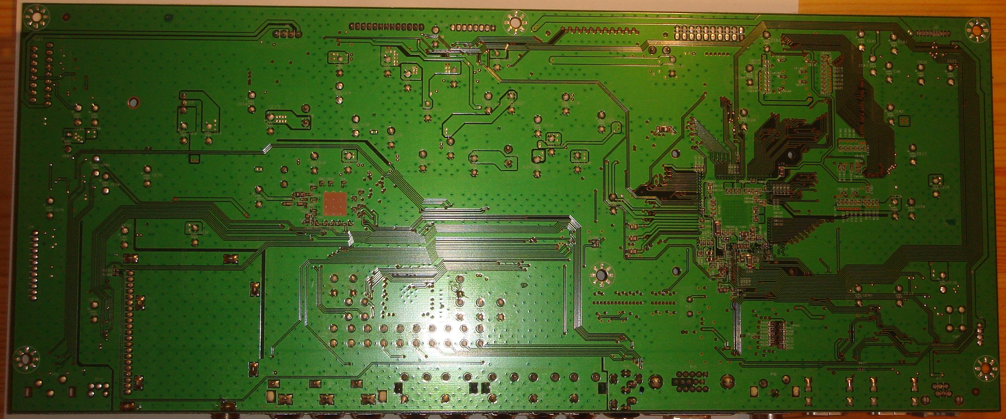

    I have attached an image of the back of the main board. There are no chips on the back of the main board, just a few SMD inductors and caps.
    Should I work backwards from the PSON pin on J1? There are a pair of BJT NPN transistors (MMBT3904L) directly connected to J1. Would my best best of finding the problem be to follow the traces leading into the PSON pin?

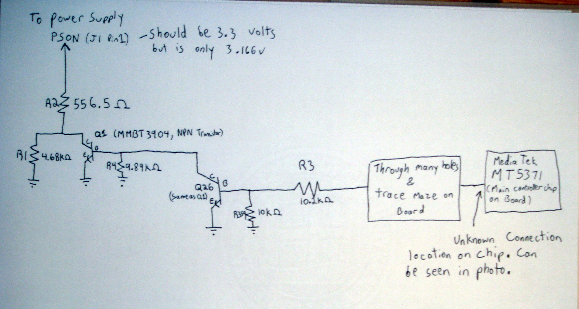

          I traced PSON from the the "start" at the jumper pin location to the the "end" at the main chip on the board (MediaTek MT5371). I have attached a hand drawn schematic. If you cant read something on it let me know.
          The PSON is connected from the jumper pin to a pretty basic NPN Darlington pair, and from there is connected to MT5371.
          All the resistors are within range of their expected values.
          What readings should I start looking for?
          The service manual has a few pages on the MT5371 which I am currently going through. I will report if I find anything indicating where the base of Q26 is connected, or what value it should be at.

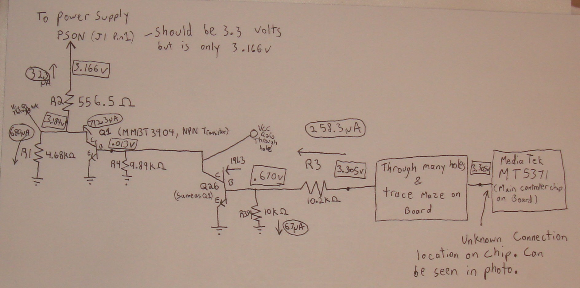

            I just took voltage readings at the various nodes. An updated circuit schematic is provided.
            I am hoping that these voltage values will instantly set off some alarms for someone reading this. I will have to dig out my old Electronics 2 notebook and will attempt to analyze the currents in the meantime.
            The 3.305v at the MT5371 makes me feel confident that I have isolated the problem to this very small portion of the circuit.
            So, ideas anyone?

              The circuit doesn't make much sense; Q26 pulls the base of Q1 low when Q26 is switched on, but what about when it is off? The base has no current to ever turn it on.
              Is PSON naturally high when disconnected from the main board? Otherwise, where does the 3.3V come from?

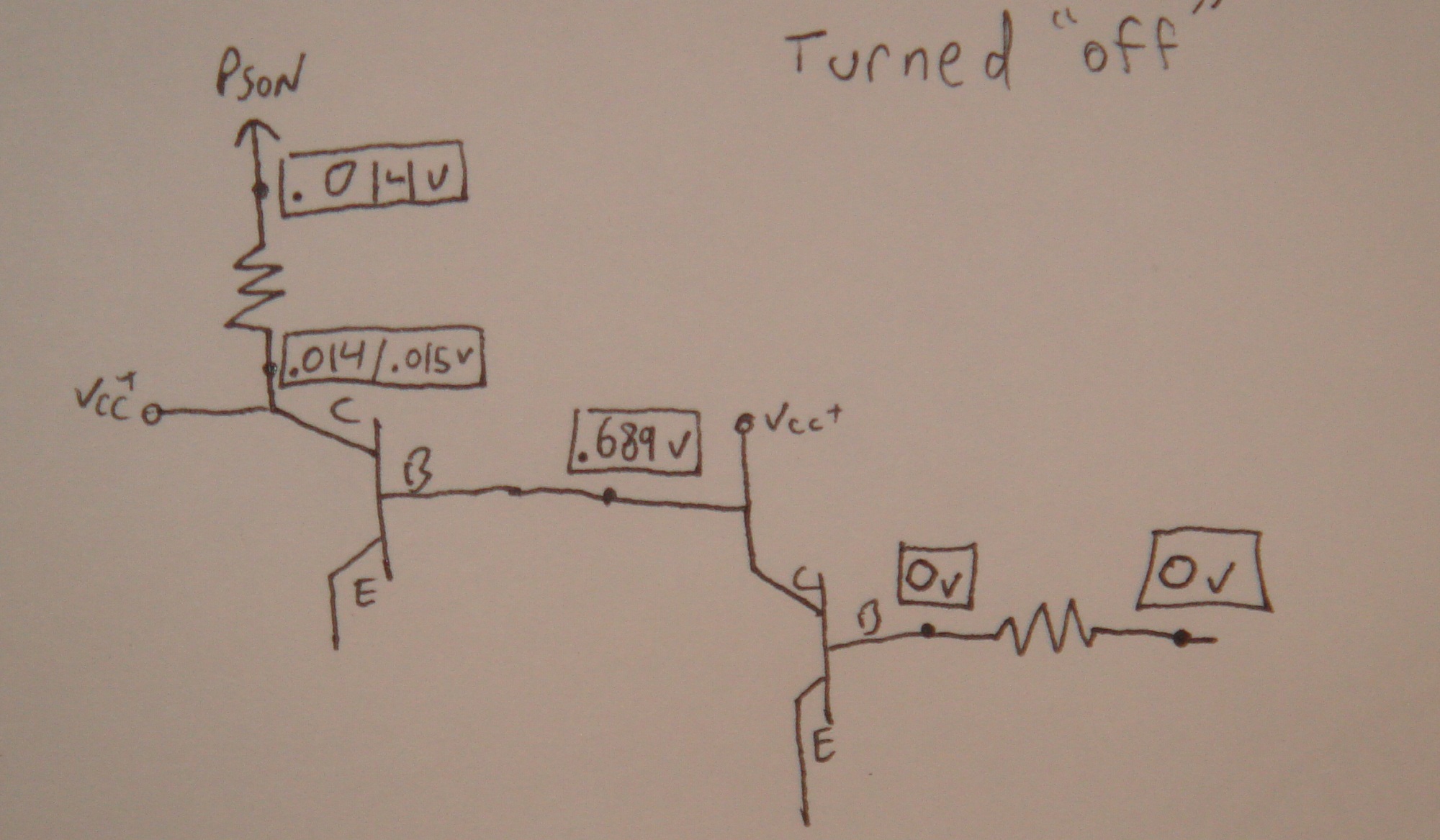

                    #69
                    Re: Vizio VW37 Power Supply PSON working but no 12v or 24v output
                    I have updated the photos and schematics to include (what I think are) Vcc's now. I have also attached a simplified schematic (just showing the relevant voltage nodes) with voltage measurements for when the system is turned "off".
                    There are two through hole traces that I am pretty sure must be the Vcc's for the transistors. It looks like tom66 is right that when Q26 receives the 3.305v from the MT5371 it pulls the base of Q1 low. Pulling the Q1 base low pulls up the voltage at Collector 1 from .014v to 3.184v. Is this correct?
                    I have been having a real hard time finding out what the Vcc's are connected to though. I have swept a whole bunch of the board using the continuity measurement on my multimeter, but have not found any connections. I have been thinking of making a test probe device out of a metal wire brush soldered that I could use to check for continuity on large portions of the board, and then from there further localize it. Thoughts?

                      No; there must be a resistor there, not just a trace to Vcc, otherwise the transistor will short the rail when it turns on (and it will melt.)

                              I'm beginning to think you've got a prebiased transistor, but there could be some resistors under the board, or elsewhere on the board. It's possible the signal is used elsewhere i.e. to turn on/off the buck converters, so placement of the resistors elsewhere could be a layout decision.
                              One way to check if this circuit is working is to remove or lift one leg of the resistor from the MLTxxxx to the base, and inject a signal into it via a resistor of similar value. It should be possible to get it to vary from 0-3.3V.

                                That is pretty delicate surface mount work. It is doable, but I would rather try and not do something like that for diagnostics unless it is a last resort, since there would be a high chance of me messing something up.
                                We know that when the base of Q1 is pulled low, the collector voltage goes high. Base 1 goes from .689v to .013v when the TV is turned on, and this makes Collector 1 go from .014v to 3.184v. The base of Q1 is connected to ground through R4 - a 9.89k ohm resistor. What if I were to add another resistor of similar or lower value in parallel with R4 to make the base of Q1 go even lower. If I were to add another 9.89k ohm resistor in parallel with R4, the voltage should theoretically drop by a half - making the base voltage of Q1 be around .006v, then if the voltage at Collector 1 rises at all, we will know that the problem resided with Q26(or its associated resistors).
                                If the voltage at Collector 1 does not rise, even with its base value being halved, then we will know that the issue has to do with whatever VCC is supplying Q1 not being high enough. The only problem I see with this test is putting twice as much current through the collector of Q26, in order to half the voltage at Base1.

                                  Okay, hold off removing the resistor.
                                  I don't think 0.014 vs. 0.006 is going to matter to the transistor. And 3.184 is enough to saturate the transistor, provided the base resistor is not too high.
                                  Try tracing that hole - it is going to involve random probing unfortunately, unless you have a schematic.
                                  There is also the possibility that some component on the power supply is dragging down this voltage, although it would be a rather strange failure.
                                  If you get tired trying to fix that circuit, you could always wire up a pair of logic inverters on a little piece of stripboard to replace them. Make sure the inverters support a ~1.5V DC input.

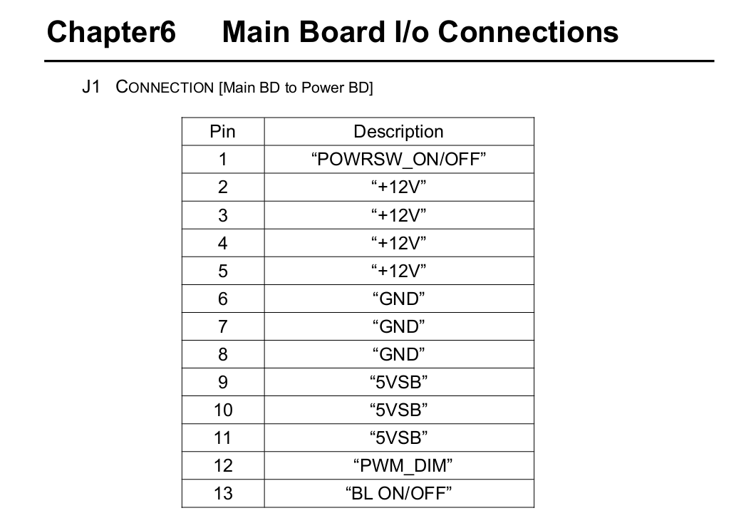

                                      If there were an AC detect would it have to be a connection between the power supply and the main board?
                                      I have attached a list of all the connections between the mainboard and the power supply, and it does not seem like there is an ac detect signal. There are only three connections besides the power rails and the ground pins:
                                      POWRSW_ON/OFF
                                      PWM_DIM
                                      BL ON/OFF
                                      The POWRSW_ON/OFF is the one that I am having a problem with. I assume PWM_DIM is a brightness control for the inverter board, and BL ON/OFF is for turning the back light on or off.

                                          The "A wire" is connected to pin 12, which corresponds to PWM_DIM, and the "B wire" is connected to pin 13 which corresponds to BL_ON/OFF. I am not sure if that is what you were asking.
