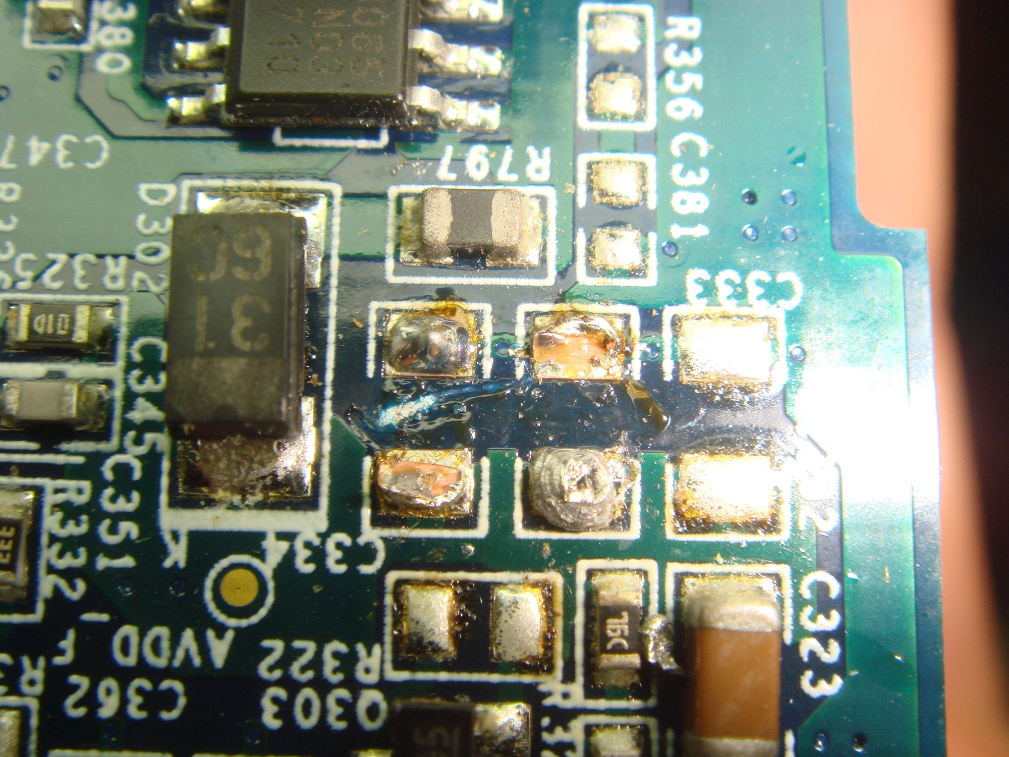

      Of course, none of these types of caps have any markings so when I go to replace that shorted cap, I'm going to take replace it size for size off a junk board.
      Haha, you answered my question exactly one minute before I even had a chance to ask it.
      On top of the .5 ohm resistance, I just checked the capacitance with my fluke 115 and it shows OL.
      How reliable would swapping them out size for size be? I bet I have some SMD capacitors sitting around that match up size wise. Would I really just be able to swap them out?

                C321 & 322 are at 4.47 kΩ and 215 μF
                C323 is 13 μF and 37.75 kΩ
                C353 is 163 μF and 4.434 kΩ
                D302 has 302 Ω (really? is that how they do the numbering for diodes?) and 4.431 kΩ reversed.
                RSS065 has 10kΩ S-G, 4.422 kΩ S-D, and 11.88 kΩ D-G.

                              C353 is stand alone, and C321 & C322 are in parallel with each other. The two failed caps (C332 & C334) are in parallel with each other, so I am guessing their capacitance value would be closer to 215 μF. It might possibly be a bit more since if two 353's were to be put in parallel it would bring it up to slightly over 300 μF.
                              Would my safest bet be to desolder a working cap (like 353), take some definitive measurements, do a parallel combo calculation, and solder in a ceramic capacitor of known value close to the calculated one?

                                      I brought the board to school with me and used a hot air rework station to pull both caps off. I did a slop-nasty job of it, but in the end got the caps off without damaging anything (picture).
                                      One of the caps is shorted at about 1 ohm. The other capacitor seems to be fine and reads 15-17 μF with a resistance in the 10's of thousands of ohms. With both caps off there is no more short on this portion of the PCB, and the resistance between the traces where the caps were is now something around 4 kΩ (a number I had seen elsewhere on the board and believe to be a good/correct reading).
                                      Do parallel cap pairs usually have the same ratings? Would it be safe to assume that the capacitor that shorted was originally around 16 μF? If this is the case then the pair of them would have been around 30-34 μF - right? If I were to find a single electrolytic capacitor in that range could it work in place of the two smd caps?

                                        Yep, you've found the fault. You can actually power up the TV now without the failed cap, but the picture will look poor... usually blurry or dim. Still, it will confirm if the rest is working. You are probably looking for an 22uF 16V 1206 ceramic capacitor. Check the voltage across the remaining good cap to find the replacement voltage rating.
                                        You cannot use an electrolytic capacitor. You may be able to get away with a tantalum, but ceramics are cheap and readily available, use them as you can guarantee they'll work.
                                        Something like this: http://parts.digikey.com/1/parts/764...bj226ml-t.html
