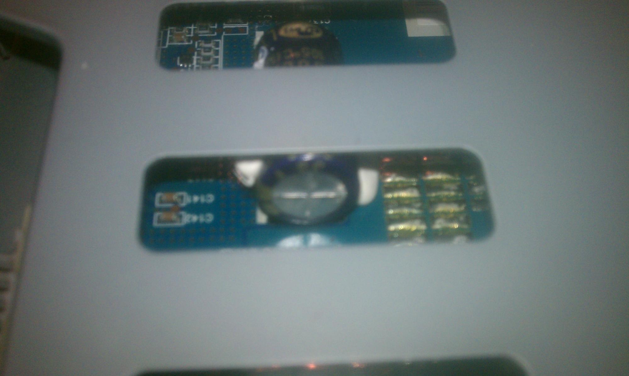

    Please Help.... I have a 47pfl7422d and the screen is now dim on the left side ... i was told a bad slave inverter so i replaced it, still dim, i removed the lcd screen and looked at the bulbs, right side is bright and the left sides are dim as if not working at all, could someone please help as i dont want to take this tv in for repairs Thanks

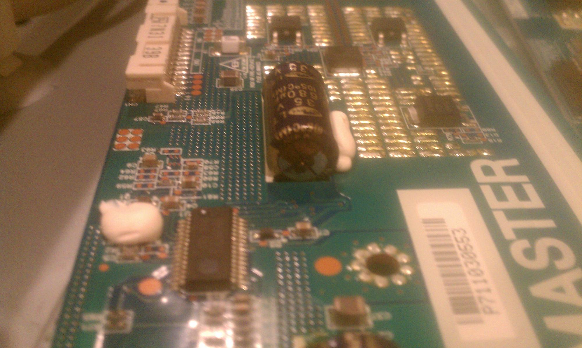

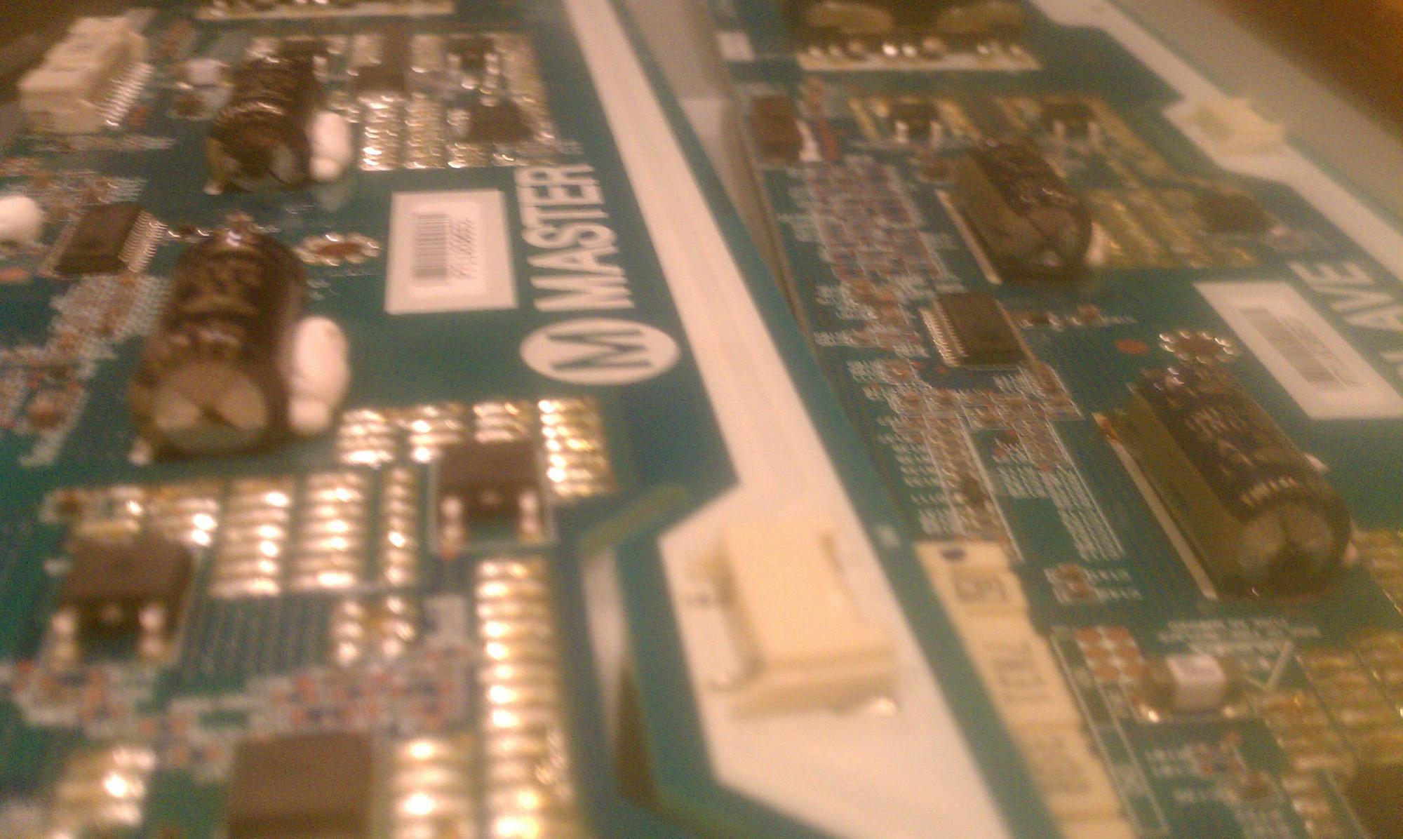

            i was looking at the 2 capacitors on the master and slave inverters and the new slaves capacitors look clean as where the old slave and masters look like they have opened up on the end and have had a blackish material ooze from them. Does this mean they are bad??

              Re: phillips 47pfl7422d is dim on left side of lcd
              Yes, they are bad. This is why we always ask for photos. Replace the bad capacitors with something like Panasonic FR or FM series from digikey or mouser.
              If that is a 680uF 35V cap, this will work (assuming height and diameter are okay)
                    ...and the new inverter(s) will need its/their caps replaced as they're using the same brand and series of SamWa crap capacitors!
                            ok so i checked the input voltages at the slave inverter and found that vin-1 - vin-5 have 23.95 volts, so it has power but seems like its not turning on anymore
                              well thank you all, i just checked the ceramic fuse on the slave board and it is bad, now to replace the little guy, hooked up jumper wire to the old master and bam it turned on... hell yeah
                                  yeah i dont know how it was popped unless it came that way or because i didnt replace both at the same time... but i soldered a the fuse from my old master to the new slave and the tv looks great
