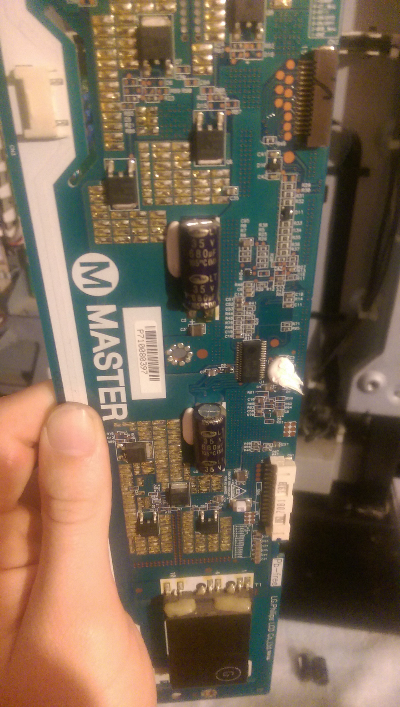

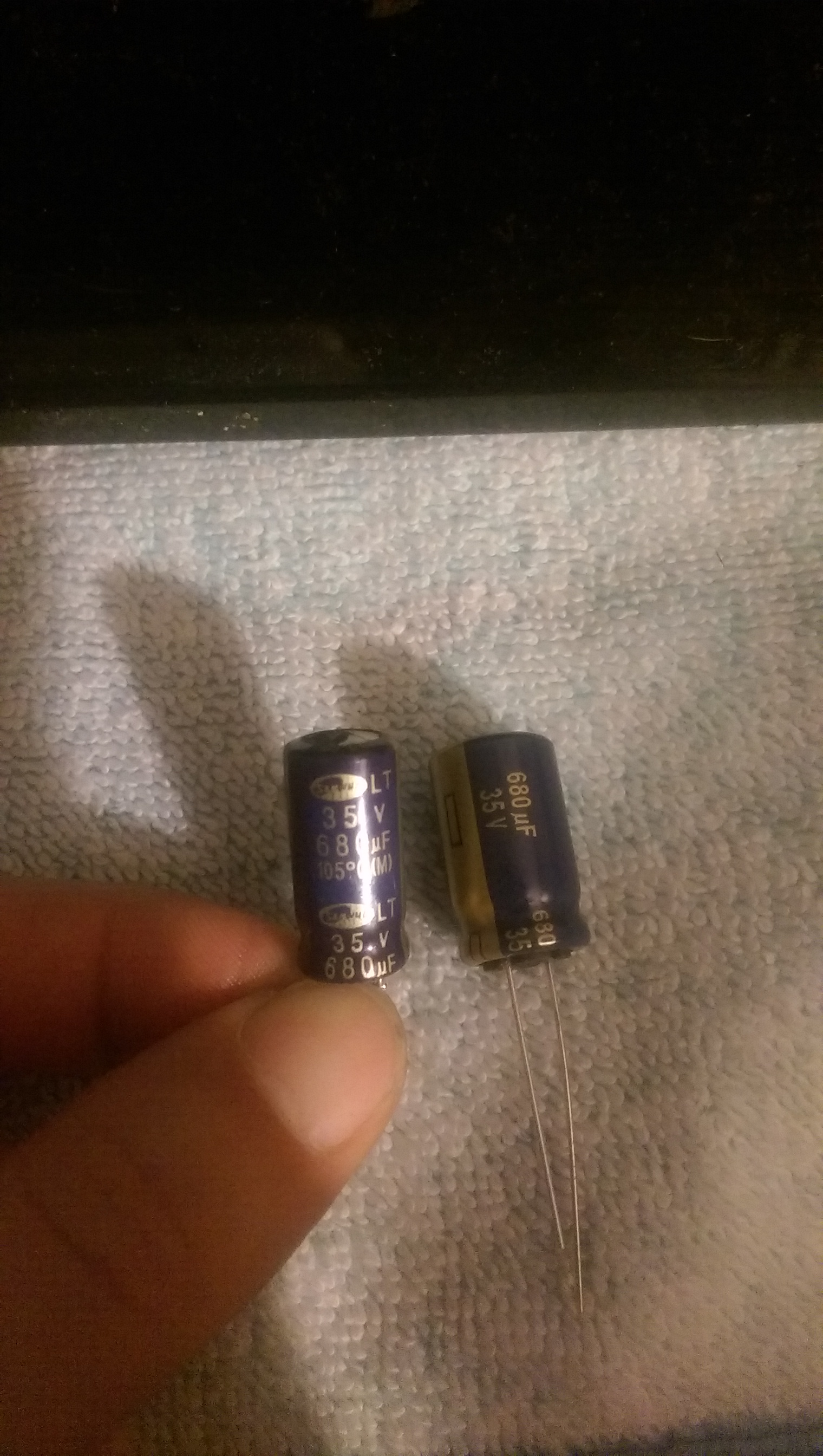

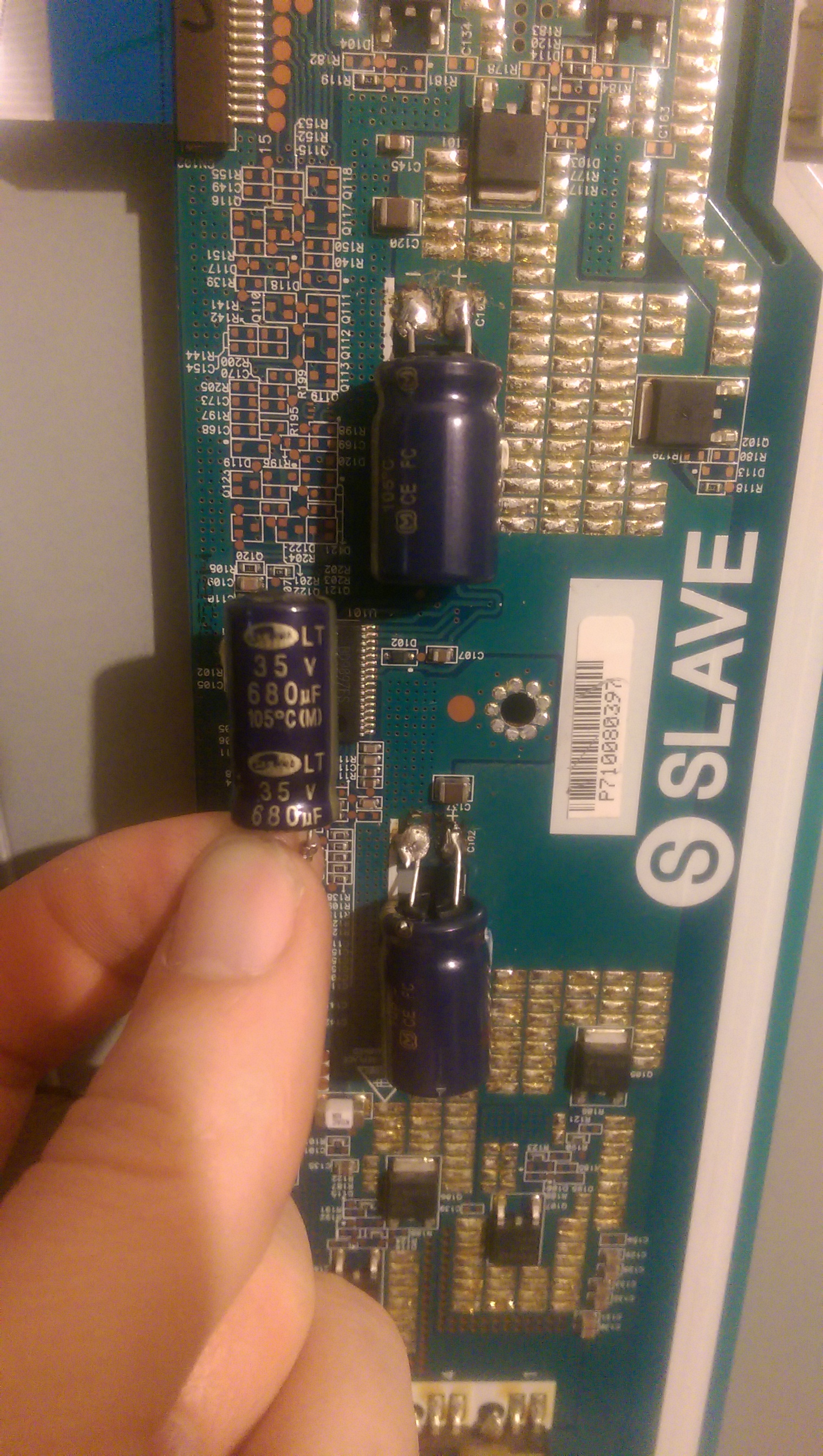

    @ Tom66 and/or anyone -
    I've removed all four 680uF / 35V caps. I've got a couple 1000uF / 50V caps from work - do you think I can use these or should I just order the correct caps?
    I'm a field engineer, not a design engineer. If I remember my college days correctly, I should still be within the 20% tolerance if these are wired in series. However, if they are wired in parallel then I'd be well over 30% off on total capacitance. I'm assuming they are just starter caps, and taken out of the circuit once fully energized?
    Thanks again!

      Re: phillips 47pfl7422d is dim on left side of lcd
      Well I found out that it totally depends on the circuit that is being worked on... For example whilst learning I changed a cap for a higher microfarad and voltage and it dodnt cause an issue, Did the same thing on another board and when plugged in... BANG! Fried 5 SMD ceramic resistors Lovely smell it made too but i fixed that and put the correct caps on and working fine.
      Someone else will be able to give you a more precise answer as I'm still learning but thats my view anyway

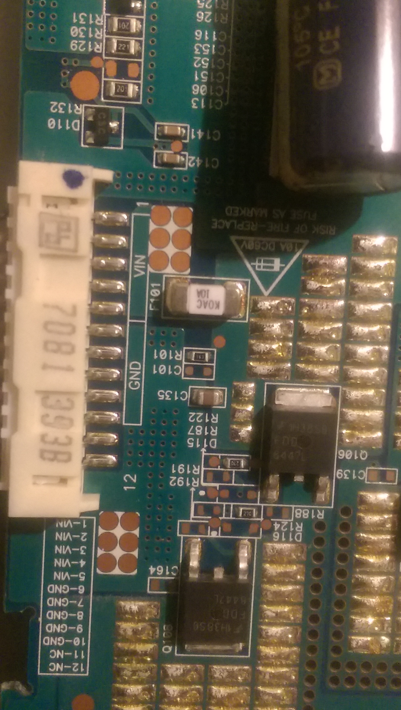

        Hi I have the same issue, slave had bad caps, replaced them, still dim. Looked at the ceramic fuse and it looks fine but then again a literally looked, I don't have a volt meter yet. What the hecks wrong with this thing?? Someone please help me out with this one please
        one mans is another ones treasure
        • maiden790
          • Nov 2014
          • 94
          okay i found out it is INDEED the ceramic fuse? now how do i look up the correct one and buy it in the united states?? its a KOAC 10A
          • Widgeteer
            • Sep 2015
            Same Issue Here. No backlight, all 4 caps on inverter boards bad. Replaced 4 caps with replacement suggested on first page and left side still dim. Soldered jumper onto ceramic fuse and works perfect. Now ordering replacement for ceramic fuse, then fixing correctly.
