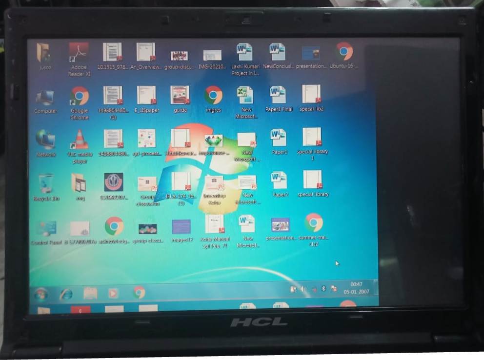

    Hello to all ,
    I have this HCL ME LAPTOP K 41 ,screen image is shrieked clock /speaker left side approx. 2 inches .Its 14.1 LCD SCREEN. I have replaced lcd screen ,found no difference
    Its blank that area blank and bottom of Task bar is rolled at bottom displaying top portion image . In bios /setup also getting same problem
    on external VGA port image is perfect /normal , Attached image

    Problem is solved, it corrosive at sides of LCD connector /VGA solder points
