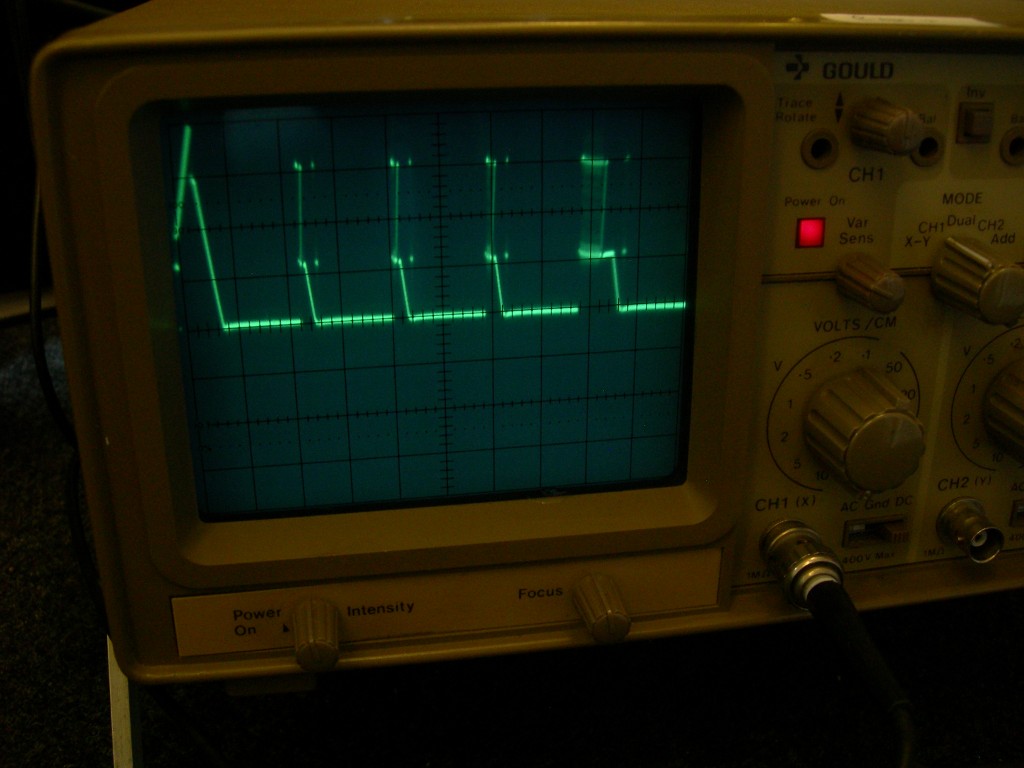

      Well, I gave it a shot, and I *do* see something. Obviously I can't resolve the fine detail, but I can see the individual voltage levels.
      I do have a 100 MHz digitising oscilloscope if necessary, but I *really* don't want to blow that one up, which is why I got the Gould.

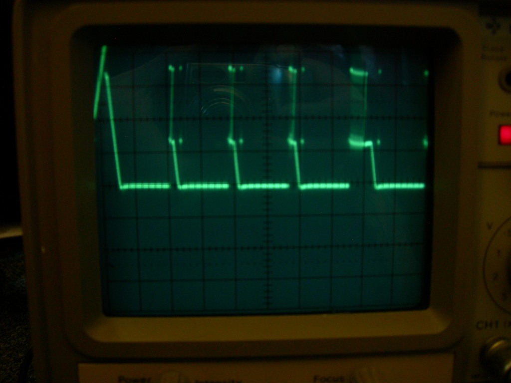

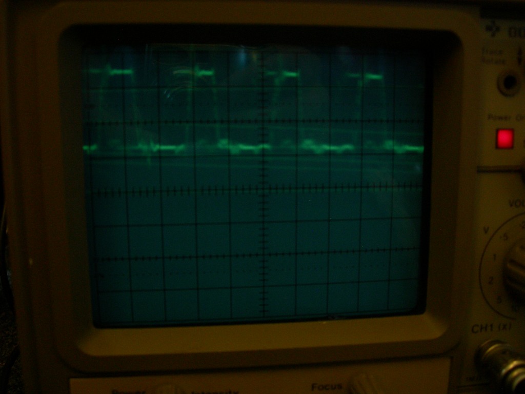

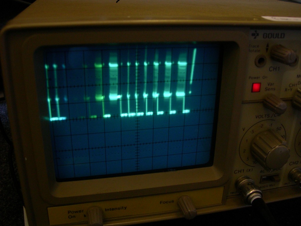

        Re: How to test my sustain board to make sure my buffers won't be killed?
        Here are some of the waveforms. Do these look okay?
        Surprisingly I was able to capture some of the sustain pulses too. However the scope does not have an adjustable trigger hold off (or triggers other than edge and TV), so a lot of other waveforms get superimposed on top.
