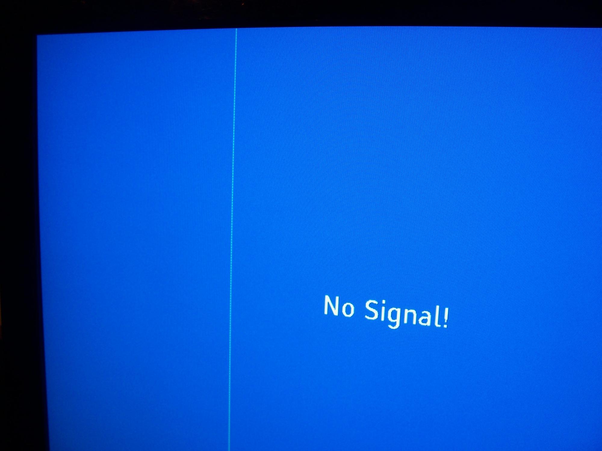

    I have a DX32 TV that has a thin line running down the screen. Perfect picture other than that. Anyone know whats up with this?

    Screen has gone bad. Most likely a damaged connection on the panel itself. Not repairable.

      Thanks Rayrod81 just my luck I though it might be repairable? This unite was sold in this condition so it must have been bad from the factory?

        So in all cases is this the result of a bad screen or is there some hope that it may be repairable. A pinched connector?? What are the other possible causes?

          Rarely it could be a bad t-con.
          It is repairable, but it will always come back. You will have to disassemble the panel and apply pressure to the ribbon which has separated itself. You can jig up some foam or tape to do this. But it will come back with time, it's unfortunately a permanent fault.

            So if it is a bad t-con board is it possible to replace the board? or are these sealed unites? I have not had this thing apart yet. Is it likely that the lines on this unite will get progressively worse?

              If it's a bad t-con it's repairable but as I said it's unlikely as usually bad t-cons cause a large area, if not the entire screen to fail.

                I think maybe bad connect at LCD panel call Tab Bonds
                check pot # 29 name only Tono & follow see is can help you
                http://www.avsforum.com/avs-vb/showthread.php?t=1173106

                  Thanks again tom66 appreciate your input I am trying to find any possible causes? Thanks to hoadle great bit of information and a great read.
