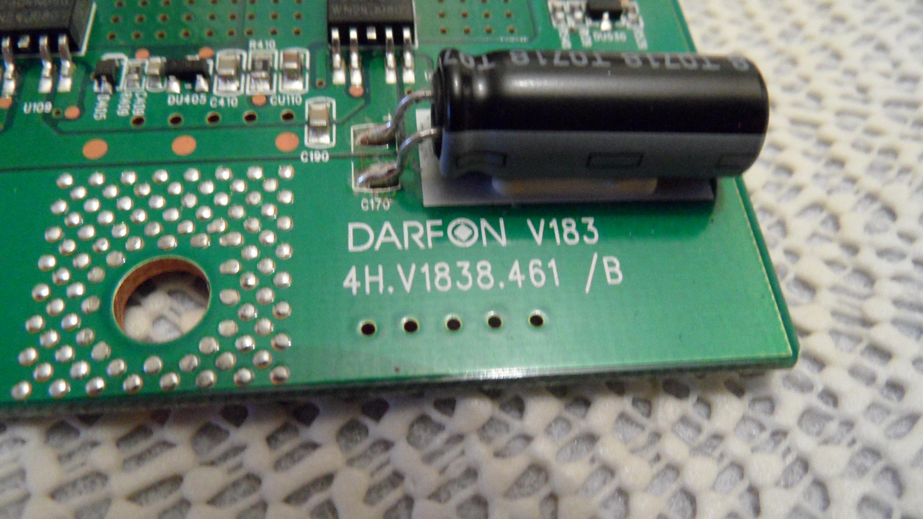

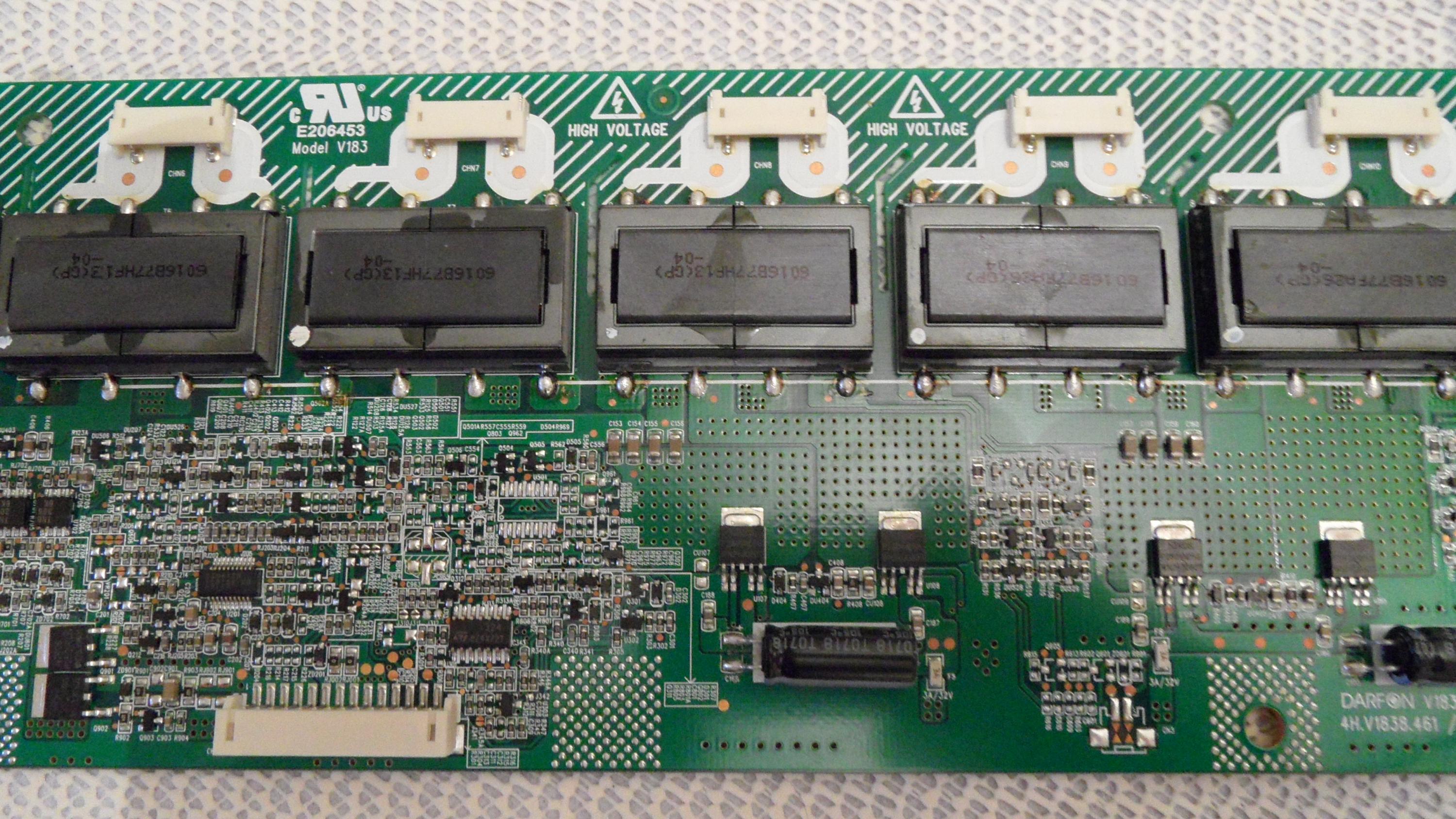

      1. Only one n in 'tuner'.
      2. The inverter transformers are on the inverter. Tom66 did not see fit to provide us with a set of pictures (BAD Tom66!!!). You may have to make up for his omission.
      3. You may not have the same problem. Fixing by wiggling cables usually means a bad solder joint. Try to localize the sensitive area.
      PlainBill
        Re: Philips 37" LCD 37pfl7662d/05

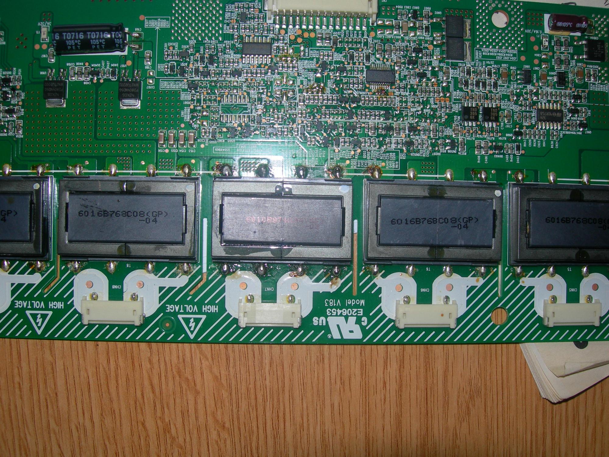

        Here are some transformers - the grey things. This was the one I replaced. (I didn't get a picture of the inverter itself.)
        It sounds more like you have a loose connection on the main board / tuner board / SSB (small signal board, as Philips call it.) Whatever it is called... it could also be a cold joint on the connector or in rare cases, a failed board.
        I can't remember that clearly, but I think the inverter got its on/off signal from the power supply, which got the on/off signal from the main board. However, some TVs bypass this and go straight to the main board from the inverter.

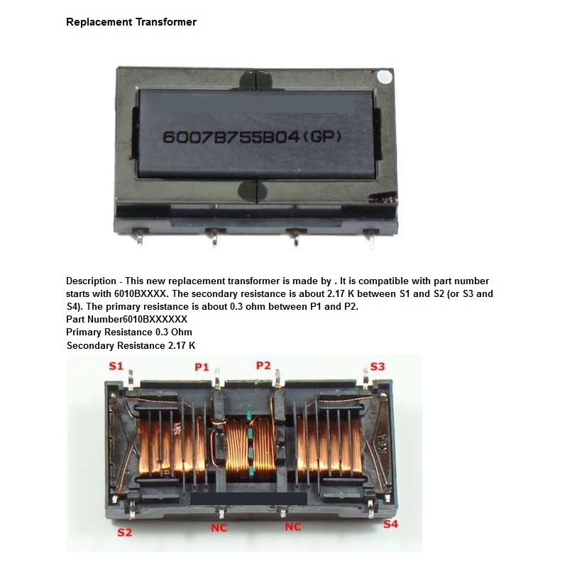

          one question: how to test transformer in circuit. thanks.
            With the TV off. Probe the two exposed pads next to the bulb connectors using your multimeter on the 2kohm range.
            On my set, all transformers measured around 1550 ohms.

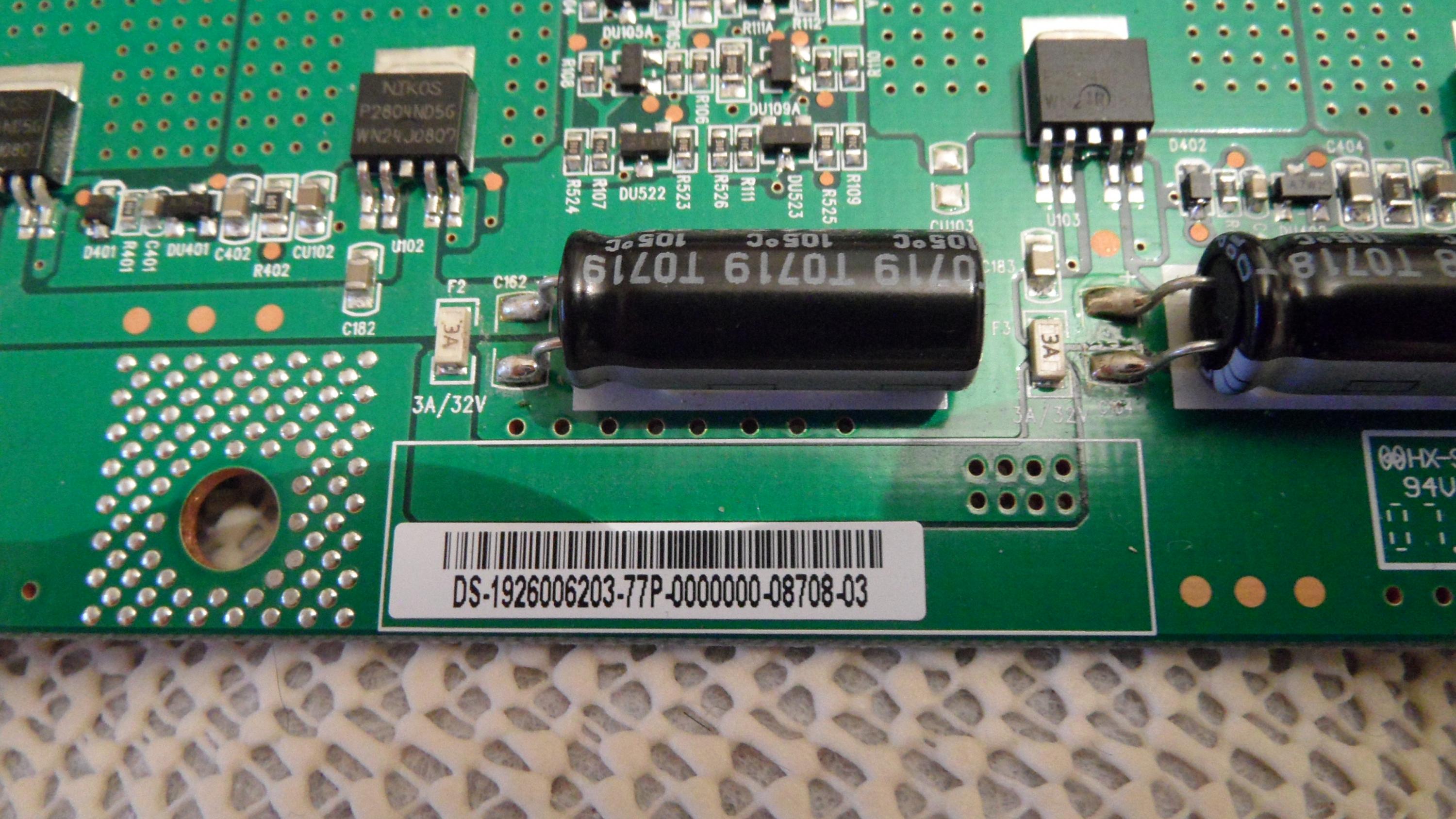

                        I don't recall it, but you'll need to open up your set anyway, and it's written on the board. It's a Darfon inverter.
                        Replacing the transformer is much easier and cheaper though.
                        • Stuwizard
                          • Dec 2011
                          • 6
                          #32
                          Many thanks ! Got one off eBay for £9.50! Has 10 inverters on the board ! Hopefully it will do the job . Was part no. 4H.V1838.461 /B
