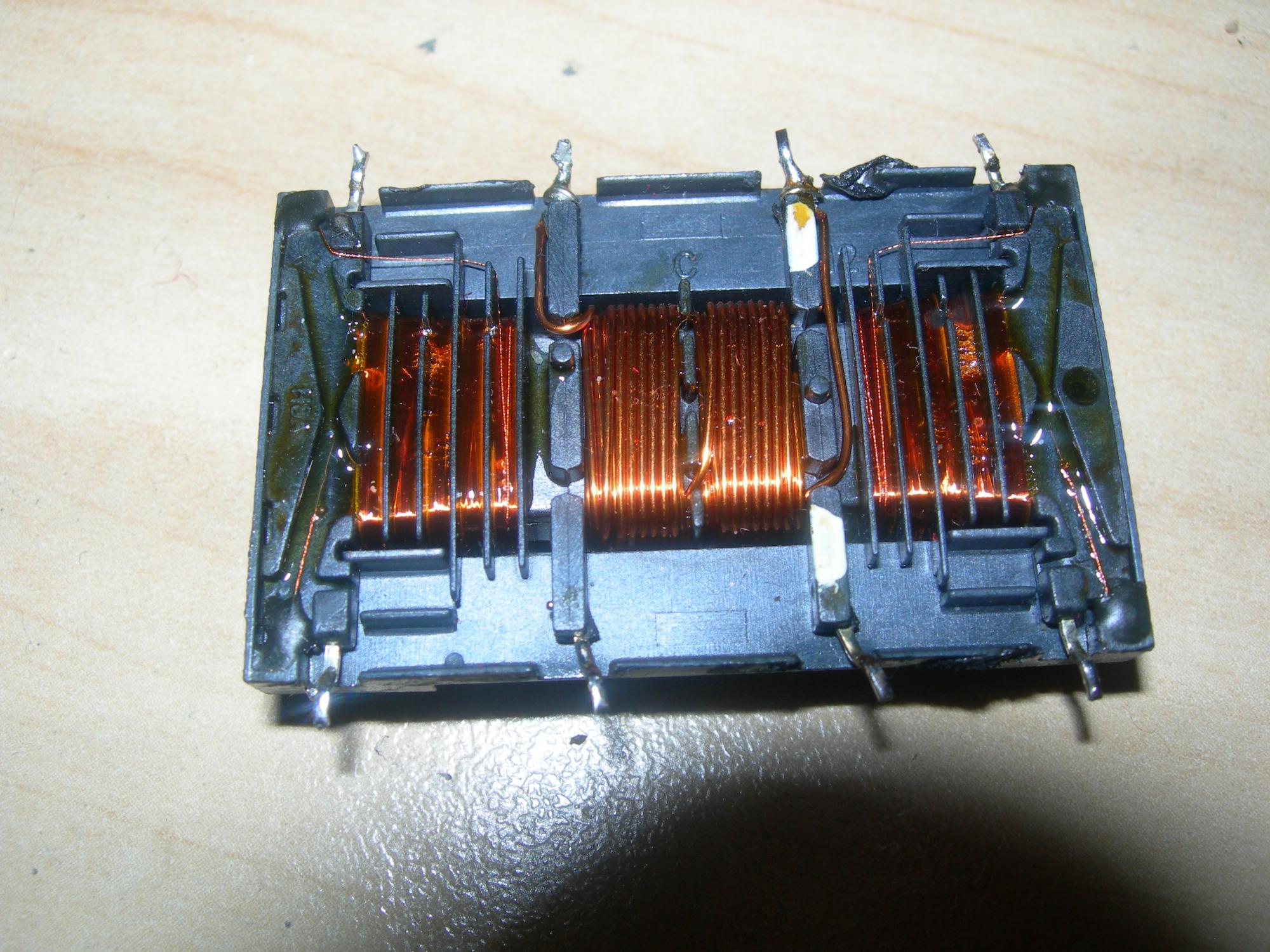

          Just got it in. Plugged it in, display lit up for half a second (with "EXT1" in the corner), then switched off. Looks like 2 seconds to black, I'll test the transformers and see if any need replacing. LCD panel is intact, although a bit dirty, and the video processor itself seems to be working, so the main board may well be unnecessary.
            Re: Philips 37" LCD 37pfl7662d/05
            Bam! Transformer 3 is failed. All others measure 5.2kohm; this one is just open. I will try sourcing a replacement and see if that works.
            Edit: My error, it is #4 counting from the top.
              Okay, so I ordered the replacement transformer and removed the old one. Well it is very clearly failed; there is a black mark in one side of the secondary winding, which has also burned the PCB silkscreen. It's in the top right corner.
              What causes these transformers to fail? I thought transformers were generally quite reliable.
                High tempeature or current. Or both at the same time. Isolation will melt under those conditions.
                  This particular failure is the result of poor winding technique. The problem is the ultra fine gauge wire used. When ending the winding the worker is supposed to leave a tiny bit of slack to allow for expansion and contraction. If they aren't careful, the wire will be under tension, and break from vibration or thermal contraction. Once there is a break, an arc forms.

                    Thanks for the explaination PlainBill, that makes a lot of sense and would explain why only one has failed. Out of curiosity is it possible to rewind these transformers? I had to pay £16 for the part, which isn't bad for a 1080p 37" (which I got for £40), but I'm a cheapskate .
                      I prefer to call it 'judicious use of monetary resources'.
                      It's not really practical. The manufacturing process involves winding a precise number of turns on a plastic bobbin, inserting the ferrite core, then impregnating the assembly with varnish. If you have access to the proper bobbin, cores, and wires it could be done, but otherwise - no way.
                      If the windings are not damaged it is sometimes possible to bridge the gap with a very fine wire.

                        Thanks. I've been eyeing up a faulty inverter board on fleabay (for cheap), might be worth salvaging the transformers from that for future repairs or to resell as parts. There are 10 on one board. Presumably only one is failed.
                                Good news. I replaced the transformer and it works perfectly now...
                                Well, it works... but there is one minor glitch. When first switched on, the right hand side of the display starts off dark, then flickers to life. Within 3 seconds of the left side being on, the right side is stable. I'll upload a video of this later, but does anyone know what might cause this problem?
                                Once powered on and the right side has stopped flickering, the picture is perfect for a long time. (I haven't tested it for longer than 10 minutes though, I'm going to leave it on for a few hours and see if it's still okay.)
                                I hope it's something simple, like bad capacitors, but it is full of Rubycon and Chemicon, mostly 6000 hour caps, so it would seem unlikely. Sad though, as I'm seeing newer Philips sets full of Ltec.

                                        Yep fixed.
                                        The problem was a failed inverter transformer, you can either replace the transformer or the whole inverter.
