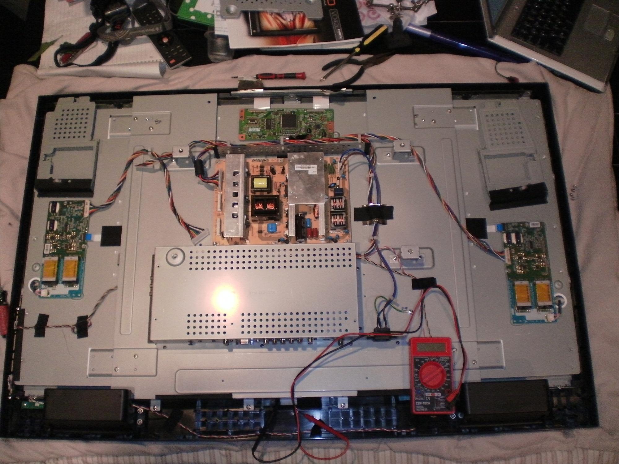

    I have been trolling this forum for the weekend trying to gleen all the info I can to fix a freebie I picked up from a friend. I have read multiple threads and figure it's time for some more direct assistance.. A Vizio VO42L FHDTV10A that the picture went out but still sound. I am a crack electronics fixer, I have fixed my bad caps on my Samsung 50inch LCD, also fixed the bad caps on my Frigidaire fridge control board and also regularly buy and fix Apple Iphones/ Ipods that have water damage and battery/screen issues for friends. I have no training with a multimeter but have been able to piece together info from this forum and youtube on how to check my new project and I do have a bottom of the line multimeter to use. I will take pictures asap to assist. Here is the issue so far. Amber light comes on when I plug in, turns white when I turn on with power button, and I get a flash from the right side of the panel(backlight i assume) when looking at the set from the back. I can see briefly during this flash the on screen menu/channel on the one side that lighted, but the left side does not flash but I can faintly see the CHANNEL 2 box in the upper side of screen that back light did not flash on. I took checked both master (left side) and slave (right side) inverter boards. Both seem to be in great shape, no pins popped or bulged on the chips, and I checked the small chips and all had a consistent reading of resistance per the research i have been able to do... I de-soldered the fuse on the power board and figured out how to check it with the multimeter, its good, re-soldered and still same issues. I have been trying to check the 2X24 volts and 12V and cant seem to get a reading on them at all. Not sure if i am checking correctly, just using the multimeter common and volt probes and touching the outer pins indicated in posts I have seen previously. I also switched the positions on the inverter plugins to the power board and still the slave (right) side inverter only flashed(backlight) both times. Not sure what this means so trying to figure still if it is power board or the inverter boards or the LCD board? Any help on how to troubleshoot from here? THanks for any assist!!!

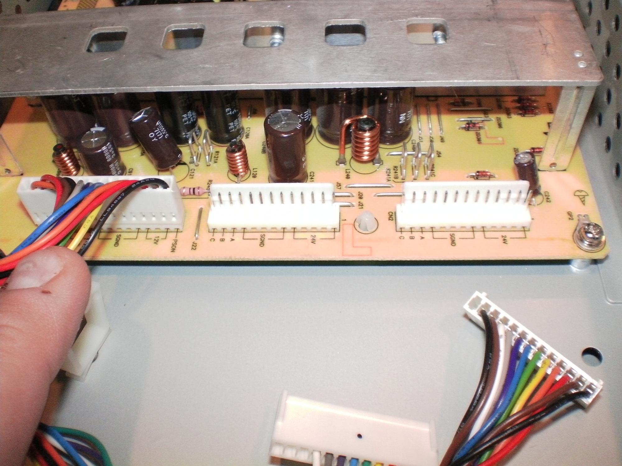

    Pics included now. Please help me troubleshoot the 12V pins and 24. step by step where to touch? what should read on the multimeter?

      place the black cable of the multimeter on the chassis or one of the screws holding down the board your checking and the red probe to the 12v pin or 24v pin. You should be getting something there. Make sure the meter is set to VDC (Volts DC)
        Re: VIZIO VO42L FHDTV10A No Video
        To check the 12 volt output first plug in the TV and hit the power button so the amber light turns white. There are two spots you can use of ground. One is a mounting screw such as the one on the right side of the last picture. The other is you can use any of the pins labeled SGND on the output connectors.
        To measure voltages set your DMM to the 20 VDC range and either hold the black probe on the ground screw or jam it into the connector next to a wire to a pin labeled SGND. To measure voltages the best way is to stick the probe into the connector next to the wire.

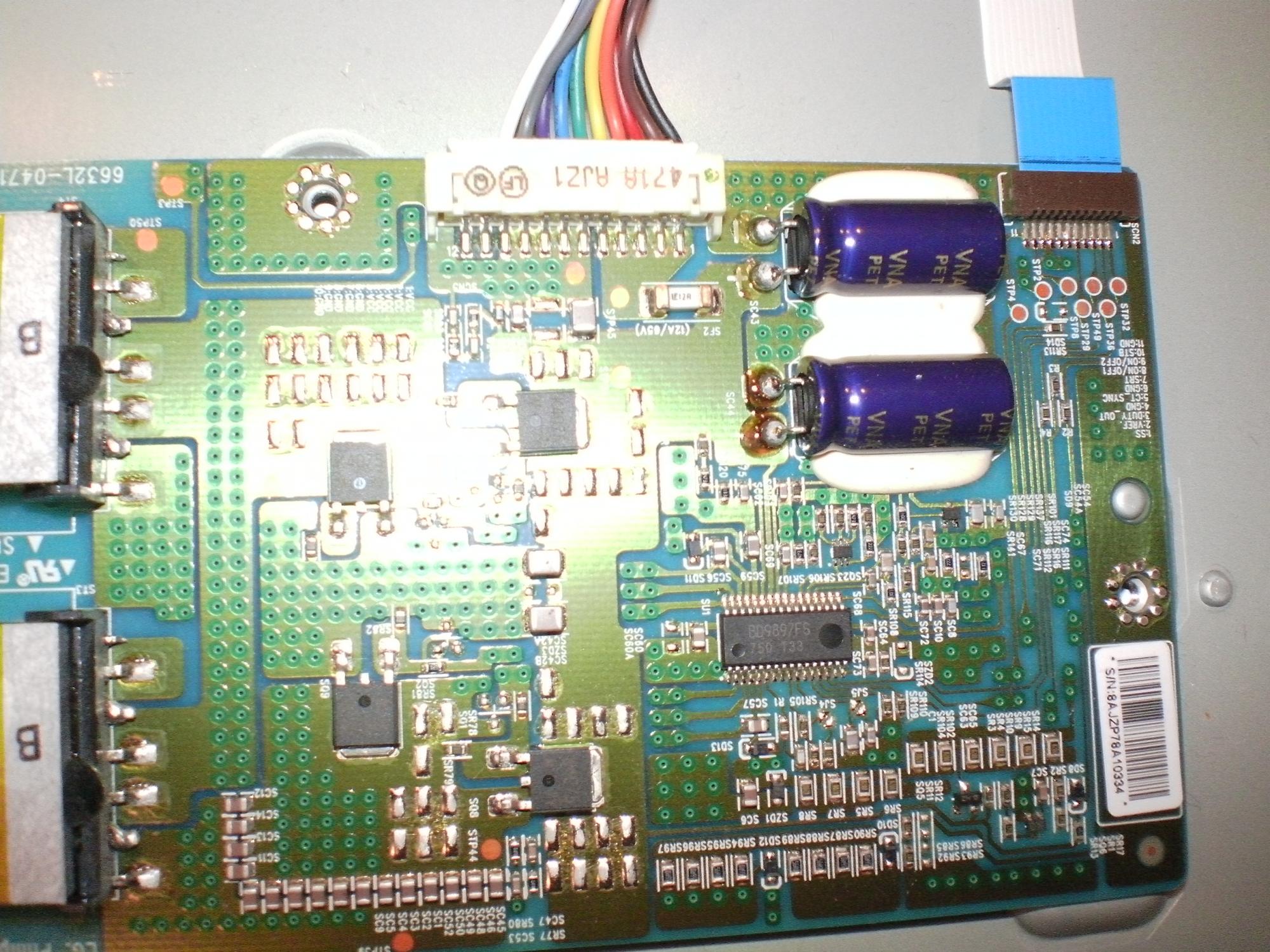

        Given that you get a flash out of the backlights, odds are the problem is one of the inverters or a CCFL, not the power supply.

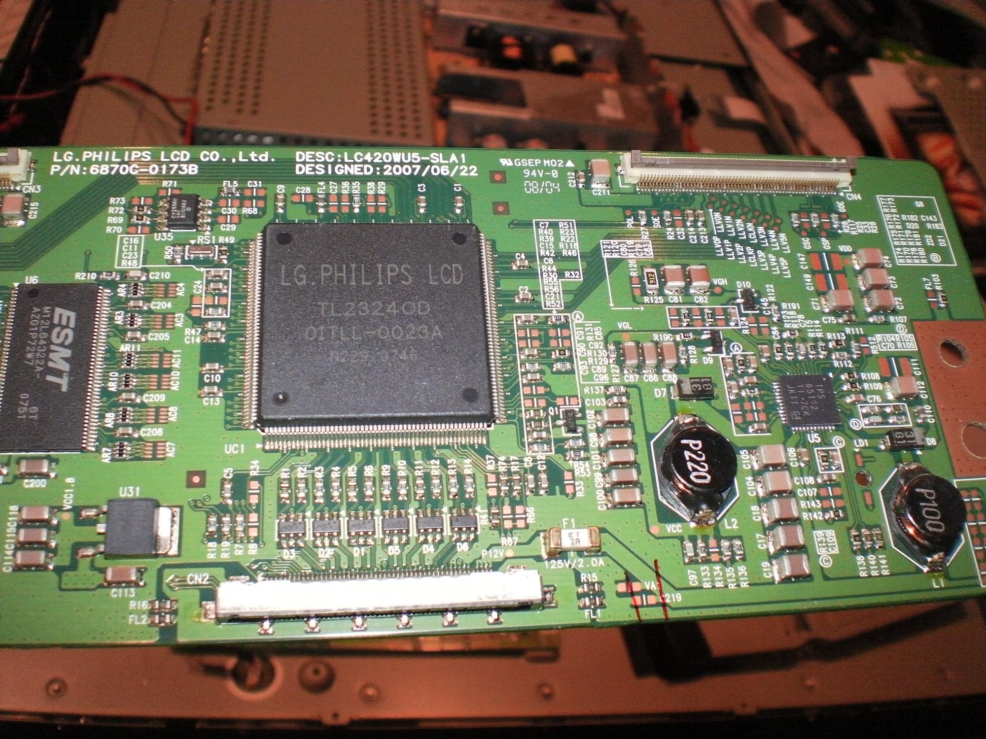

          Thanks for the guidance gentlemen. I appreciate your sharing of knowledge!! I did the DMM test as described and with vizio white and power on i get 24.3 V for the 2 24s and 11.7 for the 12. Does this eliminate my power as suspect?
          Sorry for the unfamiliarity with the acronym CCFL? LCD controller board? aka TCON?

            First a little background. Any electronic device can be broken down into subsystems. Successful troubleshooting depends on identifying the defective subsystem and either replacing it or further identifying the cause of the failure and repairing the bad component.
            To use the current example, the TV breaks down into the power supply, main board, and display subsystems. The display further breaks down into the LCD panel and the backlight subsystems. The LCD panel subsystem breaks down into the actual LCD panel and the TCON - an acronym for Timing and CONtrol board. Because you can see information on the entire panel, a large part of the TV is shown to be working.
            The problem is with the backlight subsystem, which breaks down into the inverters, the CCFLs (Cold Cathode Fluorescent Light), and 'GOTCHA' - the section of the power supply that powers the inverters.
            The problem you describe is 'two seconds to black'. Essentially, if the inverter controller senses a problem, it shuts down. Possible problems include a CCFL that is not drawing enough current (or is open), a CCFL that is drawing too much current, a bad transformer or bad driver on the inverter, a power supply with bad filter caps, a CCFL that is arcing, etc, etc.
            In this case, I'm out of my depth. I've never worked on a TV with the dual inverters you have. A visual inspection using the pictures you supplied does not show a common failure - a blown controller, but the transistors could be shorted. Or it could be something as mundane as an open fuse. Or a cracked CCFL.

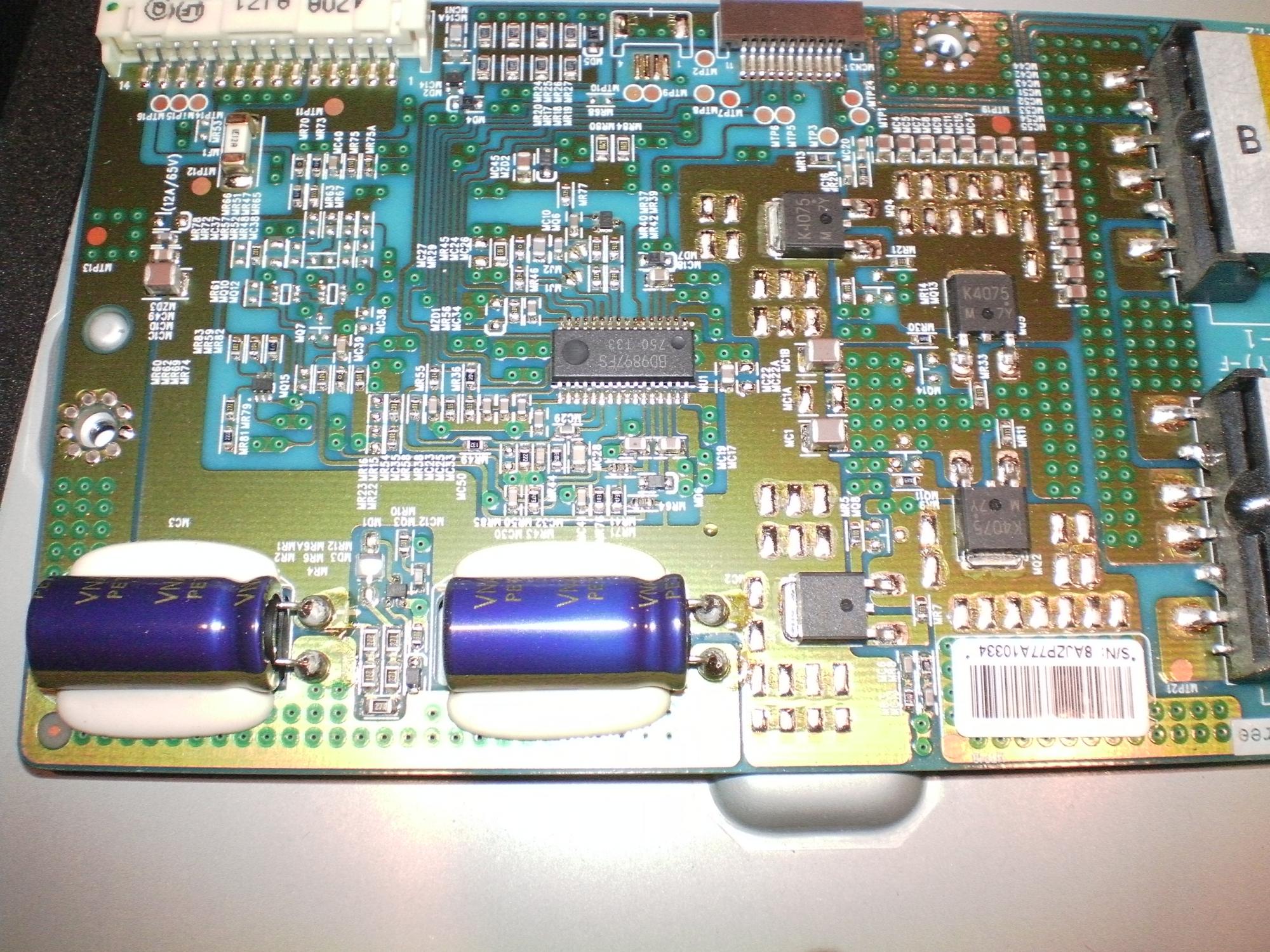

                  I just repaired 2 of these.. Both had bad caps on master and slave board (inverters) In both cases, the tv repair person told the owner it was a bad panel... One of them the screen was flashing like a strobe light and the other was no picture.. 470uf 35v caps 2 per board..

                    I have the same issue with a VO42L. I have even replaced the capacitors, ICs and all FET transistors on both inverters and I still don't get any life from the panel. I can turn the TV on and off though.
