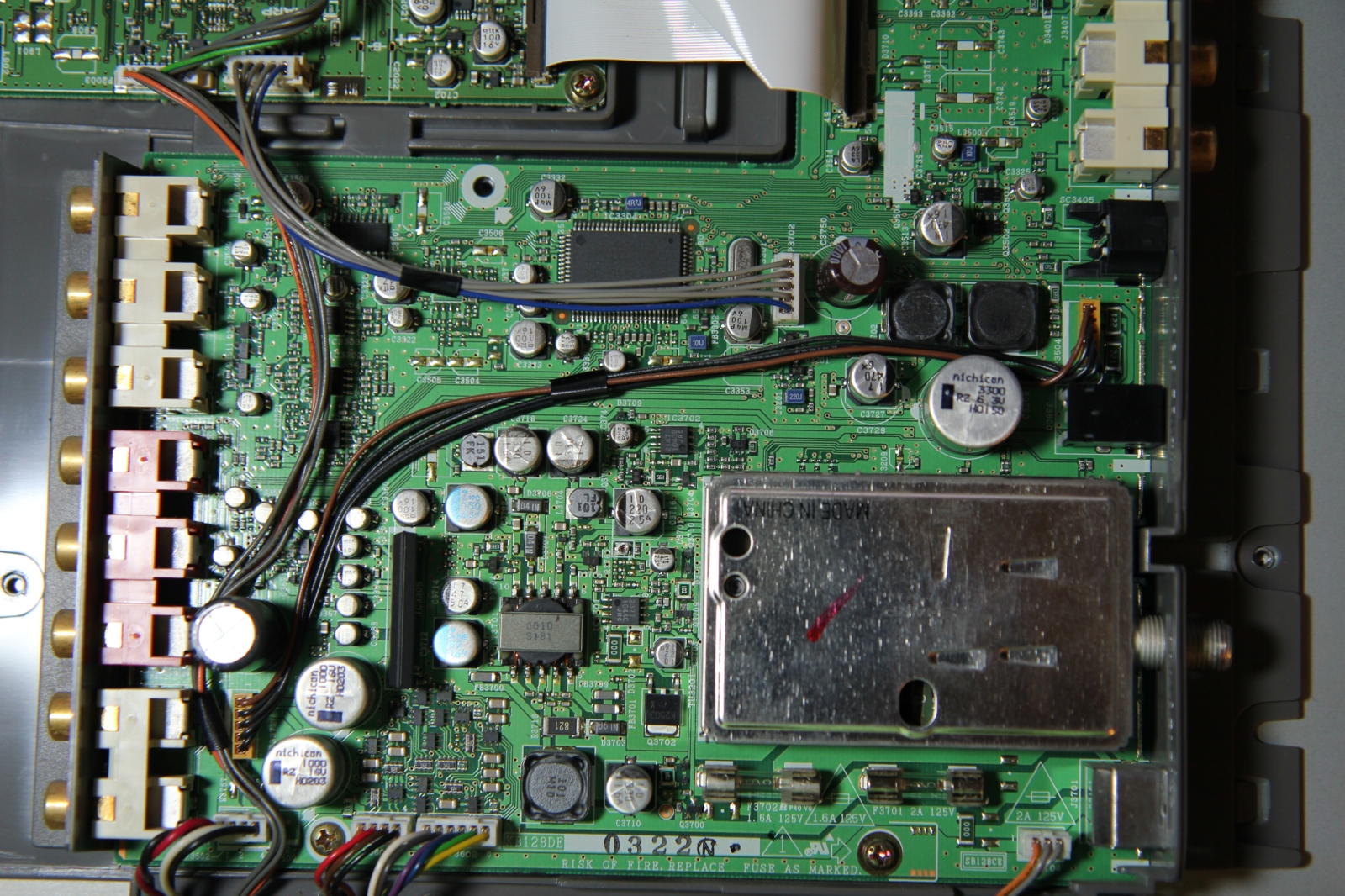

      • thisguy
        • 19
        Re: Sharp Aquas LC-20B2UA random shut off issues.
        Thanks guys!

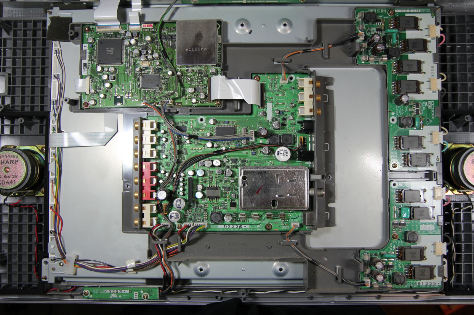

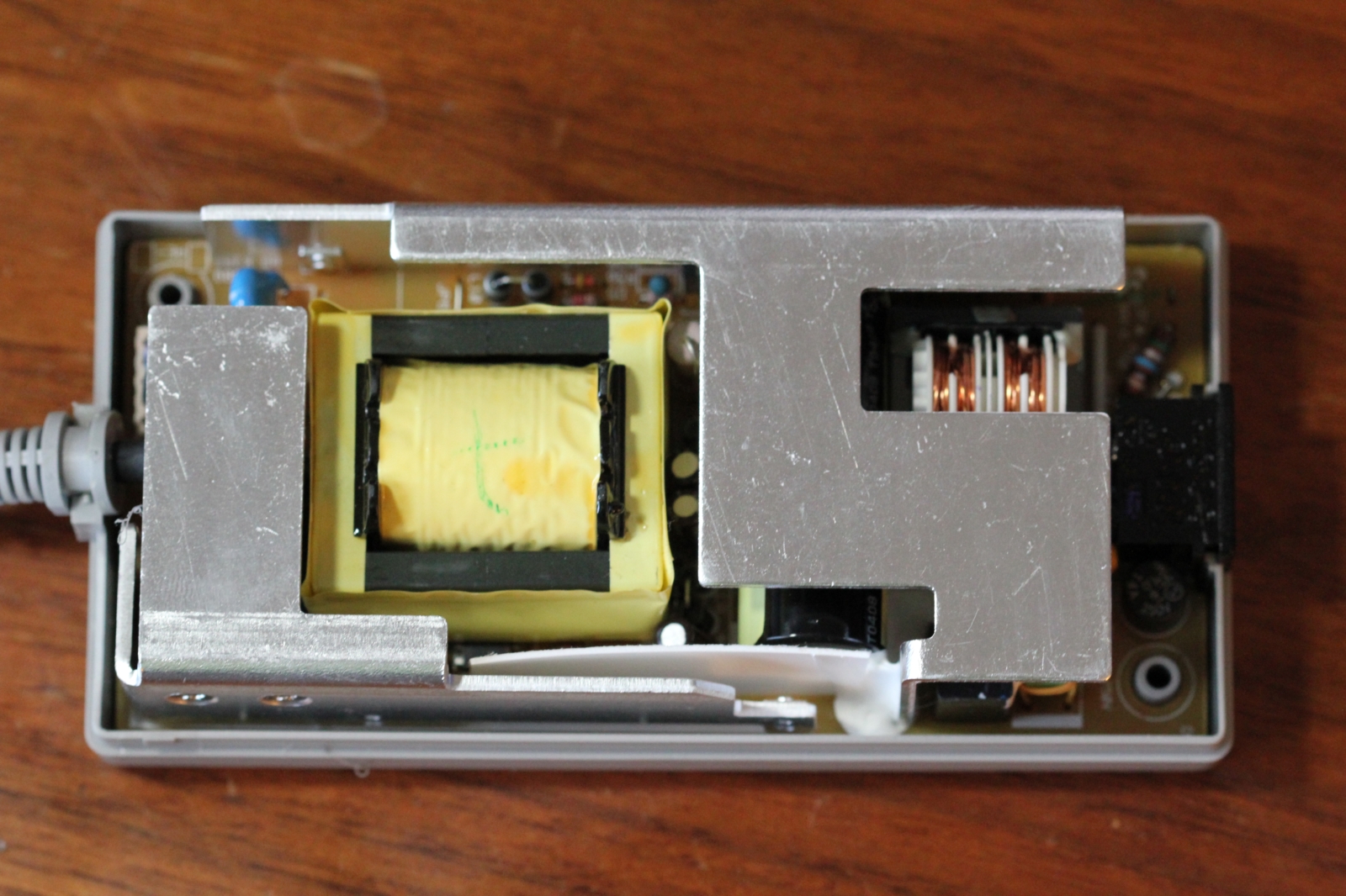

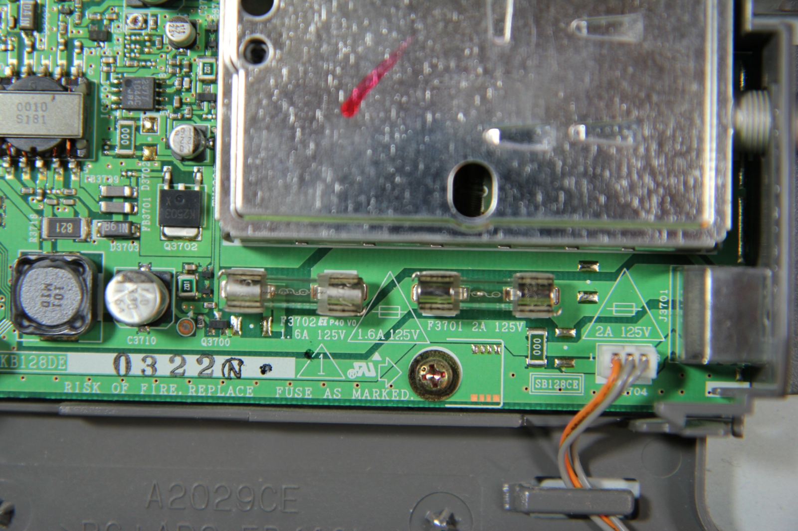

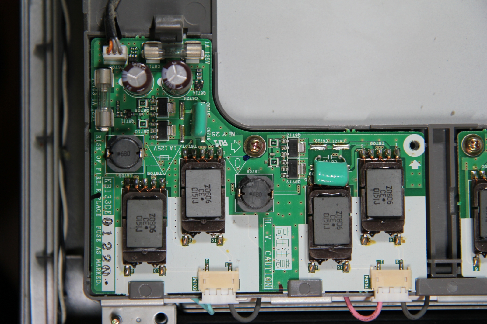

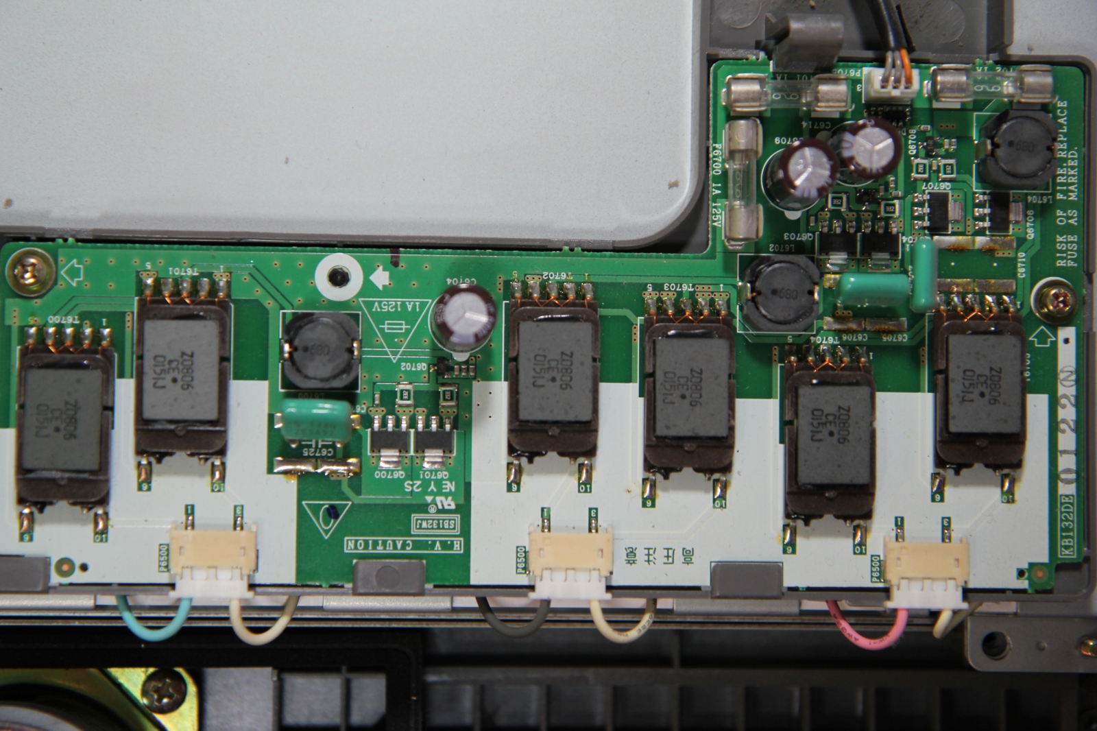

        I've uploaded the pictures. They started out as 18 megapixels, but i had to shrink it down quite a bit so they were not crazy file sizes. Please let me know if better or more details areas or needed.
        btw, The fuse only blew once after I initially replaced it when I got the TV. It has not blown since I have been using the new AC adapter.
        Also, I cannot be certain, but I'm pretty sure the random shutting off problem did not happen before the AC adapter was shorted by the ice cream.

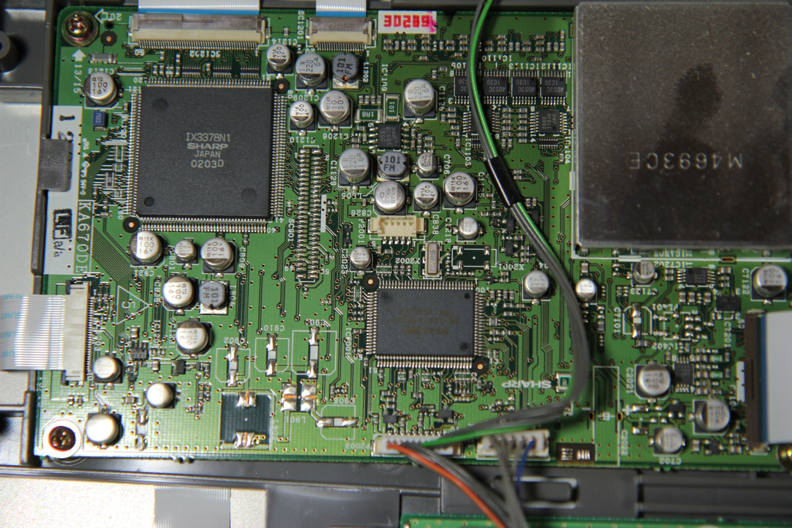

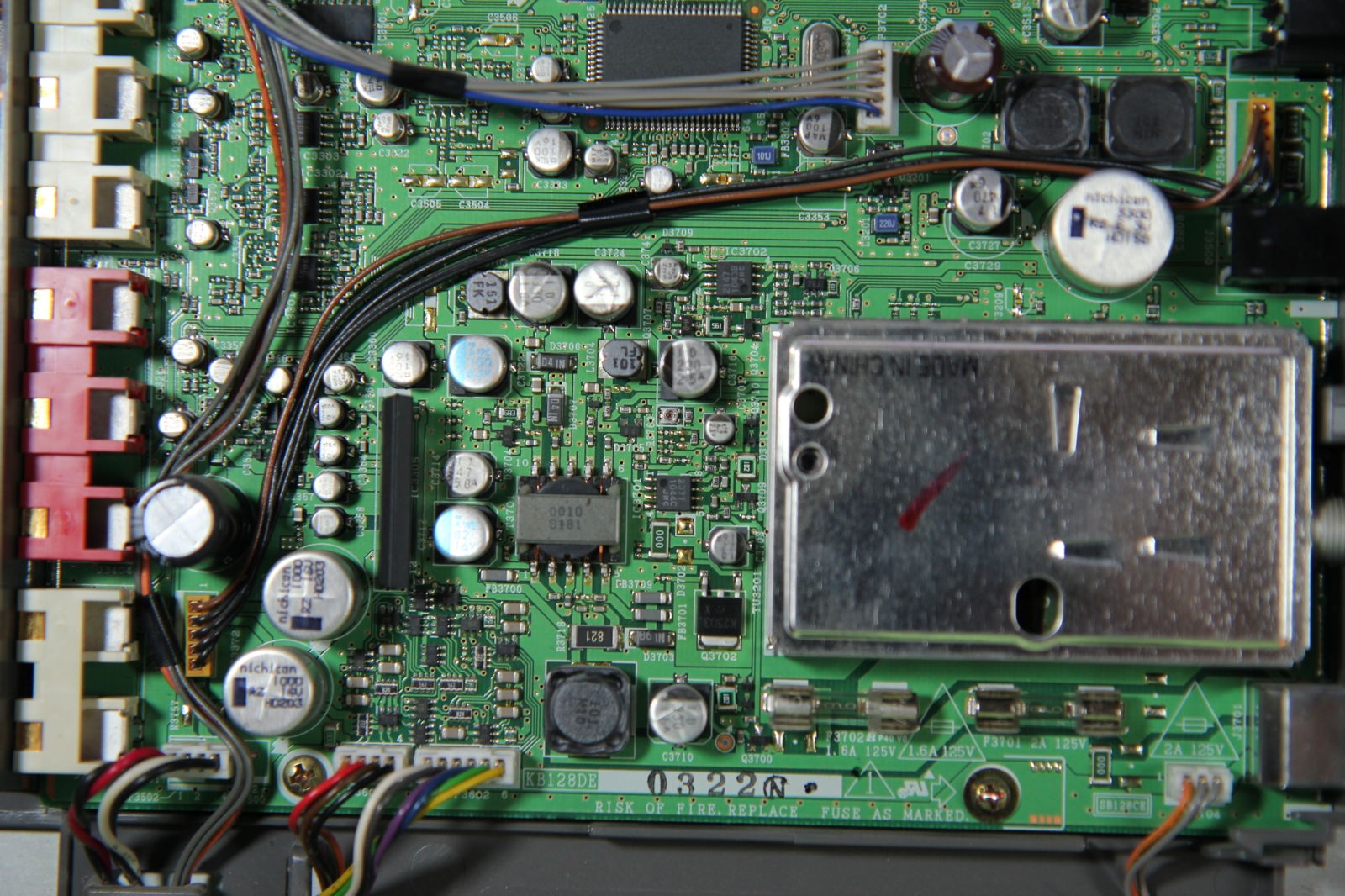

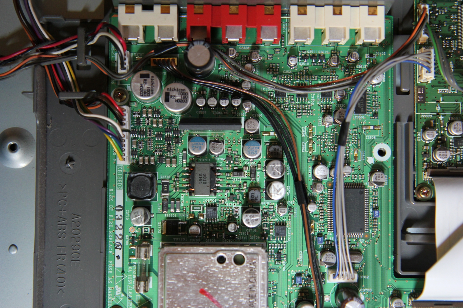

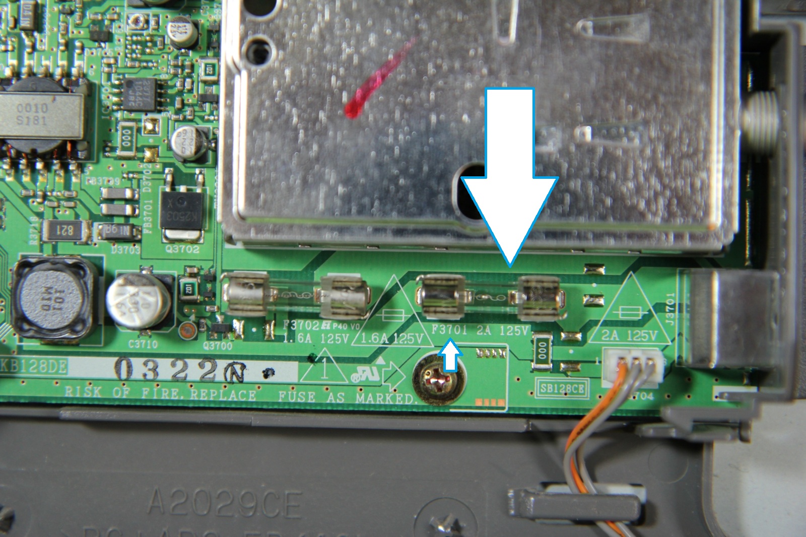

        Picture one is the overall picture.
        The fuse I replaced was F3701 of picture 2.
        The rest are just a bit closer up.
        Thanks again!

          • PlainBill
            • Feb 2009
            • 7034
            Excellent pictures, and you deserve a lot of praise for the work you did. I wish I could offer some encouragement. The fact is that this is a very early LCD TV with very poor specs. Still, it does represent a challange, so here are some thoughts.
            There are two fused power input lines. One is for Vcc.SIG, and runs to both the terminal and main boards. The other goes only to the voltage regulator on the terminal board. It would help if you could identify which of those you replaced.
            There are two possibilities. Both assume that the power supply reacted to the ice cream bath by failing high - producing too high a voltage. That voltage surge damaged some component on either the main board or the terminal board.
            If the fuse that blew is the one going only to the terminal board, it would be worthwhile replacing the voltage regulator. If it's the one for Vcc.SIG, about all you can do is see if any component seems to be getting unusually warm.
            I did check eBay for parts for this TV. There are multiple listings for most of the parts. The only notable part not listed is the terminal board. Even if the problem is the main board, at $60 plus shipping I'm not sure it is worth it.

                • PlainBill
                  • Feb 2009
                  • 7034
                  Originally posted by thisguy
                  Thanks Bill!
                  Yeah, I figure this TV kinda sucks. I wont feel to bad if I can't fix it. I just figure I try since I sunk 30 bucks into the new AC adapter and because it's been sitting in my room for the last 2 years (also I recently got a soldering station ) I've uploaded a new picture of the fuse that blew. Please let me know if its the Vcc.SIG or the one that goes to just the terminal board. The voltage regulator on the terminal board, is it that IC3701 DC/DC PWM?
                  If you don't mind me asking, what does the VCC.Sig power vs the just the terminal board?
                  Also, I just can't understand how if the AC adapter is new (and assuming it's running fine), how any damaged TV component could tell the difference between whether the AC adapter has already been plugged in for a while or if it's been unplugged for a while (because it only turns on after a random shut off if the AC adapter is unplugged from the wall for a while). Is it possible that the damaged TV can be triggering some type of safety function built into the AC power supply? Or perhaps creating some type of instability in the AC power supply that it shuts it down?
                  The 1.6A fuse powers only the audio amp. The fuse you replaced powers the Sig.Vcc line (I had it backwards on my earlier post). On the terminal board it goes to a DC-DC converter which provides 5V, 12V, and -8V. On the main board Sig.Vcc provides power to a couple of DC-DC converters and the 'Operations Board' (the board with the push buttons). And it may go to other points. I don't even pretend to myself to be infallible.
                  You bring up a very good point. Perhaps you can verify it. From an electrical point of view, there should be no difference between unplugging the AC adapter from the wall and unplugging the AC adapter from the TV IF the adapter was putting out the proper voltage. If you can leave the TV open so you can access the two fuses (without any chance of fingers touching the inverter area), you should be able to determine if the DC input voltage is still present when the TV shuts down.

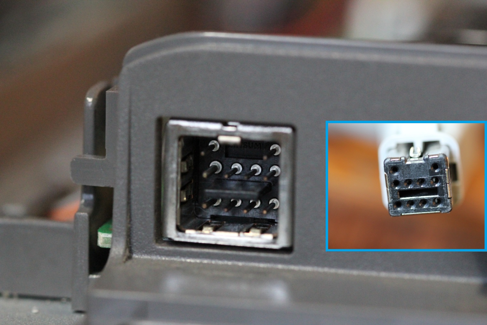

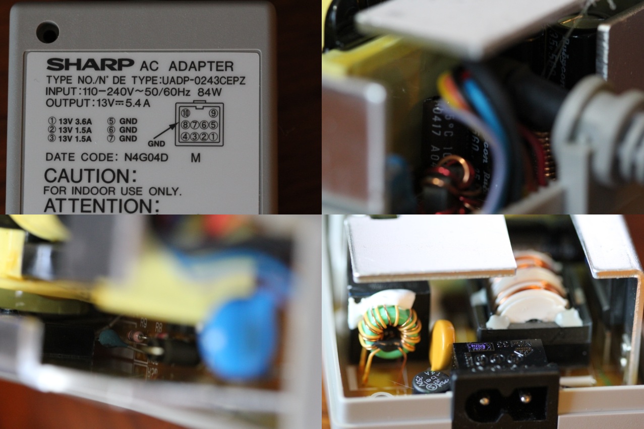

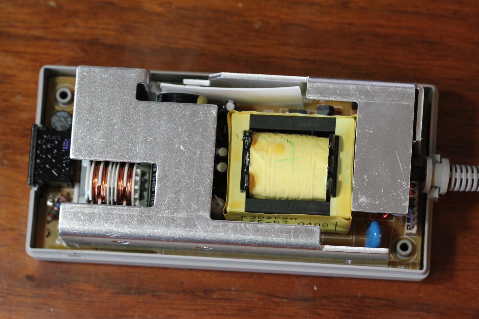

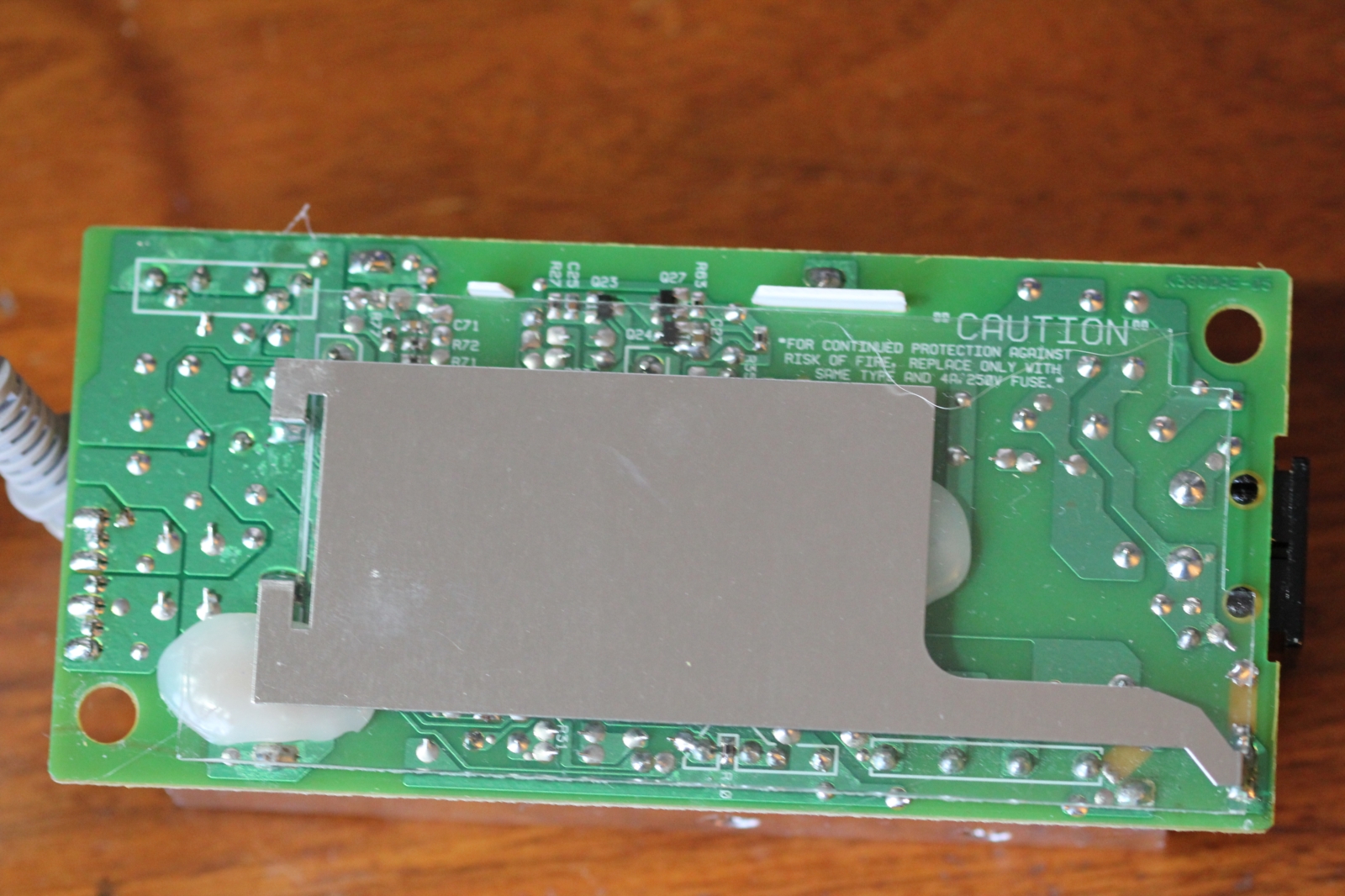

                              • thisguy
                                • 19
                                Sorry for the late reply.

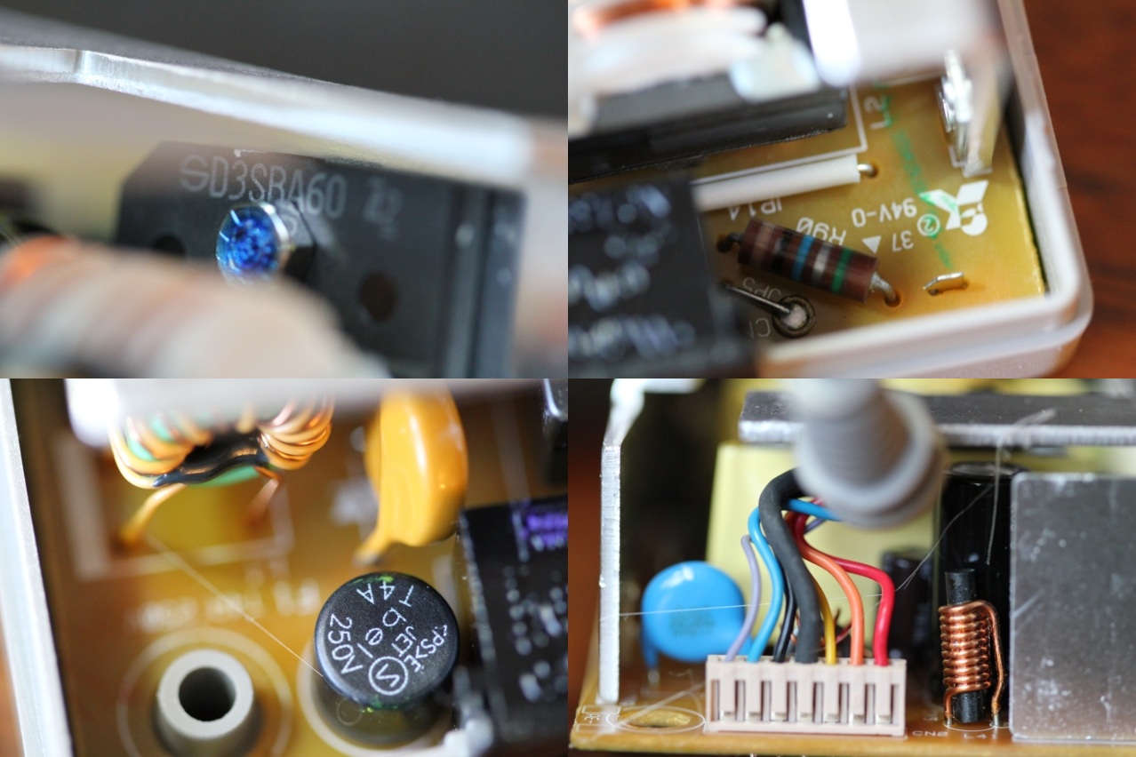

                                Here are pics of the power socket on the TV and some pics of the AC adapter. It was difficult taking pictures of the AC adapter because the heat sink, so I apologize if they are of little use.
                                I don't think there is a mechanical switch, but I'm not expert.
                                Thanks!

                                  • PlainBill
                                    • Feb 2009
                                    • 7034
                                    Thanks!
                                    If you haven't already done so, check the point where the power jack is soldered to the terminal board in the TV. It seems like that could be a likely spot for bad solder joints.

                                    • Village Electronics
                                      OldPro
                                      • 118
                                      Thanks!
                                      Note pictures 1 and 5. In picture 1 you can see the switch at the top of the plug. In picture 5, the drawing, you can see it as the little rectangular block at the top.
                                      Below that plug the is a series of solder connections corresponding to the pinout of the drawing. Quite often those connections are bad. Users will often push the plugs hard to insure that the connection is made. Sometimes they even wiggly them to make it "work". It is a stress related problem. Check that the switch works cleanly with an ohm meter. That can be done by manual operation of the switch while you observe the change on the ohm meter.
                                        OldPro
                                        • 118
                                        Thanks!
                                        Note also in picture 1, the two metal bars at the bottom of the socket. They may be the switches.
