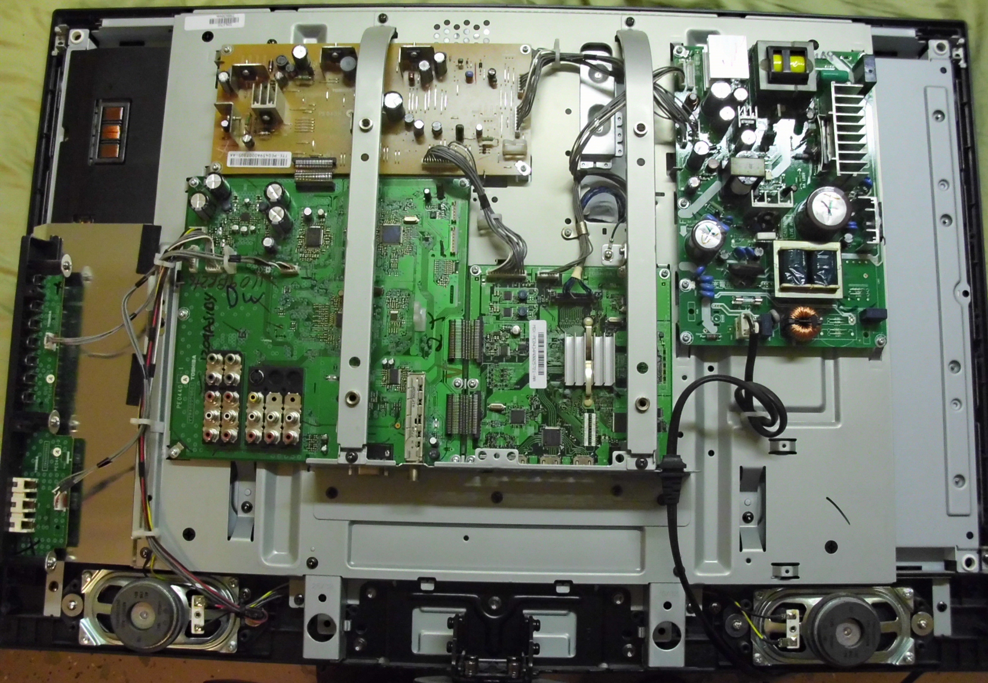

    Toshiba 32HL67US sound/good backlights/ black screen
    Toshiba model # 32HL67US chassis # TAC0749
    This television will power on, I can here sound and tell the backlights are on but the screen is black.
    This one of my first attempts at a television I hoping someone could point me in the right direction.
    I am really not up to speed on the proper names for all the boards.
    I did a search and found what I think may be a similar problem, it was recommended to check and see if the fuse on the Tcon board was good and that it's getting the proper voltage through the fuse.
    For right now I just posted an overall shot of the set and if needed I would be more than happy to provide more.
    I am just wondering if I should disassemble to get to the Tcon or are there some other things to check first?

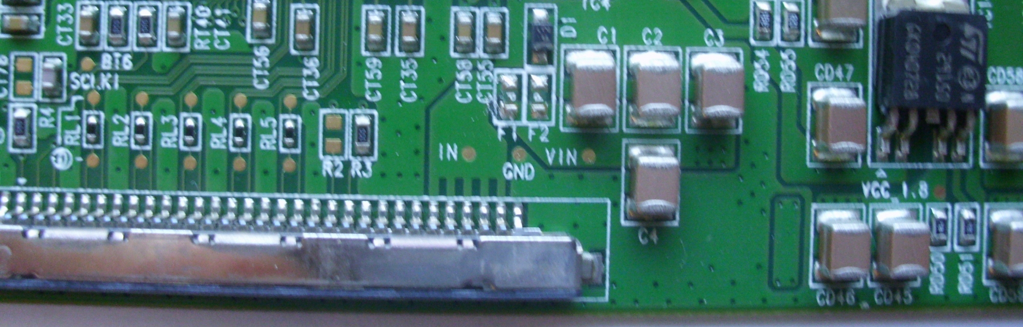

                    Is this the T-con board? Or what is it?
                    There were a lot of screws but it wasn't that bad, Fuse #1 has gone open, I have quickly checked so capacitors in its area, and none appear to be shorted, I am hoping I will get lucky and have working TV for the price of a fuse.
                    Let You know!

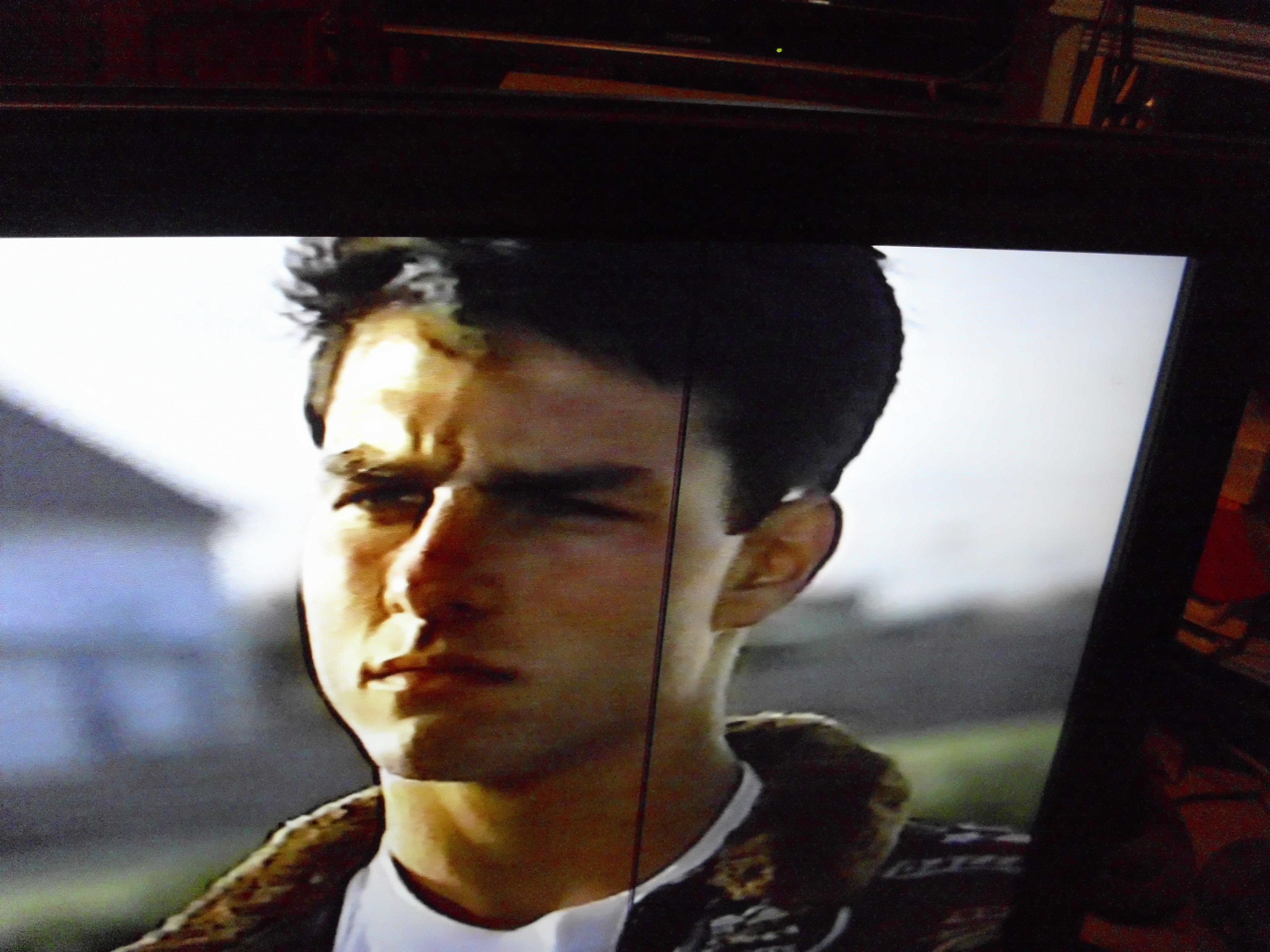

                      Re: Toshiba 32HL67US sound/good backlights/ black screen
                      I was able to replace the fuse and it dose not go open.
                      But,I have 3 lines in the screen that i realy wish were not there,Dose this mean it needs a panel?
                        After runing this for about 1/2 hour the the lines are no longer there.
                          tab bonding issues maybe?
                          (the connections from the flexcables to the actual glass panel)
                            Yes, that is the t-con.

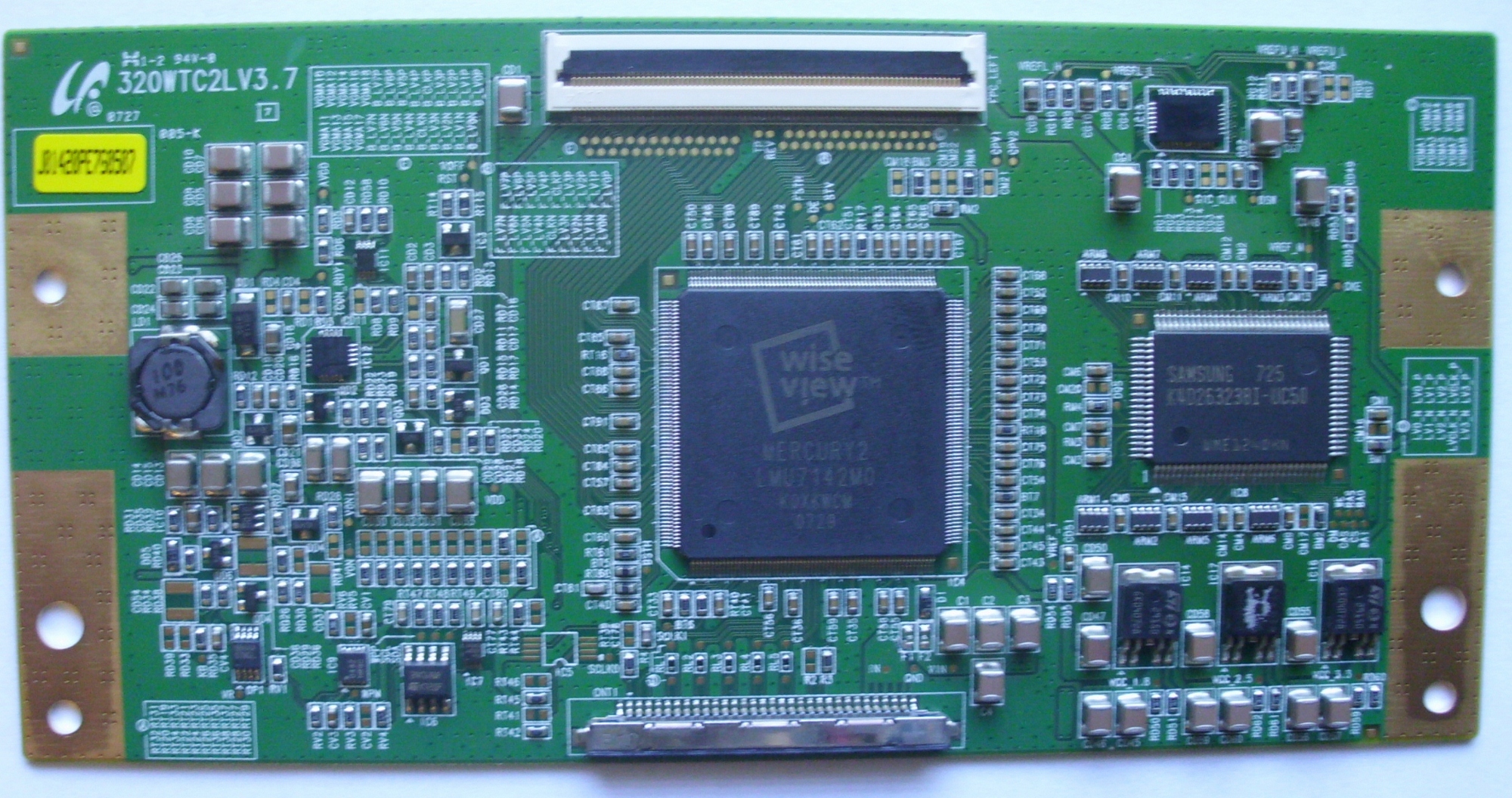

                                I have the same issue with my 32HL67US but the fuses on the t-con are good. have great sound , have backlight , but have No picture.. any suggestions? tv
                                  Post good clear pictures of the T-CON board so we can tell you which test points to check. Use attachment function.
                                    T-con likes to go out in this tv got one sitting here
